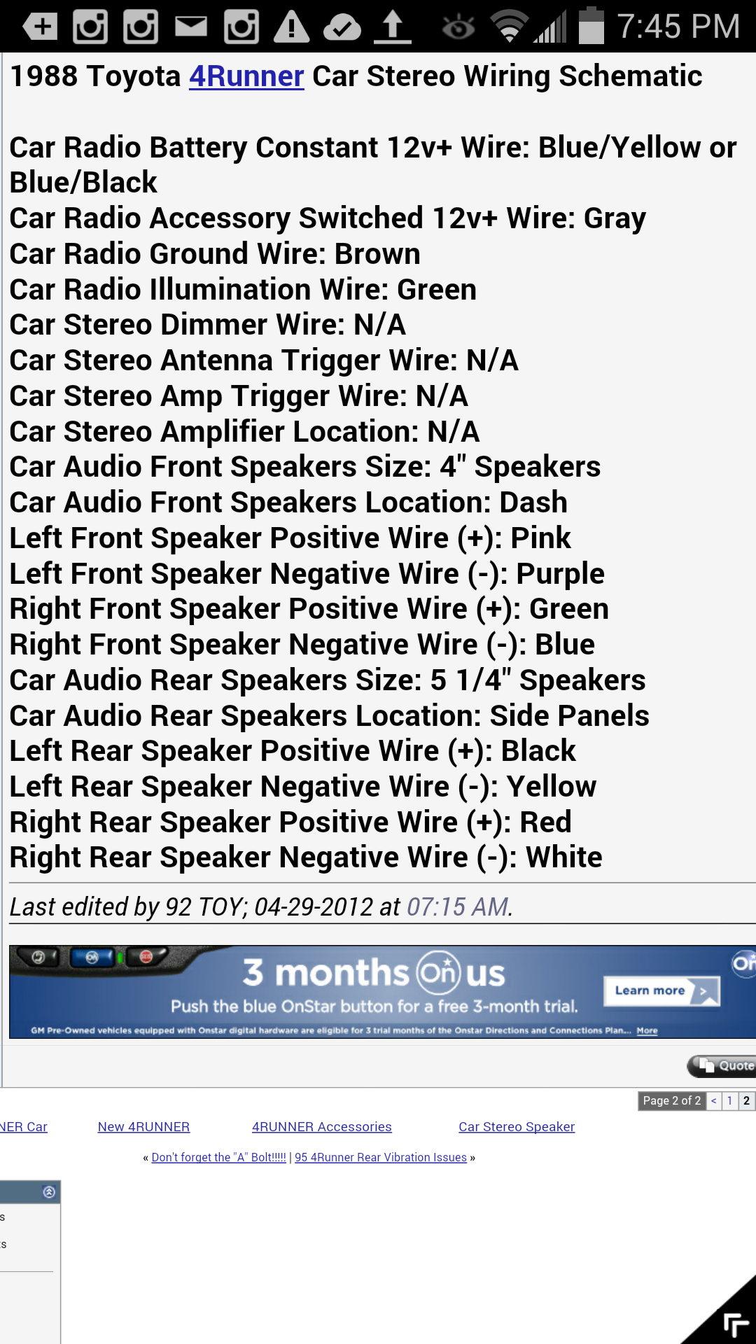

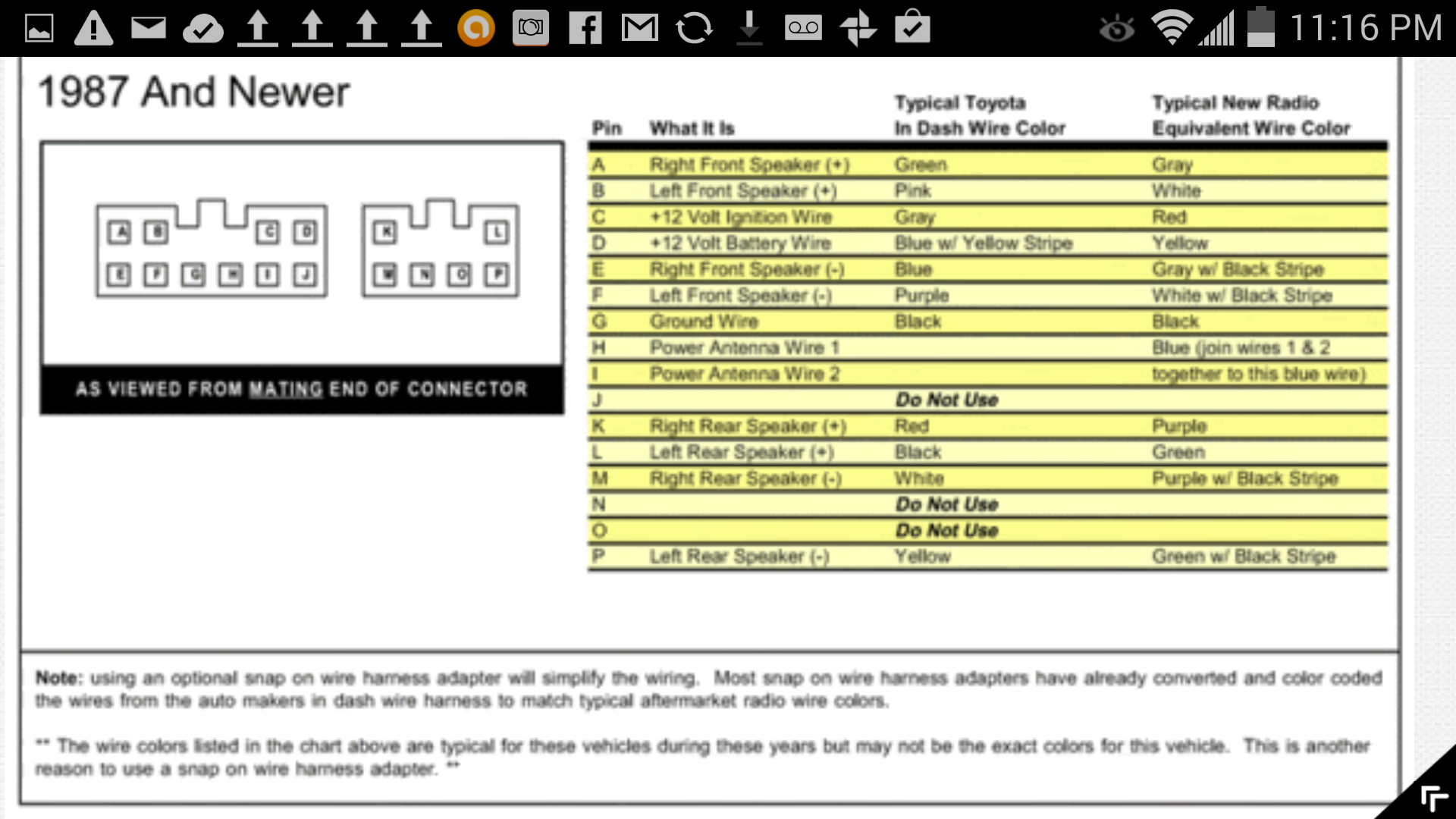

Little factory TOYOTA wiring information for anyone who might be interested.

Chef,
The Clock, Cig Lighter, Light Reminder Chime, mirrors, antenna and radio are all on the same 15A fuse.
have you checked the fuse?

yes the cig lighter is the fuse.
All you need for the radio is 12v constant (Haz/Horn fuse, wire Blue/Yellow stripe), 12V Ignition (Cig fuse, wire Green/Red stripe) and Ground (White/Black stripe). Make sure you are getting a good ground.
