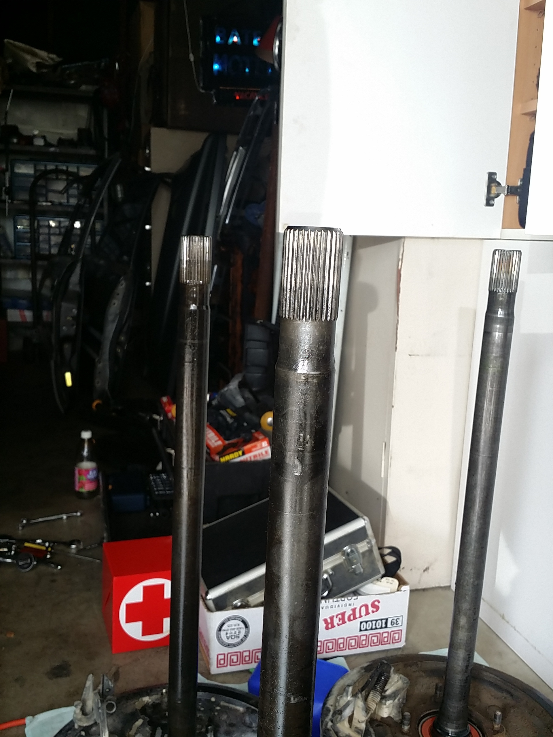

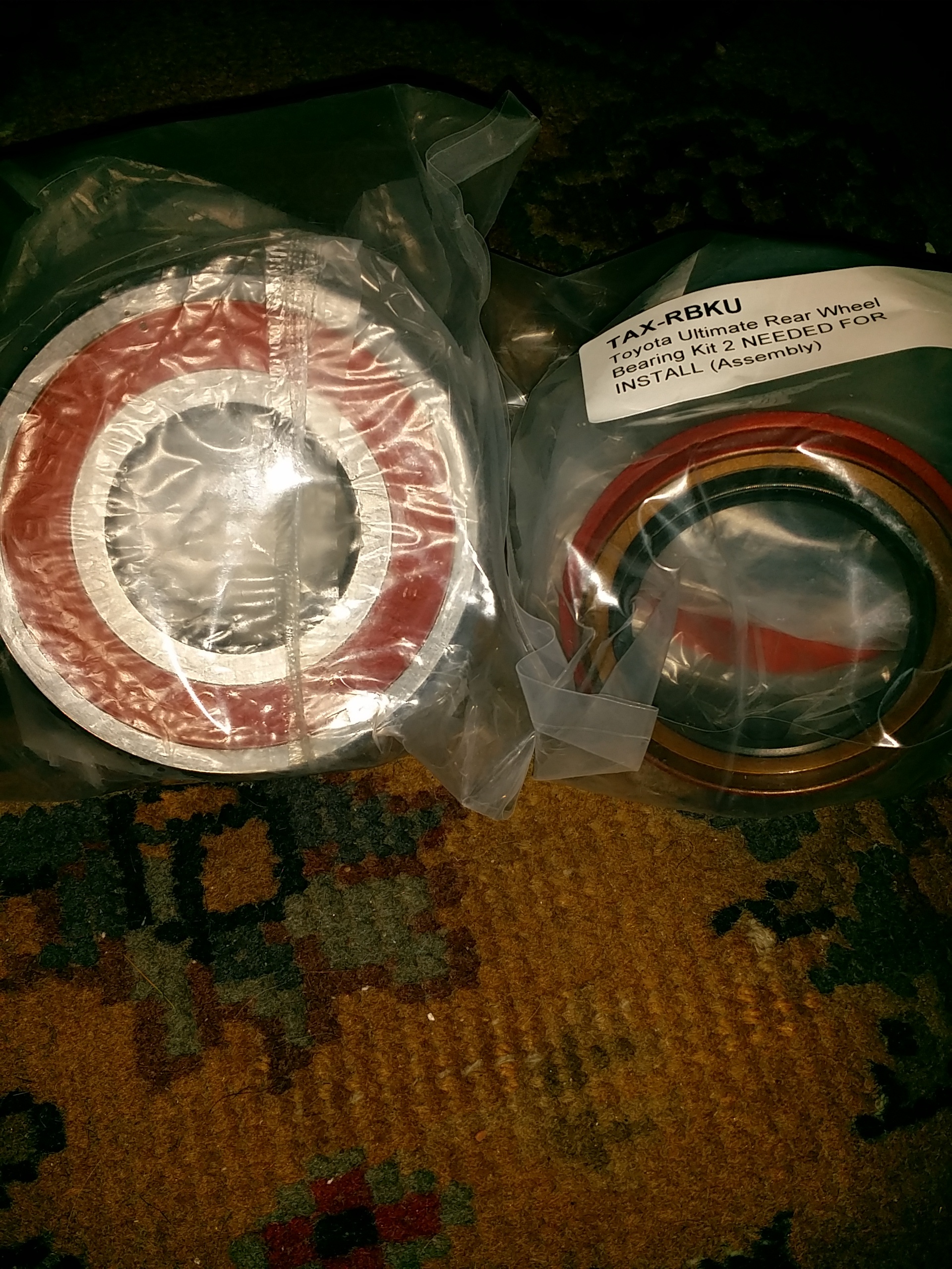

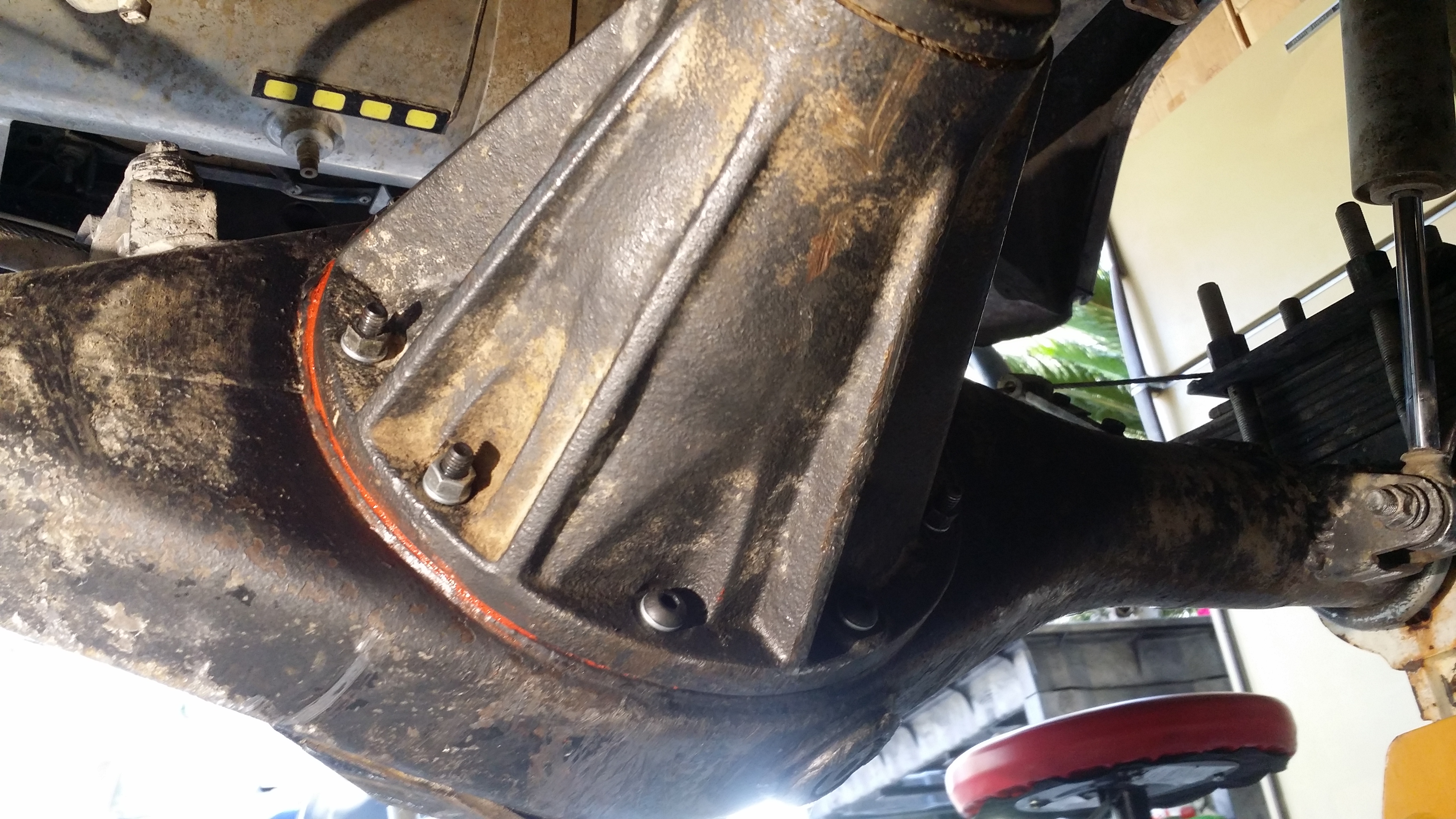

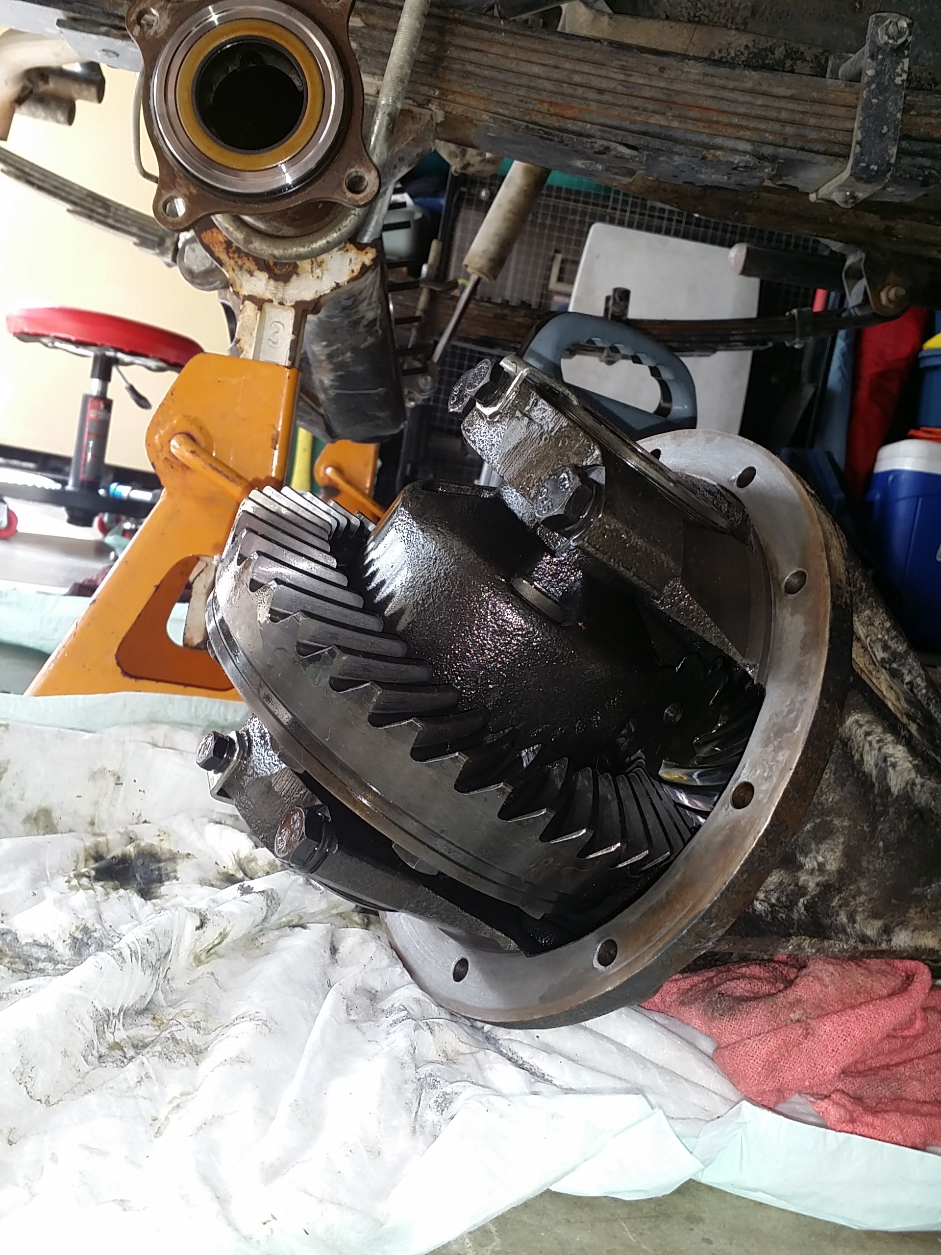

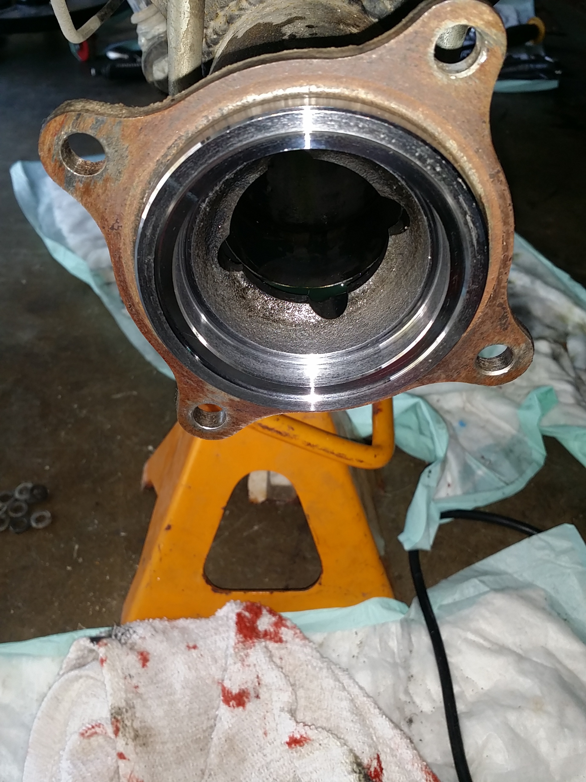

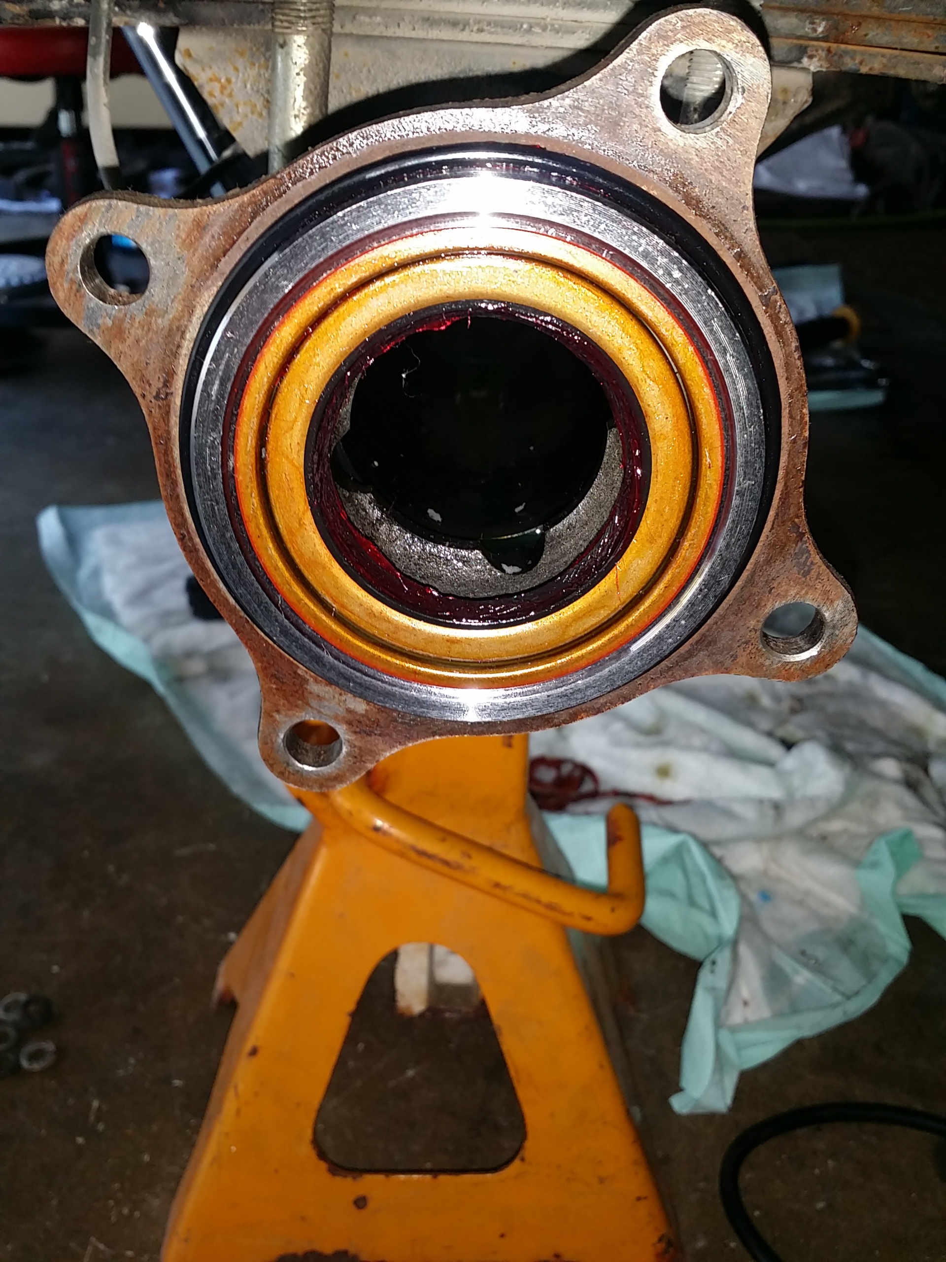

GOT MY rear 95 axles new LOWRANGEOFFROAD.COM premium KOYO & Marlin Kit installed and the original backing plates off mine, pressure washed and slapped on to these slightly longer 2nd gen 4 runner axles! ( at least 3/16s of an inch longer, which was supposed to make them stronger because they enter carrier splines deeper.....
I will get some pictures up ASAP. Camera is dead and I'm letting it charge and typing from my seat right now. Lol. I have lots of updates to do and I've just had no spare time to manage uploading to photobucket and all that. It's so much easier to just take a picture and click enter and post it up to Instagram all day long. Lol. I've learned and had so much more fun here, but I just had to cut back because it was consuming so much of my time and I was ending up with less and less time, from day to day, to spare.. Wahhhh, I know, I know! Lol....
Lots to share in the personal life as well, and hopefully I can get back here as quickly as possible. Just wanted to share what was currently going on
Old Mar 1, 2015 | 10:04 AM
  #524
ChefYota4x4's Avatar
iTrader: (5)
Posts: 19,281
Likes: 20
From: Lake Havasu, AZ

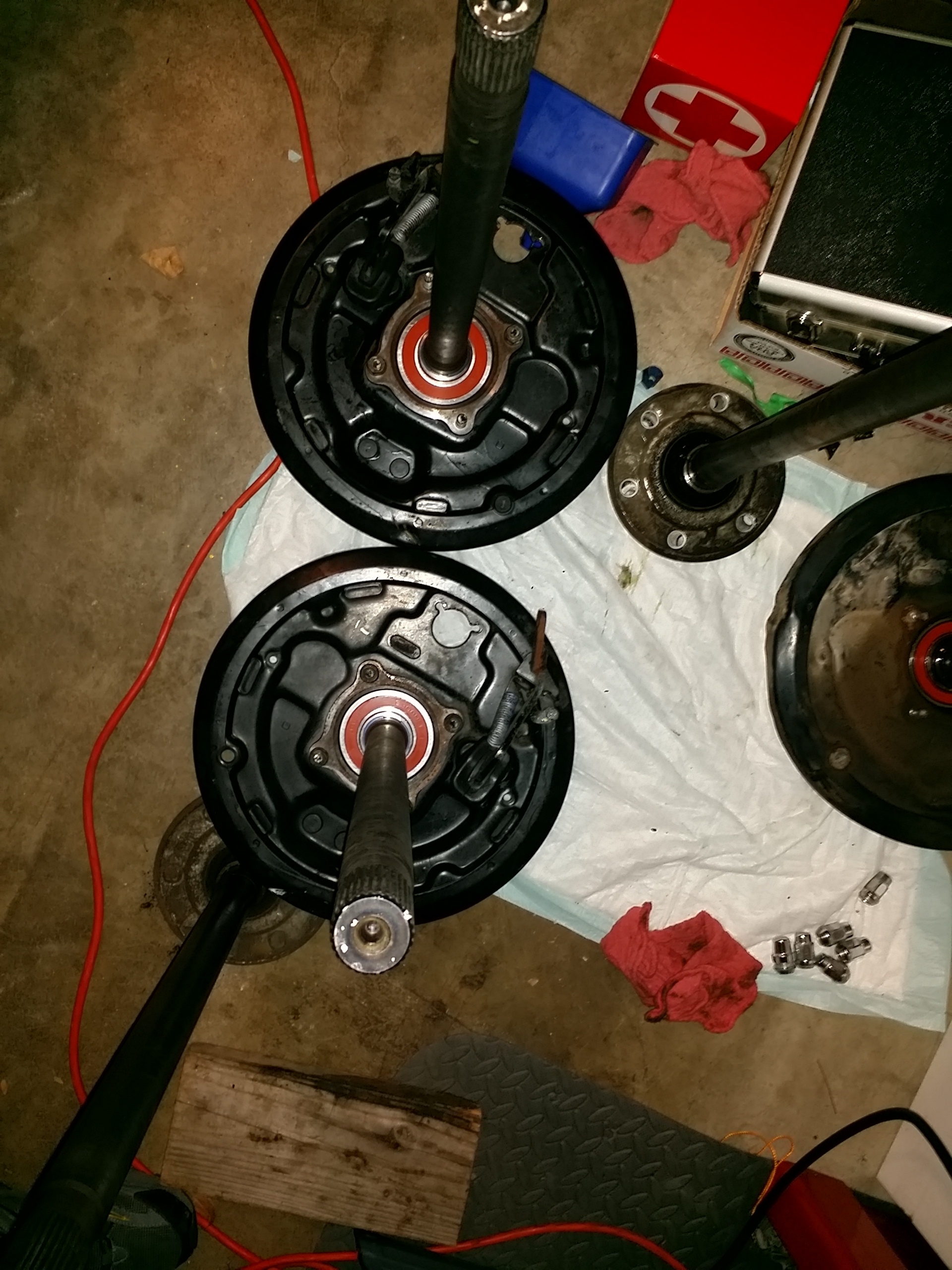

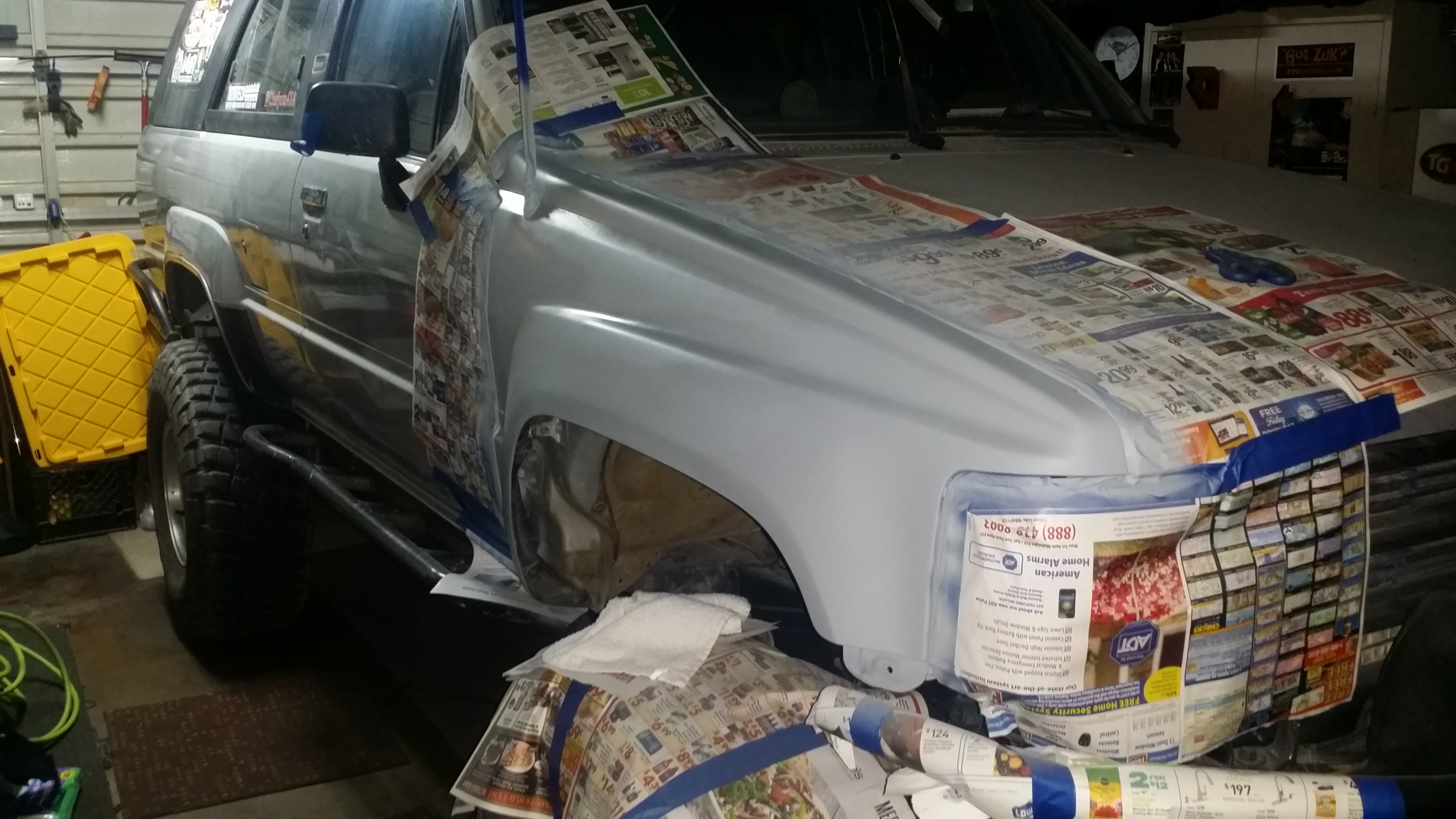

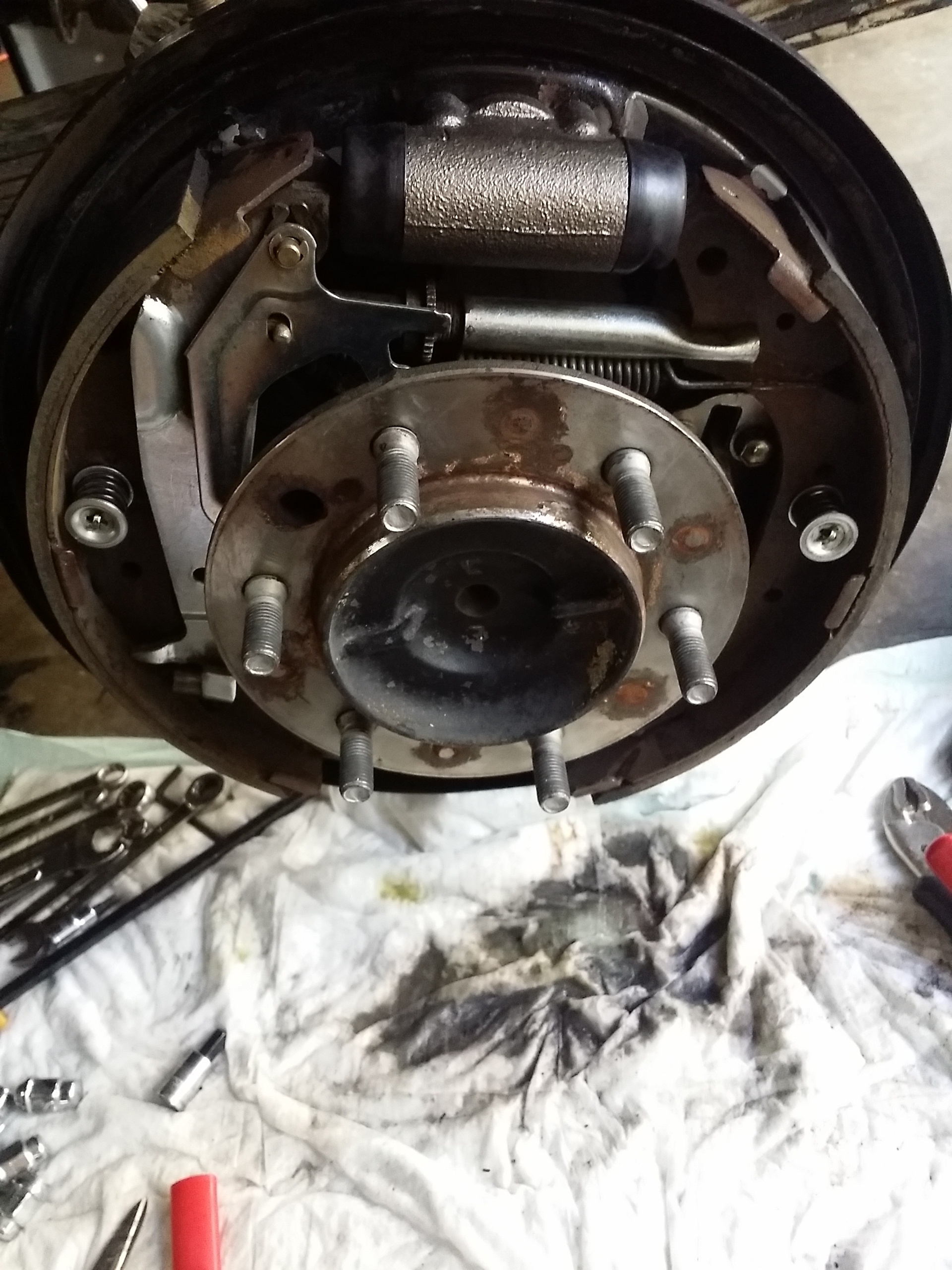

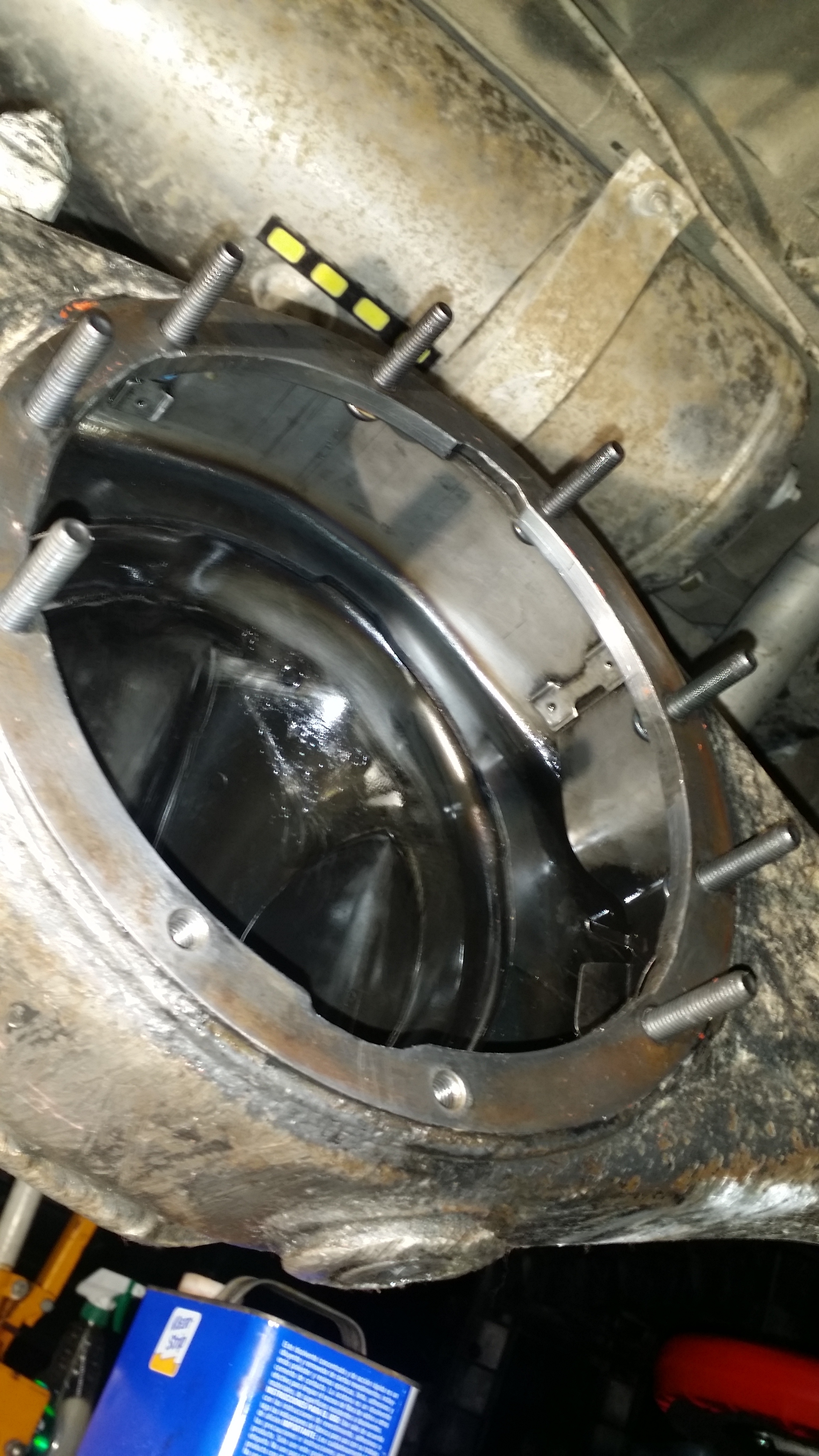

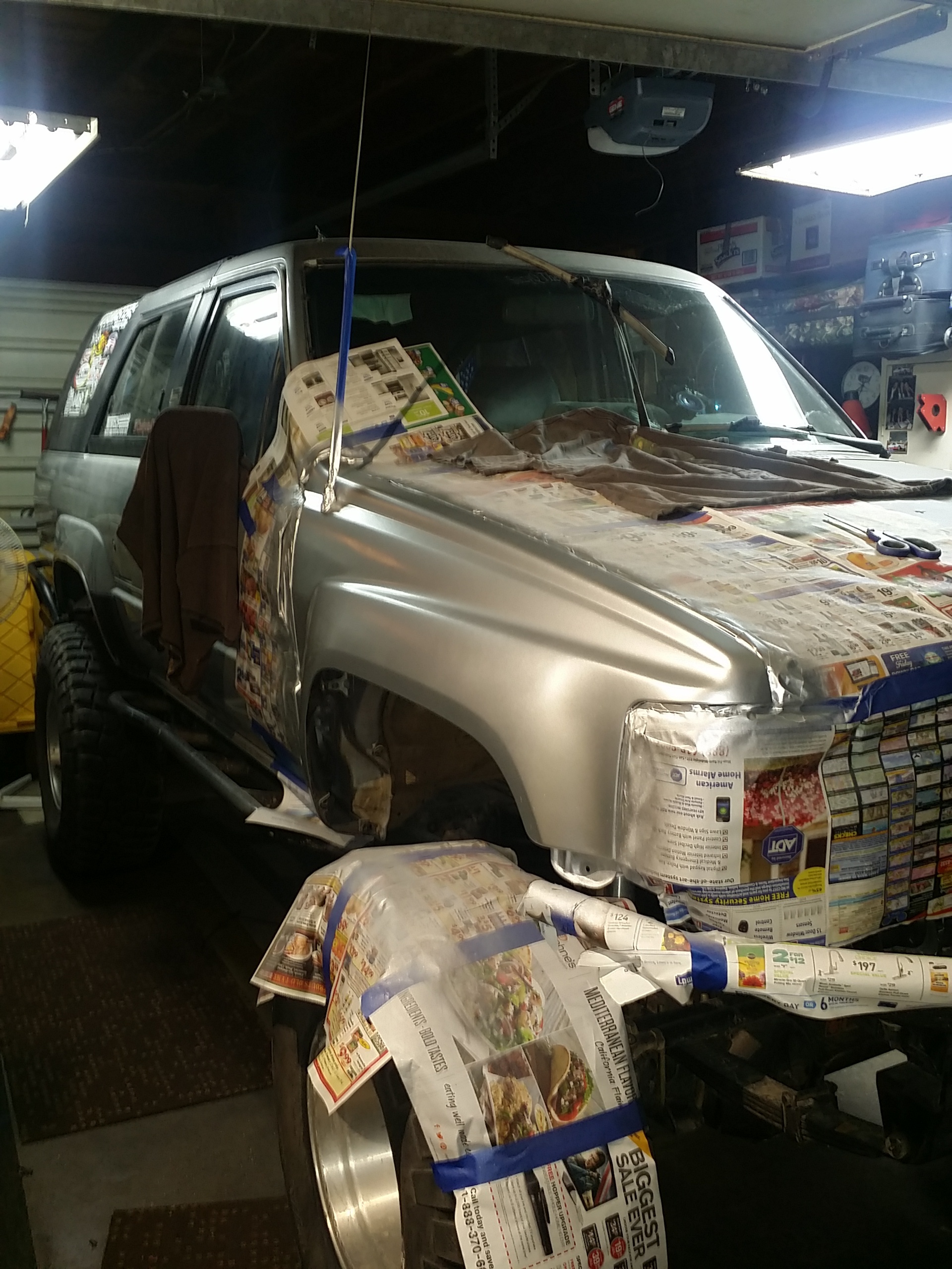

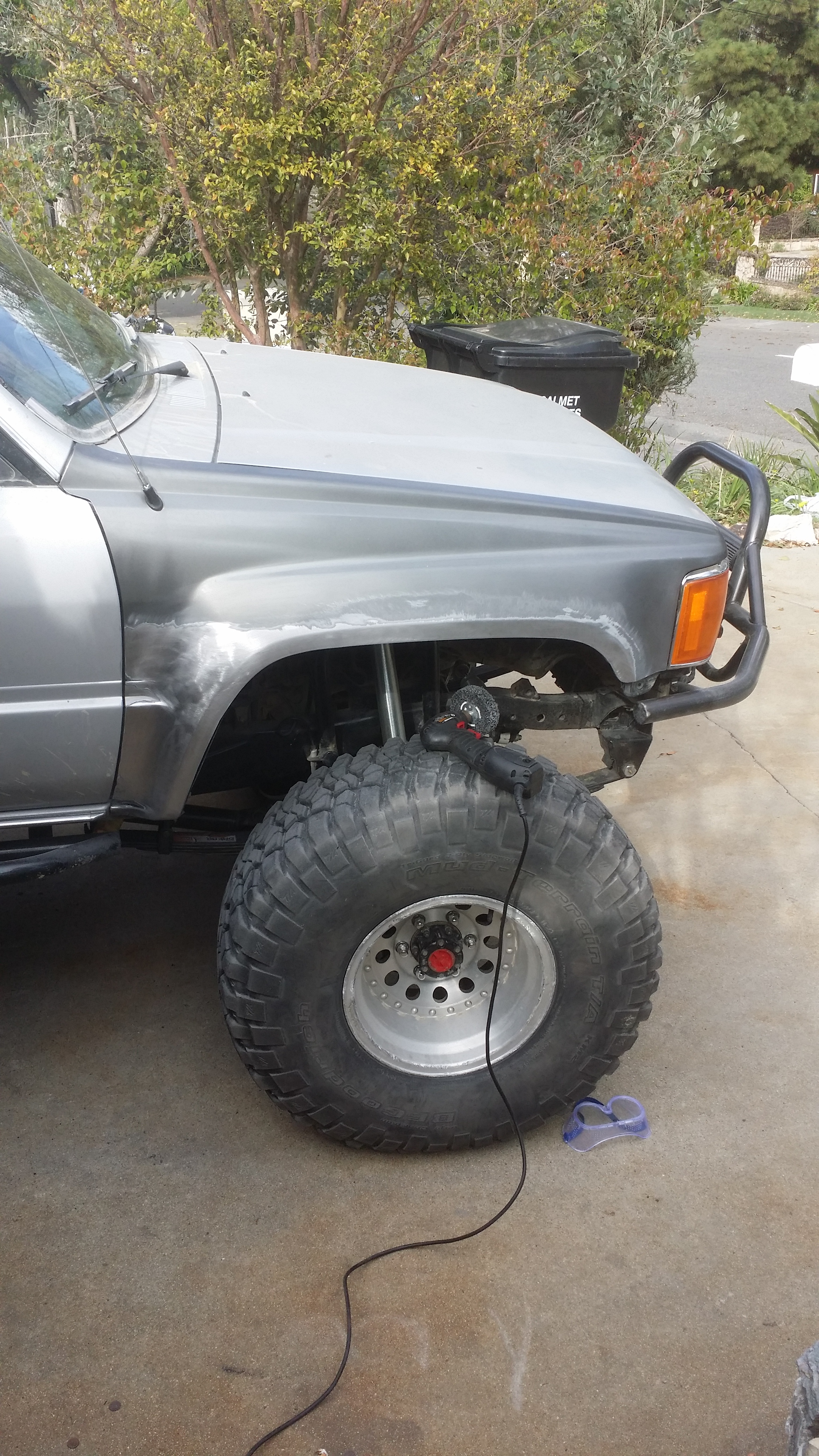

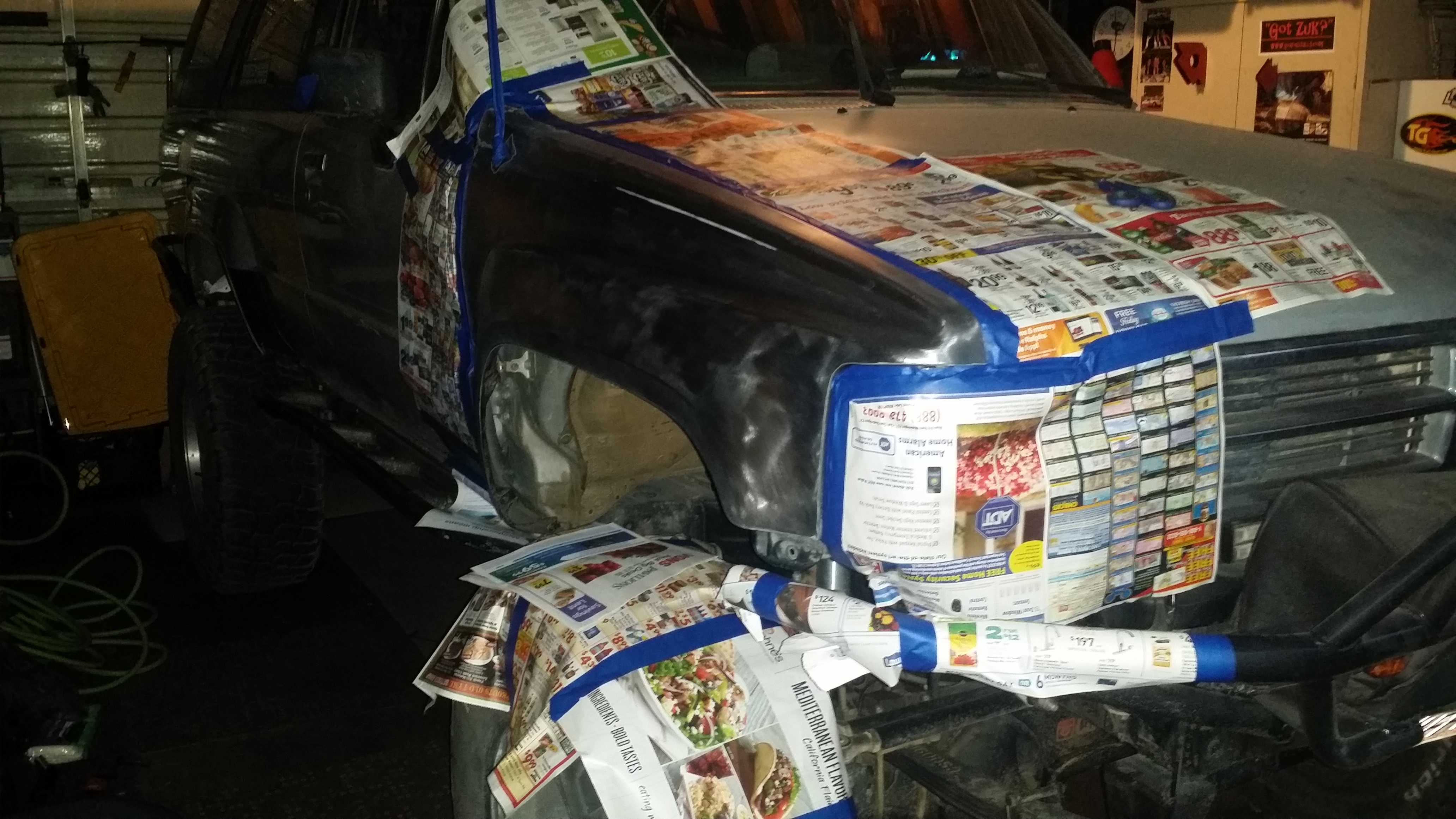

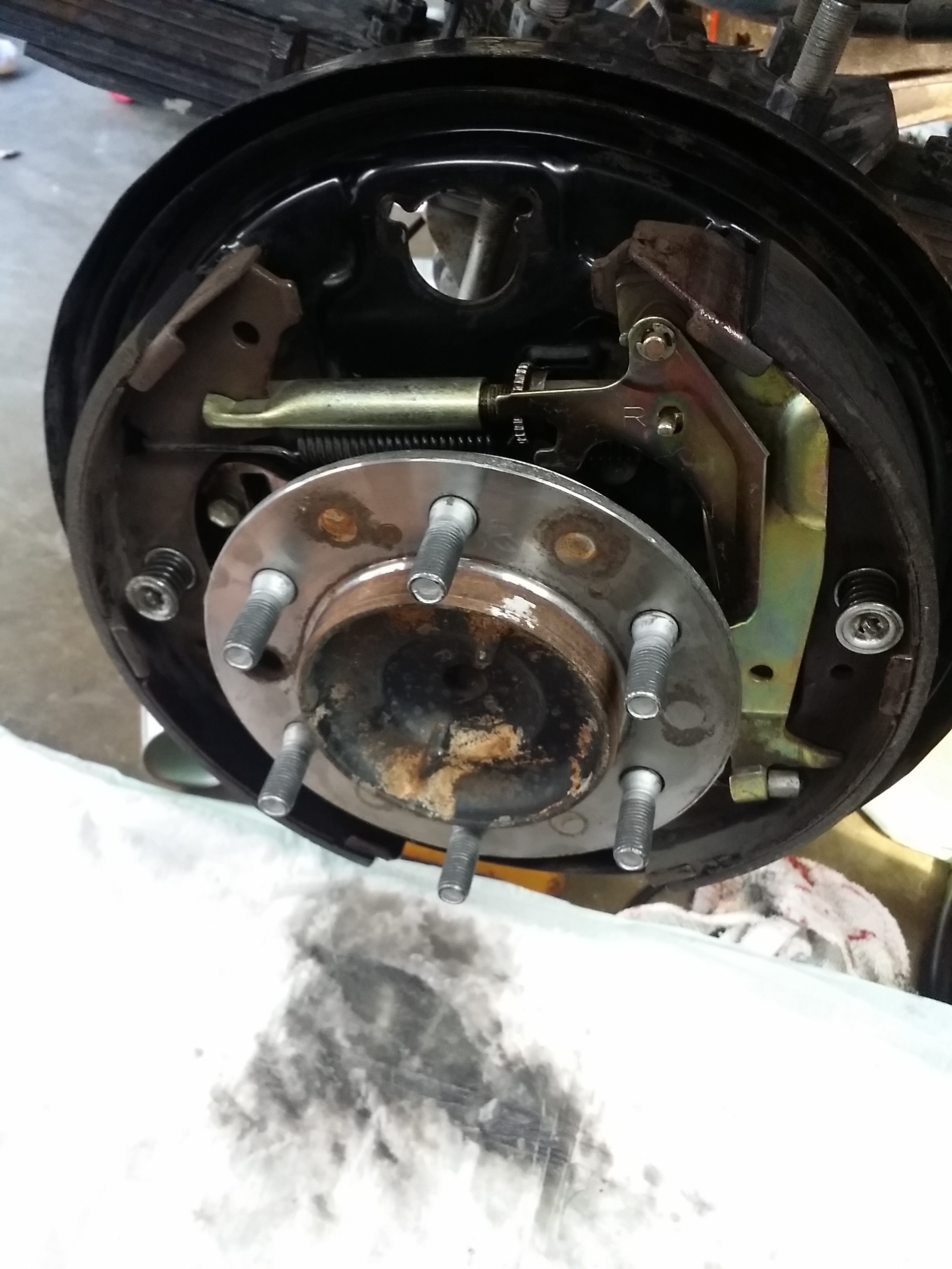

Refreshed rear 95 4runner axles and swapped backing plates to mine, new Advics wheel cyls, replaced and crappy but ok stripped and painted front pass fender......and had driveshaft repaired and added a shortened spare to the trail repair goodies list, and button head 13.9 bolts in the rear new TG V6 w/ Detroit diff..... HOLLA! Lol...

Slightly longer 95 4 runner axles in the foreground.....

Done....

All cleaned up and new wheel cylinders in and bled as well.....

Button head M8 x 1.25 x 40Mm bolts and bottom 2 as flush bolts, done.....
Prep and paint....

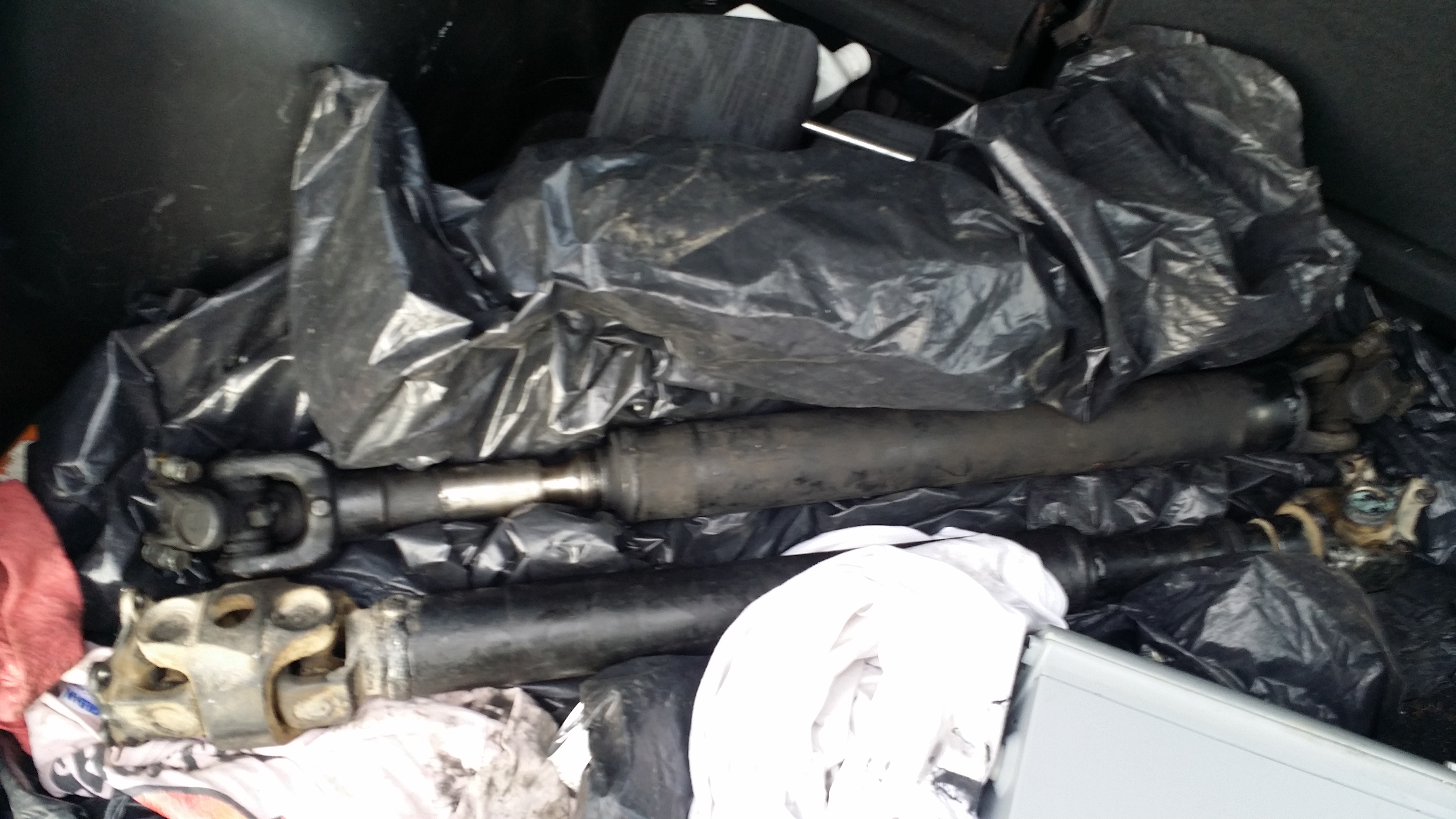

Drive shaft repaired and donors shaft shorten and balance for dual cases in the rear

Glad to see you got the runner fixed. I had not realized the 95 axles were that much more beefier. Looks like a big difference. I was able to get on the wife phone and take a look at Instagram and seen you do have quite a bit going on and it is looking good. Still really haven't figured the Instagram thing out and will be sometime before I ever move over to it as I always a little behind the times on technology.
I see on the 95 axle the brake adjuster is on top and here I am thinking I may have finally figured out how to do rear brakes. Rear brakes have always been a problem for me. A Chinese puzzle would be easier for me to figure out. Those rear brakes look great as well.

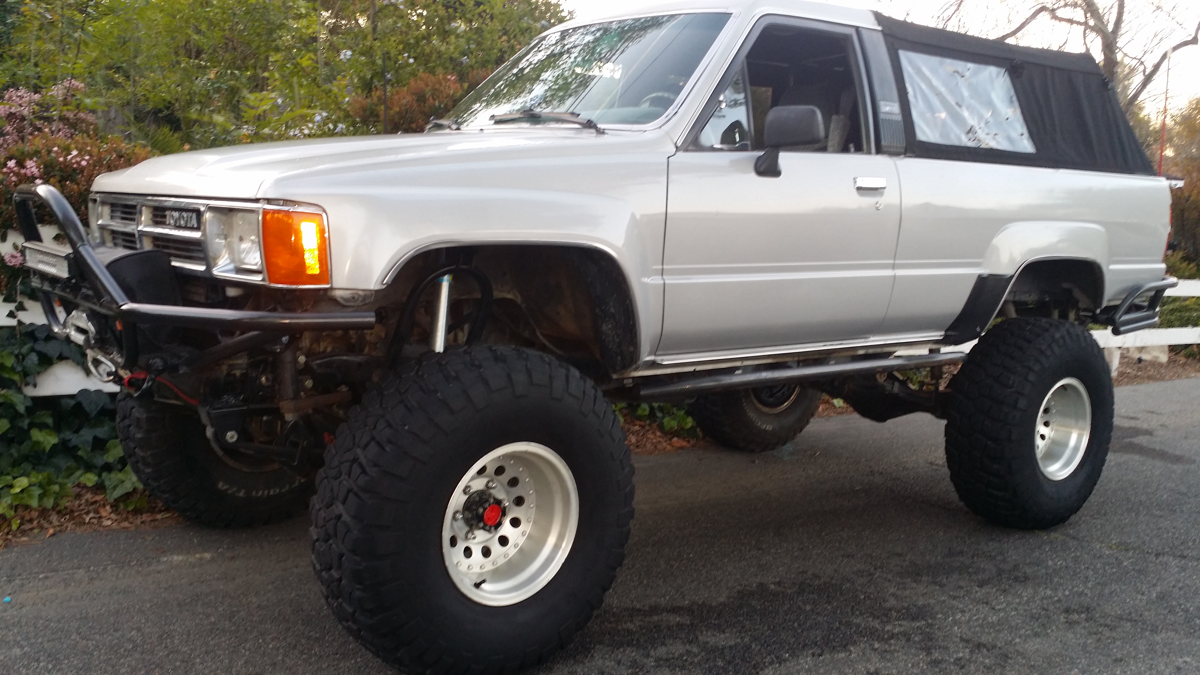

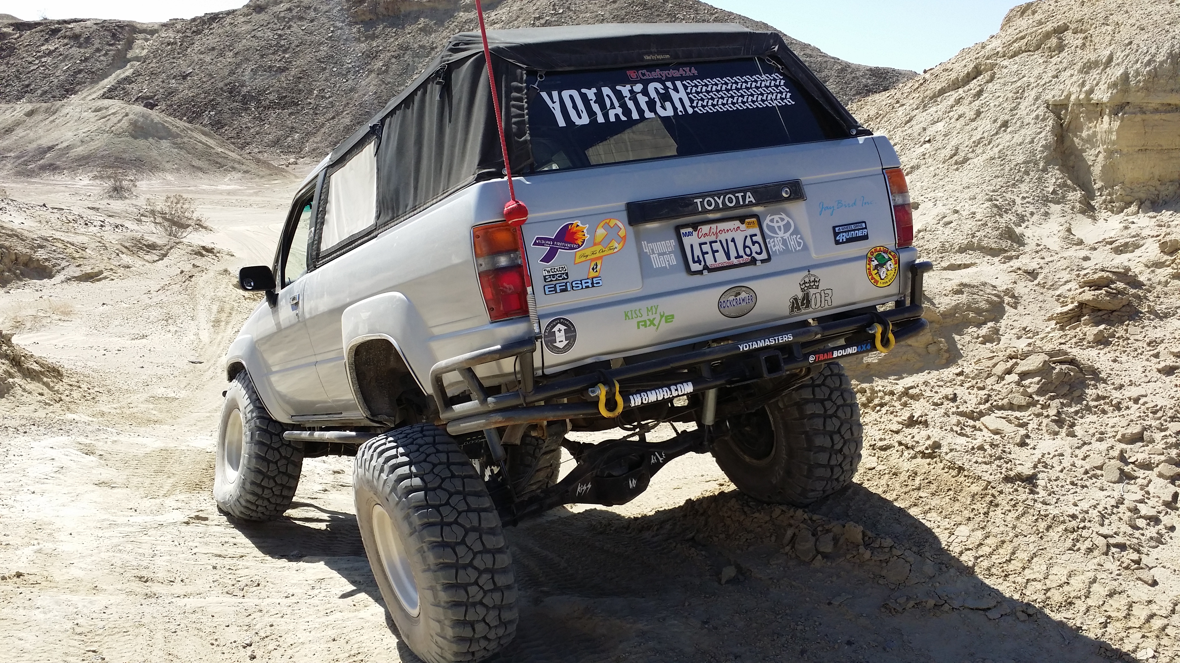

YOTATECH REP'n, and Killertoytops.com full top on for TDS 2015! ( if I can actually go of course. Try my best).....

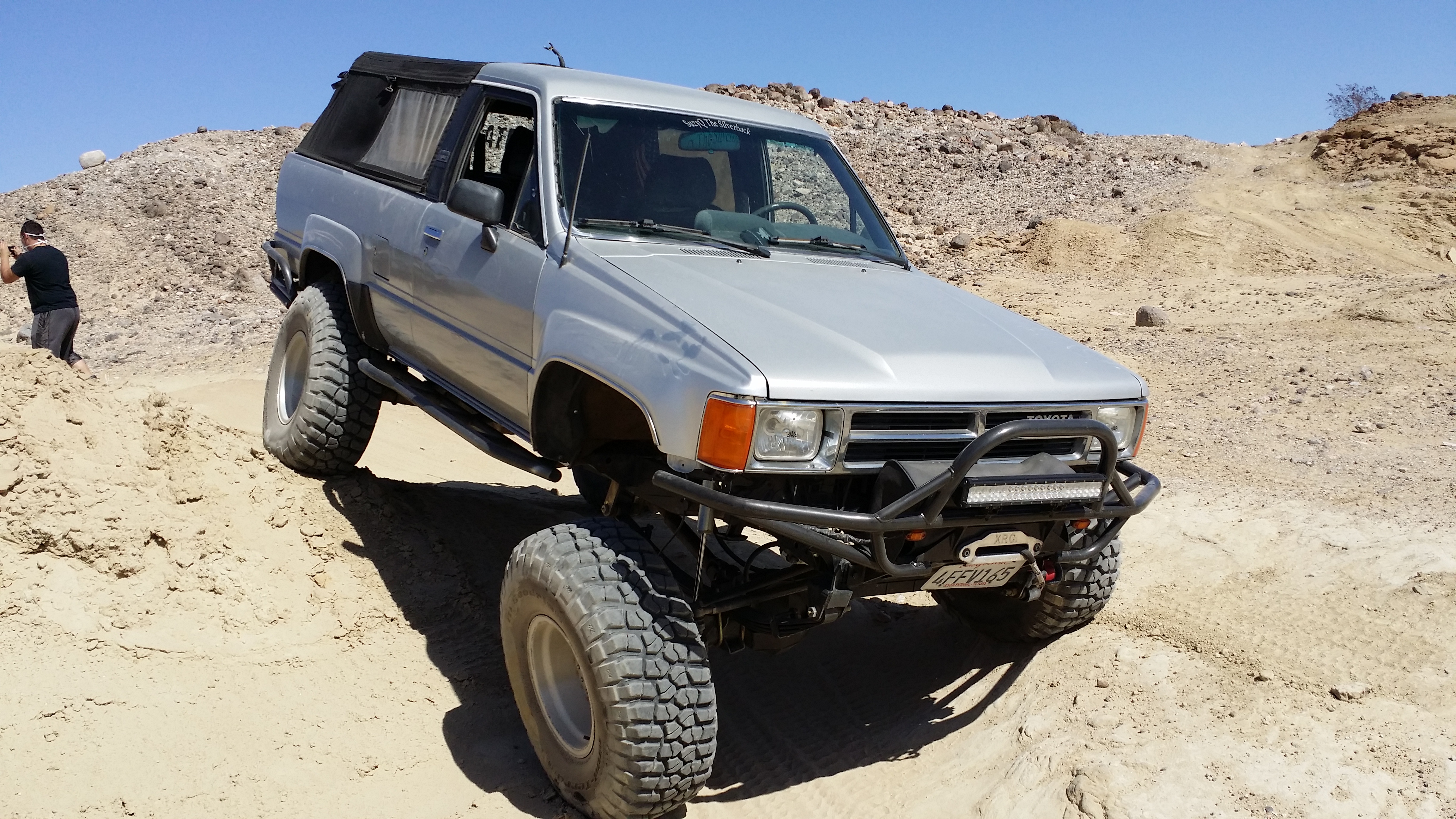

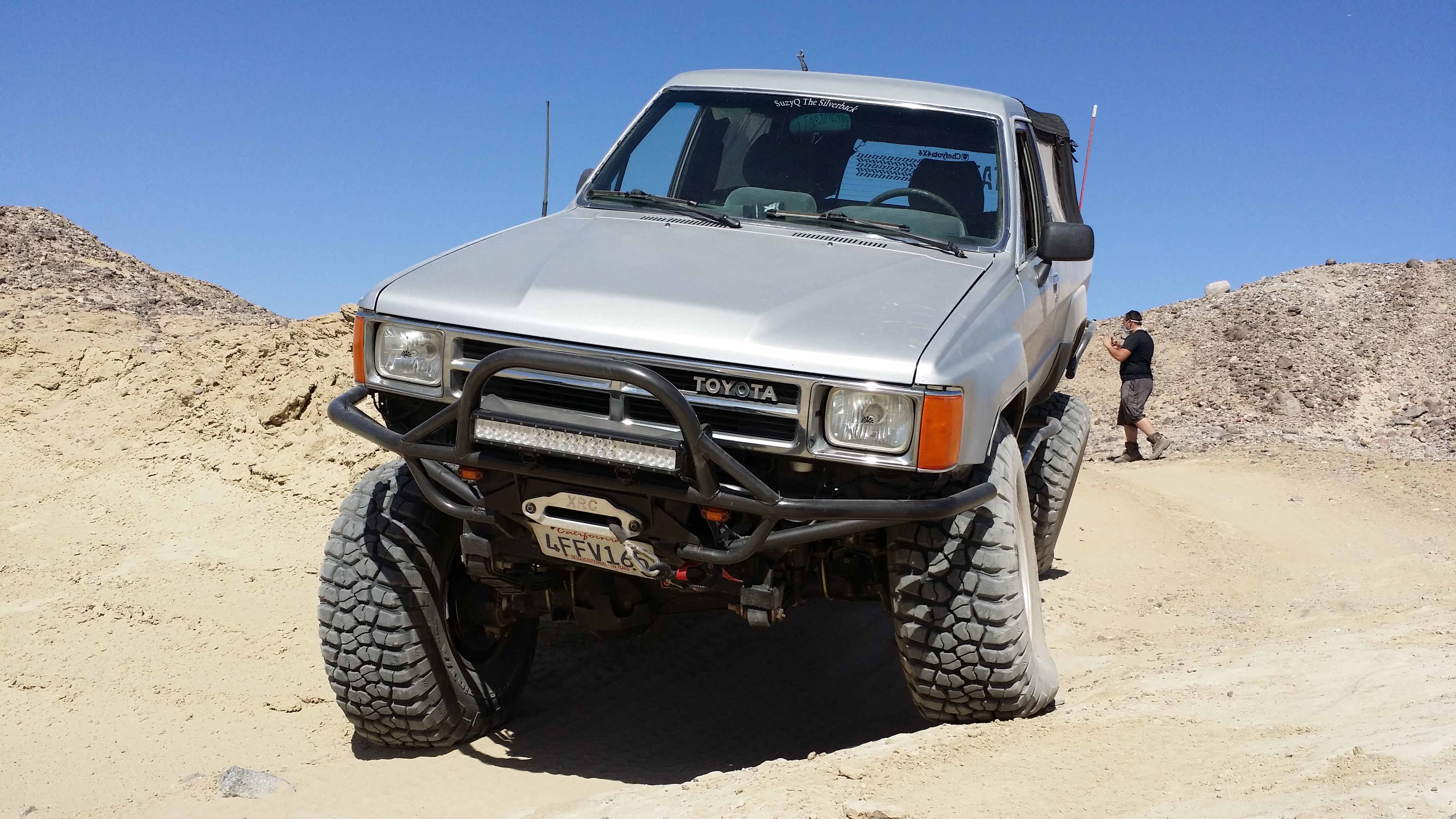

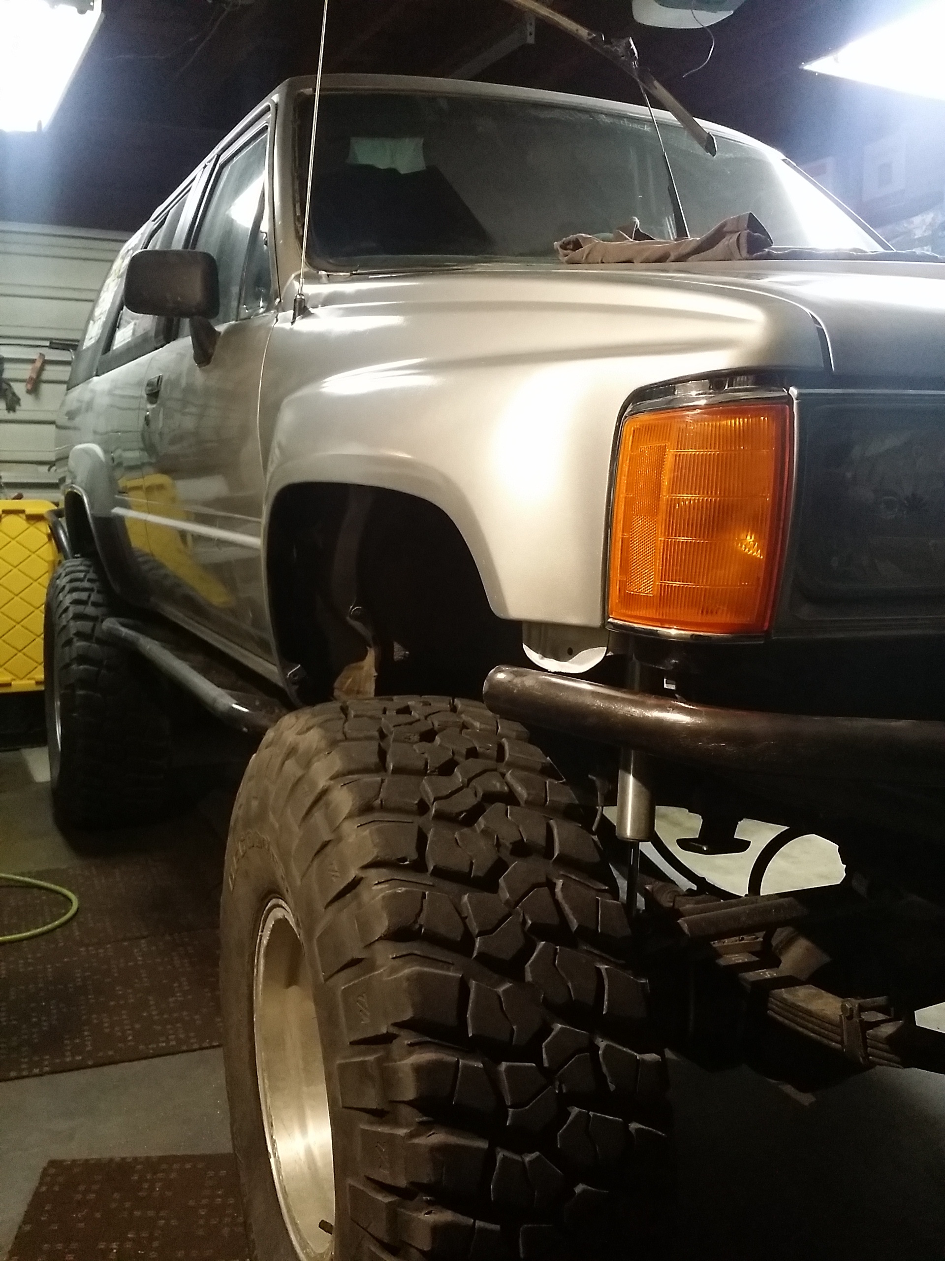

Stuffin 35x12.5x15 's up front now thanks to the fabbing to get 14's up there..... Still had more shock to go!

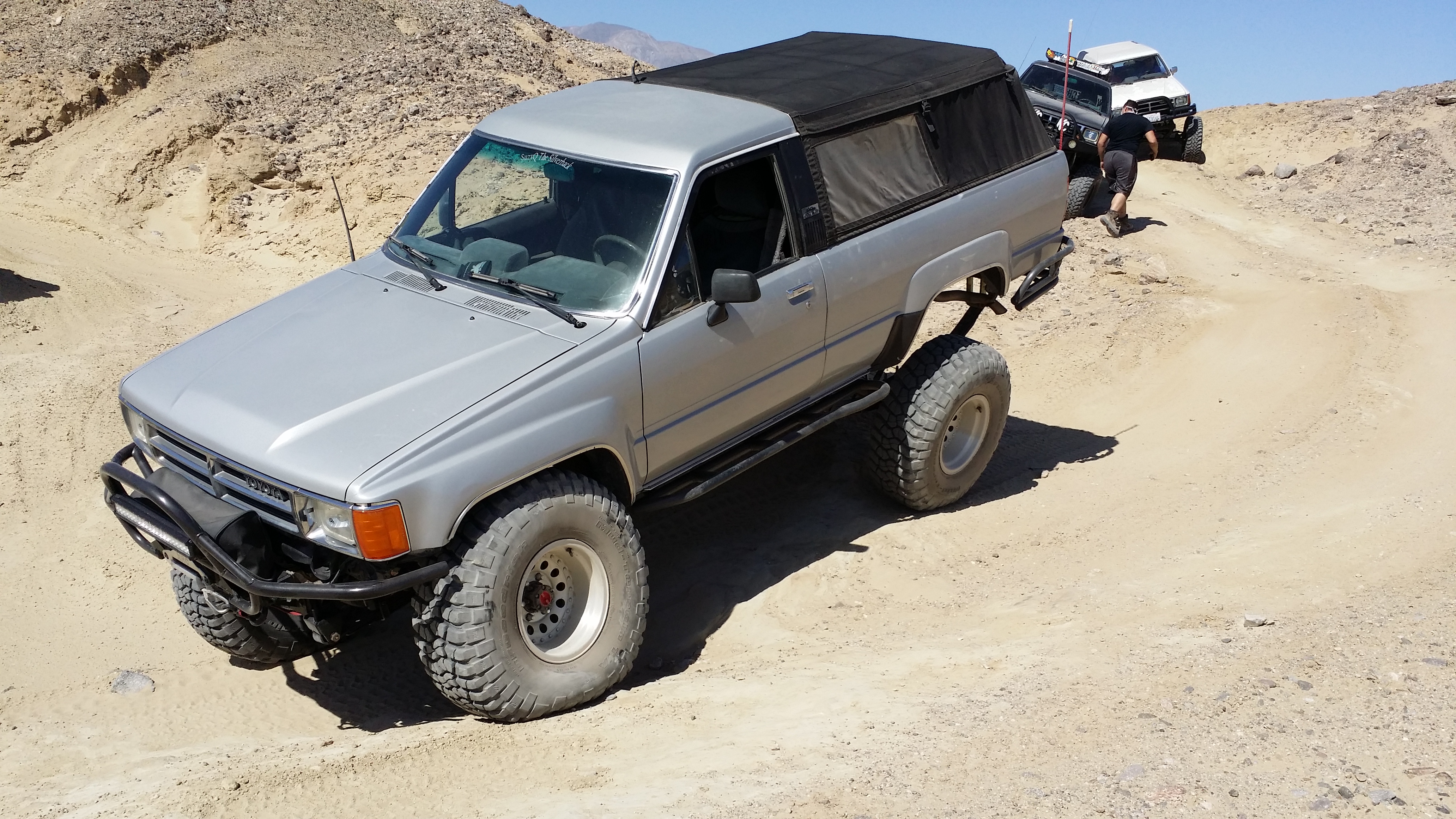

All at Tierra del Sol event 2015..... With redeth005 and his neighbors Chris and Pops, Ruben (+2 buddies and Faby, redeth005 's lady)
I have more, I will post later. I didn't get very many this trip because my phone acted up and I didn't bring my Canon D
