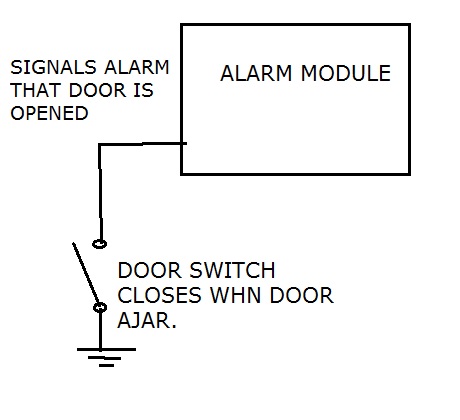

Review what we talked about, I do not think the alarm could take ground from the door ajar switch. If it did, alarm would never make a sound IF door were closed. I think that tap to door ajar switch is a sensing input. When door ajar, switch is closed, grounding that input pin and telling alarm that door was opened, when it was not supposed to be. Looks like this:
Best way to test siren is to measure voltage between 2 wires across it. May need to strip tiny section of the insulation or prick each wire with pin. Use pins as test probes. Seal pin holes when done.

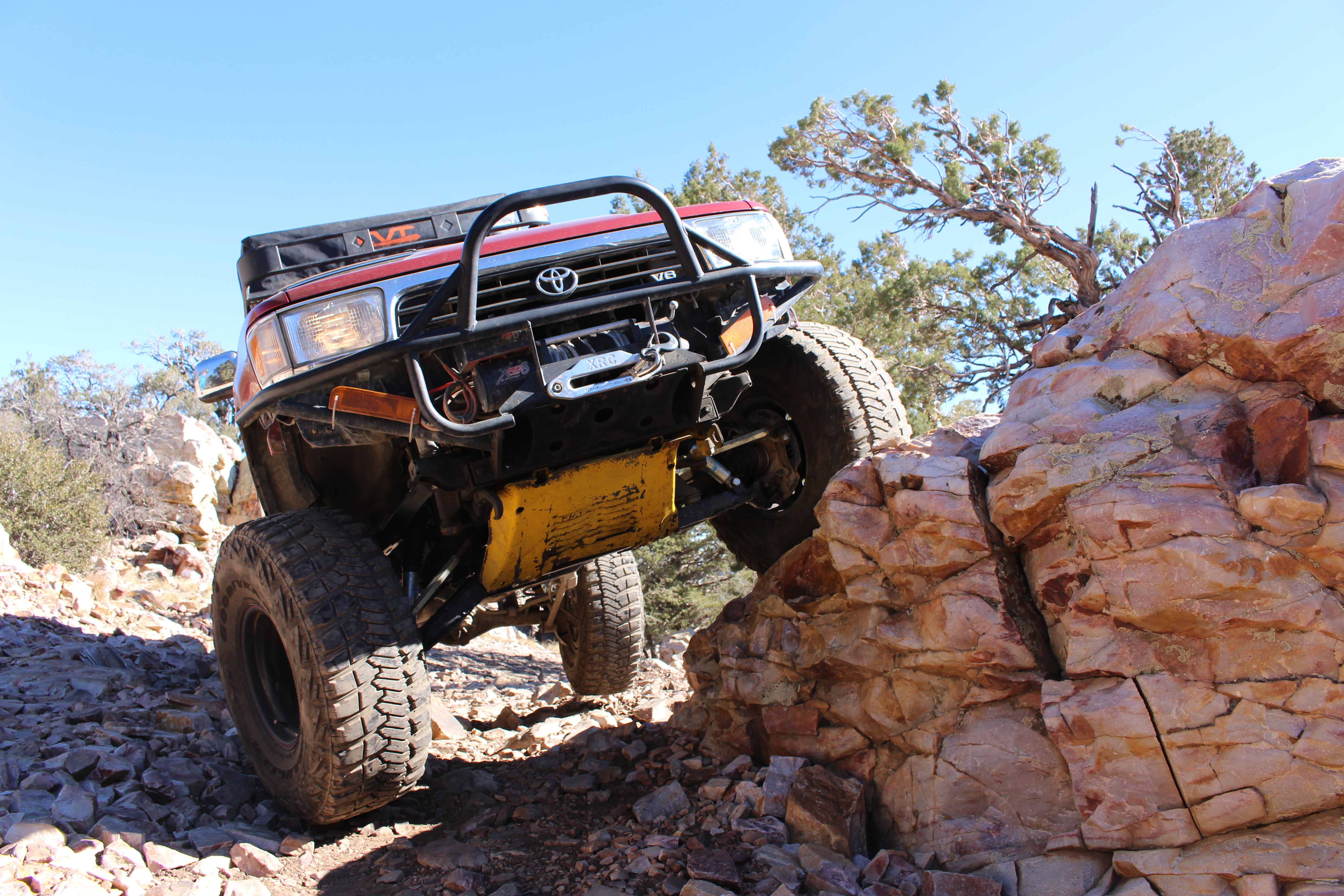

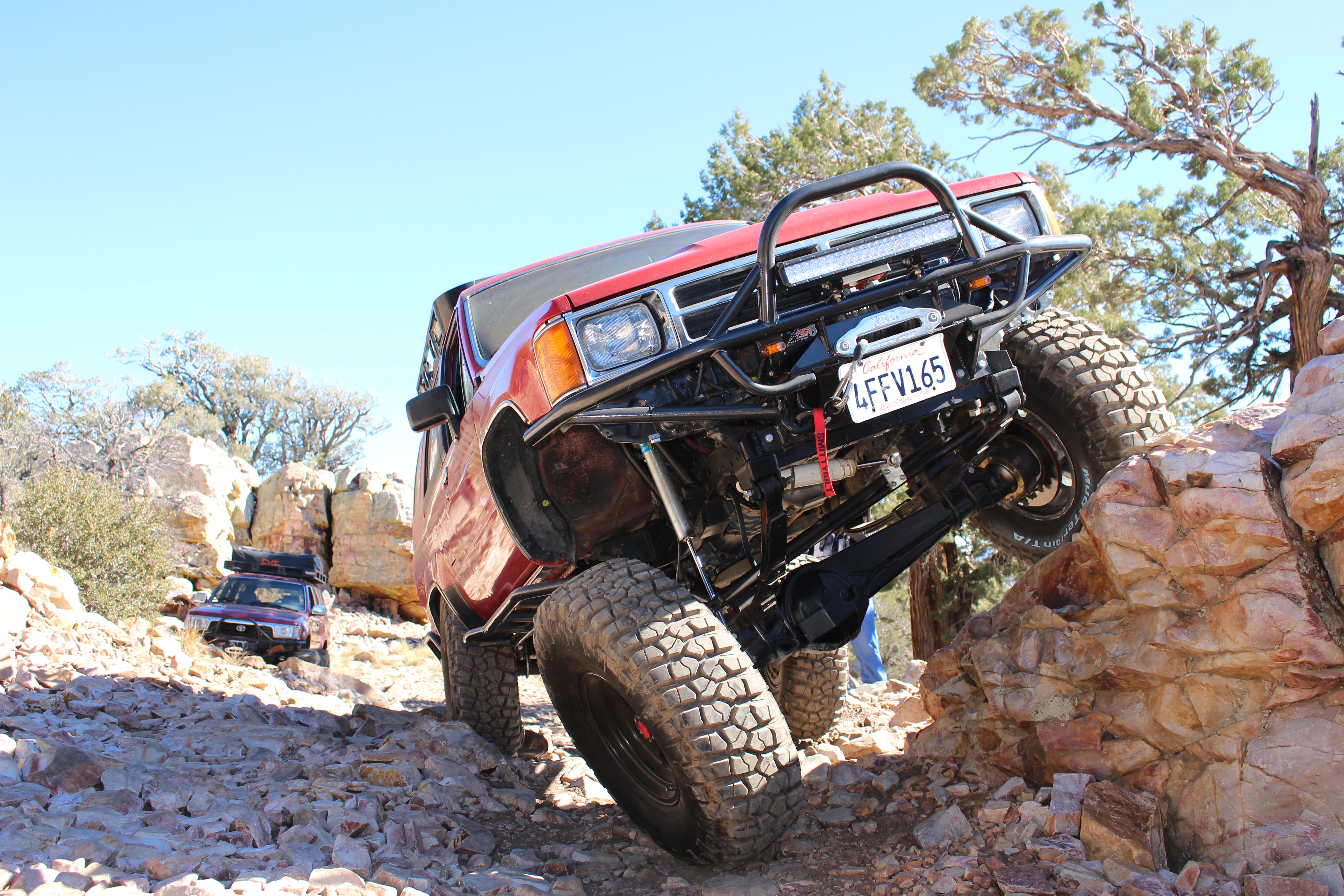

Teaser of Big Bear... LOTS more coming!

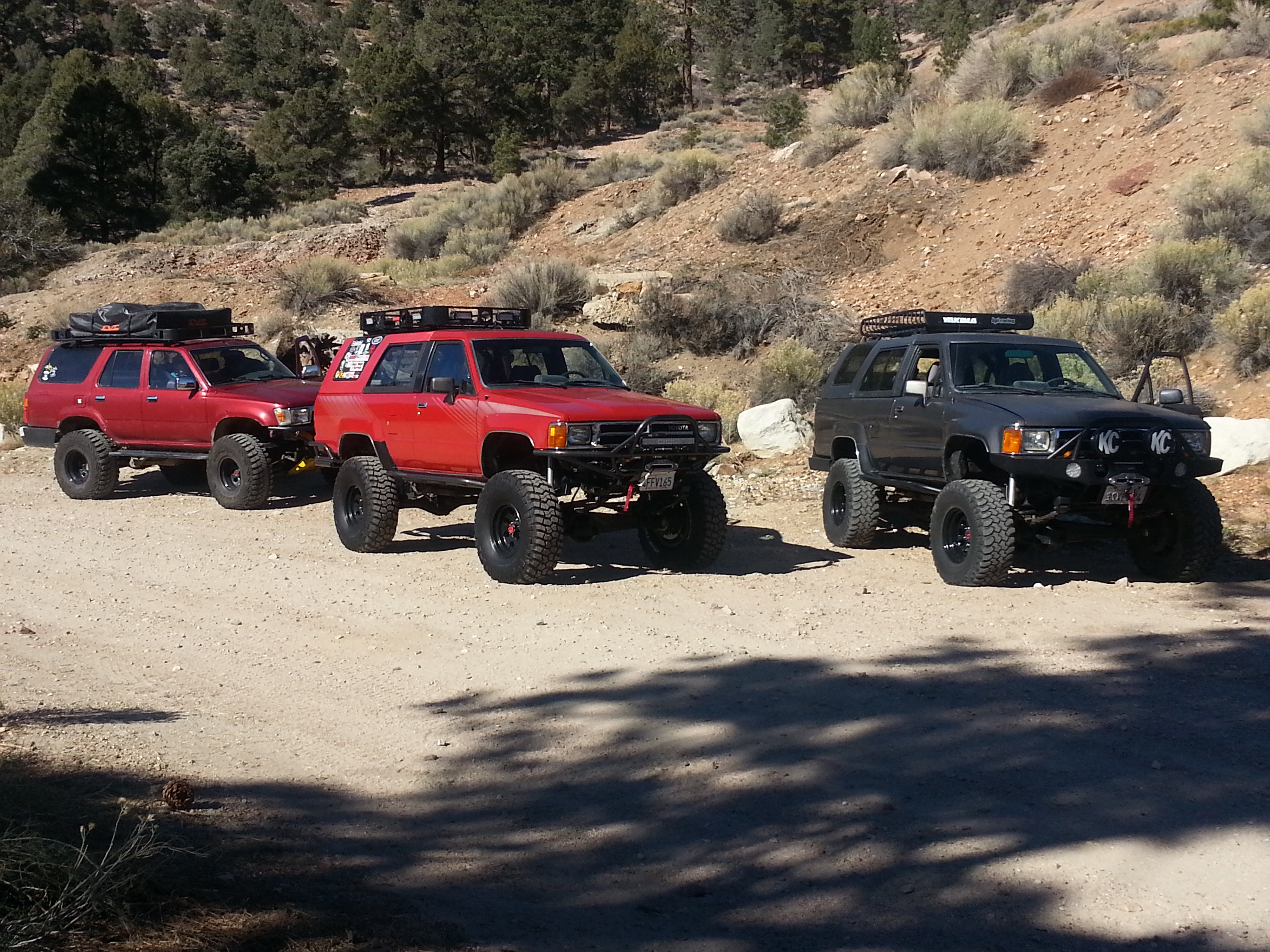

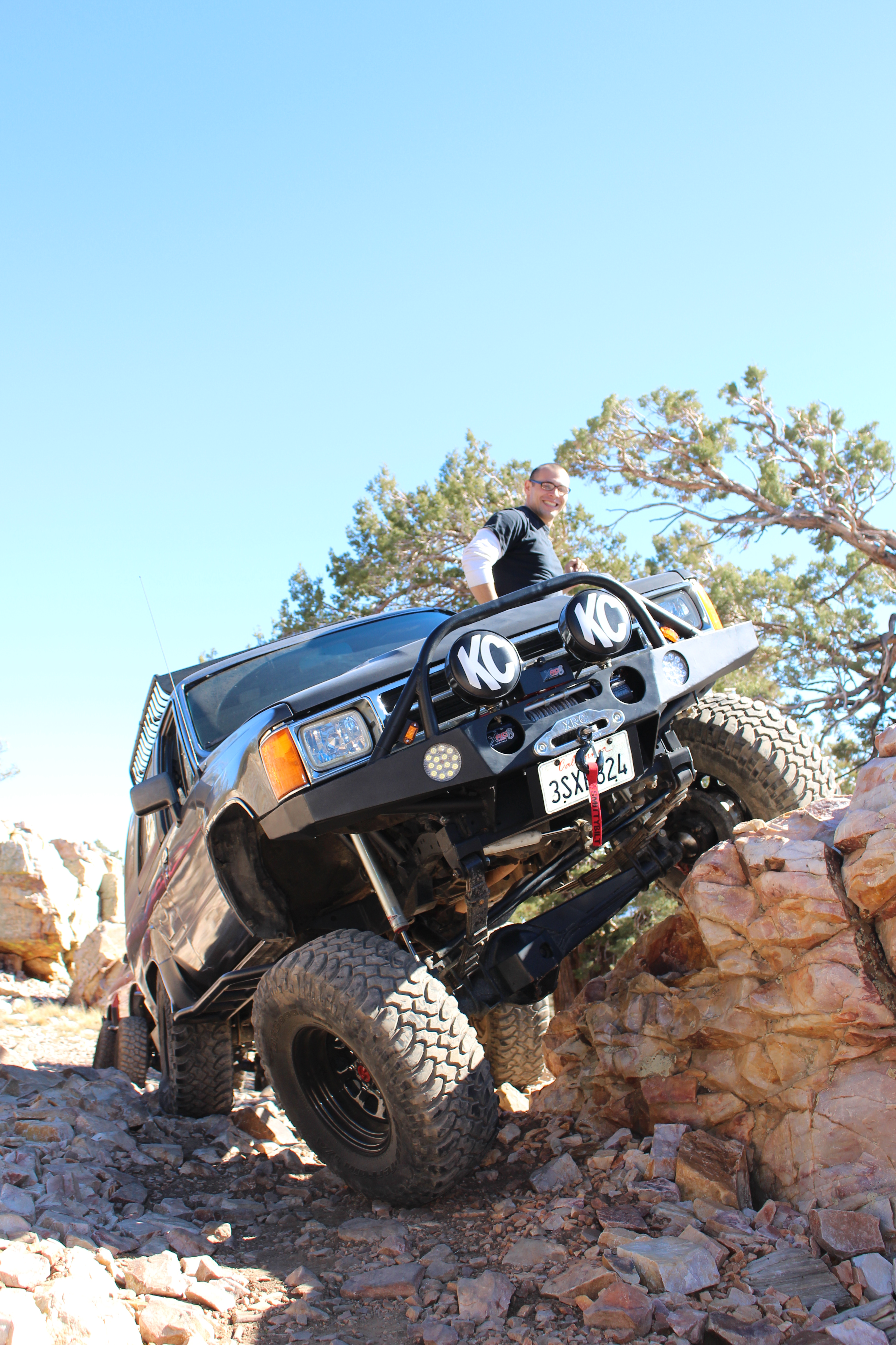

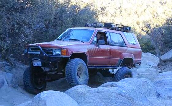

Red Wagon sporting his sweet blaze land kit....
Chefyota4x4....
Redeth....
There ya go, Red, lol.... I only abstained from posting more at the moment because I was going to do them all each of us individually, and three separate sections. Same with the video, saying your name and then showing that beast through all that stuff... Then Richard, then myself...
