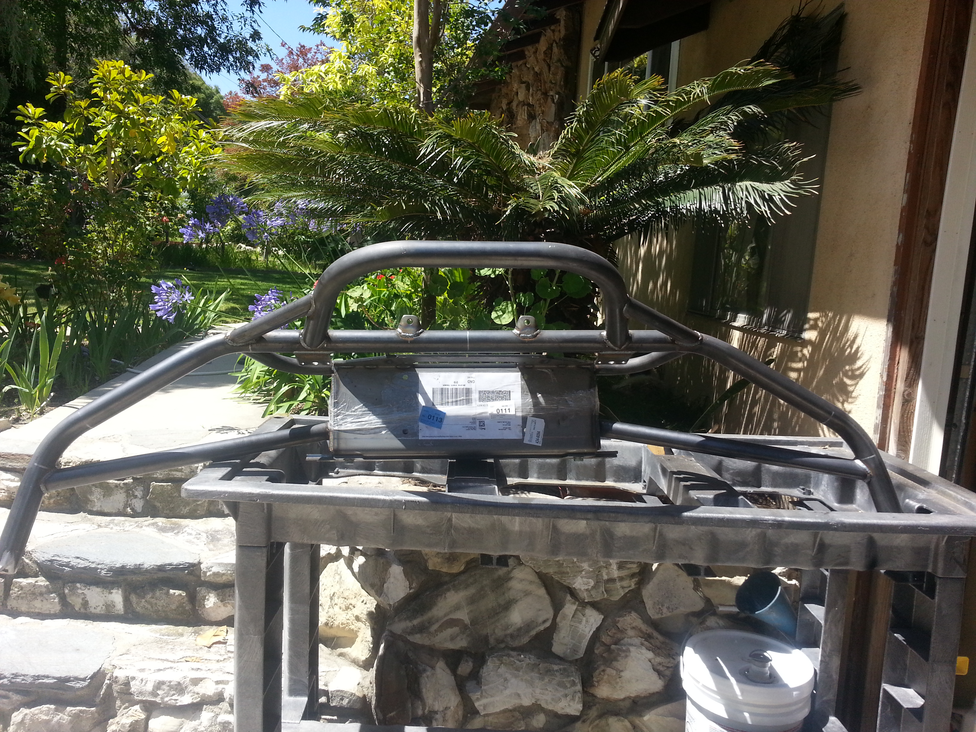

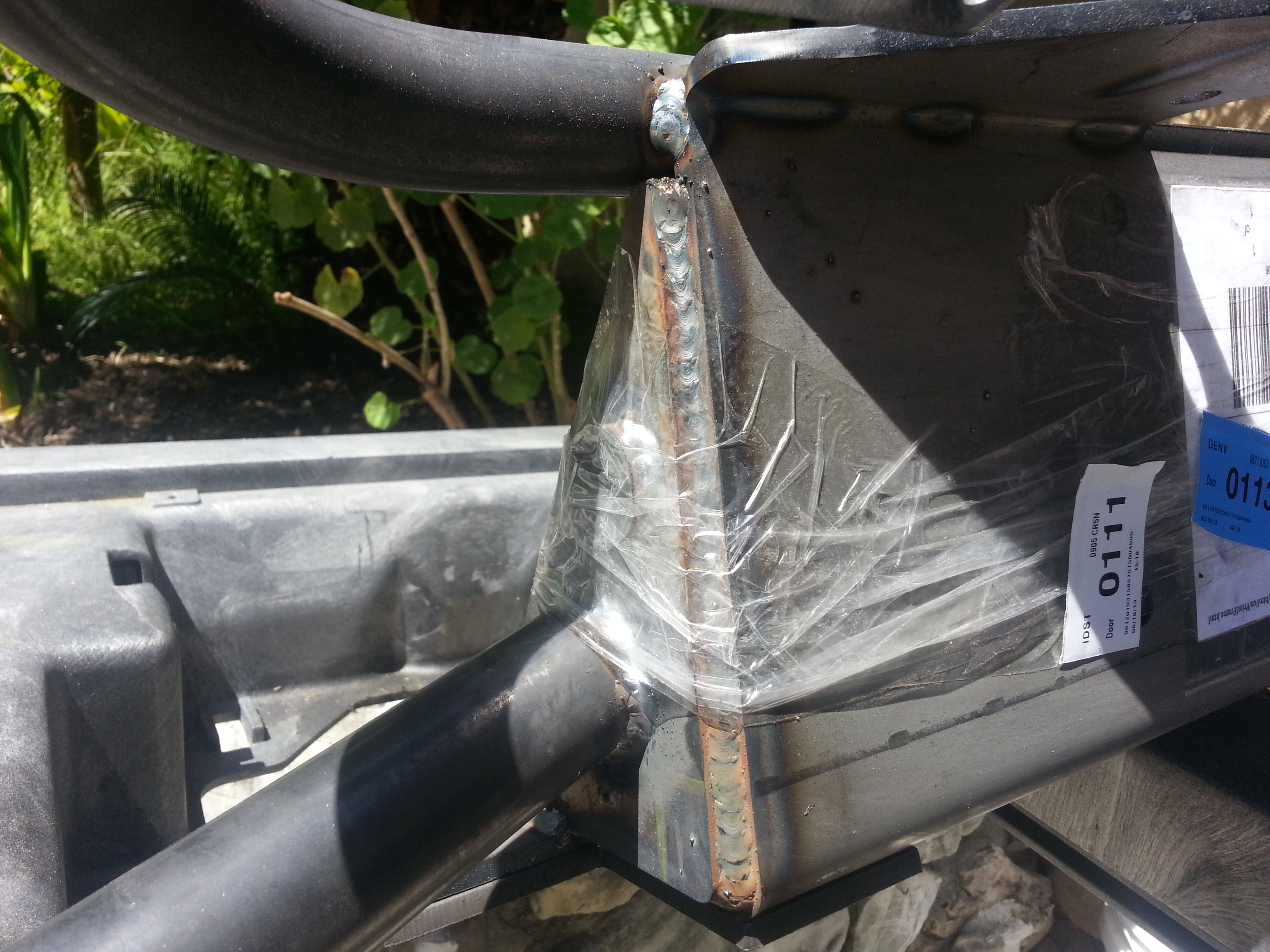

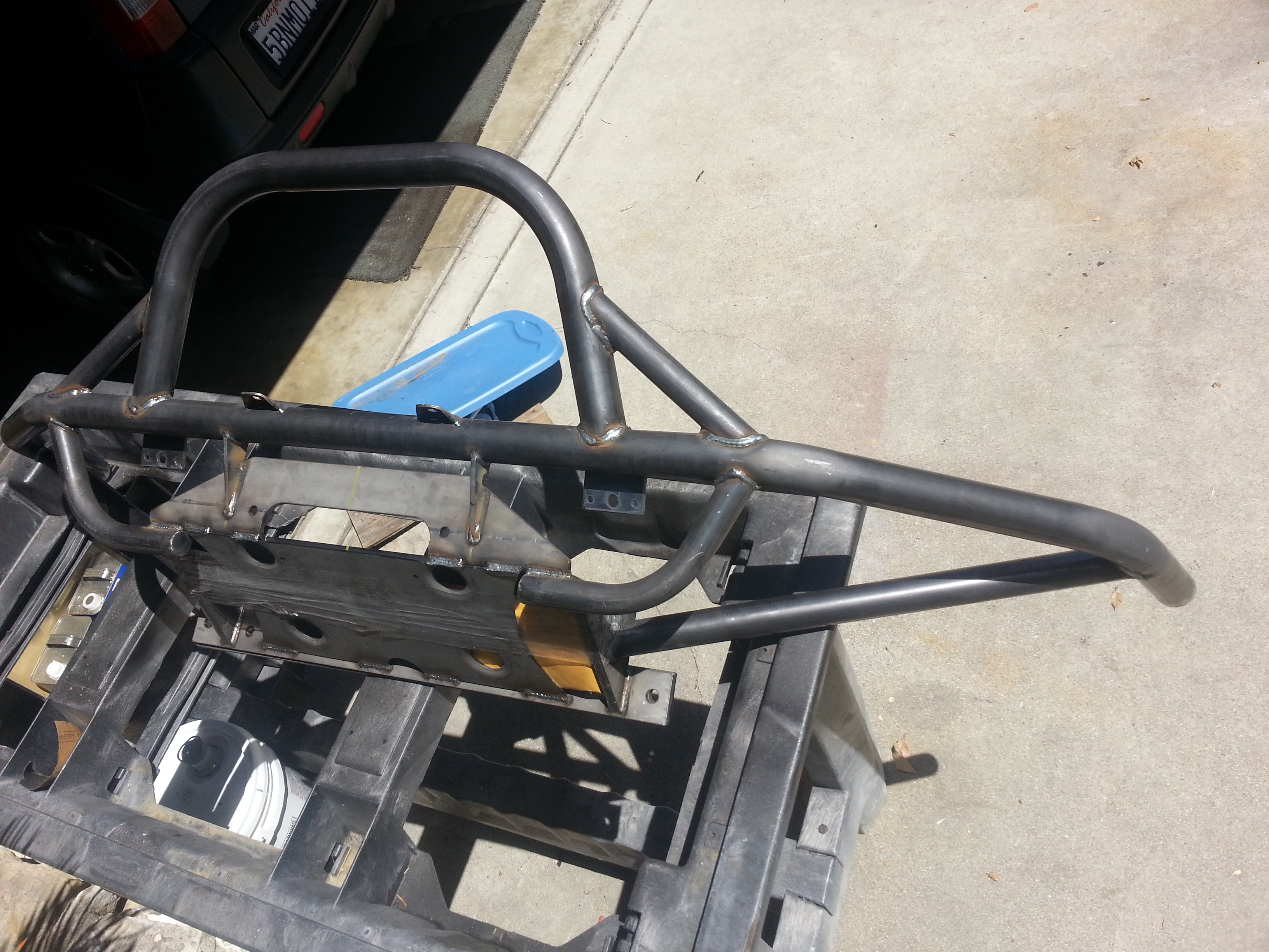

Hey guys, thanx! ... I appreciate the input on the twin stix... And of course the kind words about the bumper! I really like it, its a tank stopper for sure!
