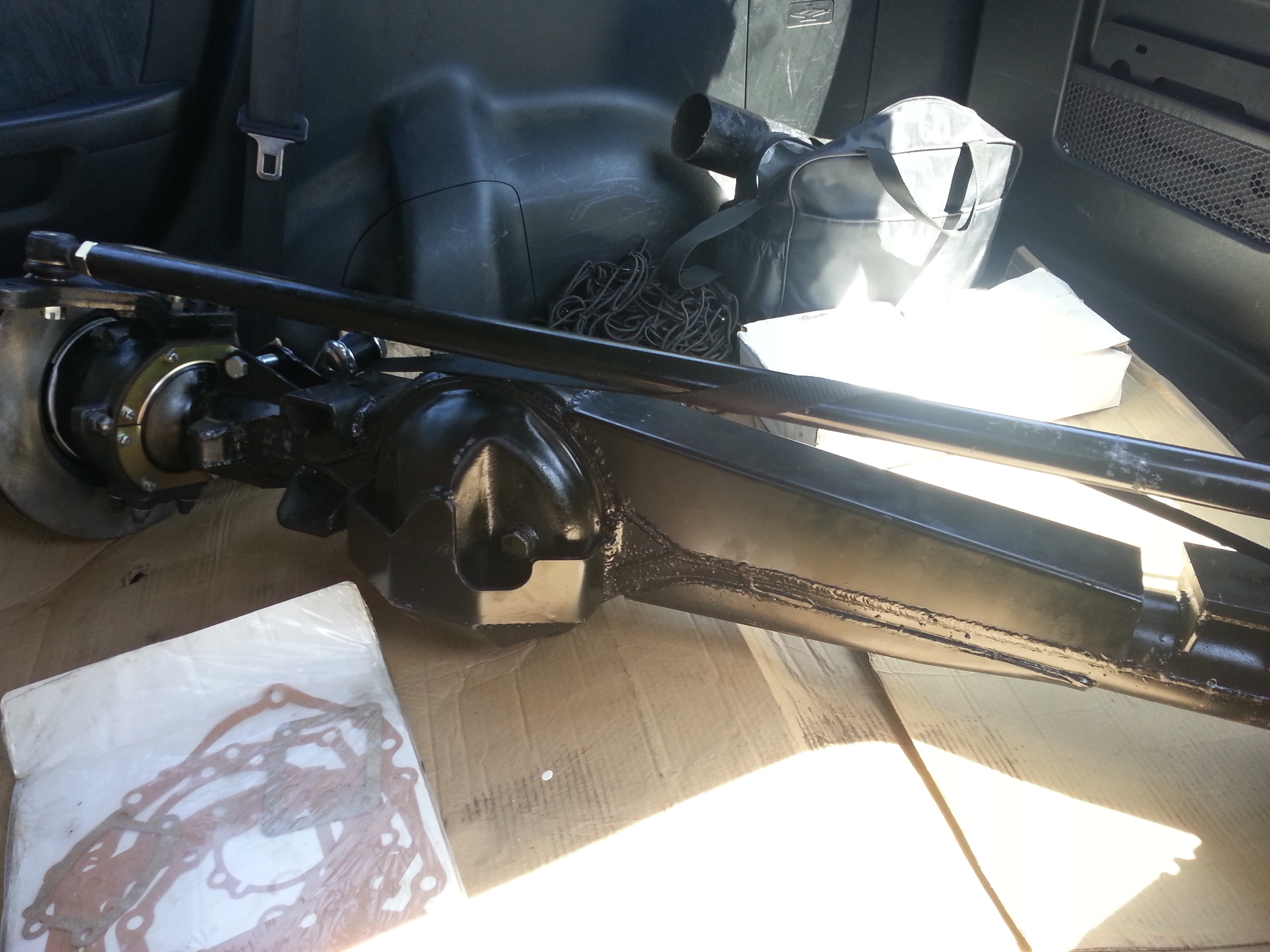

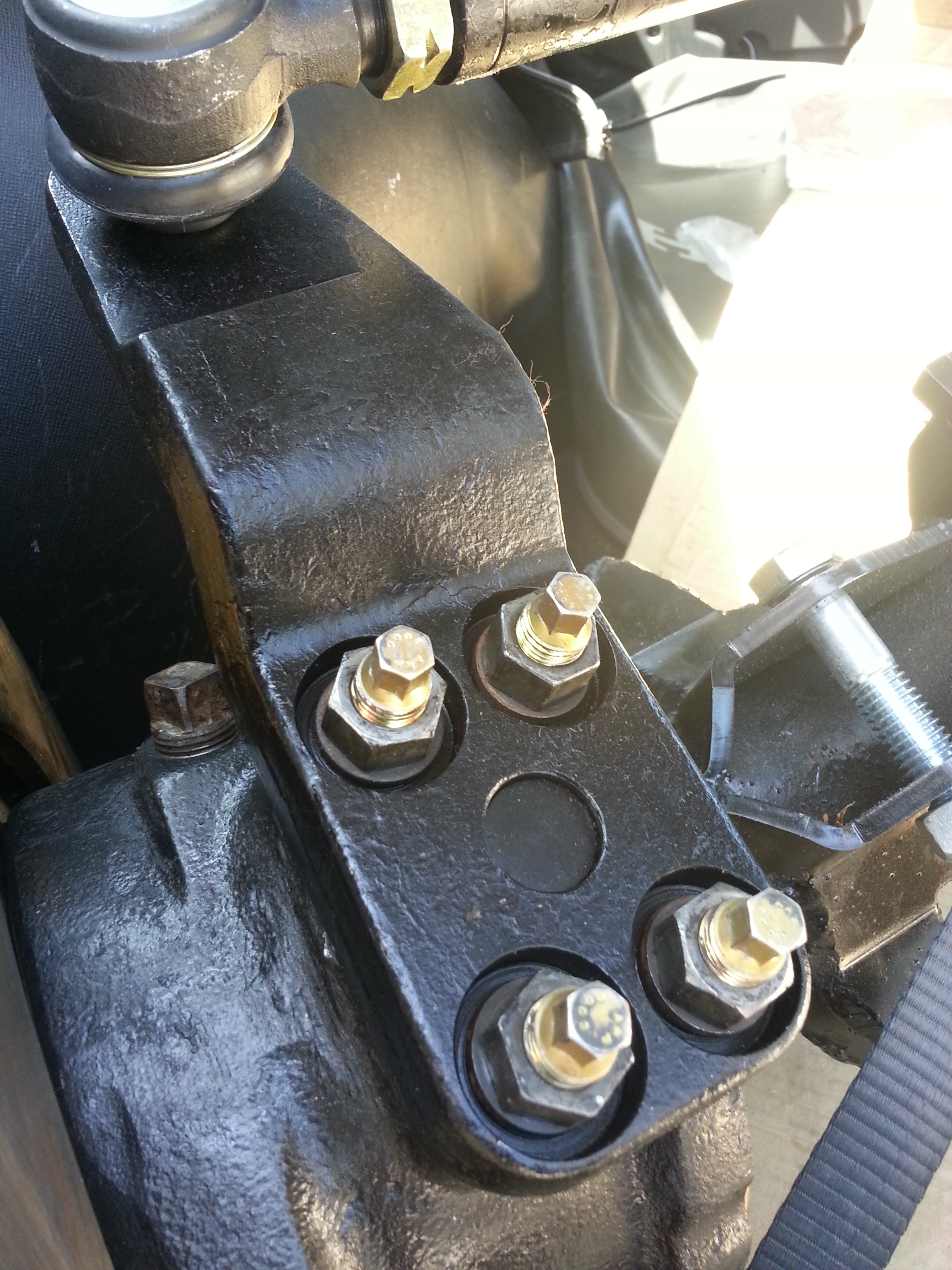

Well, another crazy day with lots of driving and parts pick ups......
Axle fully ready, 100%........
*83 SFA with:
1. A full rebuild using Marlin crawler axle and knuckle kits/mixed with SKYS offroad design.... Includind much thicker half moon retainers.
2. SKYS Offroad truss and diff armor....
3. ARP Steering studs
4. Dirty 30's Made in USA
5. Diff stud delete (Thanks Jonny!)

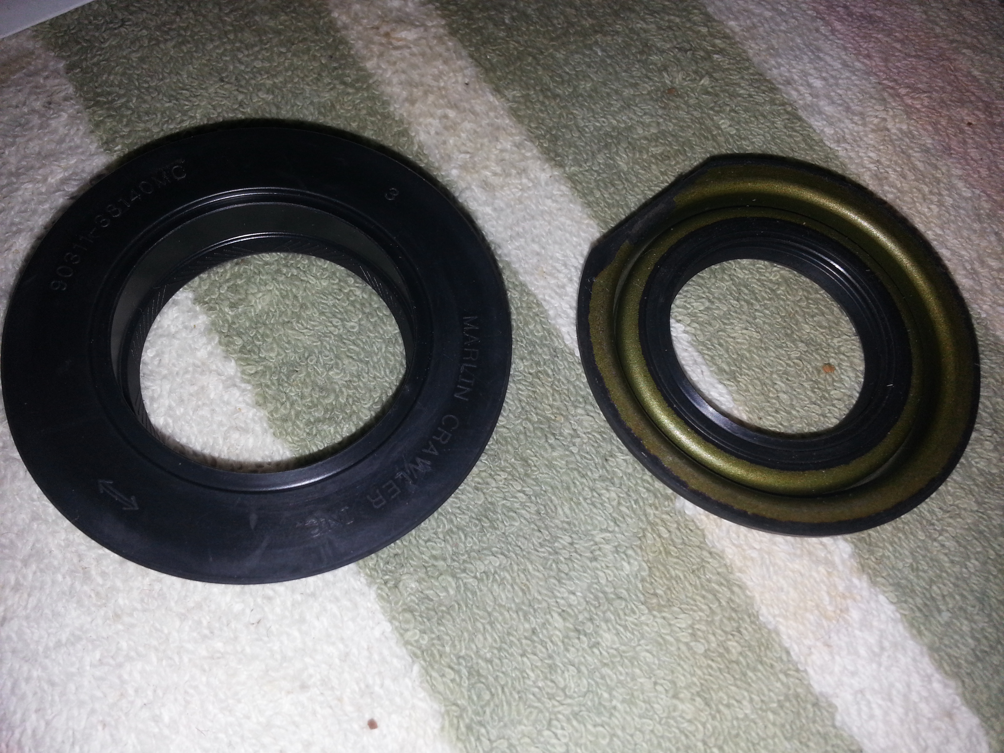

6. TG felt and rubber combo delete/replacement (every expert I've spoken to LOVES these.... And, as Jonny said, "It looks like Trail Gear, in this case, beat everyone else to doing something right and being innovative".... As YotaMasters staff said....."Those are the RIGHT STUFF, just sweet!"..)
7. TG High steer....
8. FJ60 Vented Rotors....
9. 1.5" wheel spacers....
10. G2 - 4.88 Gears and Master install/Rebuild kit(same as rear)....
11. Spartan Locker....
Cleaned up the dials on the SFA Manual locking hubs of some overhanging/little intrusive paint and they are turning like butter now(Nothing wrong with them at all, Jonny,...... just freezing up due to the paint that ran over the edge of the dial and was contacting the ring).

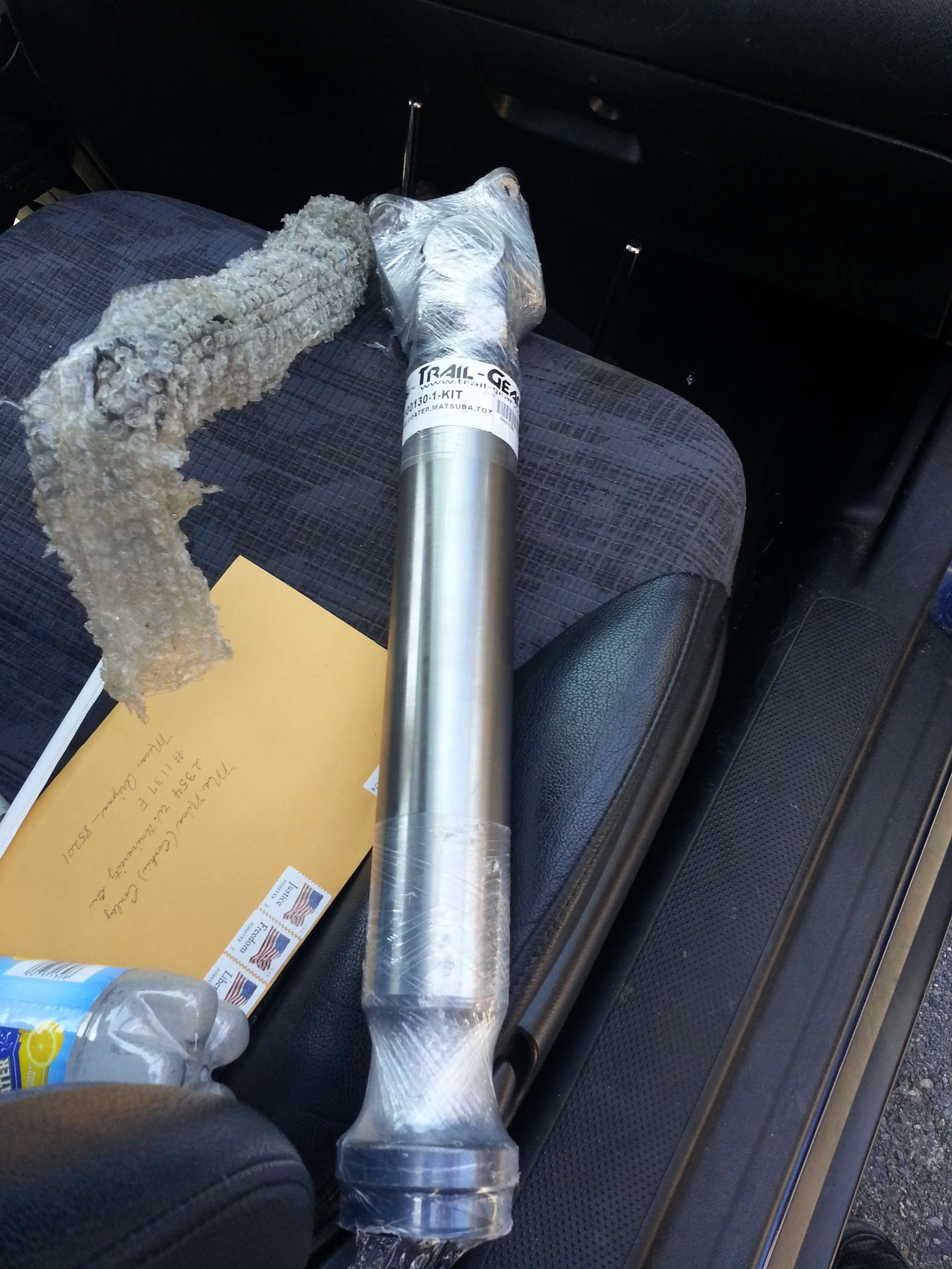

HD - TG / Matsuga 10" splined/teflon coated/chromoly/ joint driveshaft Mod/kit.....

Stud delete bolts.....

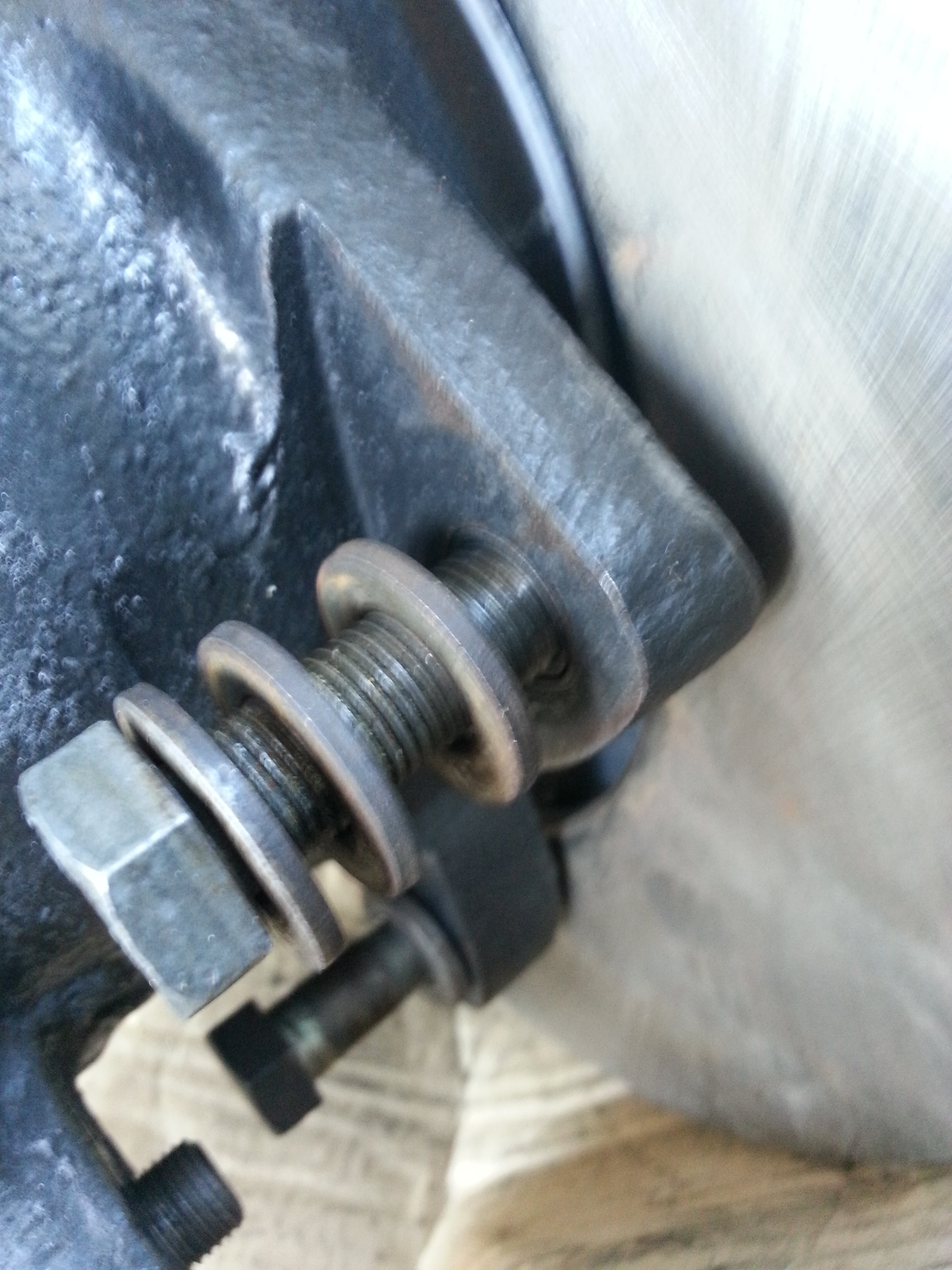

Timeserted caliper hole.....

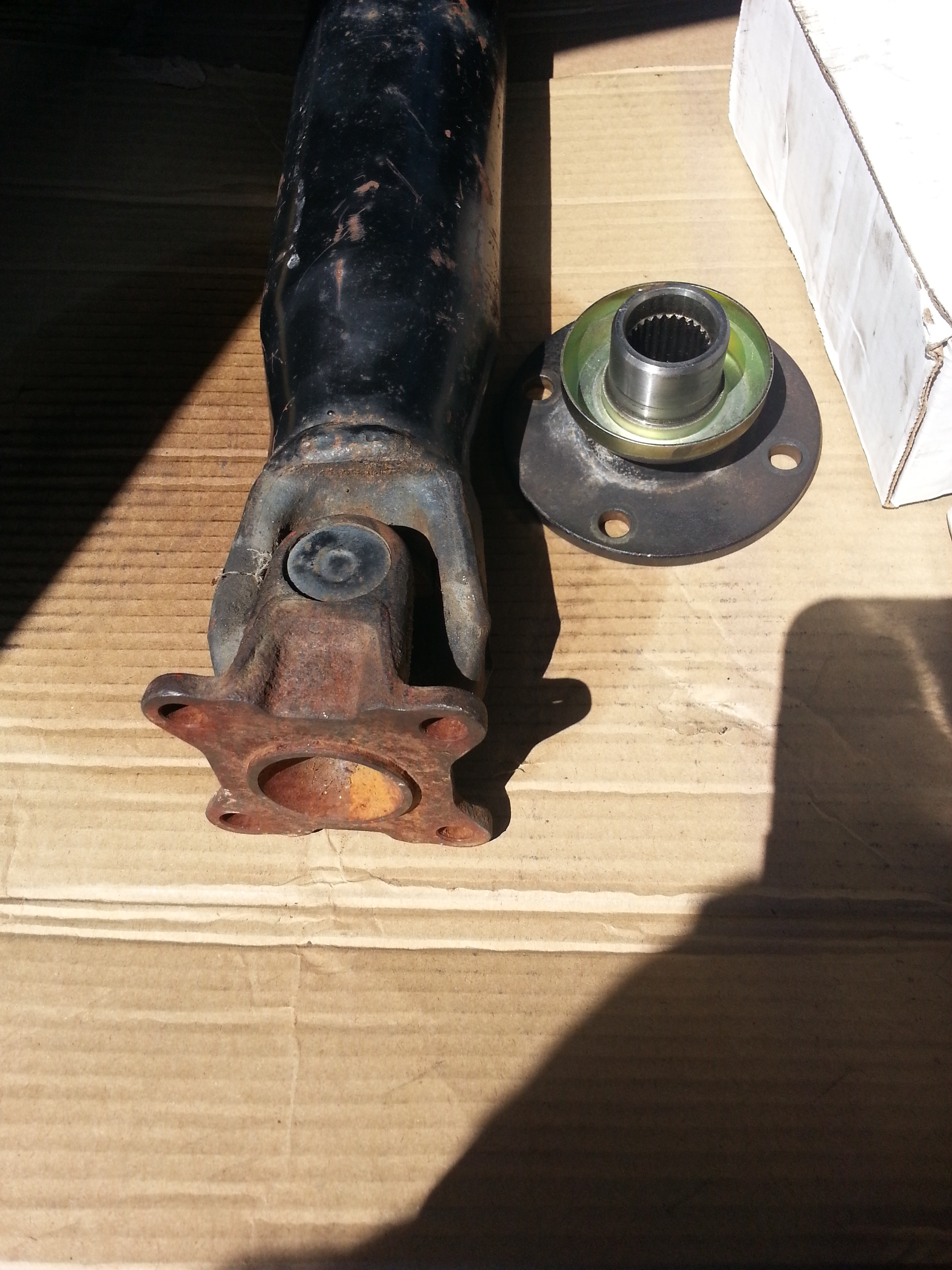

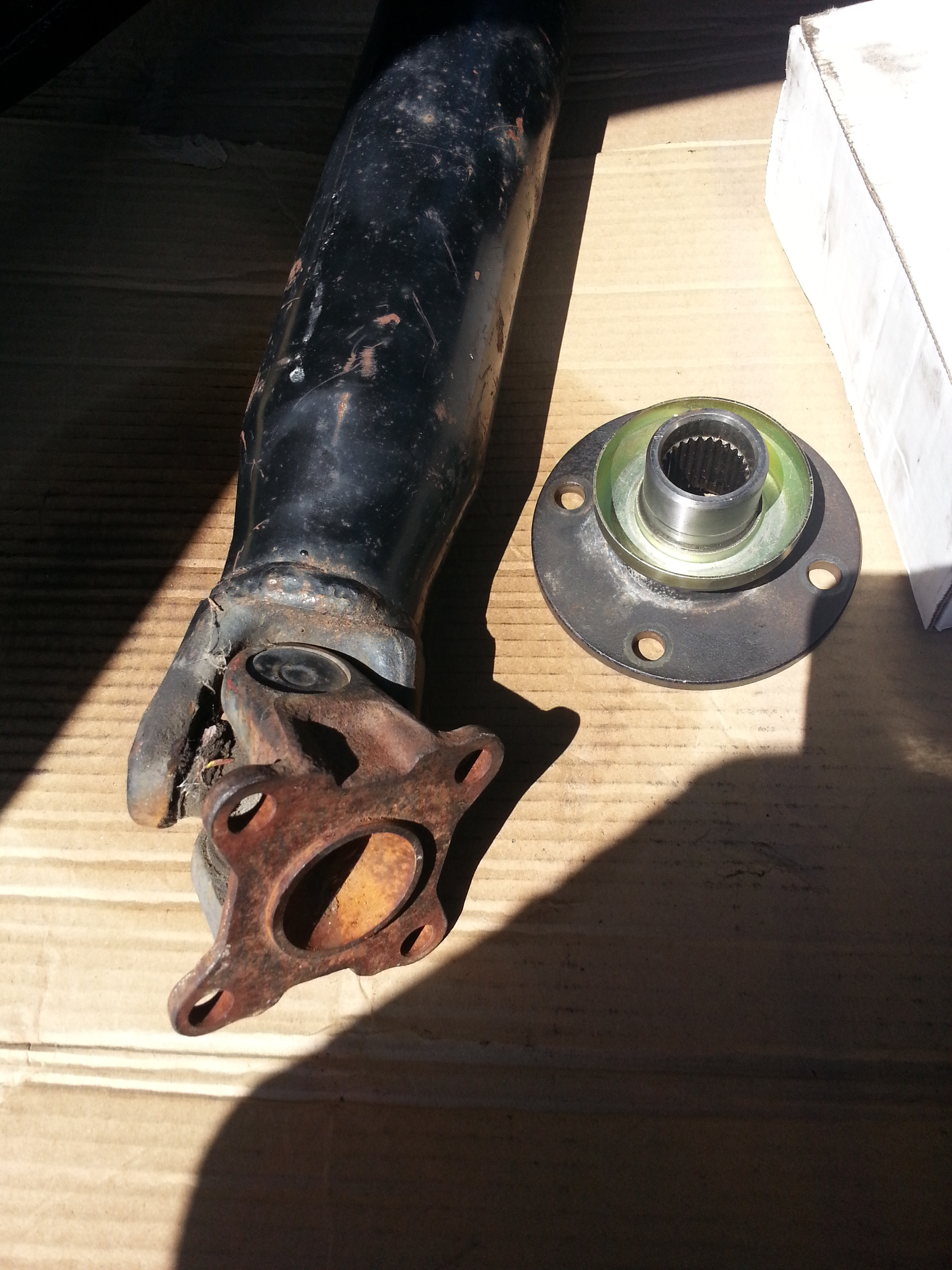

96-04 Tacoma diff flange and driveshaft end joint.....Second pic shows it's flexibility, but that isn't all the way actually... I just couldn't hold it up while I took the picture at that point ....

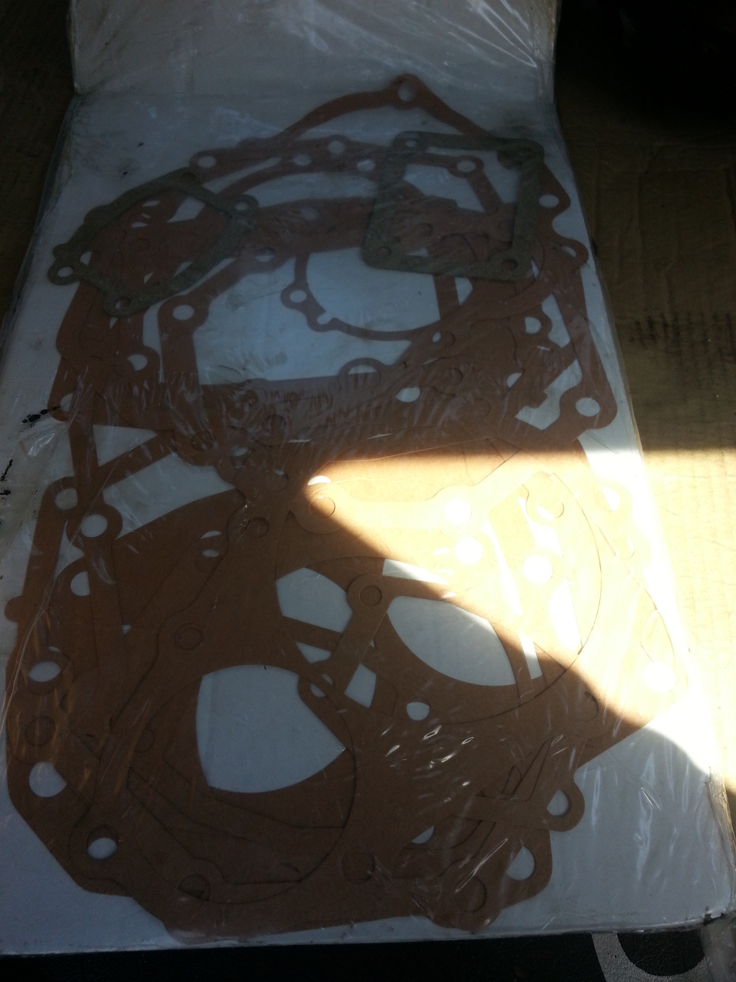

I also picked up a full transfer case and transmission gasket set that the guys out of that shop we're not going to need... And also picked up a heavy duty Marlin crawler transmission output shaft seal and a second transfer case heavy duty dual lip Marlin crawler seal....

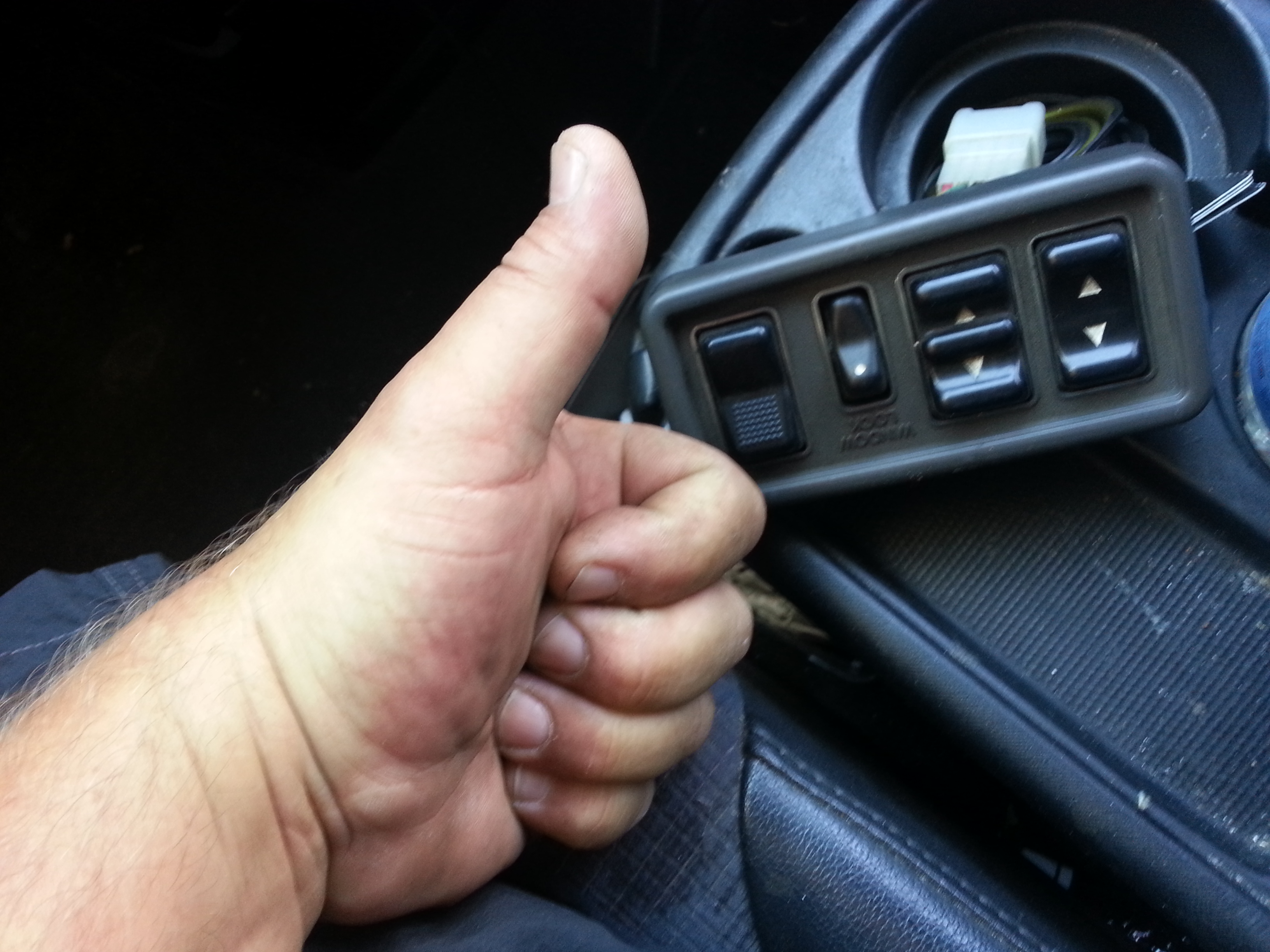

Bubble gum this into place, Richard! ........ .......
Hahahaha.... JK, ..... hope it works for ya!
Yesterday, I picked up a master switch for Richard at Yotamasters! Wooot..... Thanx, Eric!
