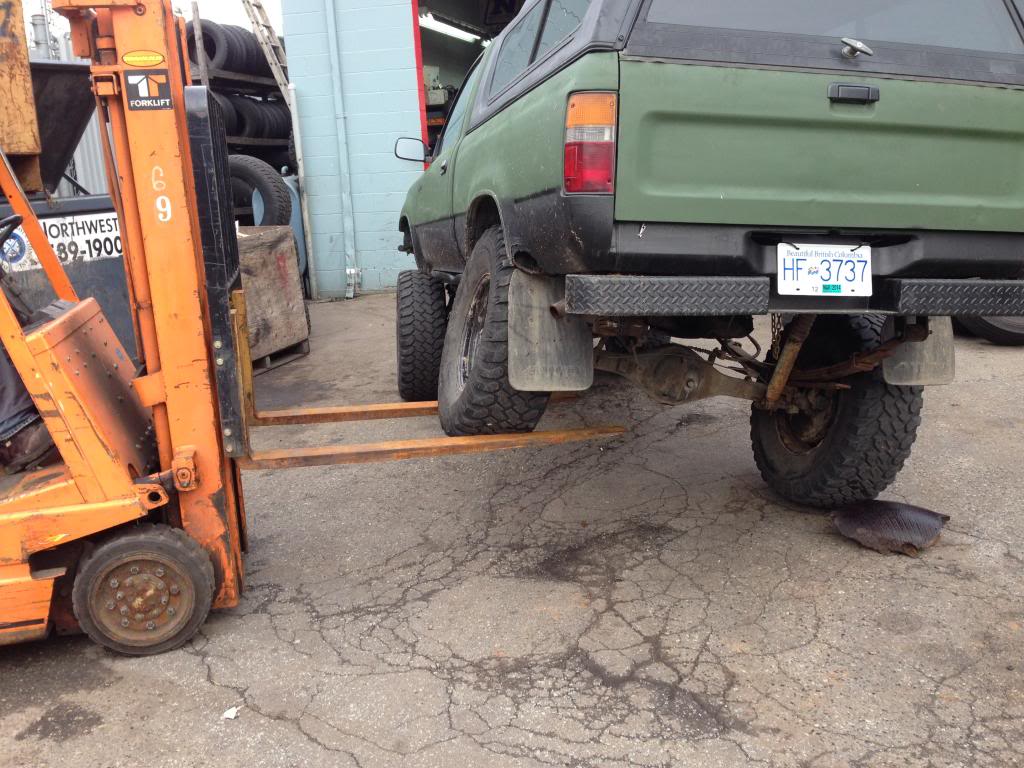

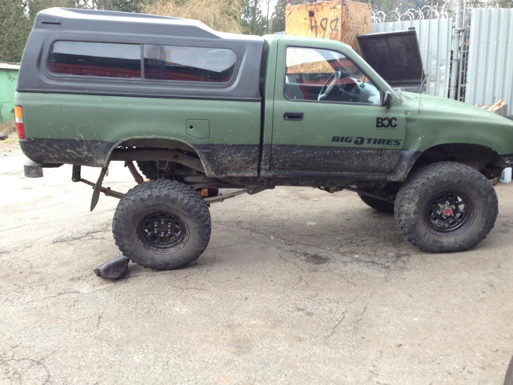

one tire 20" up with the sway bar still in the front. I've removed it but haven't got it on the forklift yet. hoping for another 4-6" i would love to clear 2' with an ifs truck.

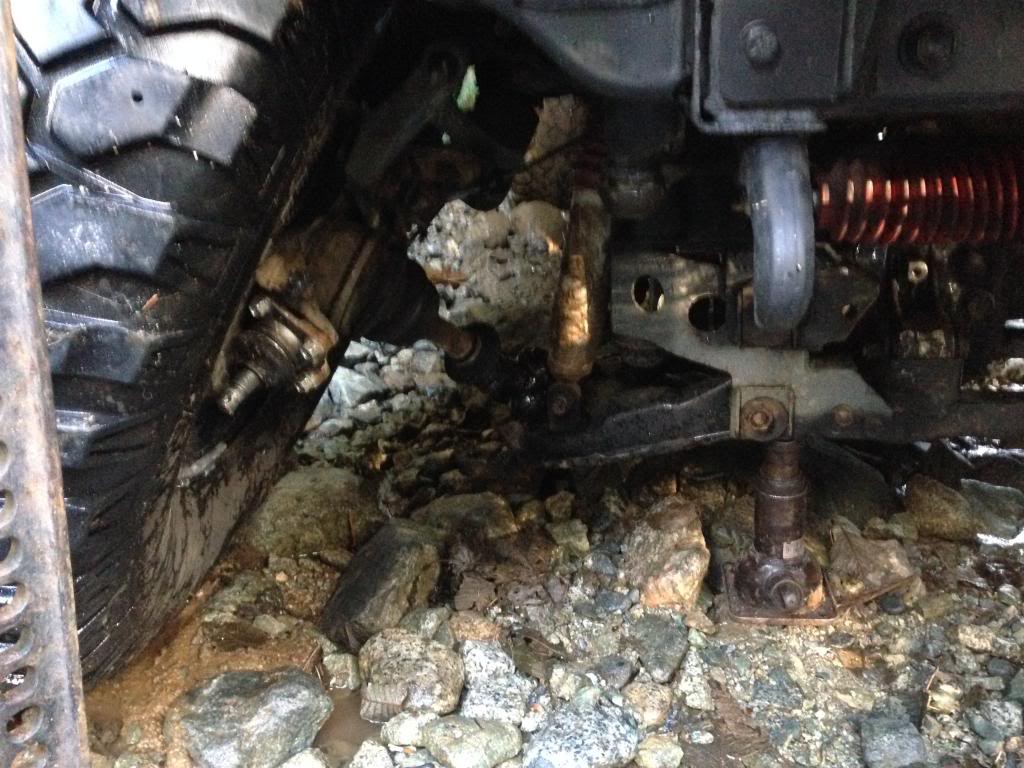

also the front fender is now smashed as on my first run the lower ball joint on the passenger side decided to strip out losing the wheel destroying my cv and leaving me stuck on a trail. luckily i wasn't too far from civilization, got some parts delivered to the entrance and after 3 hours had it rolling again. made it home with 2 wheel drive luckily, only winched once to get around a rock.
the joint itself was fine just stripped the nut. have come to one of two conclusions either i got cheap parts or the hole that it sits in has ovulated just slightly. My first thought was i didn't tight it enough but after talking to the frame shop that did my alignment that they double checked all of them

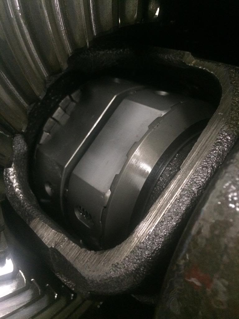

picked up a spartan locker for the front with 5.29s
i like the 4.56 but they just aren't low enough withgt the 35" tires

it will be going in in february when i get a new r and p for the rear.
