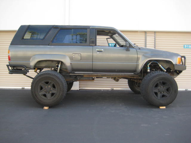

I have a little news to report. I received an e-mail from King today about my front shock / spring set up. Here is the most recent conversation. (note this is after King had reviewed the videos and asked me for some measurements)
I wrote:
I had some time this weekend to check over the suspension. I found passenger side had settled. The measurement from fender to tire on the driver side was 11.125" while the passenger side was 10.500" The passenger spring length at ride height was 14.500" main, 3.625" tender. At Droop (limit strapped) 17.375" main, 3.750" tender. When I removed the pre-load (still limit strapped) I measured 17.750" main, 4.000" tender. My calculations give a pre-load of .375" main, .250" tender with a total of .625"
When I put it all back together I pre-loaded the main .750" and the tender .875" for a total of 1.375" pre-load. When I measured the fender to tire I got 11.250" driver, 11.000" passenger, a bit closer to level now. Maybe that extra pre-load and higher ride height will help with the hard bottoming and tire fender contact?
Do you think I need to adjust my valving or spring set up? If I do need to adjust my springs should I try a 18-500 or try a dual rate of, I don't know say a 12-500 and a 10-400? Or is this the point where I need to decide if I want a pre-runner or a trail crawler. Or is there still a possibility of a multi-purpose rig?
King wrote:
The spring rate sounds good, I would not see needing to make any change to that. If your tender coil is complete compressed at ride height or your coil slider is sitting on the secondary nuts to get your ride height than the preload will be measured off the lower spring.
I would suggest that since you are doing both crawl and pre-run with this truck, to add our high speed compression adjuster option. With this option you can add more compression when needed just by adjusting the knob from soft to firm. There is 20 positive clicks of adjustment. The compression adjuster cost $300.00 per shock.
#389
Having the compression adjuster sounds sweet but $600 will be painful. I am sold on the compression being soft, especially in the roller whoop video. But, I also see the front end spring back rather quickly after being compressed. King doesn't mention this? Am I mistaken on the rebound?
In other related happenings! The limit straps are designed to stretch 1" per foot and are 18" long so I estimated they would stretch 1.500" as a baseline. If it had stretched 1.500" the UCA would contact the droop stop bracket. If it did hit there would be a mark in the paint, but no contact. With that info I adjusted the limit strap to give another half inch of droop. Hope that wasn't too much.
As for the bump stops you can see in the video the tire contacts the fender. And the aftermath is my fender near the door jamb is pushed in and dented. I have a set of bump stops with a 1/2" shim, I'll be installing those before my next trip.

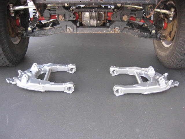

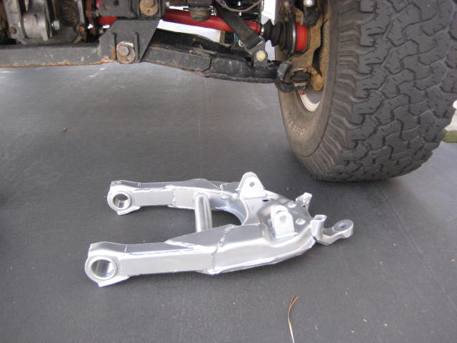

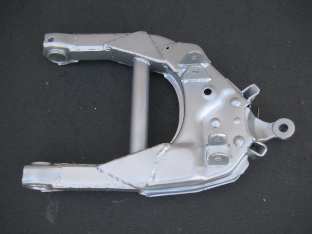

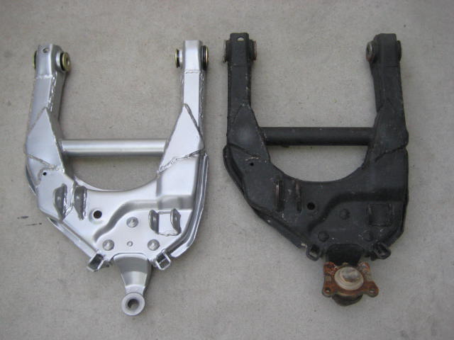

Had some parts powder coated and I piggy backed in a new set of Mega Travel LCAs in the lot. UCAs are Bengal silver so why not the LCAs.
I am needing to pull the old MT LCAs off to install the new set because the new ones will have the poly bushing conversion. The alignment cams are all over the place, my theory is the rubber bushings are a factor?
If that doesn't fix it I have some other corrections to make in the design of the cam receivers on the sub-frame. The laser cut design for the "slot" length need some adjustments. I made it too short so to compensate I made the width of the vertical weld on's too wide, and this created some slop. Next sub-frame will correct these issues.
The other design short coming may be the LCAs are +6" over stock and that just flat out over leverages the assembly. Then again maybe I didn't tighten the bolts enough or they just loosened up. Time to play detective!

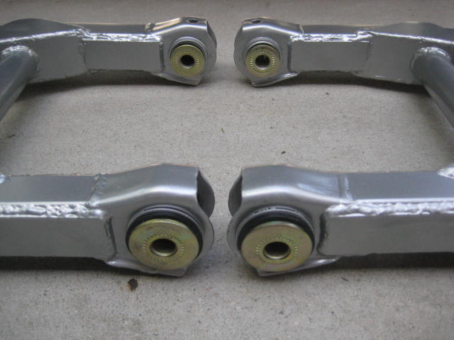

I installed bushings in the new LCAs yesterday. The full floating non-binding poly bushings should reduce the forces on the alignment cams. The old rubber bushings were showing some wear. They were getting dry, showing some cracking, and starting to chunk apart.
Off with the old LCAs, on with the new.

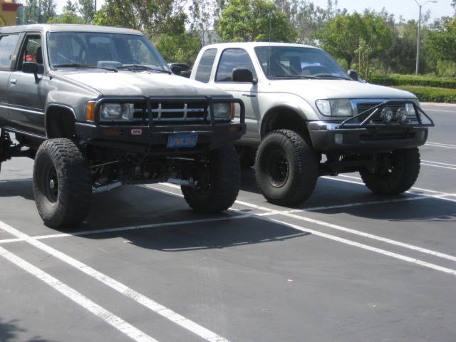

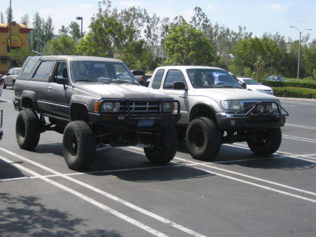

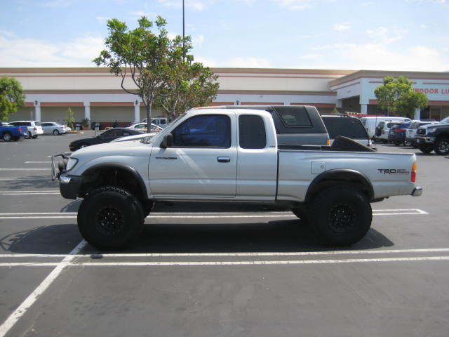

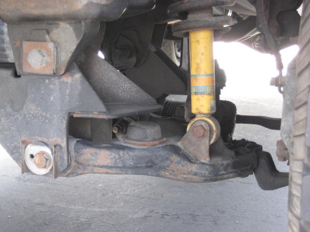

Not a whole lot of update items to report. Just been doing a lot of street driving. Now I am preparing her for the summer, going to be my daily driver. Remember I swapped in the new LCAs, well last week I got a profession alignment. The LCAs were identical to the previous ones, only now with poly bushing, and silver powder coat. Anyway the alignment came in spec but the caster was maxed. It drives nice but a slight pull to the left. I need to look closer at the print out.
I was pulling into the Home Depot parking lot this morning and saw this sweet looking TRD Tacoma.
So i parked next to it.
Looks like a similar amount of lift. Tire is 35x12.50xr15.
Took a picture of the suspension.
Zoomed in for another picture.
Wow look at that up travel, must be a solid 2"
The suspension from another angle.
And another. Wait, something is missing? Can you see what is missing?
