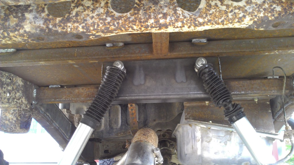

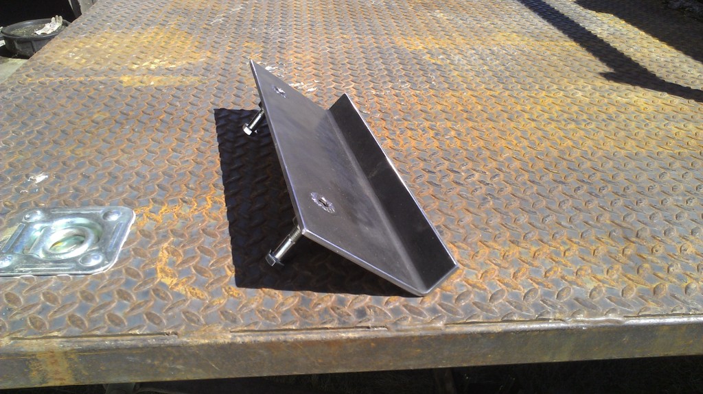

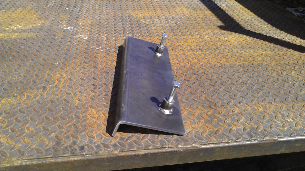

This is the mount I made. It's 3/16 plate that I bent with the brake at work and welded to a square tube crossmember that I made to replace the rusted out factory one.
Here's a shot of it mounted and u can see the gussets I added to strengthen it.
And here's a rear shot of it mounted
It's about half an inch away from the bottom of the flatbed. I made the mount as tall as I could to spread the shocks as far apart as I could. Ideally for shocks to work the best they should be mounted vertically but most ppl compromise and mount them at angle in order to gain extra travel.

Those look really good, i think i will do the same thing with my truck, with some help from my uncle, the angle isnt as harsh as ive seen on some rides. Are those the Billy's 5100?
Old Dec 3, 2013 | 05:10 AM
  #133
85sr5excab's Avatar
Joined: Sep 2012
Posts: 618
From: iowa
Yessir they are. Got them thru lowrange offroad. Here's the pn# Bilstein 10" 5125 (v170/60) Shocks-TSP-BIL10-5125-170-60. They have the softer valving. I read somewhere that the softer valving was perfect for trucks and the heavier valving was perfect for 4runners. I'm planning on running the 12" travel version on the front when I get my ruf packs put in. I paid $75 apiece for them which is $10 cheaper than I could find anywhere else. I'm very happy with lowrange so far. Didn't take very long to get the shocks and when they got here they had included a decal sheet and a handful of business cards asking to spread the word of their business. I always try to shop around for the best price but they will be the first place I look.

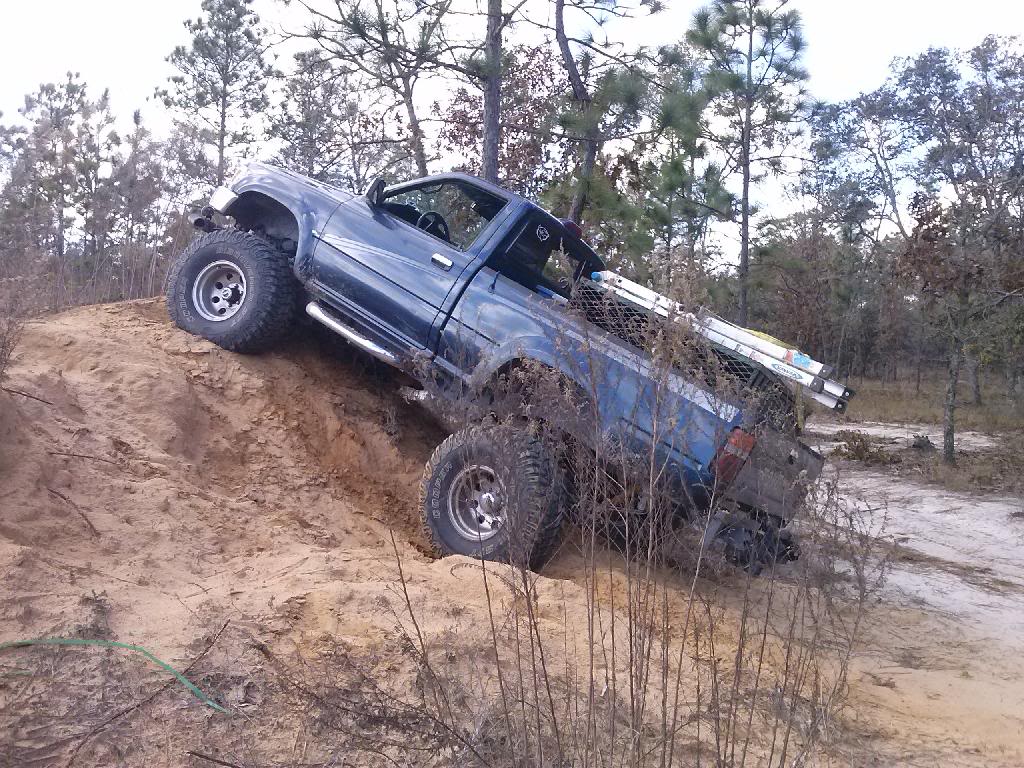

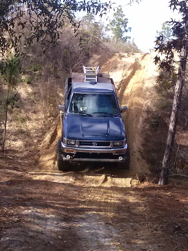

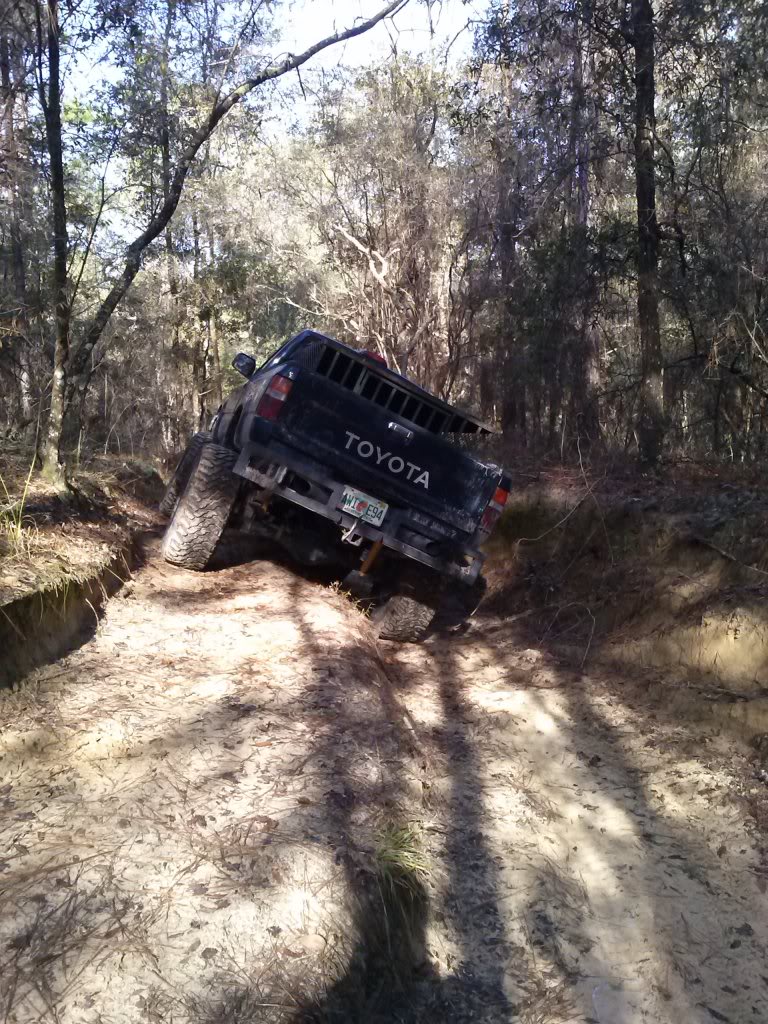

So i went out to Citrus today between jobs and did some light wheeler.
The pictures never show how steep these drops really are, it felt like myvtruck was gonna tip on one of the ones that i didnt take a pic of (cause i couldnt open driver door, low side on driver side). Anways heres 2 that i took.
There are alot of these washouts like this here, and ive gone on 3 of the Florida Threads where people were basicly begging (im exagerating) to have other members do rides and go off roading, ive sent a couple emails and PM, and posted on all their threads, with no avail. Not sure why ppl round here are like that....

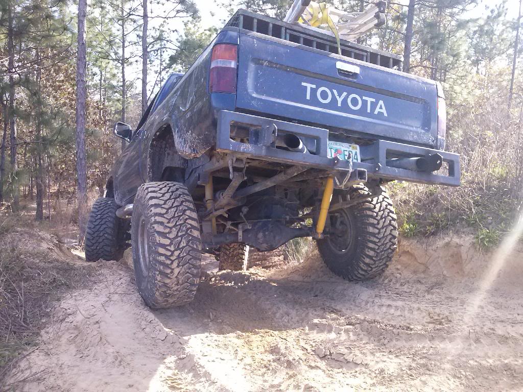

You were right bro, i went up a very steep hill the other day and the rear bumper hit the edge of the pavement as i was going up a dirt hill that was right off the side of the road. It pushed my bumper up and into my new exhaust, now my tips are pressed to the bumper instead of being in the middle, lol. Nothing damaged though, i gotta see about getting it tucked closer to the bed though!!!
