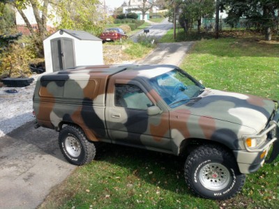

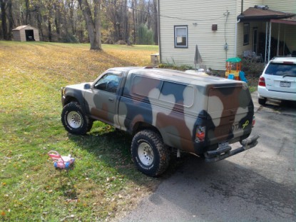

Hey guys and gals... Just thought I would post up my 95 Toy. I bought this truck about 5-6 years ago for 1000 bucks. When I got it the truck had around 60k miles. It had a hole in the frame beside the gas tank.(easy fix) Other then that the truck was MINT...
I later found out the fenders and hood were all bondo and needed replaced. I also found that it had a blown head gasket. I replaced the guts of the gas tank also.
1995 Pickup 2.4l 22R 4X4
Parts list...
Fenders
Hood
33" BFG's on 15" rim's
29mm Torsion bars
Brush guard, Rear bumper
Removed spare tire
Removed sway bar
Fiberglass cap
Camo paint :-)
Lunchbox locker (spartan) 4.10 gears
Exedy HD clutch kit
Hella 500 lighting
Engine gasket and seal kit
HP water pump, oil pump, timing chain and guides
Attached Thumbnails Bean's 1995 IFS Pickup-camo-cap-415-x-311-.jpg   Bean's 1995 IFS Pickup-camo-cap1-400-x-300-.jpg

The truck is just sitting on an odd angle... Its level. Also I never put a lift on the truck. With the correct rim backspacing and a hammer to pound in a few spots, I get no rubbing with my tires even in the woods.
I am actually planning to step back down to 31's. This thing is a TURD with 33's and 4.10 gears on the highway...
