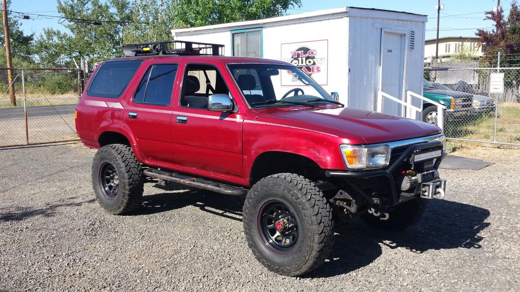

Got my Blazland kit in. Overall the istallation was a breeze and the quality of the product is very nice.

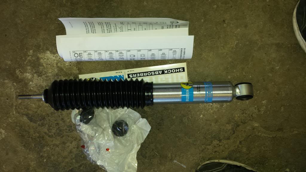

Got some stock t100 axles and some bilstein 5500's

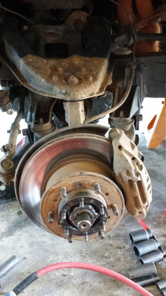

Took off the wheel and hub.

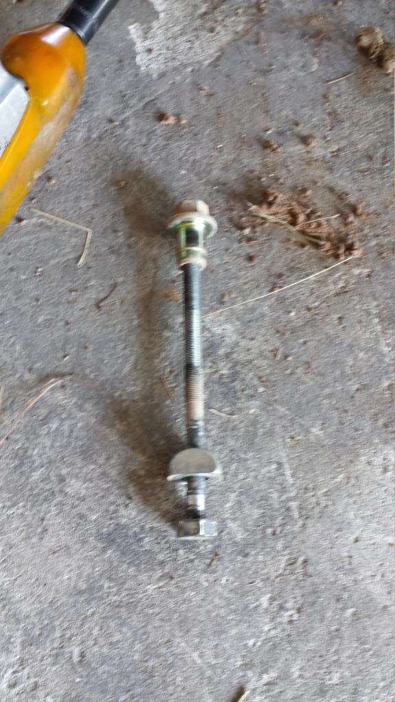

Loosened the torsion bar adjuster nut, then removed it.

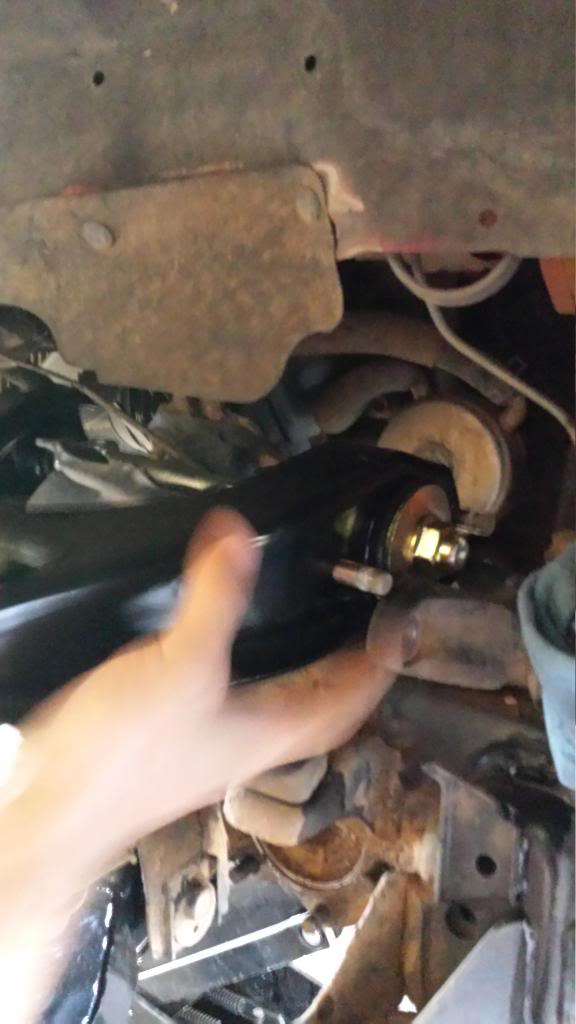

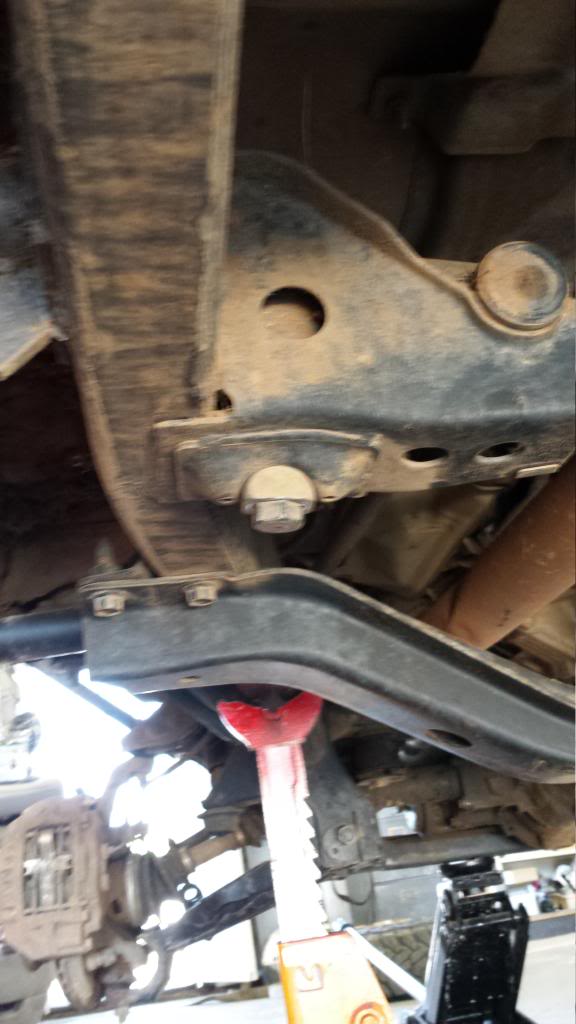

Unbolted the torsion bar from the upper A arm

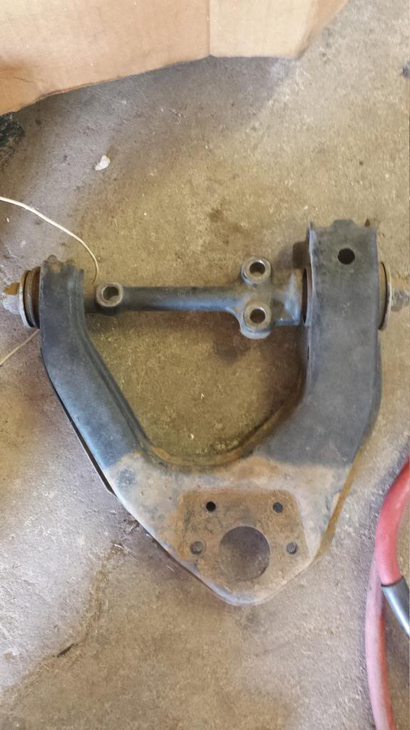

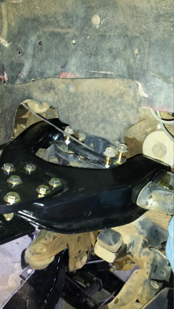

Unbolted the upper ball joint then then unbolted the upper A arm.

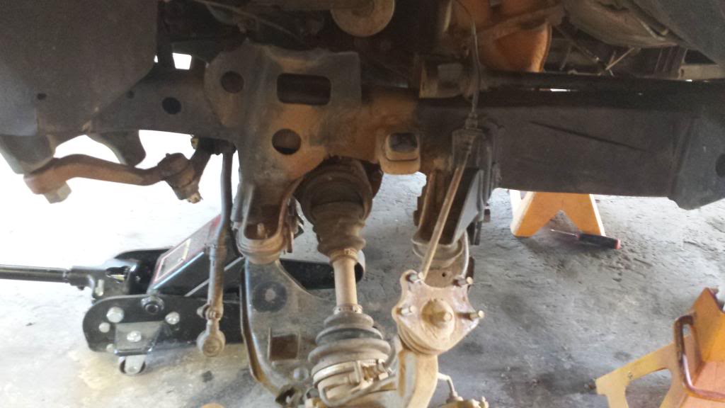

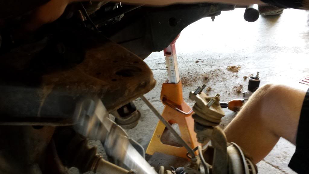

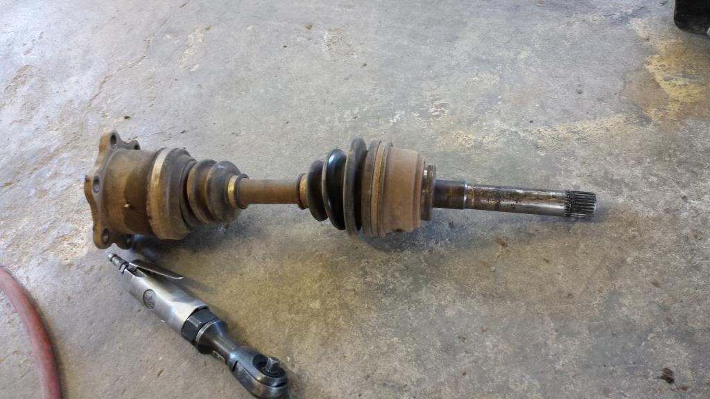

Removed the Shock and unbolted the CV axle from the diff

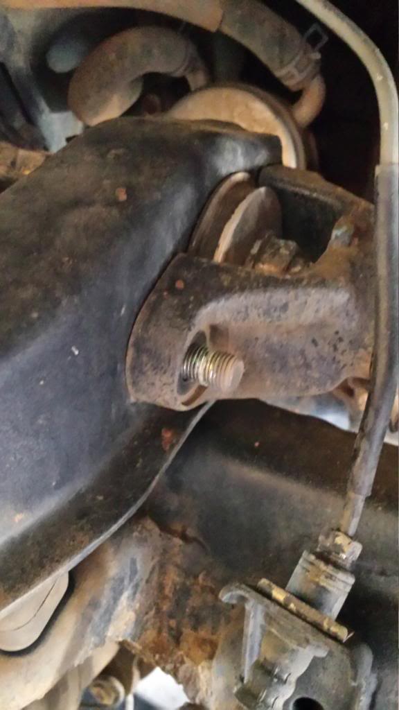

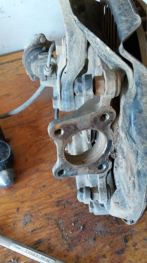

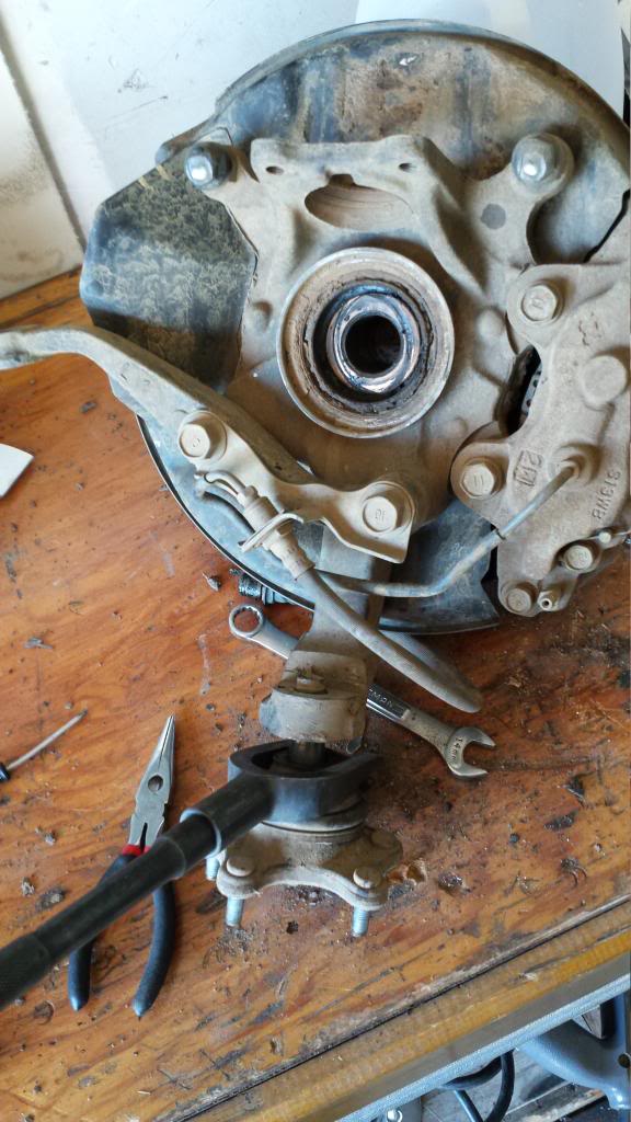

After removing the brakeline and the tie rod I unbolted the lower ball joint and removed the knuckle.

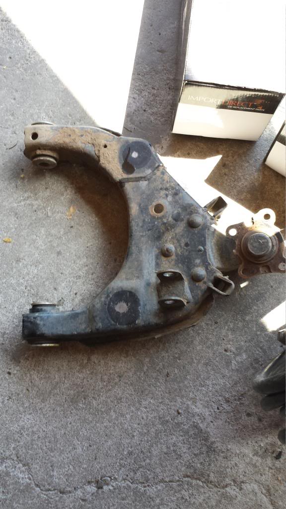

Then removed the lower A arm.

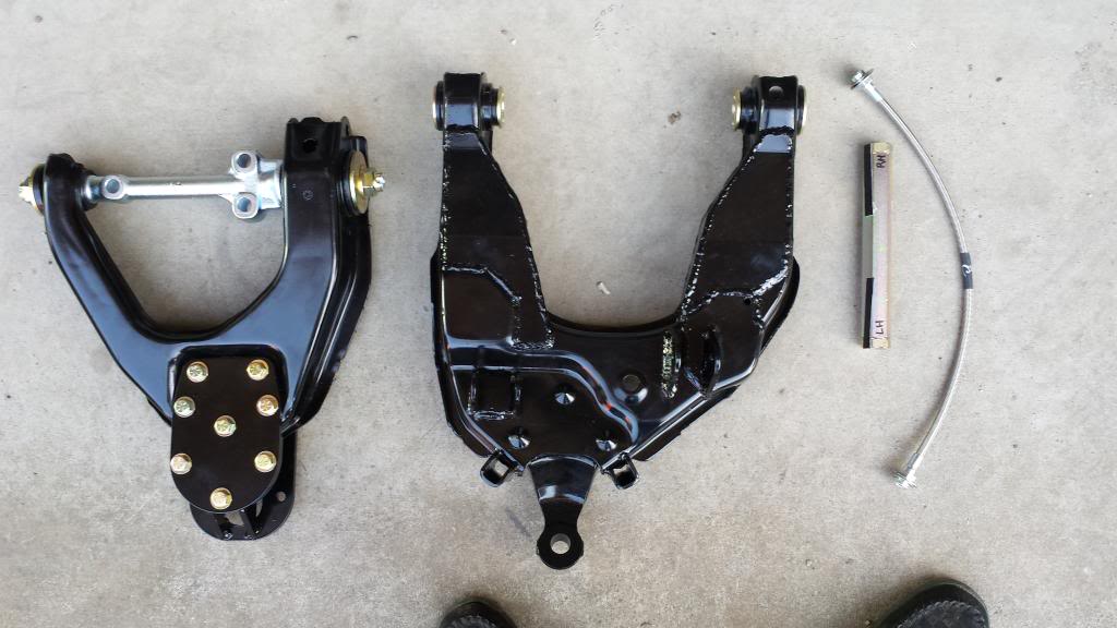

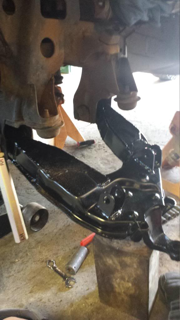

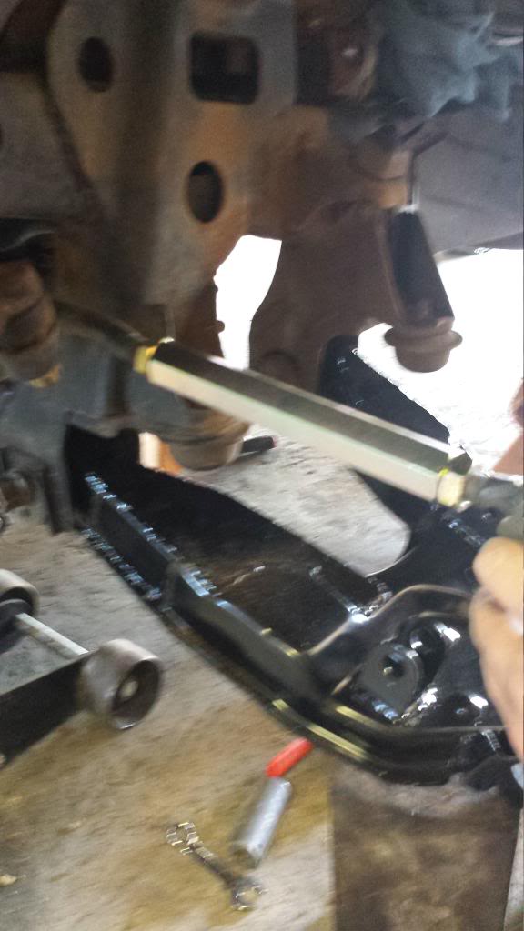

Then it was time for reassembly! started with the Extended lower A arm.

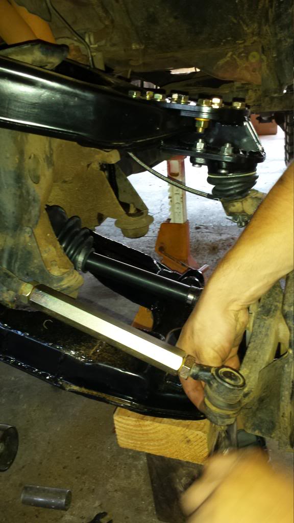

Tie rod extension

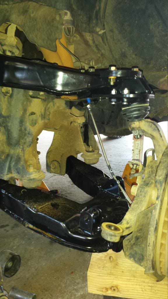

Extended upper A arm

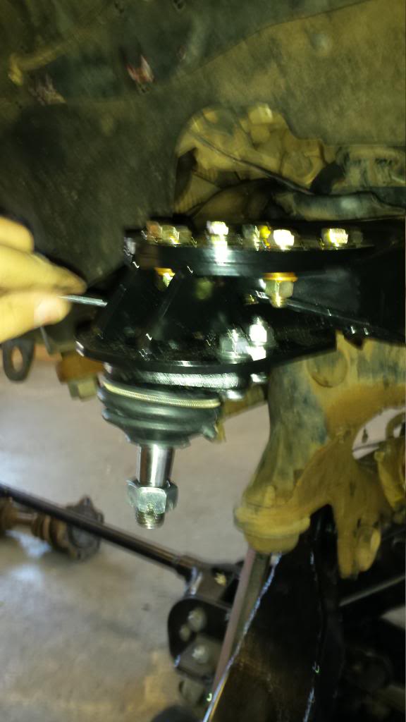

New upper balljoint attached to Upper A arm

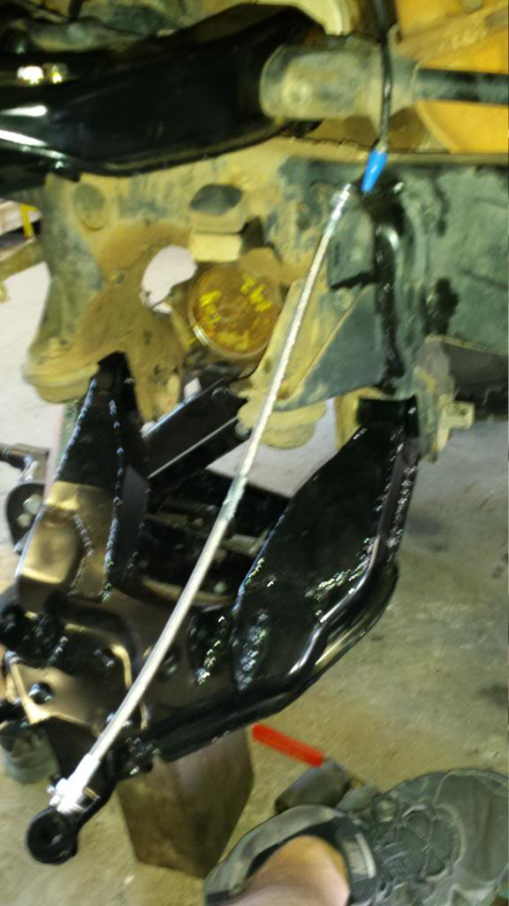

Extended Lower A arm and braided brake line

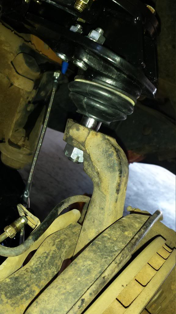

Put the new lower balljoint on the knuckle and installed. Had the raise the lower A arm quite a bit to line up the upper balljoint lol.

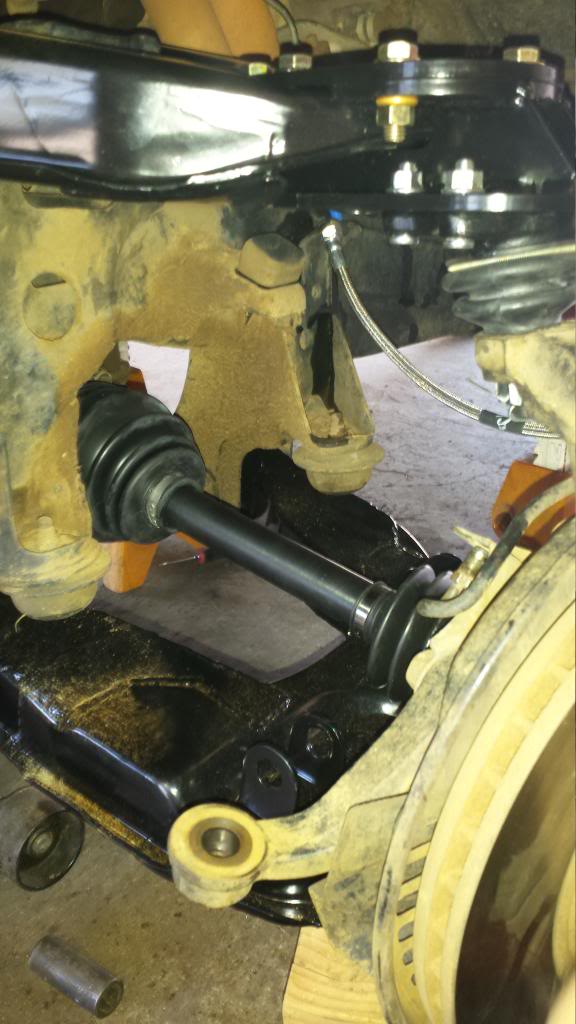

Before we tightened the lower ball join we installed the T100 CV axle.

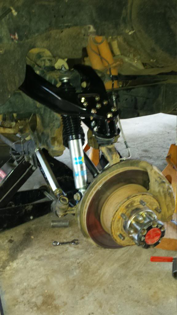

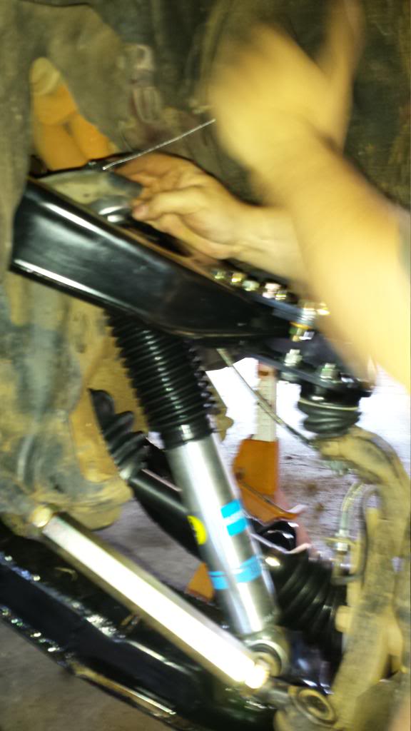

Installed the shock (which the first time we had to man handle it in because we didn't install it before tightening down the lower ball joint.)

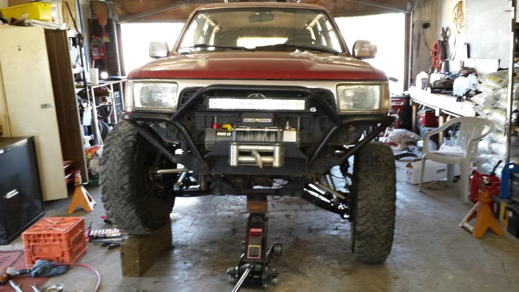

Rinse and repeat with the other side and voila! There was probably 2-3in of more travel available still.

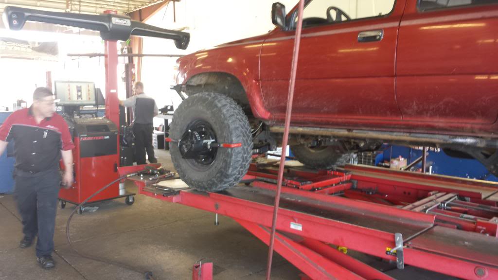

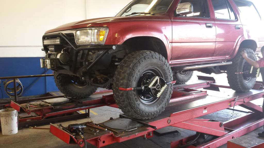

I am only going to run this set up for a couple months to save for the coilover kit. So I decided to just use stock torsion Bars for now. I had to crank them all the way down to get to about stock height.
The toe and camber were off big time so I used my tow truck and brought it down to a local tire shop (Ed's Tire Factory) and had them give it an alignment
The ride right now is soft and cornering is a trip. It leans really far and picks up the inside a lot but I never feel like its tipsy lol. I know with the coilover kit a lot of that will go away. I took it on a small dirt road run and the front seems to soak most of the bumps but now the rear needs to be done.
I am curious if there is any way to get just a little more preload from the stock torsion bars though. Does anyone have any ideas????

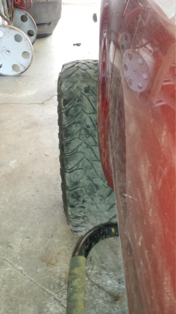

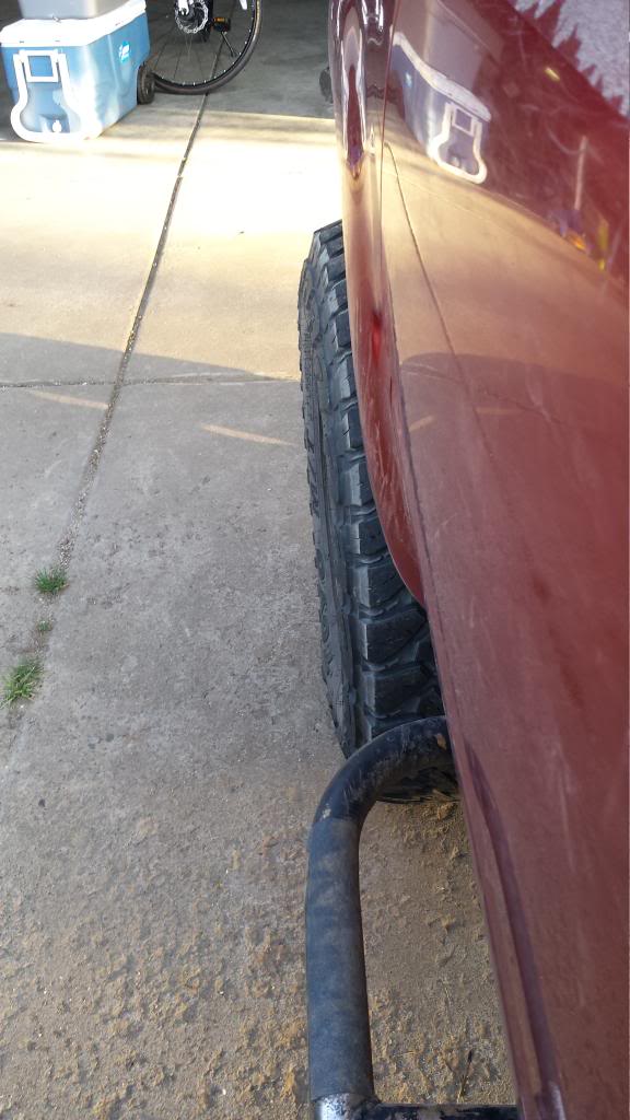

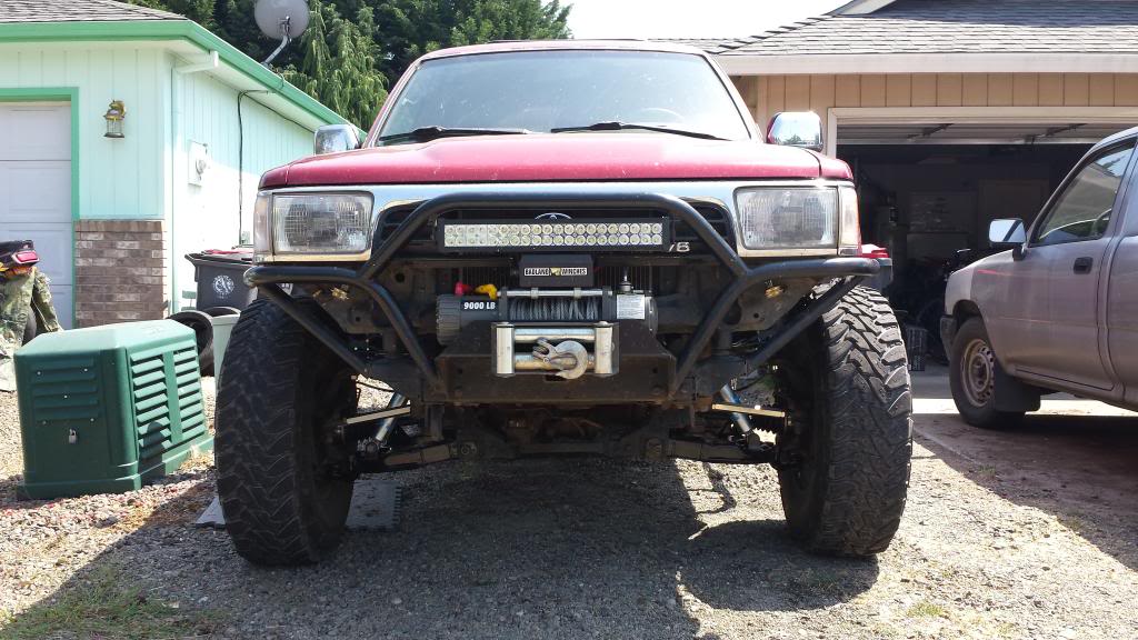

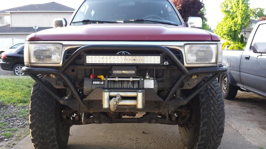

Before and After pics...

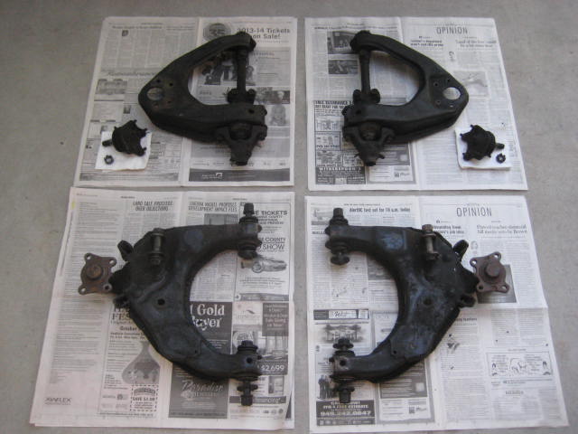

Oh by the way, I received your old LCA/UCA cores today. They were in good shape so I will be sending you the full deposit refund shortly. Oh yeah, the lower BJs were really pressed onto the LCAs, looks like you gave up trying to remove..... which is good, as some people force it and hammer the crud out of the drop and in doing so elongate the tapered hole, ruining the LCA in the process. Not a big deal for me to remove properly, I have the technology!
Not your actual cores, just a photo from my archive. Blazelander2013

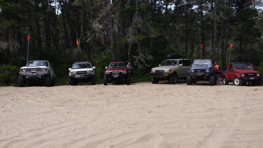

I went to the dunes this weekend and the front handled SOOOOOO GOOOOOD I was flying across the dunes. I even jumped the damn thing 3-4 times without a problem. I am so impressed by your kit! I'll post some pics when I get them.
Just hold onto my deposit money because I am going to buy your coilover hoops here shortly
Old Jun 15, 2014 | 05:49 PM
  #31
andersej's Avatar
Joined: Dec 2011
Posts: 228
Heres one

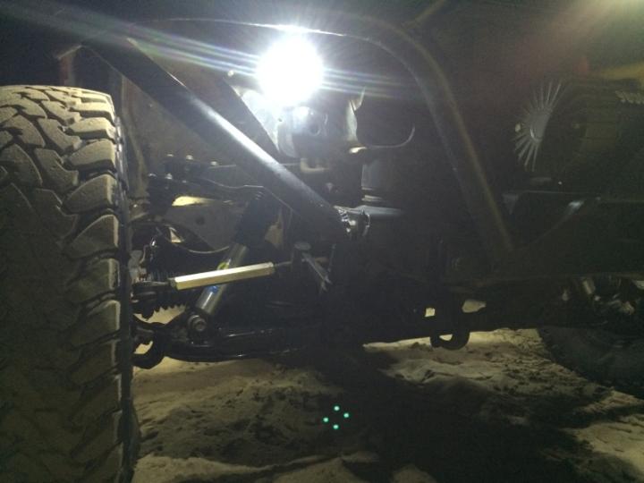

The light setup worked sooooo well at the dunes.
