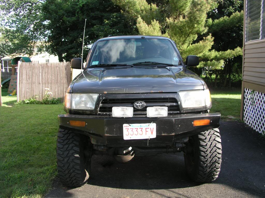

That is a 3rd Gen in the photo. I think the body is a couple inches wider than the 2nd Gen. Mine will look even more bottom heavy. I like that look.
