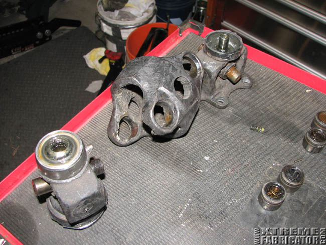

Okay so i did in fact build a driveshaft before you asked but ah it failed
Broke a ujoint. It needed to be replaced when i took it apart to build the driveshaft.
But here is how the 4runner sits now.
Inside the needle bearing area on the tube-side yoke the roller bearings are missing inside that center piece from when it broke. Is that repairable or do i have to cut off the ifs double cardon yoke and put another one?

so you're only missing the needle bearings? how exactly did it break? sounds like you could just replace the u-joint...

This part on the very left is missing the roller bearings.
I believe a ujoint broke which caused the whole thing to separate.

cheapest option is probably just to replace the whole thing with a JY unit... you can get the individual parts, but it'd probably cost you more.

Yea one of my friends was thinking about parting out his 83 and i was trying to bum the front driveshaft off him so i didn't have to clearance it. But i might have to get another one and clearance it properly
