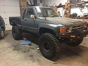

This might just turn into a picture thread, as I have tons to share. But I would like explain some of the more technical things I did and the problems I've had since, most importantly answer your question along the way. Anyways on with the pictures

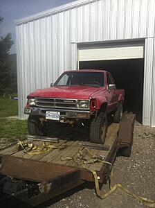

Day I brought it home
Current Photo

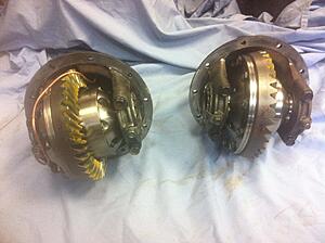

front diff all cleaned up and gusseted, ready for paint 88 pickup - Low SAS tech-08zwt2e.jpg

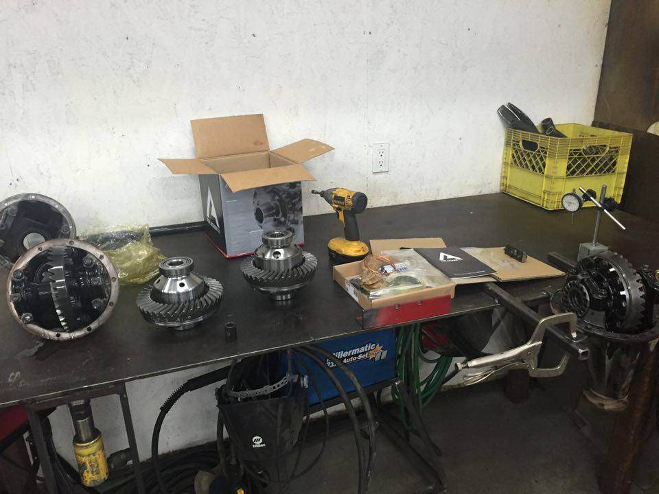

diff party at a buddies place
Mmm fresh Arb and Grizzly

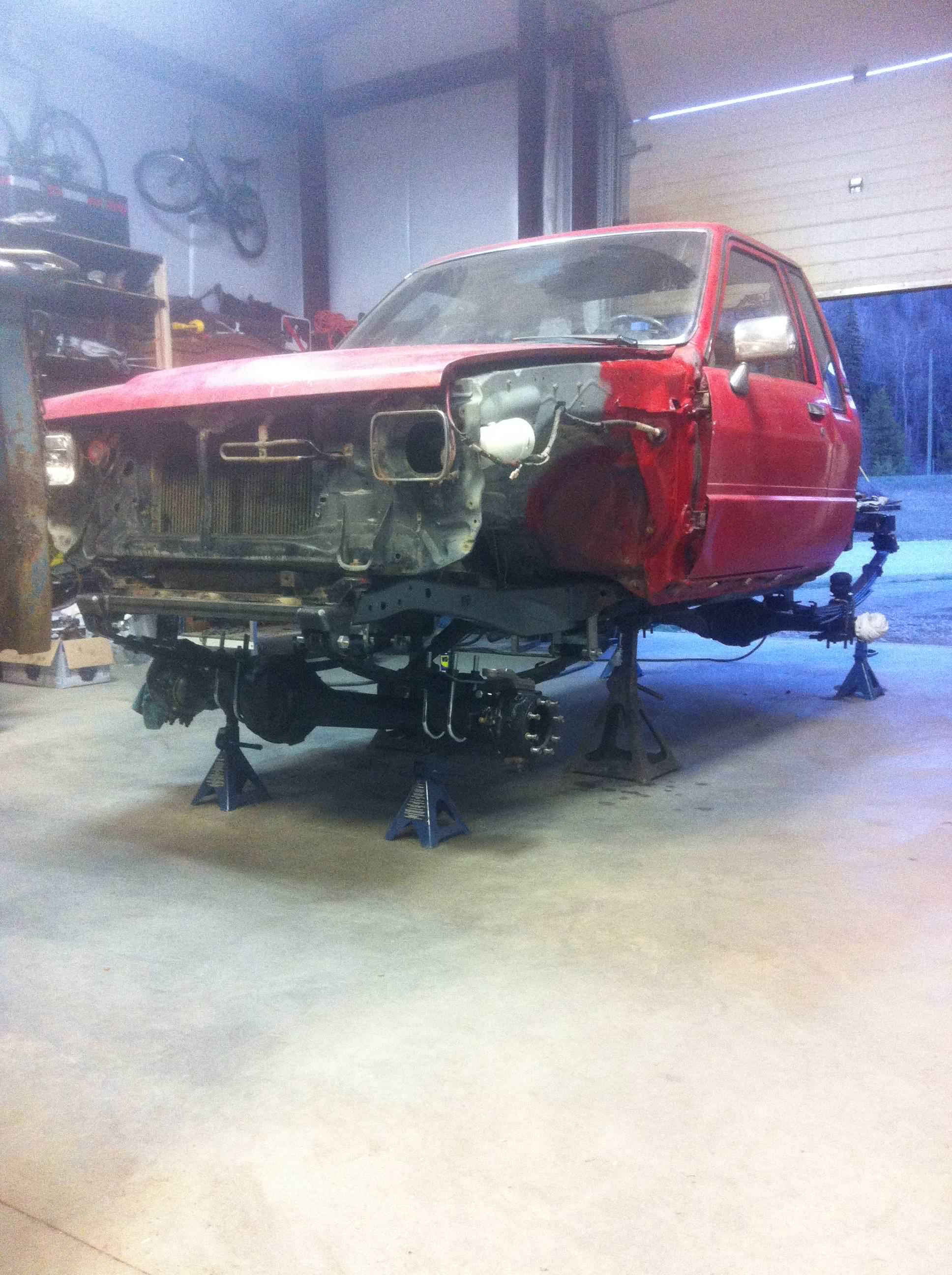

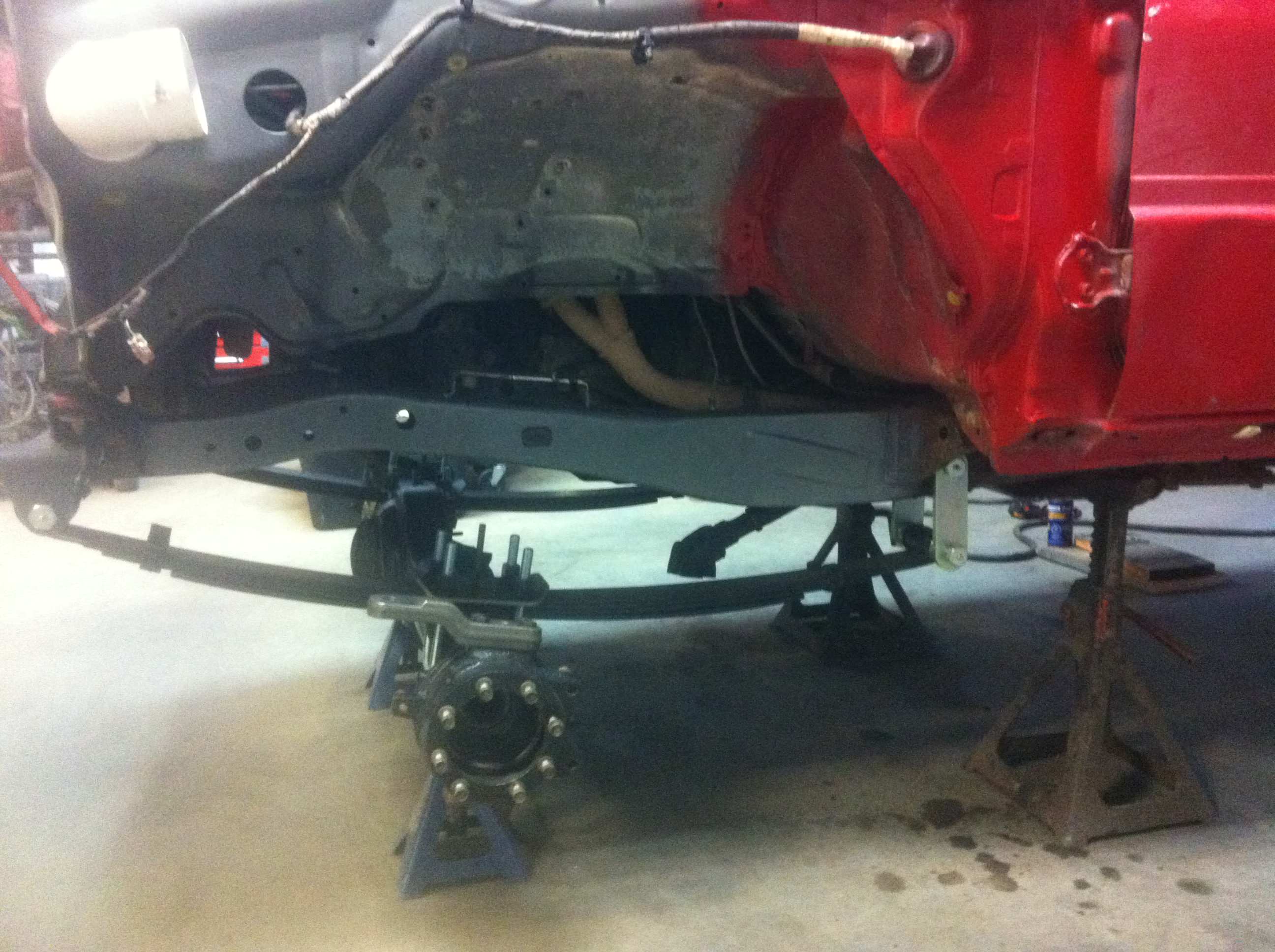

So after I got it torn down I started with the 63's first then moved to the front

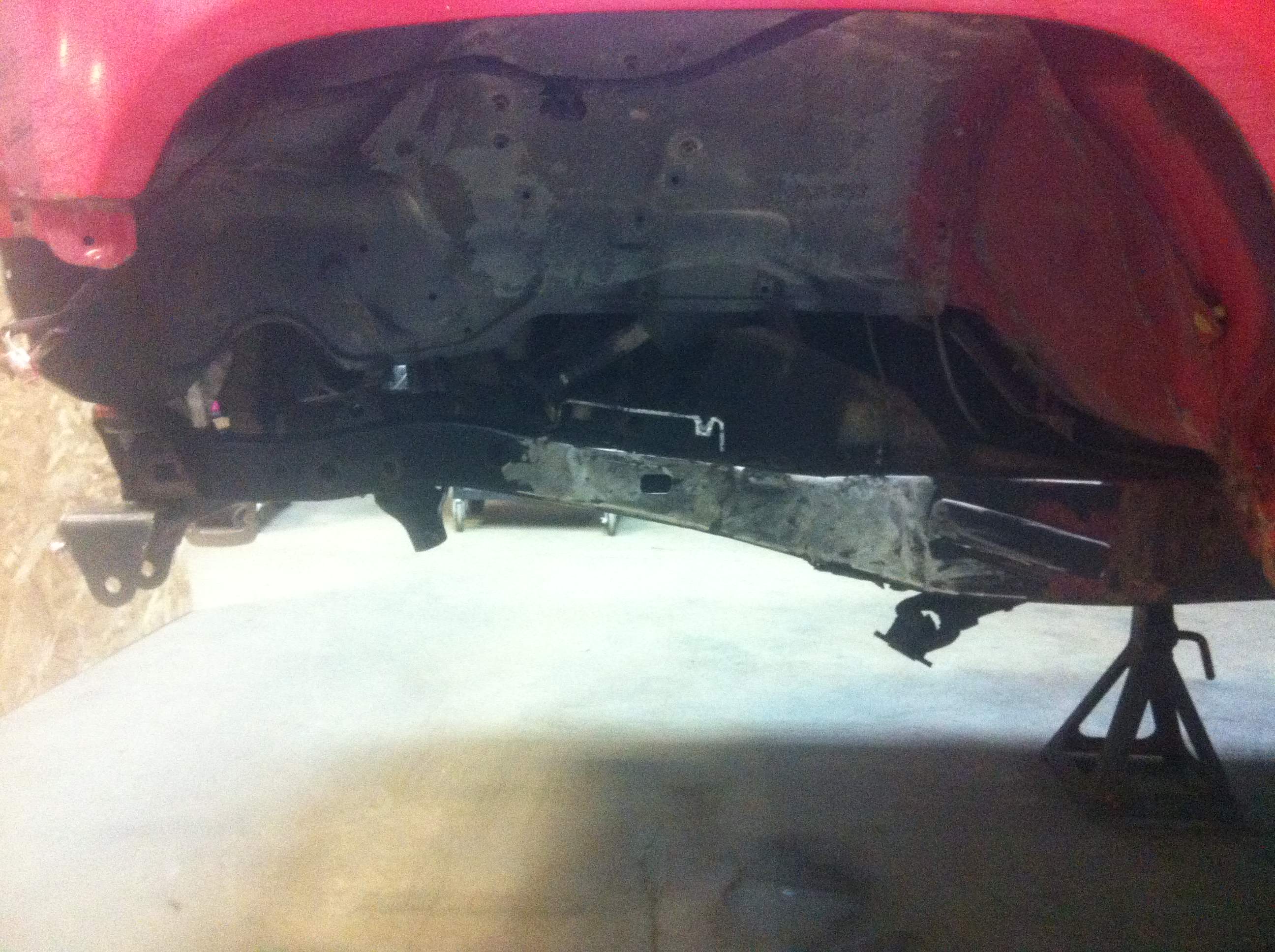

​​​​​​Frame tubes drilled and the front hanger mocked up88 pickup - Low SAS tech-5wqb3rm.jpg
Front hanger is currently raised 2" up into the frame and 2" further forward over a stock solid axle spring eye location ​​​​​​

What size tires are you sitting on in the grey picture up near the top? I've got 32s on my sas 4runner and they seem a bit small. I may have to go up to some 33s or some skinny 34s. I was trying to keep mine short as well but I went with Toyota front springs that were 2 in lift. I also cut my front shackles down to 3 inches. Yours looks like you have more distance between the frame and the axle. I've got 3 inches or so of up travel.
