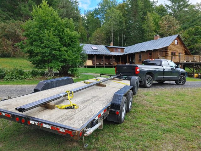

Picked up a few sticks of 1.75 .120 wall ERW to start on a cage.

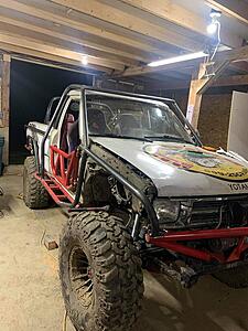

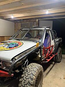

Not doing too bad for 3 guys who have never really bent tube before.

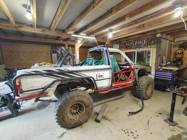

Little more progress on the window bars. Will do a crows foot on top.

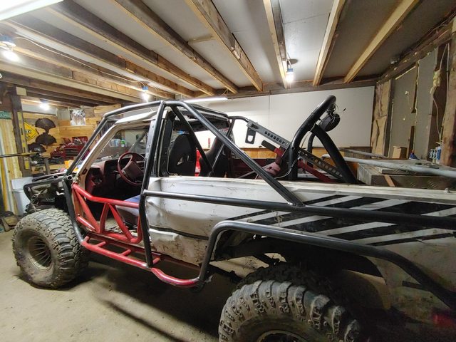

"fastback"
This will get one more horizontal bar
We did this without the cap around, but it "should" fit back on. Goal is to have it read for next Wednesday/thurs evening run

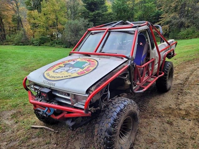

Still needs finishing, but got paint on some of it and took it in the woods..
