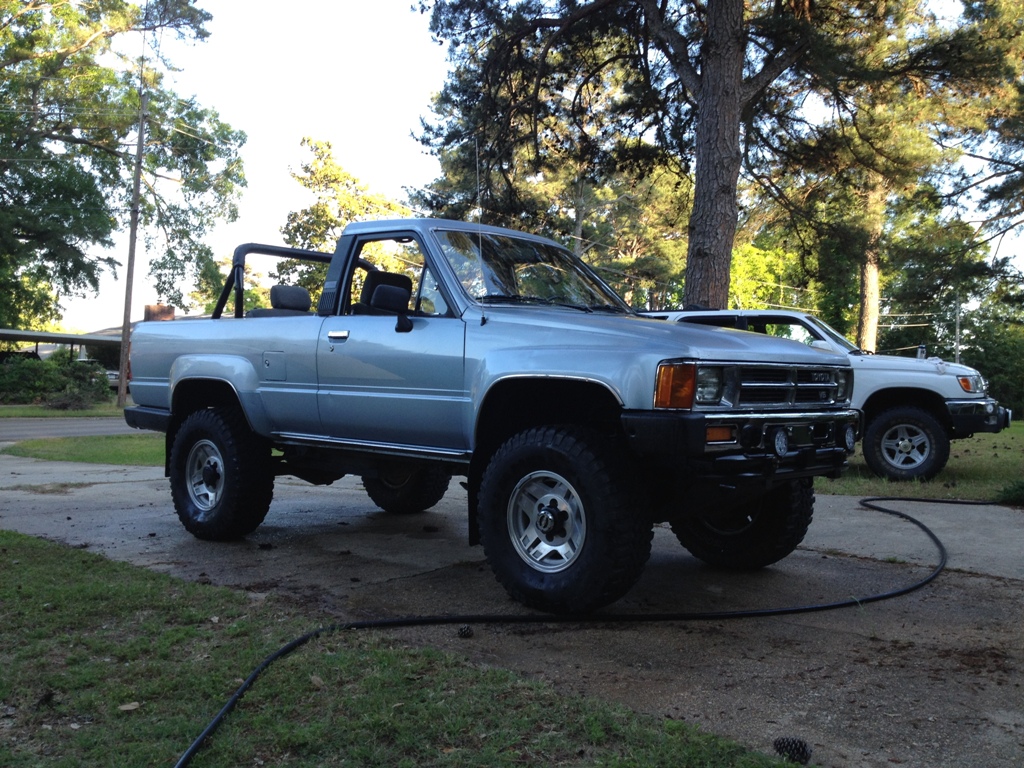

If you would consider a stock style bumper. I got mine on amazon for less that $40. As far as the budget lift goes, I have 2.5" ball joint spacers up front and 1.5" add a leafs plus 6" shackles in the rear. Here is a pic to give you an idea of what that might look like. I'm running 32/11.50s. Plenty of room for 33/12.50s.

My combination of add-a-leaf and shackles seems to work very well. You will have several options here. I used a standard duty add-a-leaf. They make heavy duty ones that are designed for extra weight but I wasn't planning on hauling or towing anything heavy. The shackles can be bought as greasable or with like Teflon bushings. Mine are the bushing type and haven't squeaked or anything up to this point. I have not put the suspension in any kind of rock climbing bind so I don't know their full potential but I have been very satisfied so far. If you start raising the back suspension pretty high, they make some wedges that go between the axle and springs. These allow the axle to be rotated a few degrees to reduce the angle at the rear u-joint. May want to look into this option. Also, if your spring packs are sitting pretty flat, you can buy complete replacement spring packs. These trucks are known to have worn out back springs due to the added weight of the cap that the trucks don't have. Check out Toytec for options there.
On the front end, the ball joint spacers are going to put your CV axles in a pretty good bind. They make a differential drop kit that is pretty simple and will reduce this binding stress. Even my 2.5" spacers were putting mine in a bind and I had to be careful when installing them not to leave them in a binded position. Also, the spacers are going to bring your wheel rim in closer to the upper control arm. Mine barely clears with the same wheels as yours and 11.5" wide tires. You may hit your control arms with 33-12.50s. If it does, you'll either need to grind a little off your arms or get you some 1/4" wheel spacers. Do a little research on that end if you're planning on running tires that size.
Check out Toytec first to get an idea of what you want to try. Even if you don't buy your stuff from them, you'll be able to see what will work and what you might want to avoid. They have a good reputation for selling products that work well and not selling ones that will get you in trouble. They also have installation instructions posted on their site. I have done business with them several times and highly recommend them.

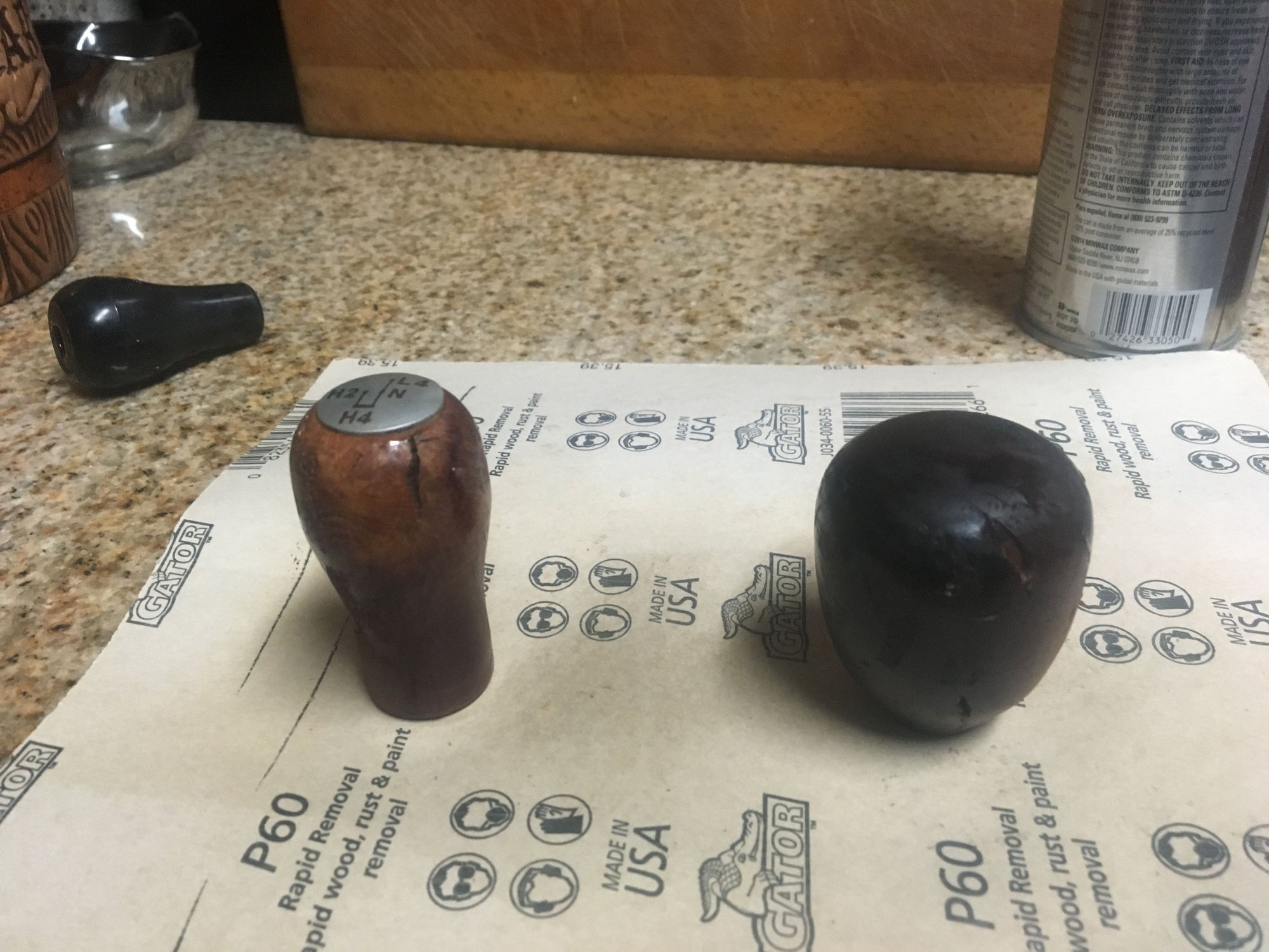

Only able to work on the runner on the weekend so I was able to finish up these manzanita shift knobs my neighbor turned on his lathe for me.

The knob on the left is beautiful. It looks like it would cost a lot of money. You could probably sell those.
I'd get all the mechanicals and body work up to speed before spending a lot on the lift. It doesn't hurt to plan though.
Thank you, I really liked how it turned out. I'm almost thinking of redoing the darker one but I'm not sure yet.

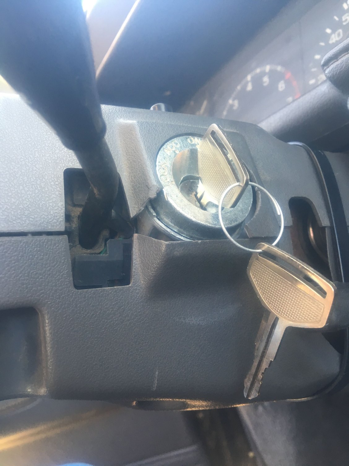

Finally found the right ignition cylinder lock! Time to smog and get her on the road!

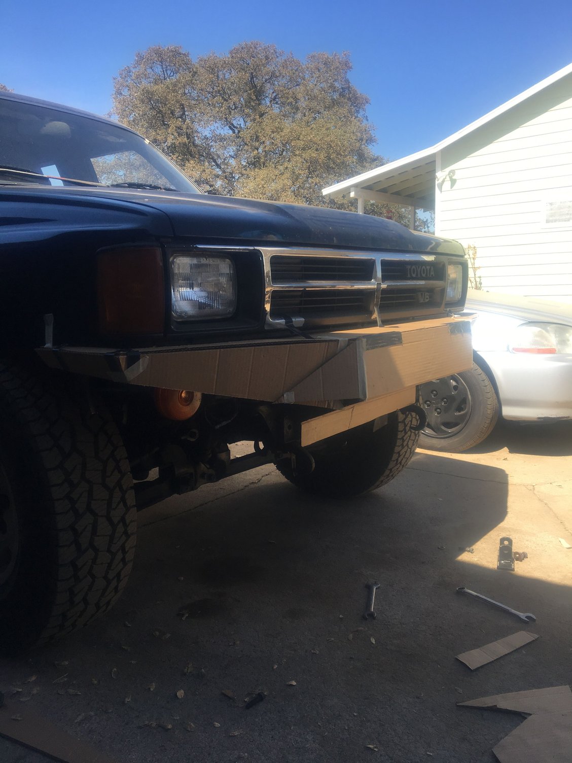

Started making a template for a plate bumper! Can't wait to start building it! Buying the metal today!
