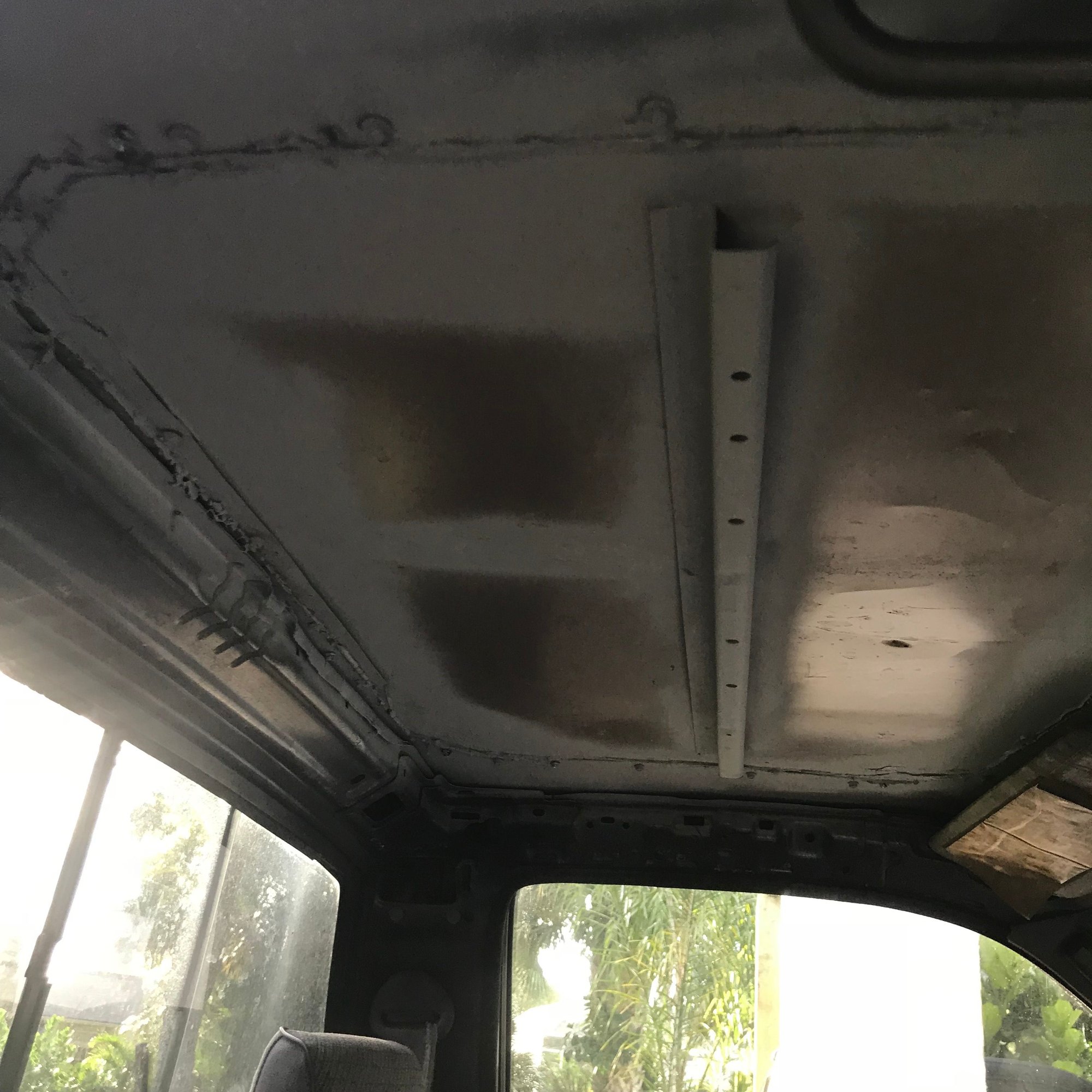

As you see the truck had a sunroof at some point (dlx trim ) the owner fixed with it with metal screws and some silicone. Doesn't leak not to sure what im gonna do with it leave it? try and replace it better? cut the right size of metal out and have my welder weld it in then sand the welds?

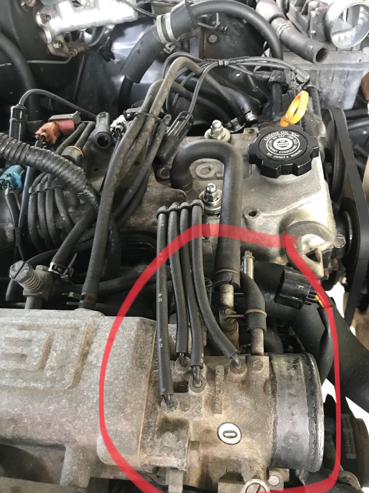

also this is probably a stupid question but just to be clear when you say throttle body you mean the section of the upper manifold that I can separate that houses that butterfly valve correct ?
The part circled in red correct ?
Yes that's the part the one you have circled in RED. There is a gasket between that and the plenum some kits do have them. Also there is a rubber gasket you will need for the IAC if you take that off. I really haven't messed with those, but have read up on them as my 22re is an 86 and 87 so i have a different IAC and slightly different throttle body.

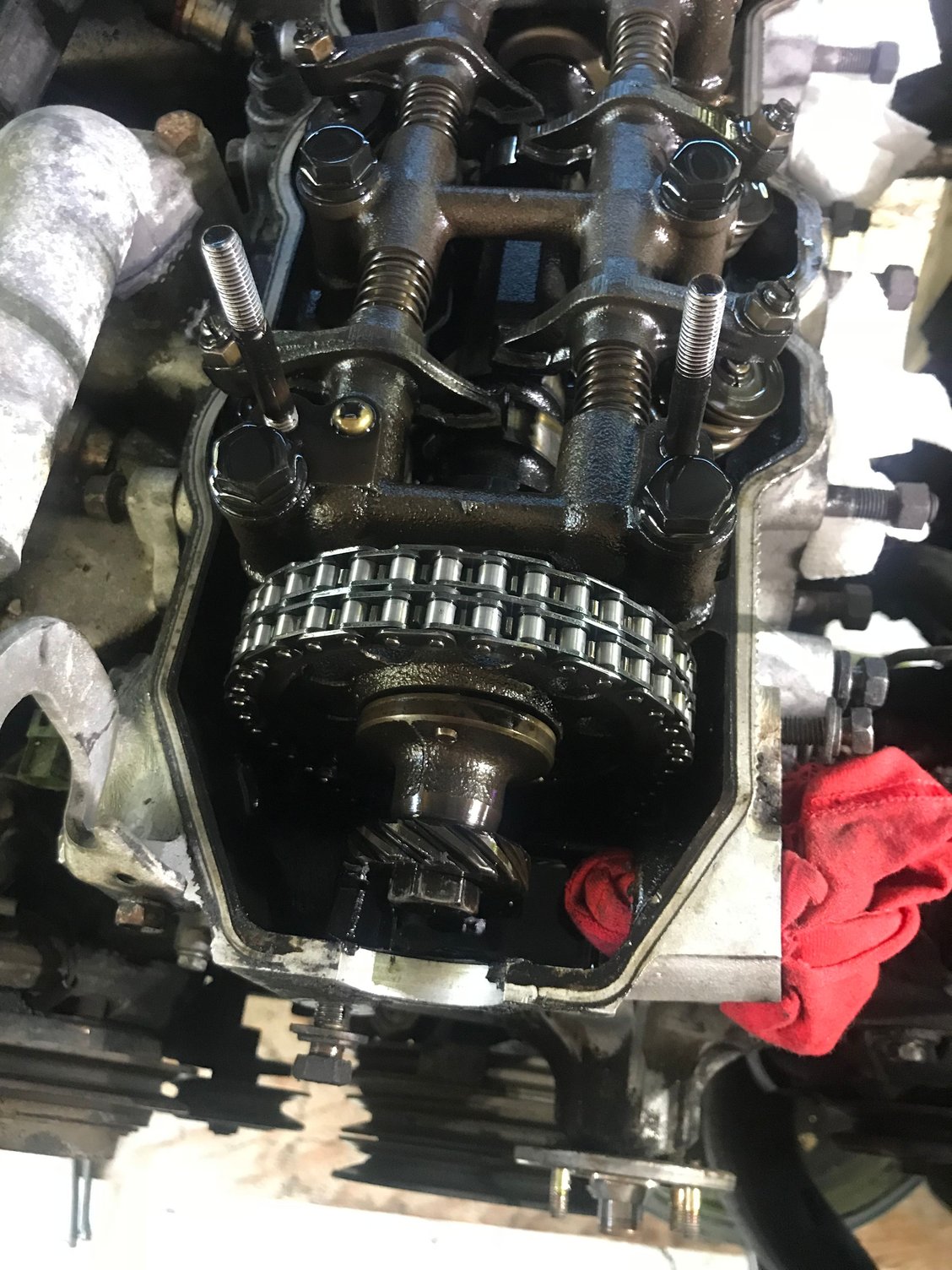

popped my valve cover off finally and found this nice surprise. Previous owner did a dual tow timing chain conversion and it looks to have been done pretty recently. I’m thinking I’m going to leave the dual row chain that’s on there alone since it looks pretty new and return the single tow kit back to 22re performance. I’m hoping the gaskets I have for the timing chain cover still work since I’m pretty sure to run a dual row chain you have to have a different cover or a modified one.

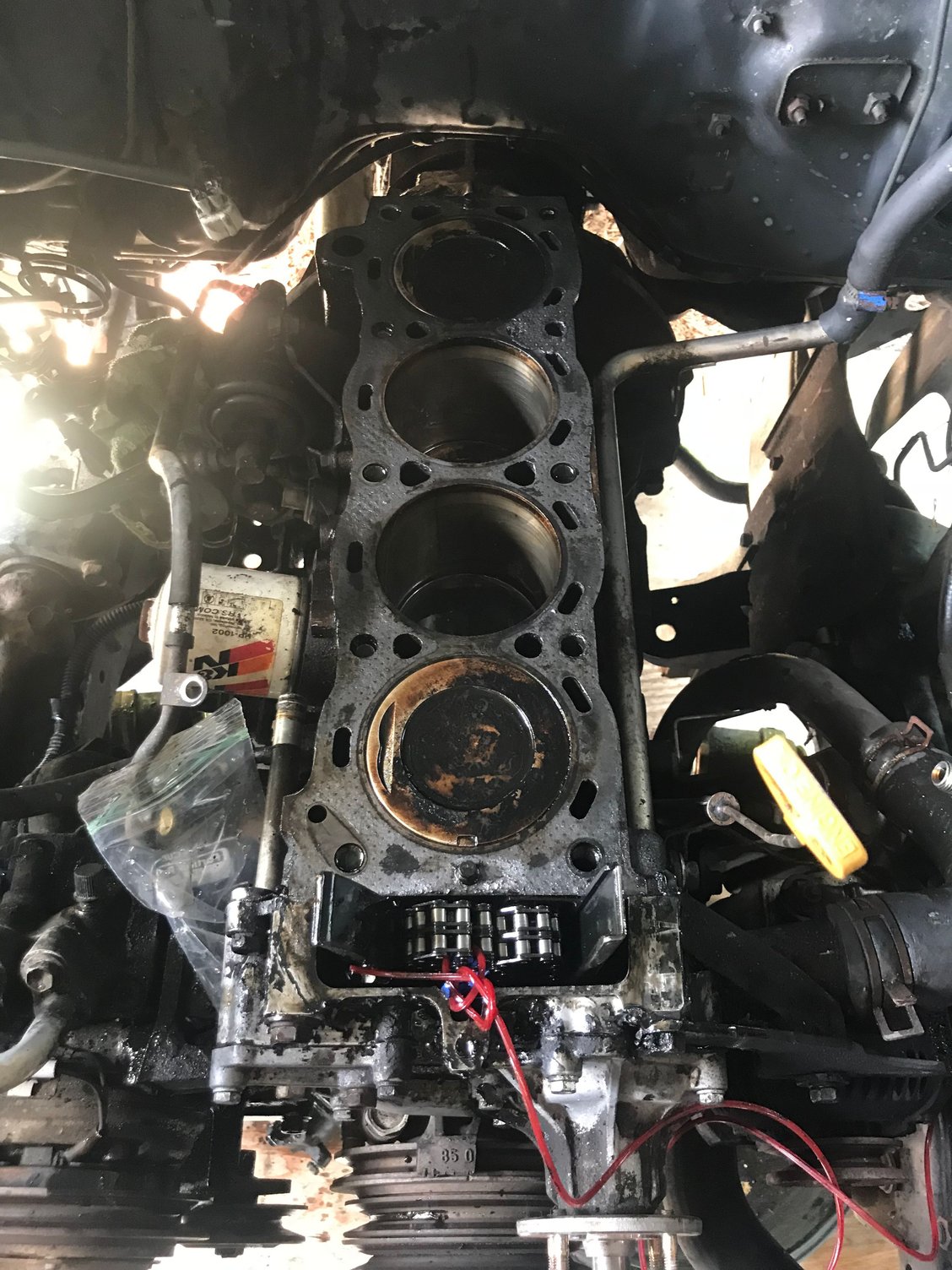

Got the head all of the way off cyclinder walls seem to be good along with the Piston surfaces. I’m really thinking this motor has been rebuilt before maybe somewhat recently which leads me to my next problem. The head measures 3.756 overall thickness which is much smaller then what I’ve been told is stock 3.780. I’ve been told I should run a head shim to make up for that difference and prevent slack in the timing chain and maxing out the tensioner. Anybody have any input or experience with this ? I have read the lce page about head thickness that says I need to measure from the cam seat to the bottom so I’ll probably bring the head into my shop within the next couple days and check that measurement on a height gauge along with checking for flatness of the head.

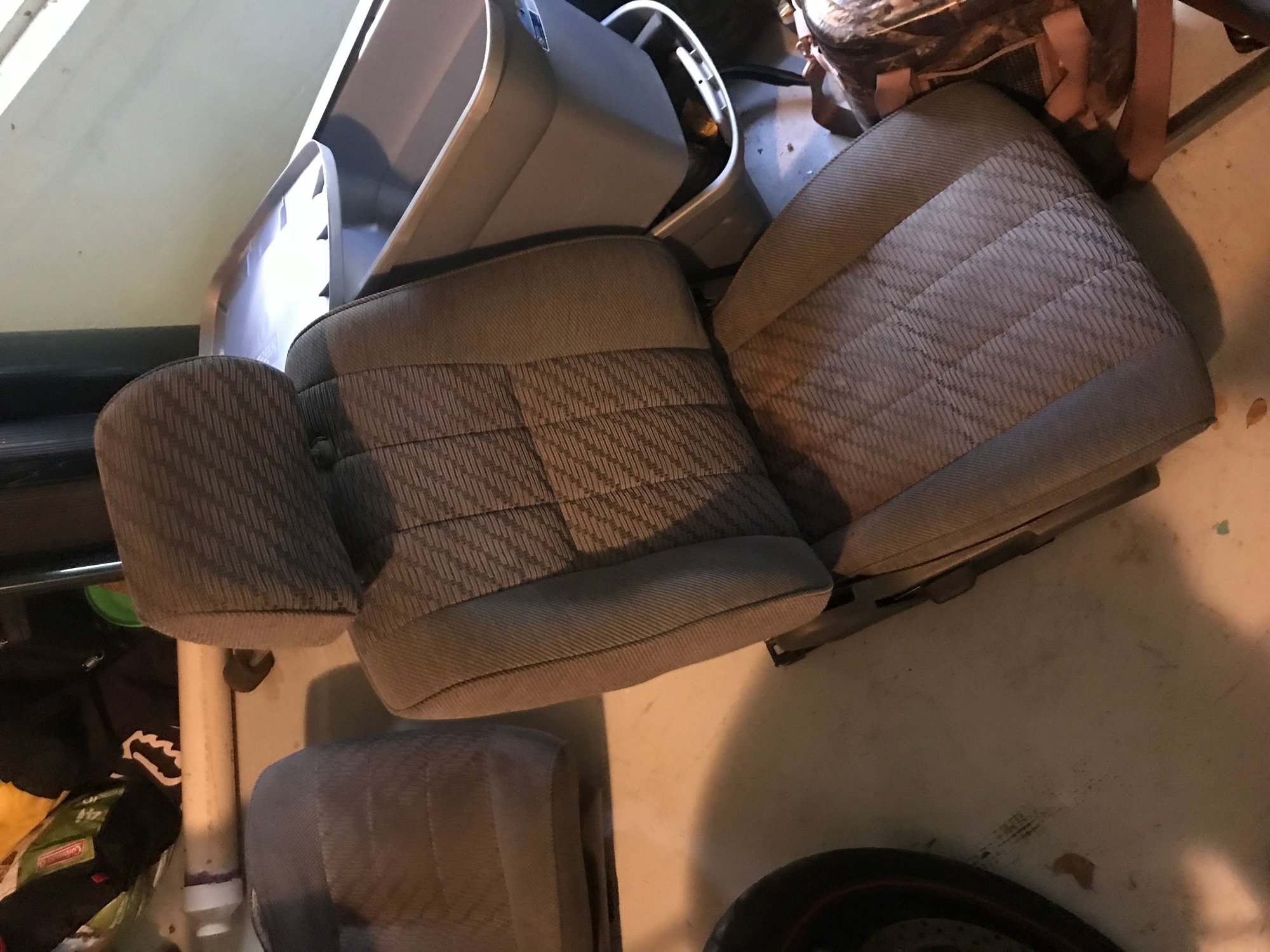

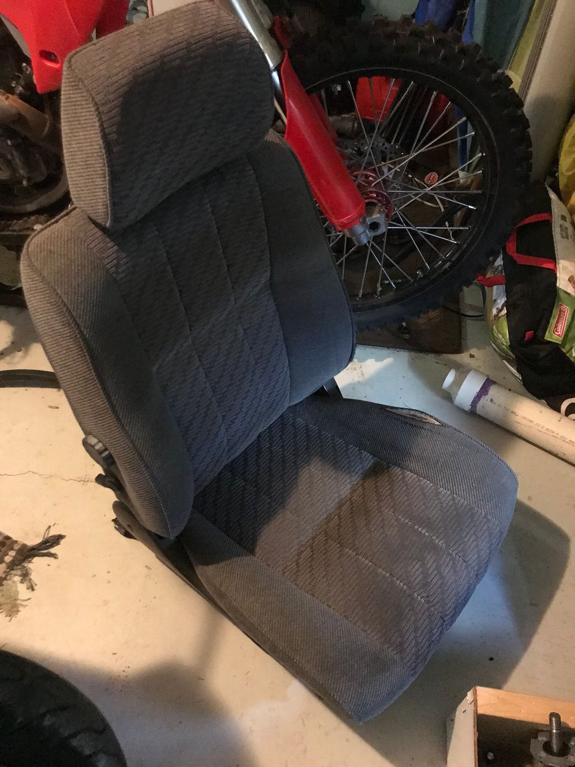

Also managed to pickup two front seats outta a 93 runner for 100$ and let me just say there about perfect and seem to be even comfier then the seats in my 99 sr5 Tacoma daily. Pretty happy with this pickup even though any kinda interior work is waaaaaay down the road for me

Nice going on the Dual Chain, that alone is worth a bunch.
Nice score on the seats.
