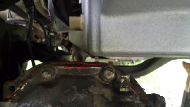

Old Apr 2, 2014 | 09:25 PM
magpede's Avatar
Joined: Apr 2014
Posts: 81
From: South Carolina
I know this is one yall probably wanted to see. Pay no attention to the silicone...previous owner's work.
