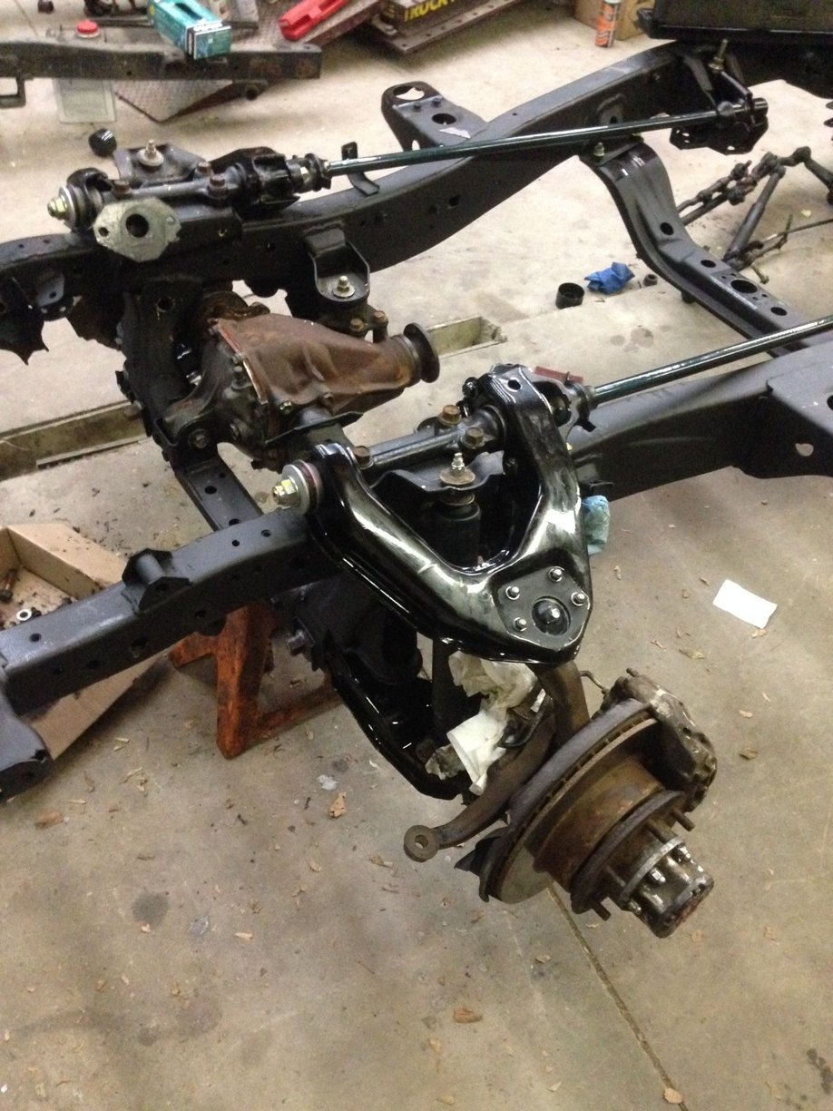

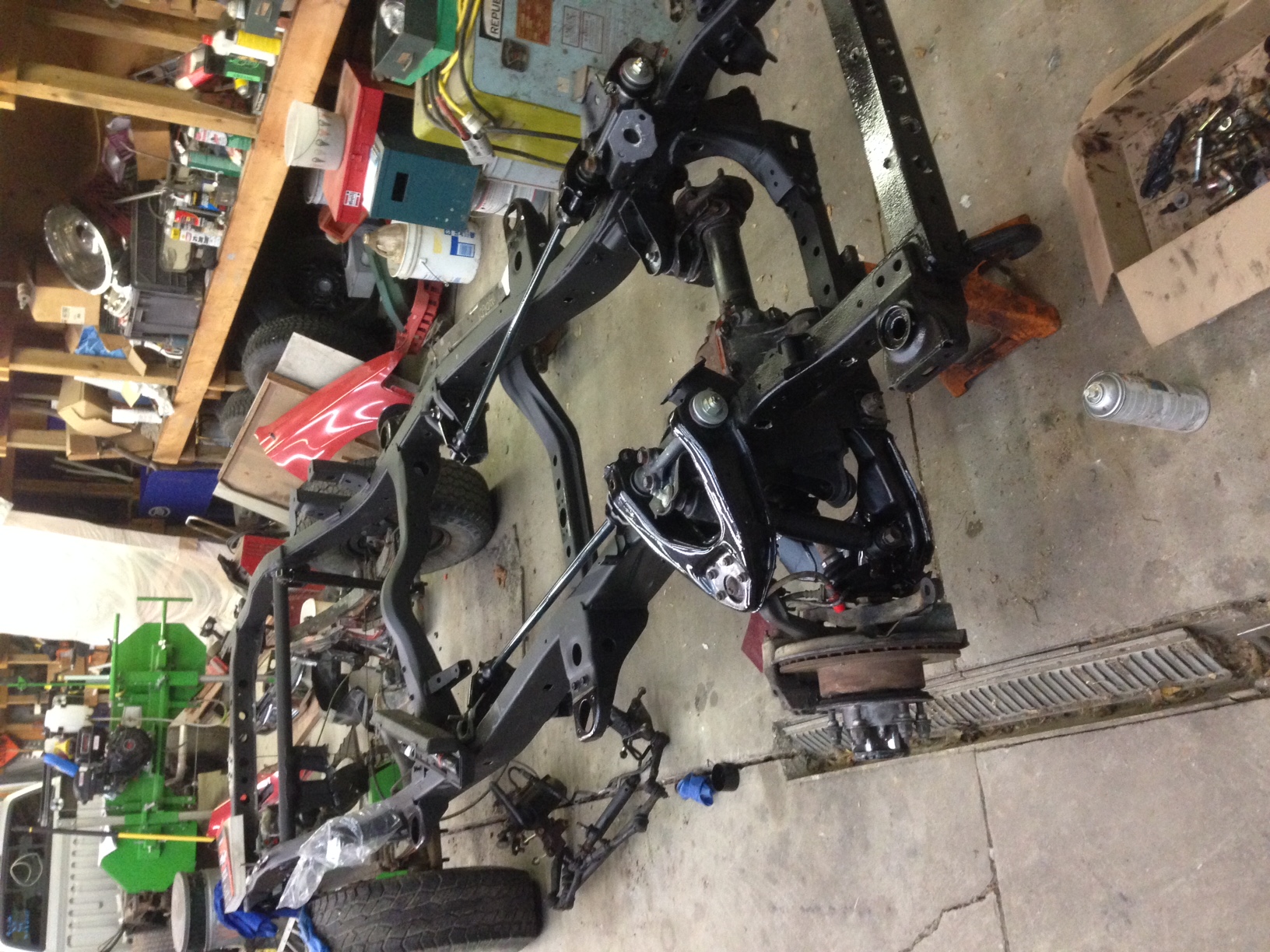

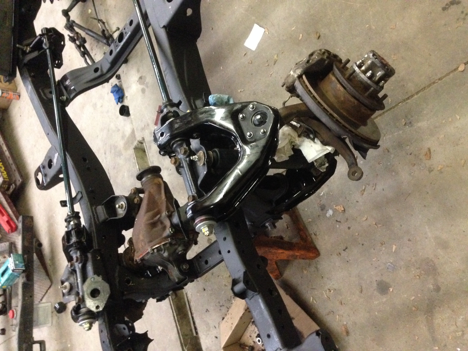

Thanks man! I'm pumped to get it back on the road! So i'm close to finishing assembly of my front suspension. I plan to get the chassis rolling and set the cab on the frame. Then weld the new front piece to the cab while all the body mounts are bolted to the frame. Then patch all the rust holes in the floor. Then take the cab back off to put the engine and trans in. Then put the cab back on for good and put everything back together. This will probably take me a couple months because i'm just doing it at night, and things are going to be pretty busy in the next month or so.

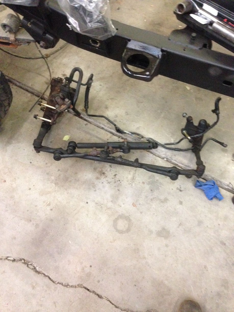

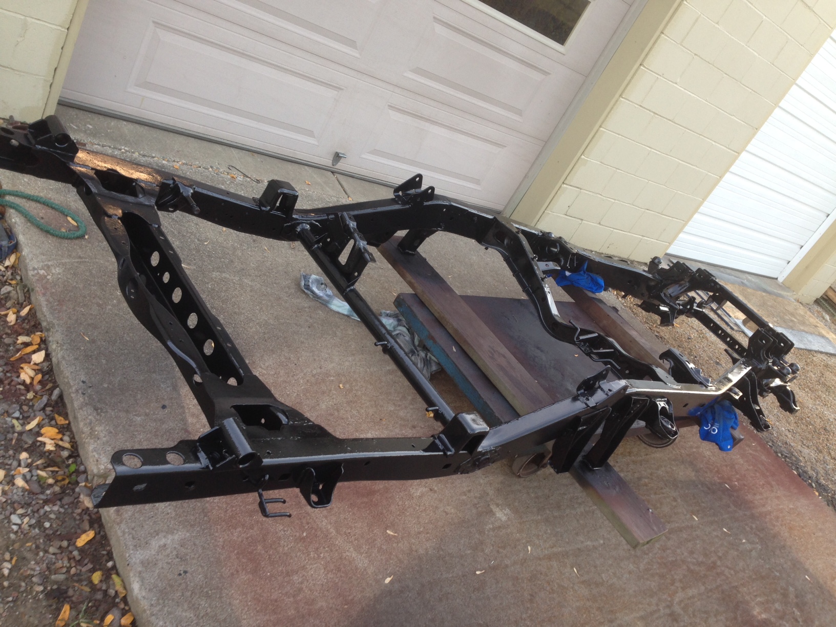

So its been a while since I have been on here due to Christmas and stuff but I have finally made some more progress on my truck. I got my steering box, idler arm and steering relay rod installed. I'm still waiting on my tie rod assemblies from Toyota. I tried both a Monroe and old man emu steering shock. Both of them hit the frame when the steering system was fully locked to the left. They both hit the ear that hangs down from the frame. It looks like the pitman arm would hit this ear on the frame when the steering is at full lock. Has anyone else had this problem? Maybe once I get my tie rods the steering will stop before the shock hits the ear on the frame. I guess I just need to wait until I get my Tie rods and go from there. I should have taken a pic of that but I was not thinking of that at the time.

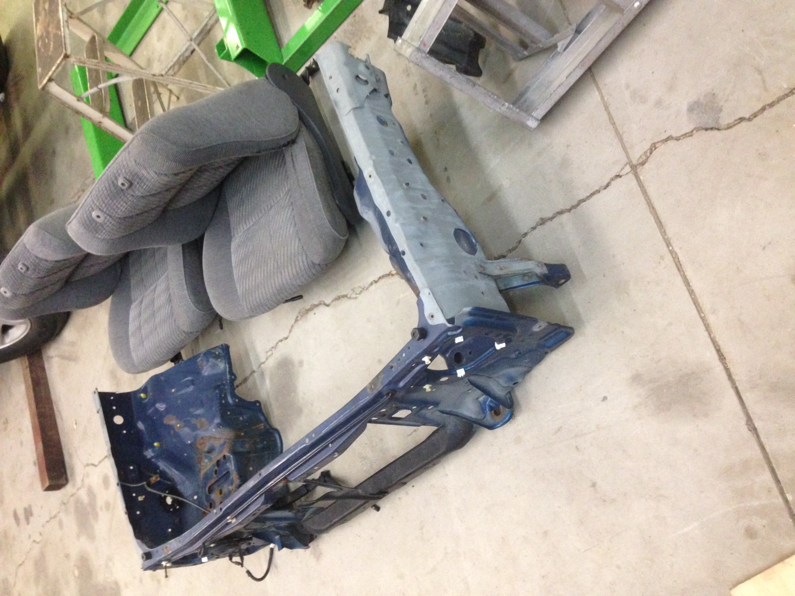

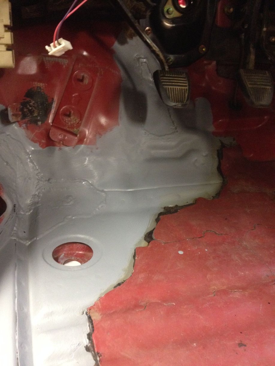

Well I do have a pic or 2 of how nasty my inner fenders and firewall were. I guess all those years of spraying cosmoline on everything caught up to me. Anyways I spent about an hour pressure washing that off and I
did end up getting it pretty clean
next I rounded up some help and we sat what was left of my cab up on my new frame
A few hours of working on it with my dad later and we had the new front piece welded onto the cab. This was a little more involved than I had originally anticipated. We had to put the doors back on to see if the fenders would line up. Then we had to put the fenders on to see if the hood would line up. It took a decent amount of adjusting and bending things around but we got it on there pretty strait. Its not perfect because my cab is still a little messed up but the outside body panels fit just fine and I will be well satisfied with it. I am glad we spent the time to trial fit everything even though it all came right back off. I will know it will work when its time for
final assembly.
I still need to finish welding this together but it is on there good enough where it is not moving around as its worked on. Im so glad to be making a bit a progress on this again! My goal is to have this truck done in about 2 months but it will probably end up taking me longer.

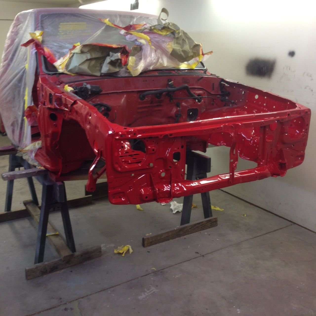

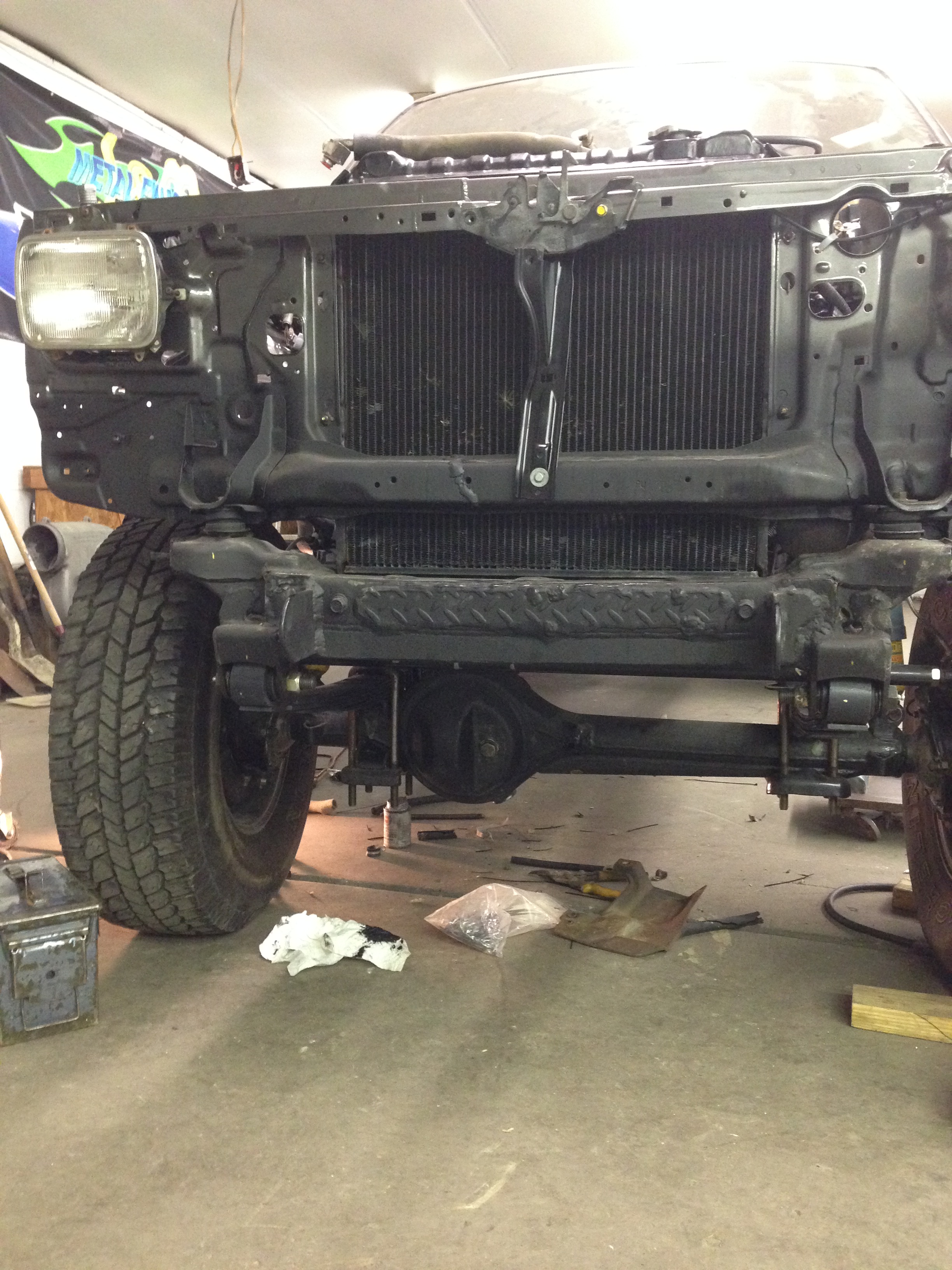

I removed my cab from the frame again in order to paint the cab and lay the motor and trans on the frame a little easier. I know this is not really necessary but with absolutely nothing hooked up to the cab it is just a matter of removing six bolts to get it off, very much worth the convenience to me. The first thing that I wanted to do was paint. The weather is abnormally warm for this time of year and I want to take advantage of It while I can. It's not crazy warm out but at 40 degrees or so I have a hope of getting the garage warm enough to paint, normally it is colder than this in January
here I have it all taped up and in prime. I used a urethane primer and it seemed to work quite well
after the primer I used a couple different seam sealing products on the areas that I worked on, some of the stuff they put in the wheel wells from the factory was wearing off, in those spots I sanded out the bad areas and spread some seam sealer to try to match what the factory had
I put one more layer of primer over the seam sealer stuff and then finally put down some color on this thing. It does not match perfectly, it is a mix off all the extra reds we had laying around, but I think it looks fine for being under the hood

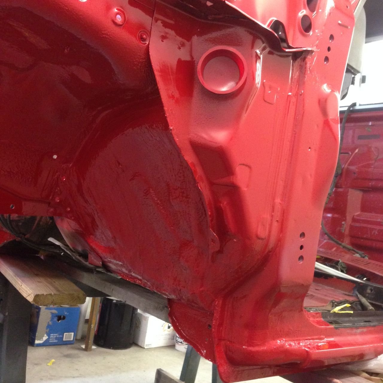

I was talking about the factory coating in the wheel wells coming up. Even where it was not coming off there were cracks in it. I'm guessing all of the times I pressure washed the underneath of this truck sorta tore that coating up. Anyway, I put the clear coat on really really thick down there to try to fill in all the cracks. It had several runs under there which is exactly what I expected, but I'm hoping it keeps the cracks filled up and holds that stuff together.

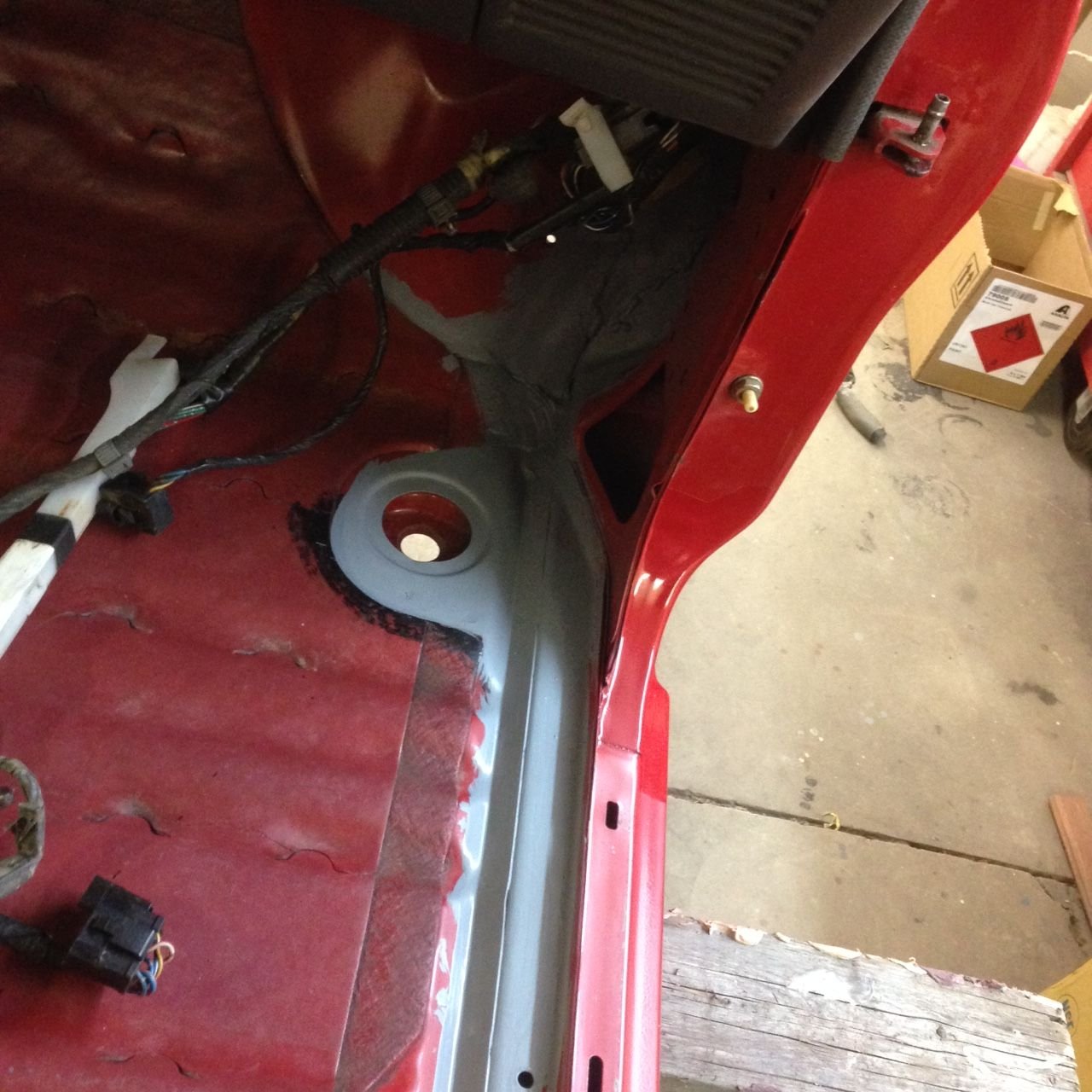

inside of my floor where I patched things up, and for some areas where the rust was not severe yet but the paint definitely needed to be replaced
I used a brush to put this stuff on. I know it is supposed to be applied with a gun, but I did not want to have to worry about masking the inside of the truck and getting over spray and what not. I'm not sure if brushing it on will be a problem or not, It might have been too thick to dry properly but it will be a good experiment and I will have a better idea of if it works next time.
I'm definitely letting this stuff dry a couple days before I put the color and clear on, also brushed. Again, I know this is not how its supposed to be done but this will never see weather, and I think ill be able to tell if its working before I put the interior back in a few weeks.

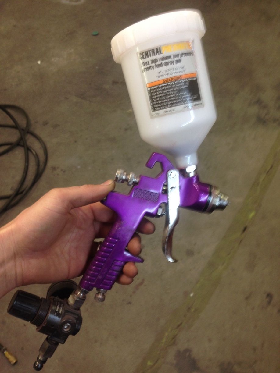

I could have mentioned this earlier, but this paint gun is awesome. my most recent paint job under the hood was nothing special but I have also used this on several more showing paint jobs and it works great! It sprays just as good as other guns I have used that were 10-15 times as expensive. You can pick up one of these bad boys for around 10 dollars at hft if you wait for it to go on sale. I keep a few brand new ones around. I hardly spend any time cleaning them out. If it gets bad I just use it for junky stuff or throw it away and break out a new one.

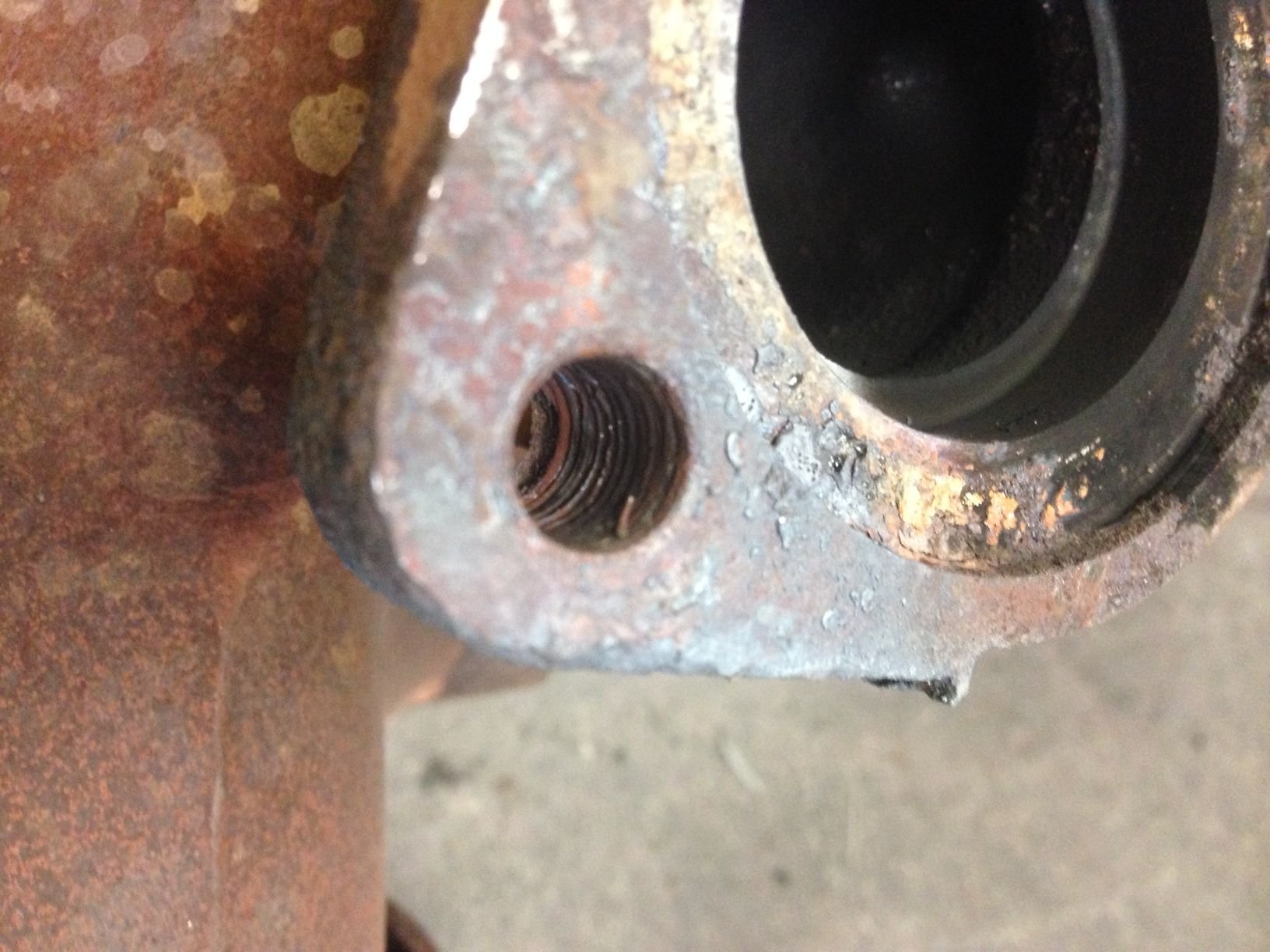

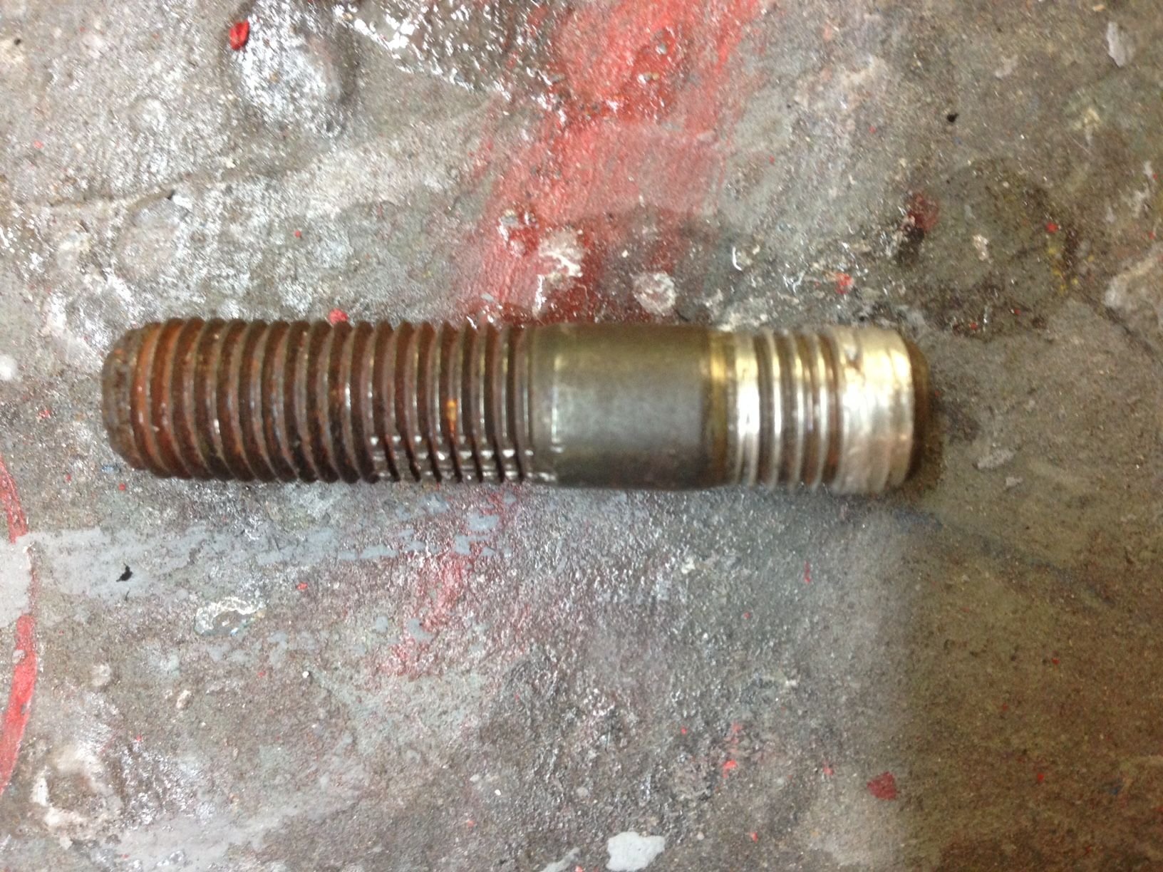

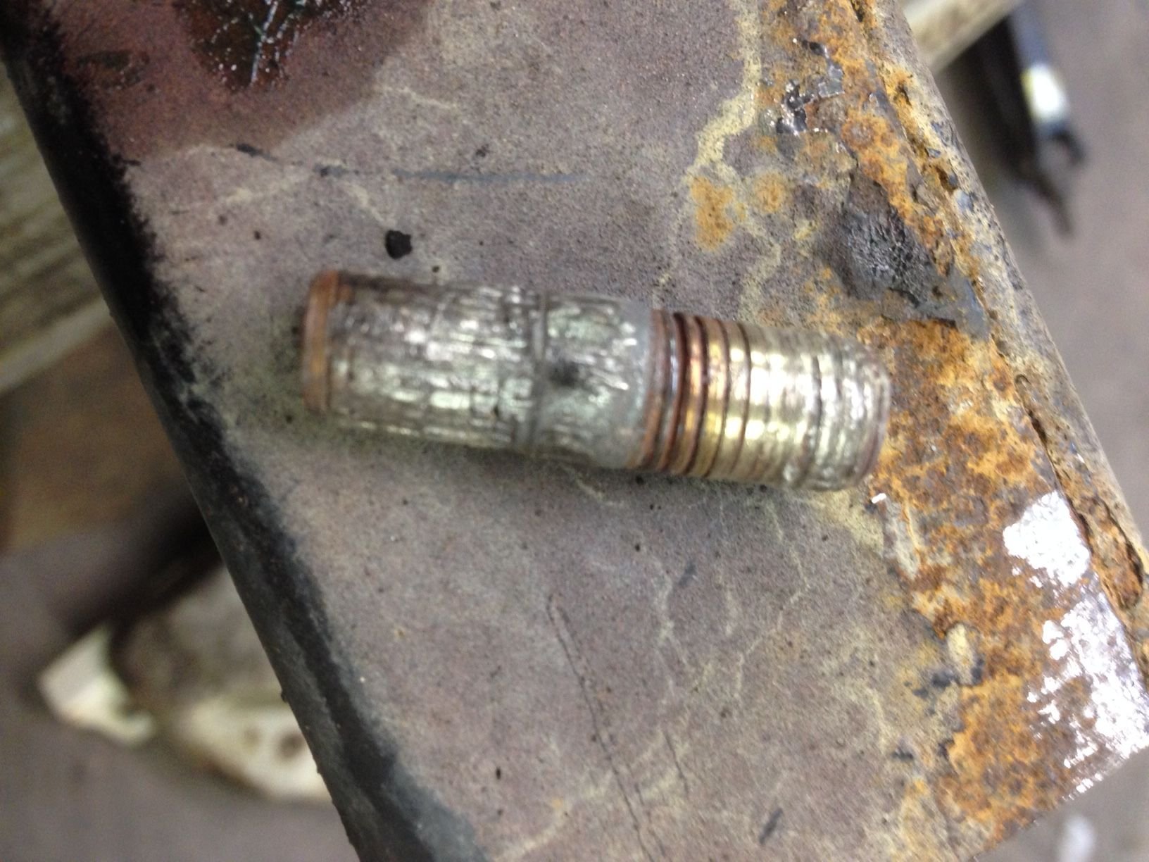

This is after I gave up on using this manifold. The stud that was already broke broke off even shorter, the other one came out but stripped the threads out on it and the manifold. At that point I did'nt even try the third, ill just have to use a different manifold I have that has good studs.
here is the stud I actually got out of that thing, the threads in the manifold looked just as bad. At this point I removed the manifold, I almost had perfect success, but one bolt took all the aluminium with it.
this is the nasty hole it left in my cylinder head. I am not yet dedicated to a plan yet, I'm going back and forth on using a helicoil, a time sert, or just re tapping and getting a bolt that will reach down to the threads in the bottom that were not damaged. That last option is probably the easiest. I did some very careful measuring, if I used a bottoming tap I can probably get almost the same thread engagement as the original(only short around 1 thread)

Out of curiosity, do you think the Harbor Freight spray gun is as good as ones you can buy from the parts stores or Lowes or Home Depot? I want to get a spray gun just to practice with in the future.

Hey, I thought I was crazy and that I was the only one who thought so much of the Harbor Freight cheapo spray gun. Like many special tools, I bought one from Harbor Freight just to see if I liked the process of painting with one before I invested in a good one. I got one like you have and loved it. I painted a metal locker with it and it looks like the metal was struck from that color steel. Flawless! I said, "I'm a natural at this painting thing!" Invested in a good setup and have never been able to replicate the results from the $15 rig. That may be a topic worth a thread of it's own.

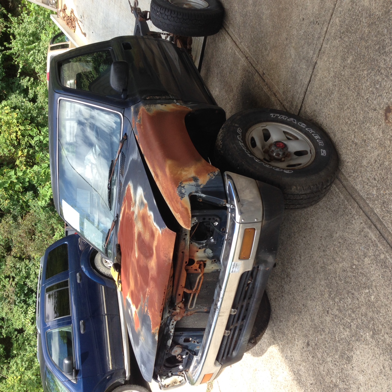

The bed on this truck is actually off of the same burnt truck that I got my new frame for my red truck., there is a pic of that truck at the beginning of my build thread. I did spend some time wet sanding and buffing the bed, I think it looks great, but don't expect the hft gun to do quite this well without a little extra work after painting. This bed used to be blue.

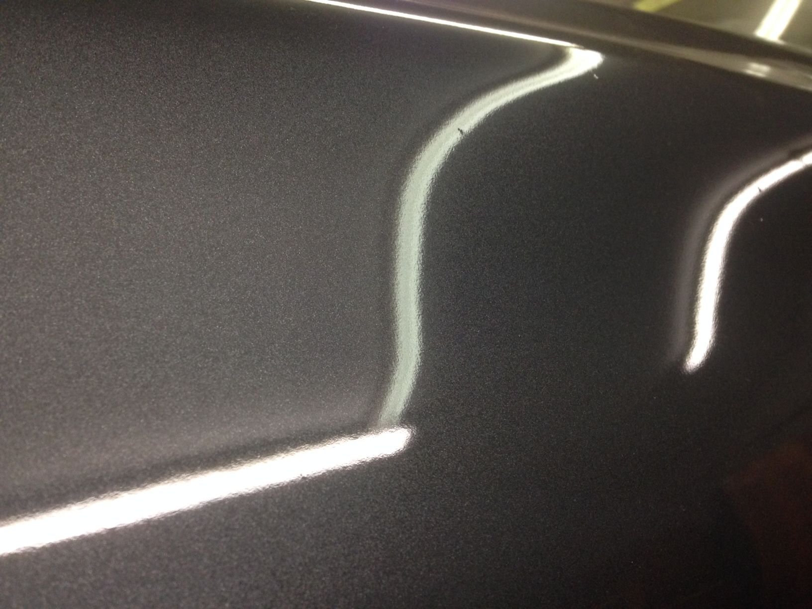

this is a close up of the fender. I did not wet sand this or buff it at all, this is exactly how it looked after the paint dried. This fender was red before.
This is an even closer up of the same fender
There are definitely flaws in this paint job that you cant see in the pictures, but I am very happy with it! especially when you consider that It was done outside with a 10 or 15 dollar gun.
oh, here is the regulator I have on the hft gun. can't remember where I got it, very likely it was also hft

Nice! That paint looks great!
The paint that hasn't been buffed looks smoother than I expected.

Thanks! It is pretty smooth, it has a few runs and stuff in it but i'm very happy overall
