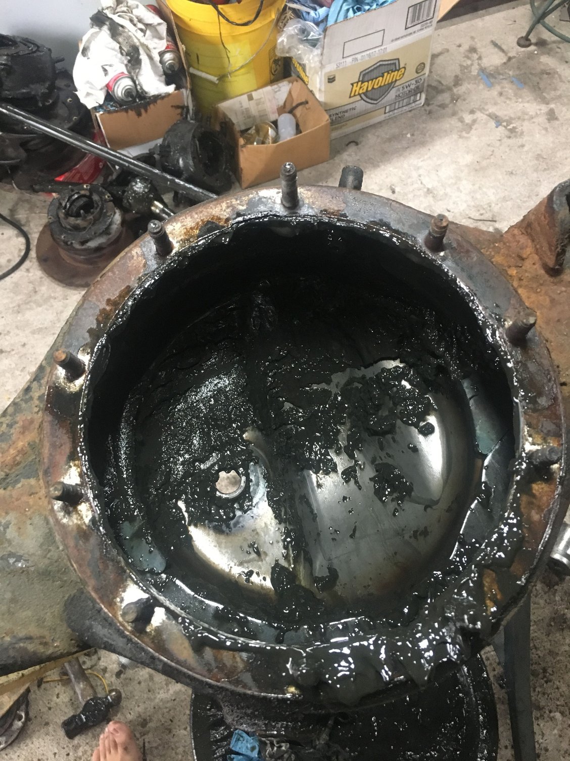

starting to work on breaking down the front axle now. Once i got into it i noticed it is slap full of what appears to be Grease. would their be a reason someone would deliberately fill it with grease? or is it just that old and has water mixed in that the oil got to that consistency?
got the front on jack stands
axles and stuff out
yummy
like i said its like grease. bringing all the parts to work to clean in the parts washer to see whats all good and if anything is unusable. will be updating with pics and what not as i get further into it.

mmmm mmm mmm looks like Birfield soup . could be whoever had it kept adding grease to the knuckles with a bad seal? letting the grease and gear oil mix . your is a lot thicker then what came out of mine though .mine was actually missing the driver side seal ....just not there ??? sometime people use heavy thick grease to mask problems like loud bearings or slow a bad leak . or maybe they thought moly fortified grease goes in the third too ?

Yeah i might have. That pic was taken after i took everything apart. i didn't disassemble the axle with no shoes on lol.
