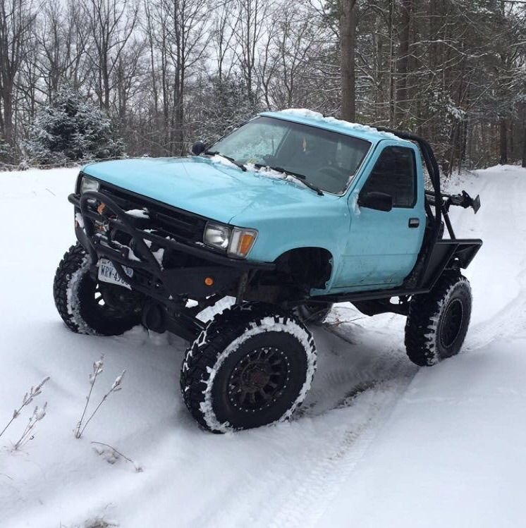

Sas all done with front and rear lockers, 5.29 gears, 3rd member rebuild kits and 5 37inch maxxis trepadors wrapped around pro comp 17inch Rockwell rims in the mail! Nex I'll finish up the rear figure out what I'm gonna do with the fuel tank and start prep for paint before it gets to cold then it's flat bed and maybe Alittle exo cage!

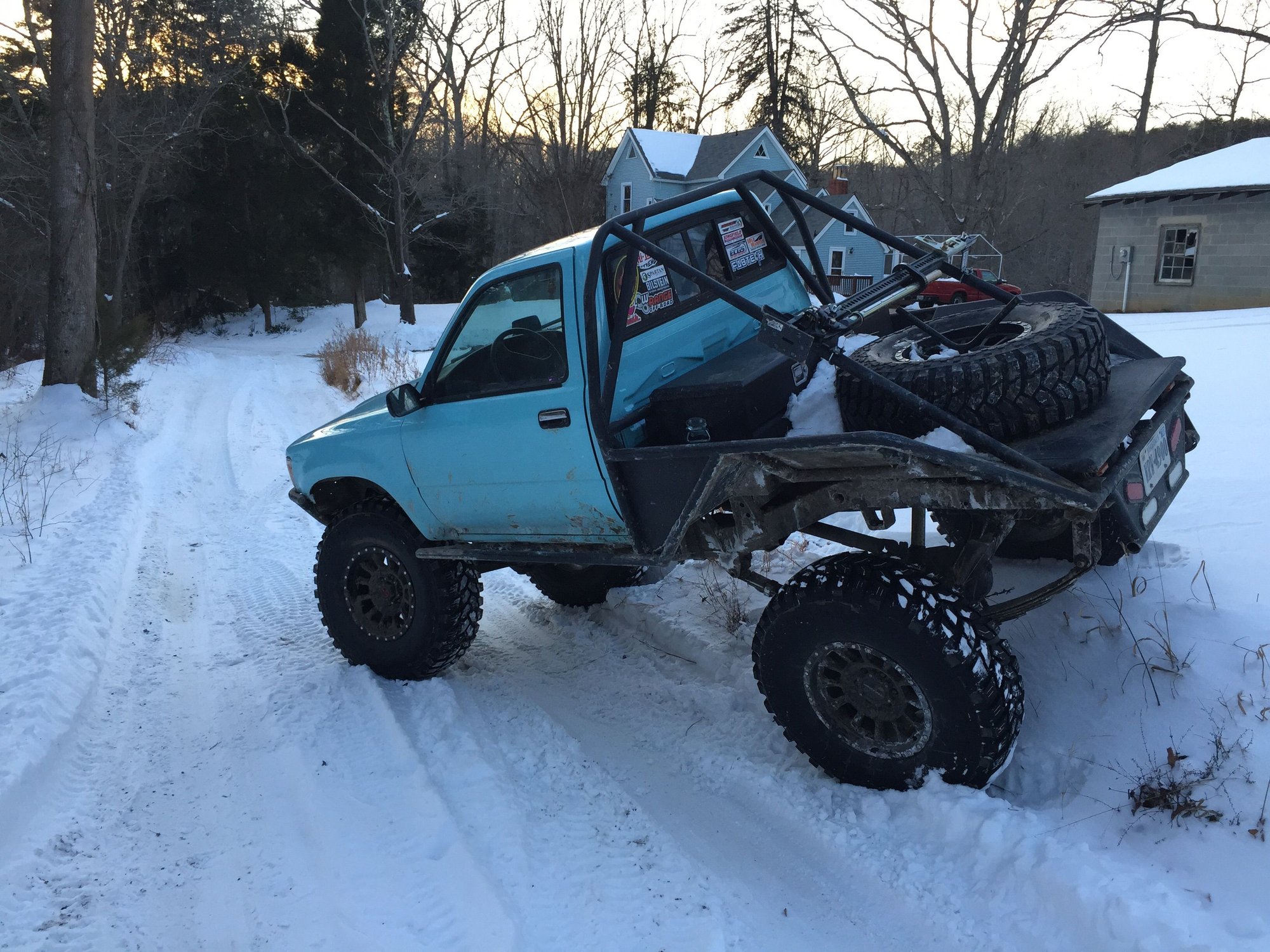

So after none stop work the whole month of December and getting tired of staring at the truck and garage walls we finished the truck for now long field axle shafts 6 shooter knuckles Spartan locker front and auburn limited slip rear custom sliders and flat bed 37inch maxxis on 17inch pro comps new 22re from promar bed lined interior with corbeau seats, mile marker scout sec 8 winch up front.we ran into a few silly snags broke the bender, blinkers wouldn't work, front drive shaft. Then test driving it the O2 burnt the wires and popped the fuse to the fuel pump but it's done till we cage it fully and maybe link suespension later down the road

Dang! Turned out sick, I'm diggin the flatbed, nice work! Time to switch your avatar pic, lol!
