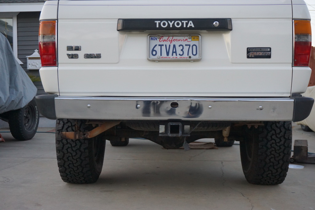

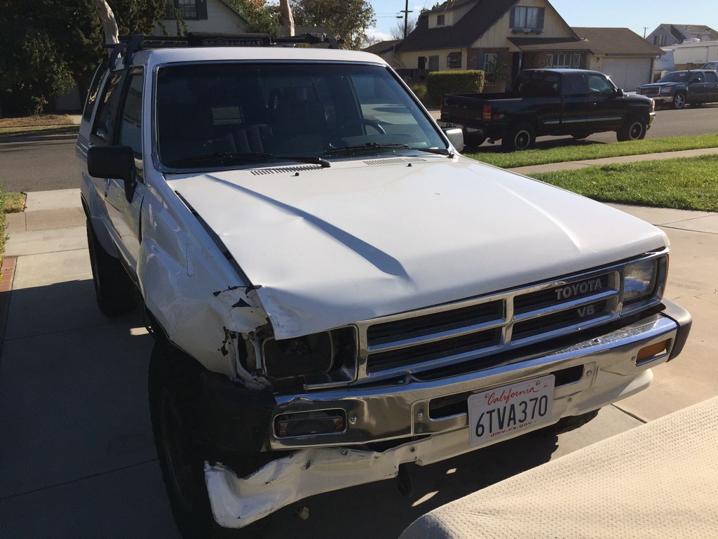

So here are a few pictures of the 1989. I actually pulled the fender and bumper out and drove it home from Lake Forest to Huntington Beach. Everything felt very tight motor-Transmission and suspension wise. The front end tracked completely straight. The interior is super clean also seems like someone really cared for it, previouse owner didn't have it very long before he got hit in it.
Day I brought it home

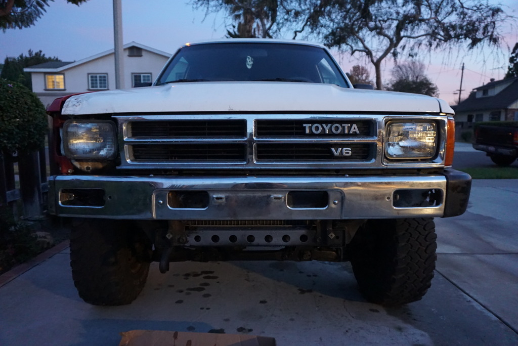

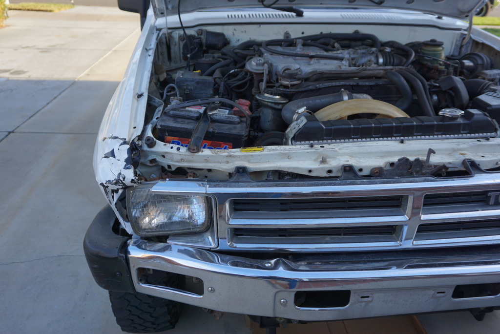

After pulling on the front end bit and placing a headlight in just so it looks decent.

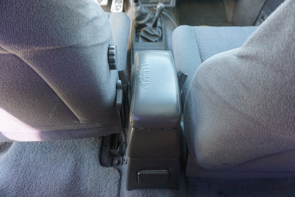

Here are some more interior shots

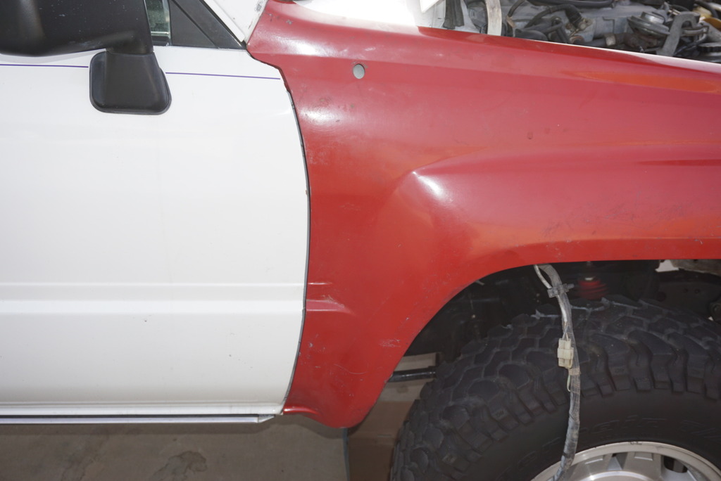

Just picked up a fender yesterday on Craigslist for 25$. It has a small crease on the bottom that I should be able to work out with a hammer and some dolly's. Then I'll prep it for a coat of white paint.

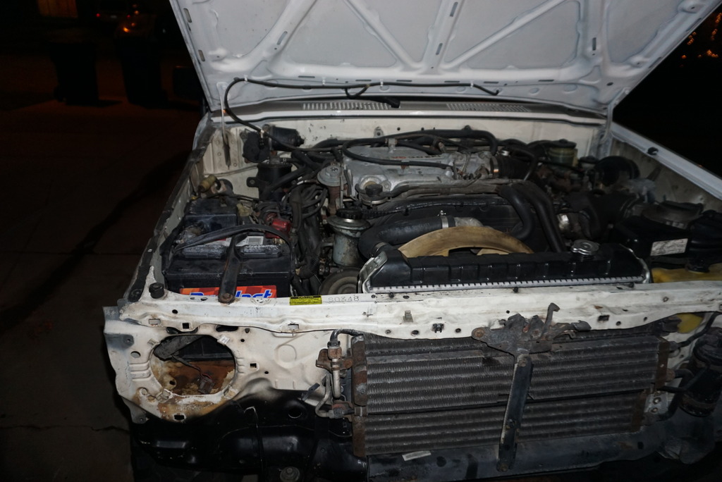

Ok so I made some progress on the TR4 tonight. I pulled all the electrical and battery off of the passenger side inner fender in preparation to cut the bent inner fender well out.
Ok so here is a better picture of the damage before it was cut out.
After I pulled the fender-bumper and grill off my you could definitely get a better idea of how pretzeled it was.

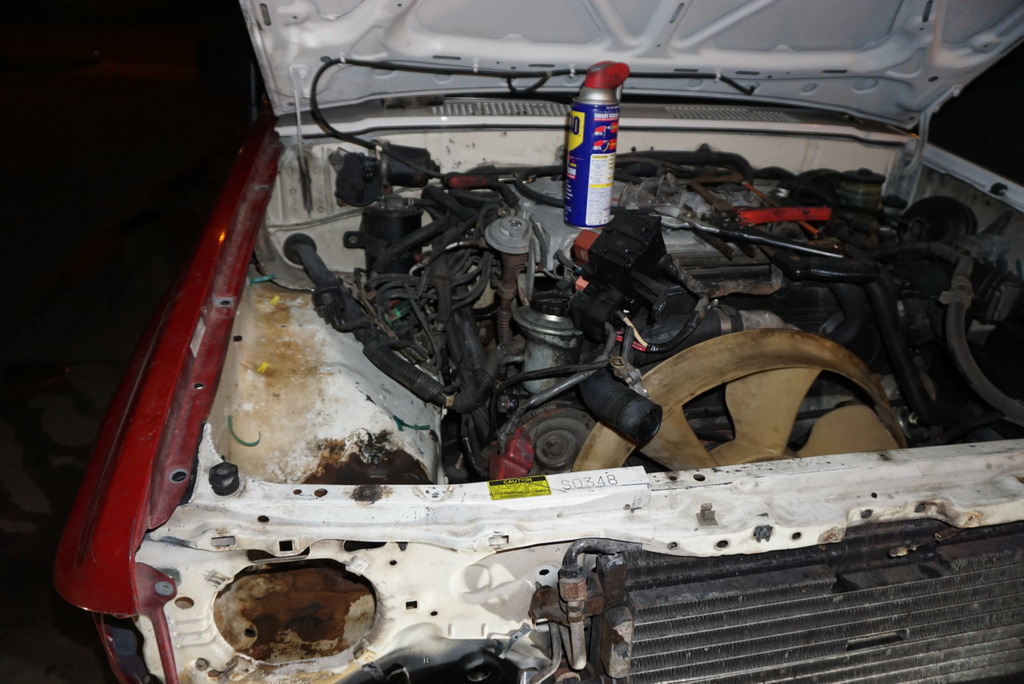

I even threw back in the battery and radiator and drove it to degrees the dirty engine while the inner fender well is removable.

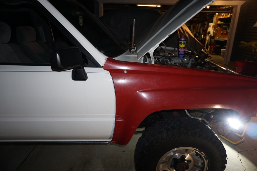

Ok guys so I made some more progress on the TR4 today. After trimming the donor clip and mocking it up I welded up the front end, it turned out really straight. It isn't perfect but hey if I wanted a perfect 4R I wouldn't have bought a wrecked one! The front inner fender is cut and spot welded and in the rear inner fender well I lapped it over each other about a 1/2" because without pulling the motor it would be very difficult to weld and make perfect. I'm just shy of about 1800 bucks (250 of that spent at the DMV) into it now but I need to order the rest of the front end parts that I need since I can't find any local parts.
After I welded the clip on I mounted everything back up and took it to degrees the motor one more time.
