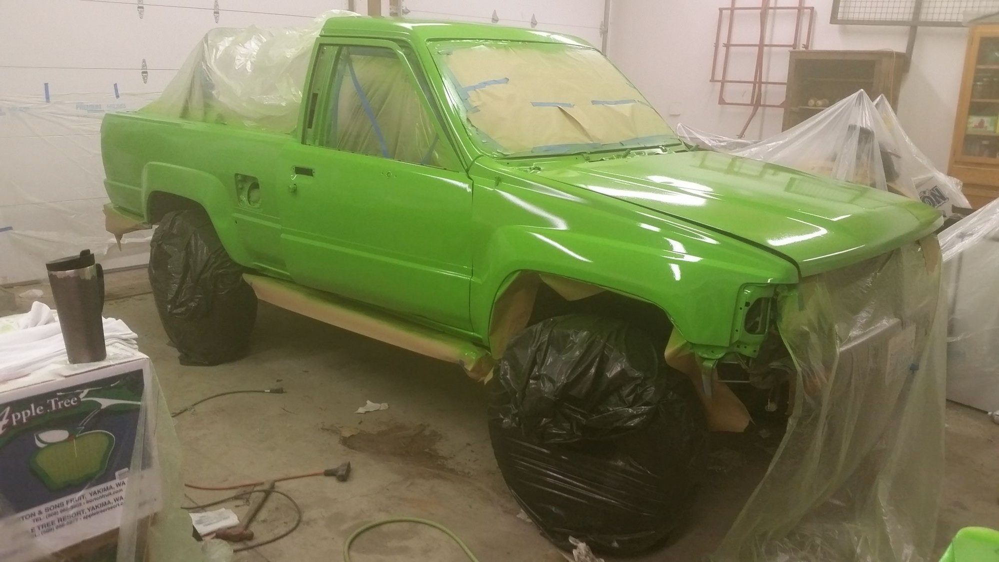

$300 for a half gallon of paint, all the flies and bugs in my shop came back to life when I got the heat going and they landed all over the new paint. I spent about 30 hours in two days painting, sanding and buffing. It turned out pretty good, I couldn't stand the primer gray.

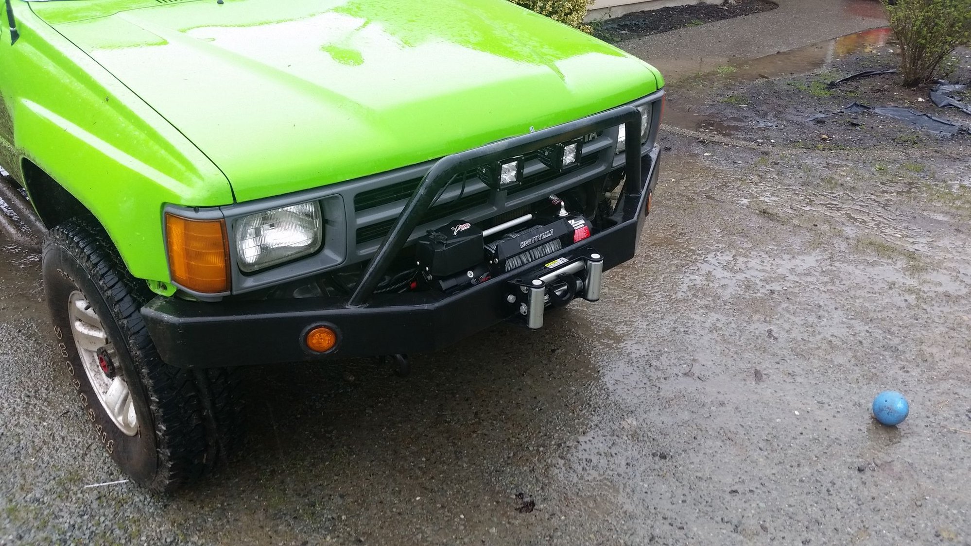

The front bumper was beat and I always wanted a winch although I never needed one. It was time to start building a front bumper.
Got a smittybuilt 8500 winch for Christmas. Time to build a front bumper.
HSS 5X3X1/4 that i got from the scrap bin.
Lots of trial and error.
Slowly coming together. So much cutting, welding and grinding.
Im pretty happy with it except there are only two bolts holding it to the frame. It needs some more reinforcement.
I added to the rock sliders and bought 5.29 gears and a spartan locker. This truck had come a long way and it has a long way to go.
This is how she sits today, soon to come bigger tires and gears and lockers. My wife doesn't mind driving it now.

Excellent work! I love the bumper and the paint looks good. Are you a painter or is that just a thorough garage job? What kind of paint rig are you using? Is it single stage or did you clear coat it? I am dying to paint mine but for the level of quality I'm wanting (maybe a 7 out of 10) I cant see paying the couple thousand bucks that shops want around here.
Really outstanding work.

I am not a painter, this was my first try. I watched a lot of youtube and got the paint from napa. It was a single stage paint. It took just over a quart of their martin senour paints. You have to follow directions very closely. I tried to re-coat the hood the next day and it would not stick to itself,that caused many more hours of sanding and buffing. No matter where you do it or how good you are I think you will still have to wet sand and buff. Luckily I have a friend with a buffer and a variety of compounds othe wise you will have to buy one, a real one for a couple hundred dollars and a bunch of money for compounds. It's nice that you can fix the runs and flaws ie bugs and dust after spraying but it's so much work. I used a $50 gun from Lowe's and my little air compressor.

You really did a great job painting that thing, and those bumpers are nice.

paint looks great!

Kawasaki green is awesome! Good job!

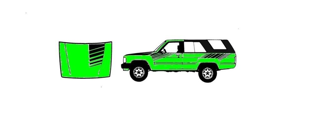

Nice work, I really like the bumpers and the paint color looks great! Have you thought about adding new decals, I think it would really make it pop and go well with the black top!
Those would really look sweet

Jamesdeancreations.Com
that's a good idea, I'm going to look into that
