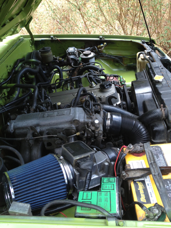

Ok here we go. I bought 1986 4runner sr5 two years ago. It being my third toyota. Previously a 88 pickup and 91 4runner. I always wanted first gen 4runner though. And I found one. It was priced a little higher than I wanted to pay but I jumped on it. And with my luck sure enough I have it for about a month and blown head gasket. So I knew I've always wanted a first gen so I figured why not put all I can into it. It's been a slow progress but ill list everything done so far. And plans for future as well. And will also try and include as many pics as I can. So here goes
Done so far
Remanufactured long block from Denny's machine shop Hagerstown MD
Clutch kit
Water pump
Starter
Alternator
Front brake calipers
CD player
82 supra afm swap
Fuel pressure damper
Rear shocks
Tie rods and ends
Sway bar links and bushings
And a few cans of spray paint.

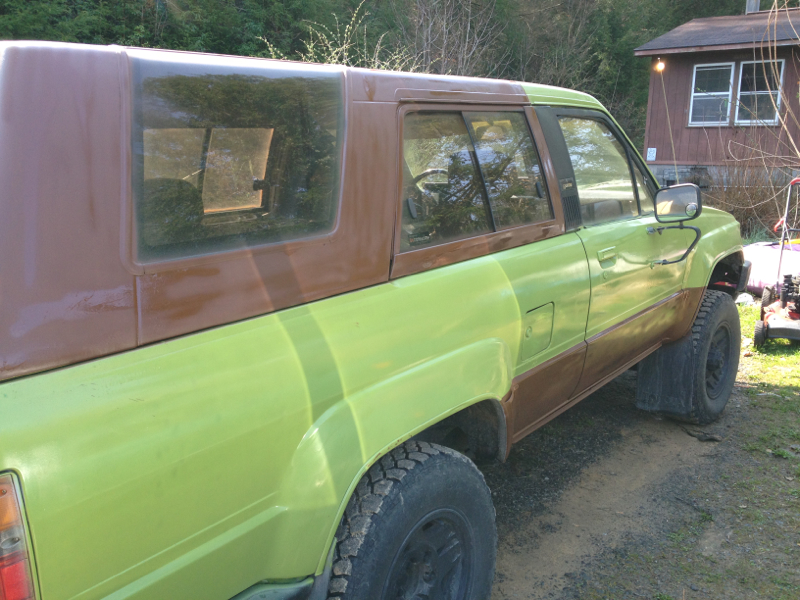

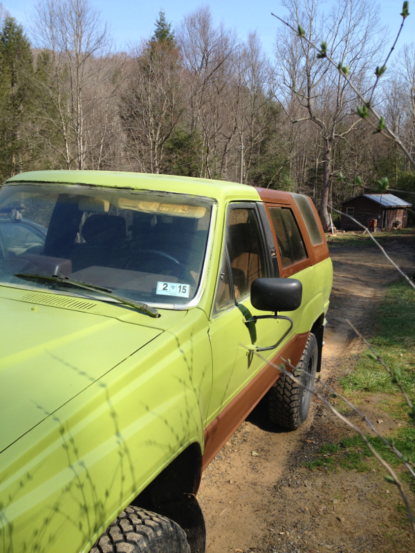

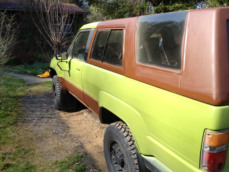

More pics
Attached Thumbnails 1986 yoda 4runner build up-image-2377014056.jpg   1986 yoda 4runner build up-image-987255418.jpg   1986 yoda 4runner build up-image-650133653.jpg   1986 yoda 4runner build up-image-3209441473.jpg
