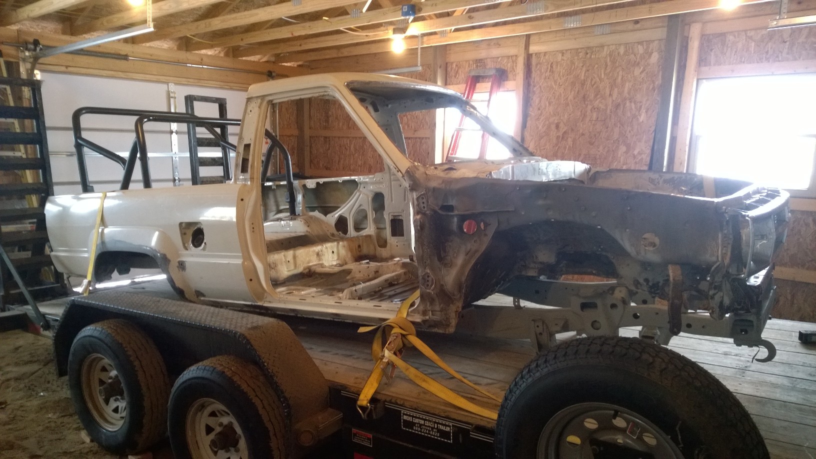

I just found a 4Runner in pieces and plan on rebuilding it to a stock DD condition.
Plans
New 22-re
Solid front axle swap
and a close the factory lift

I like that rear roll bar, looks like it was used for a full legnth soft top. Looks like it will be a fun project!

the previous owner was going to mount another set of seats between the two roll bars and the hard top wouldn't go on as is so it has to come off.
