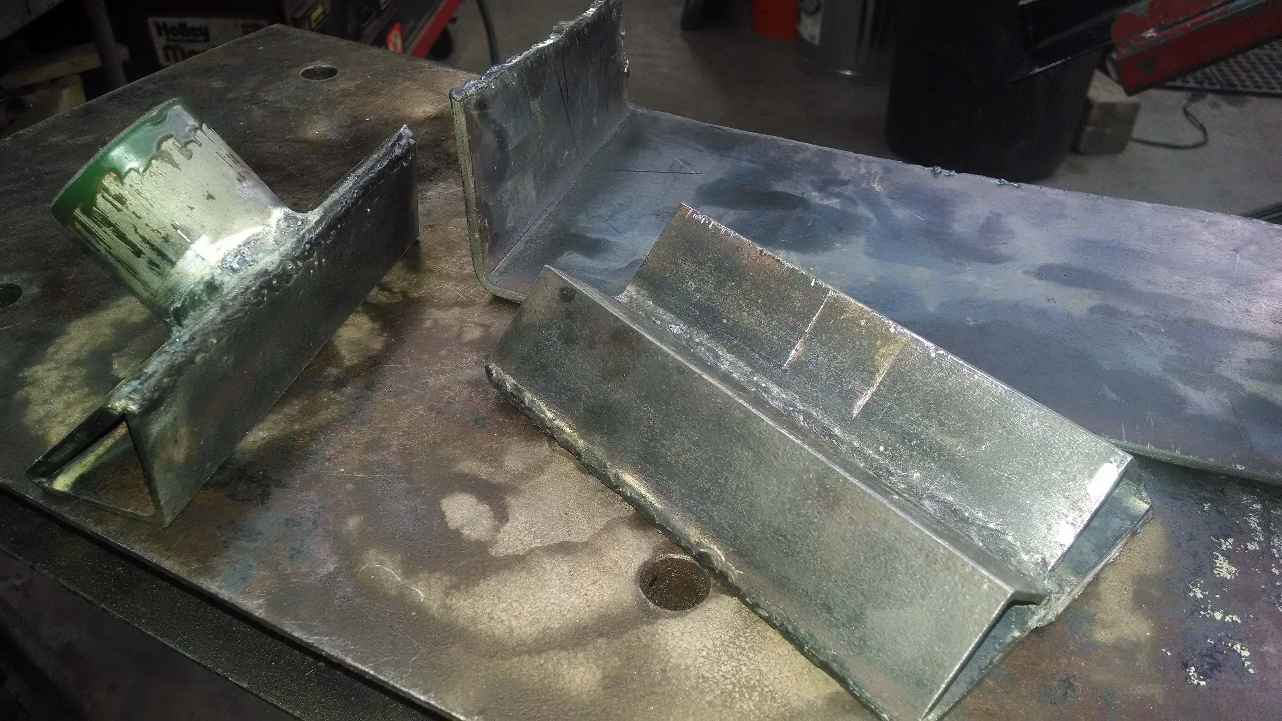

Got an idea for the fuel cell mount that need some bent plate. So I made a quick press brake and tossed a 6" piece of 3/16 in it. Worked great

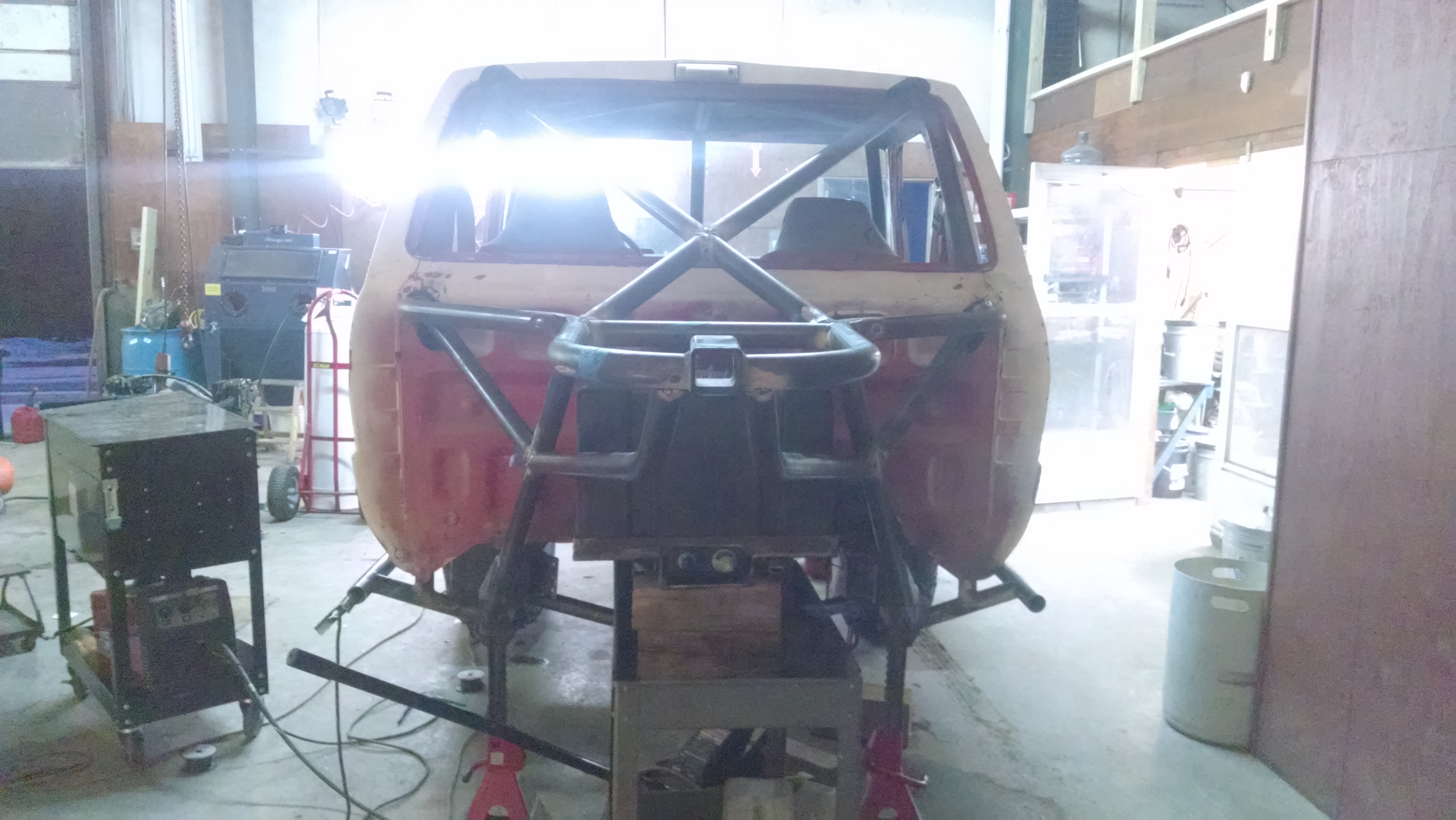

Got the frame tie in done, braced the receiver hitch in the rear (recovery point)

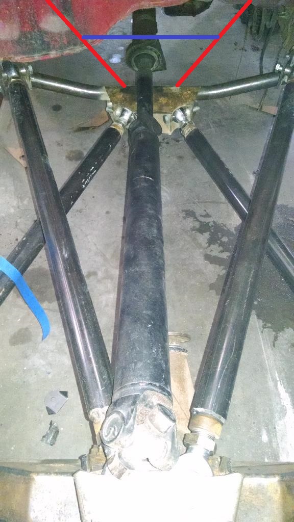

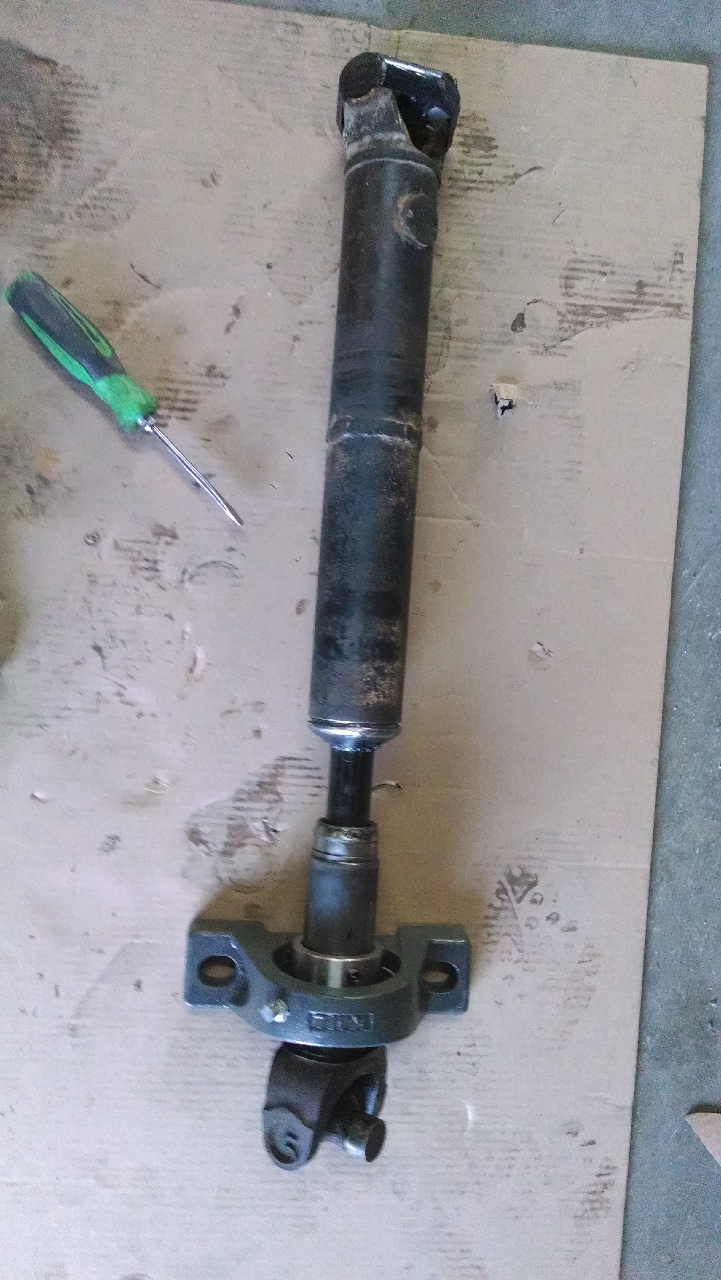

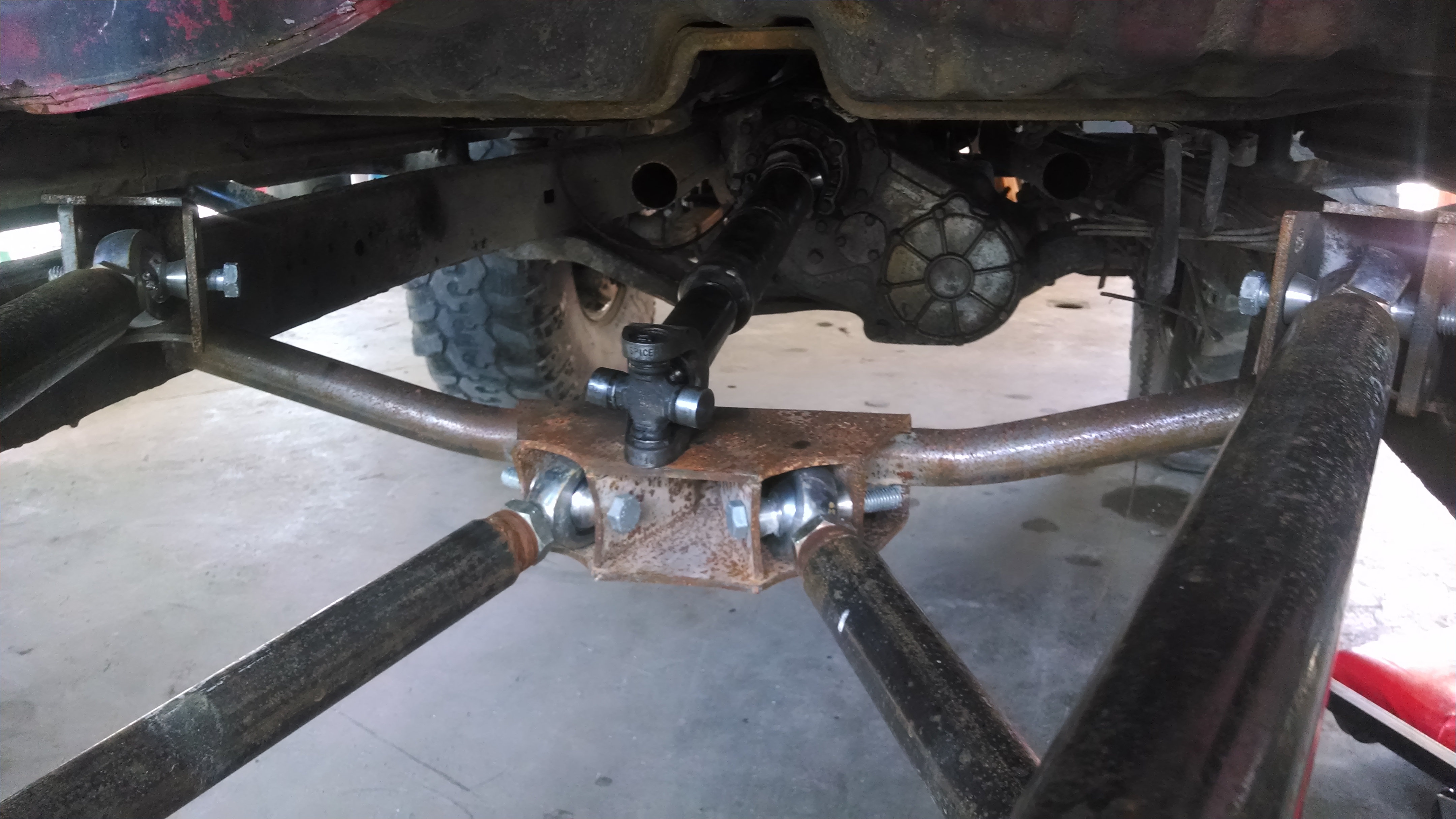

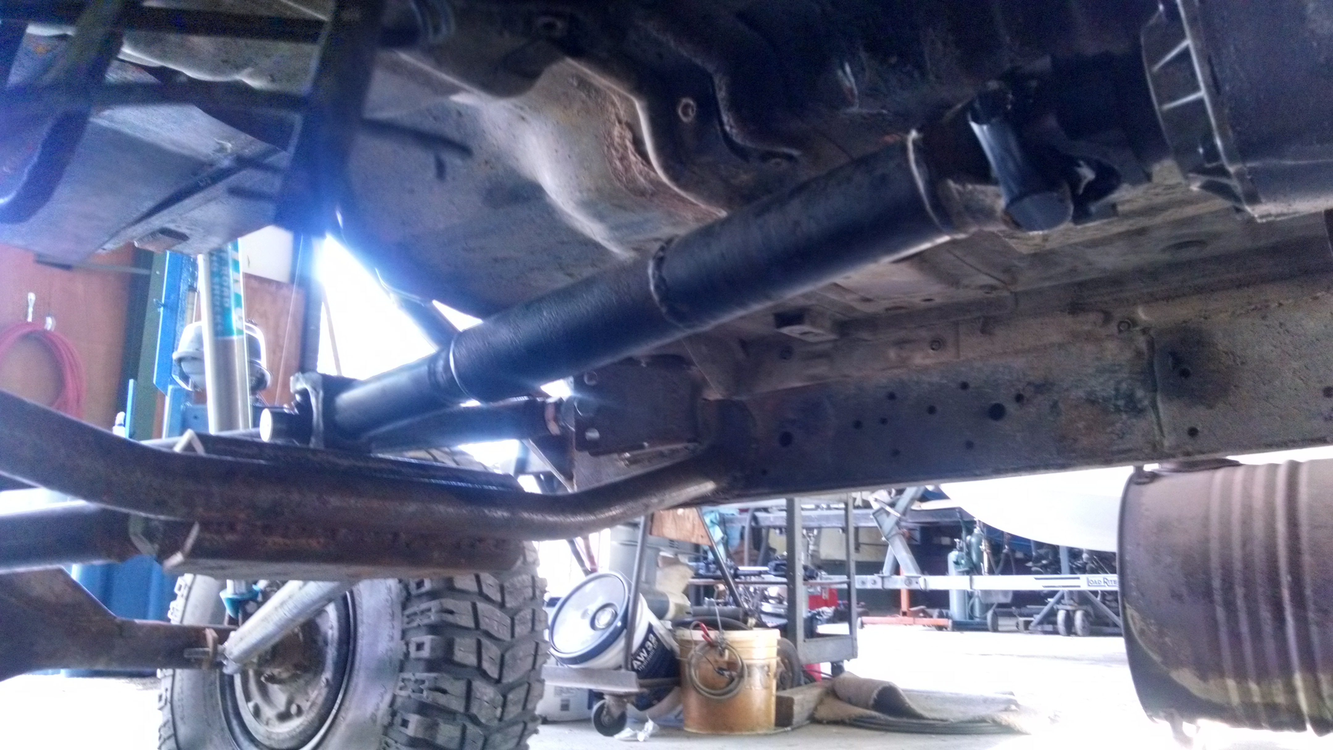

And tossed a drive shaft up to get an idea on what I have to do.... Gonna be tight. Only got about 24" or so ujoint center to ujoint center for the rear shaft. The Carrier bearing/pillow block will mount on the "blue" tube. The red tubes are support going from the lower link cross member up to the frame.

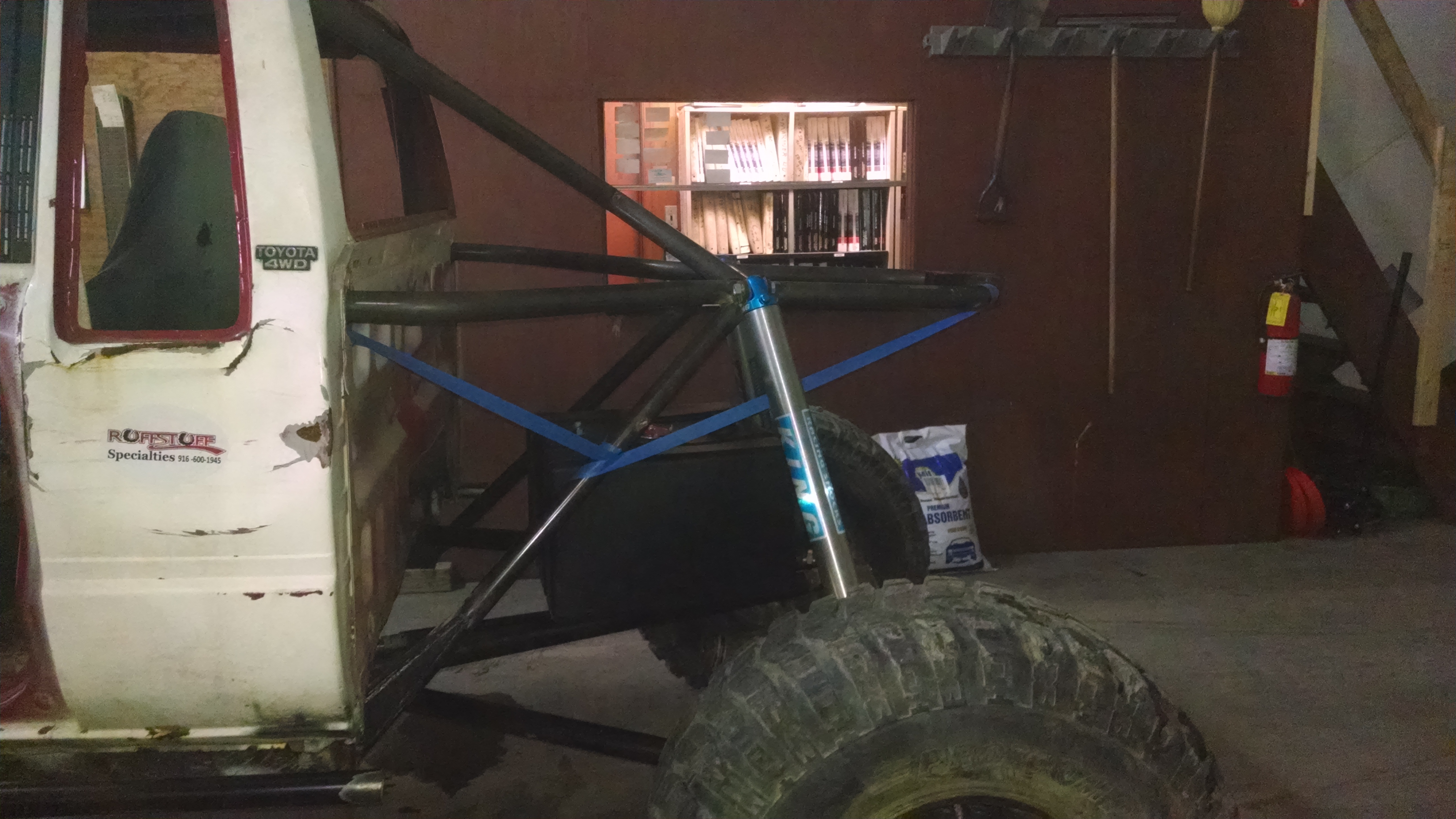

Also still trying to figure out how I want the lines to go for the rest of the tube.... What y'all think of this?

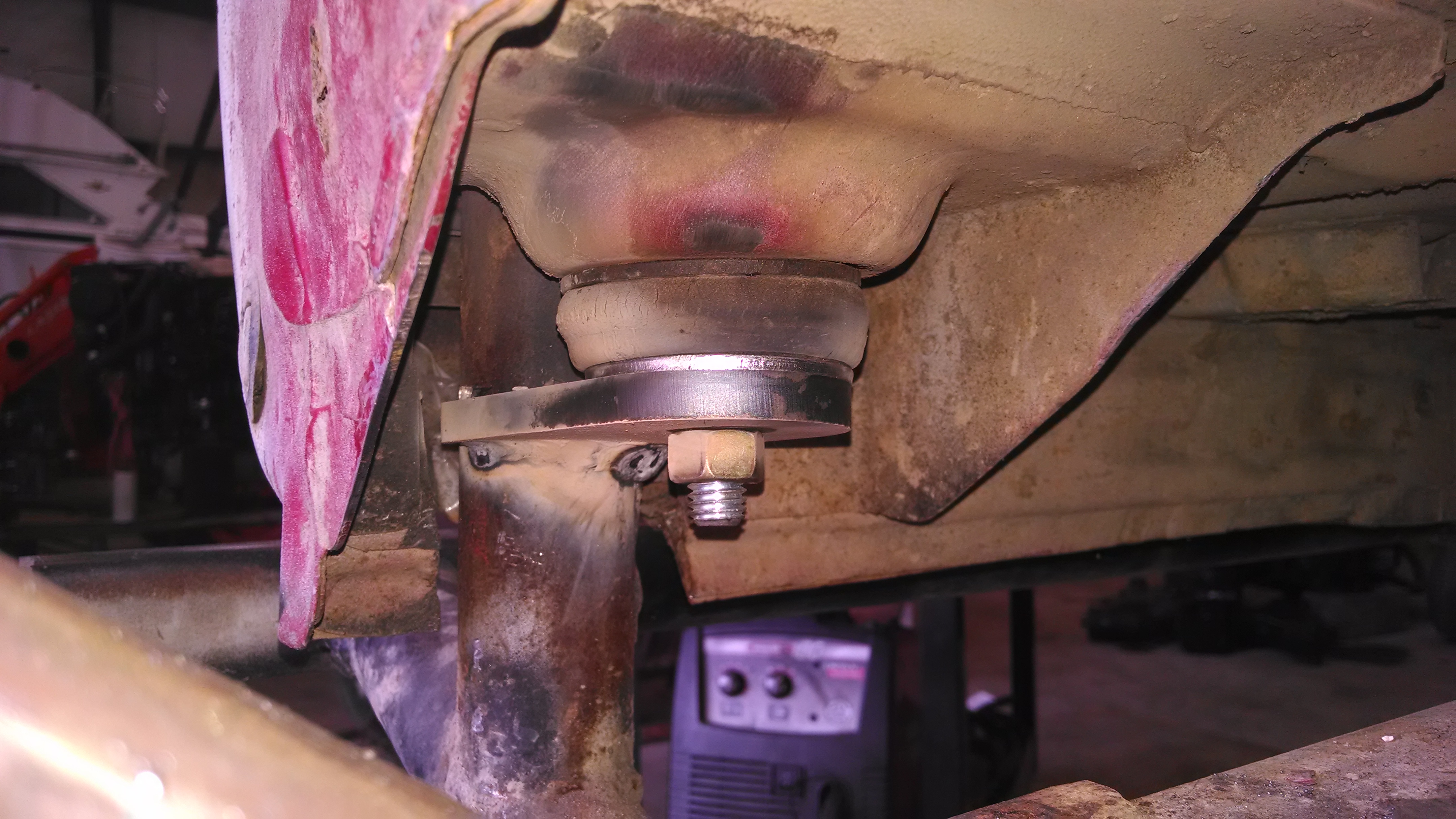

When the internal cage was installed we removed the rear body mounts. Listining to the cab bounce off the cage gets real old real quick so I whipped this up. Still need to add a gusset.

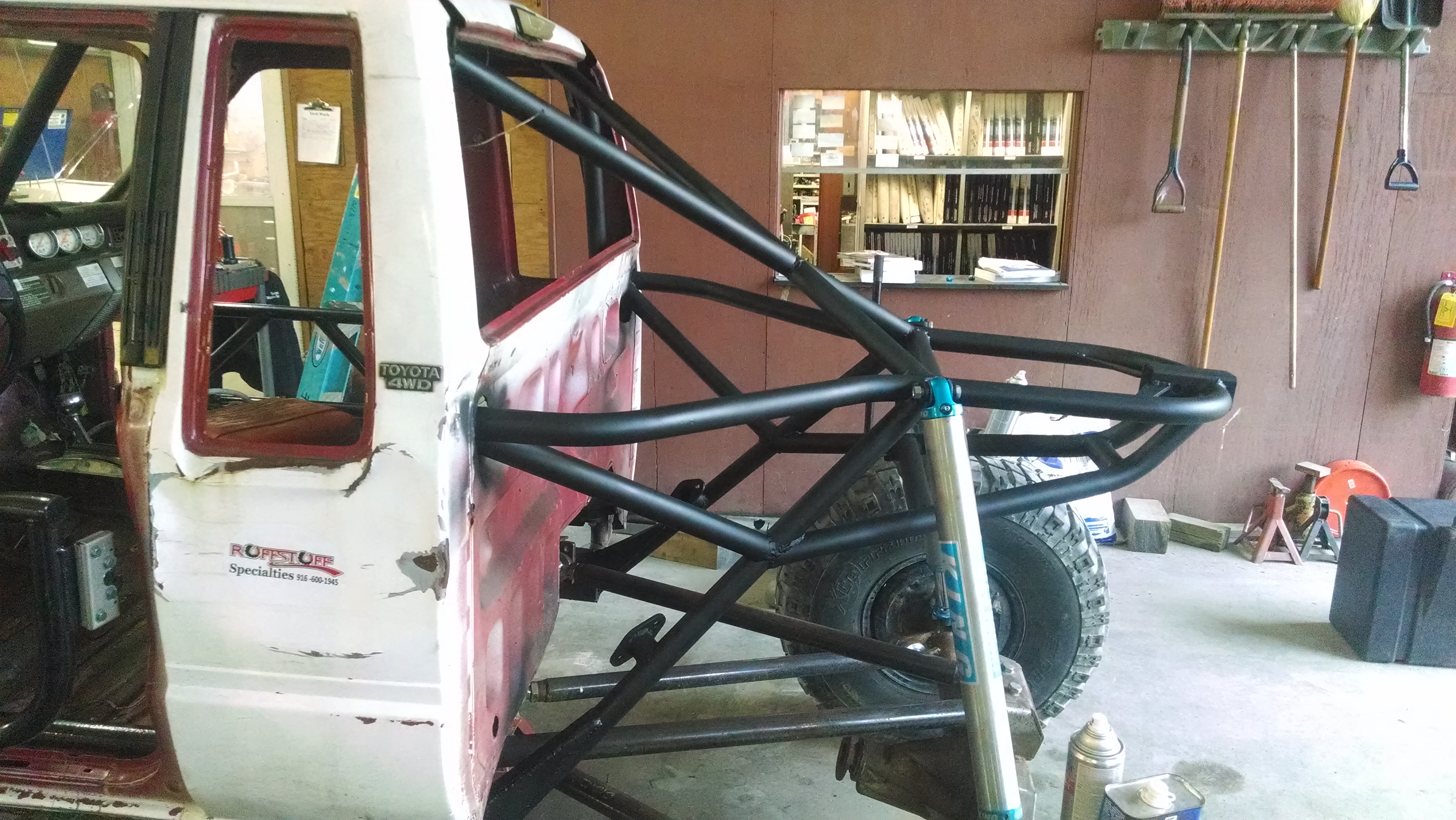

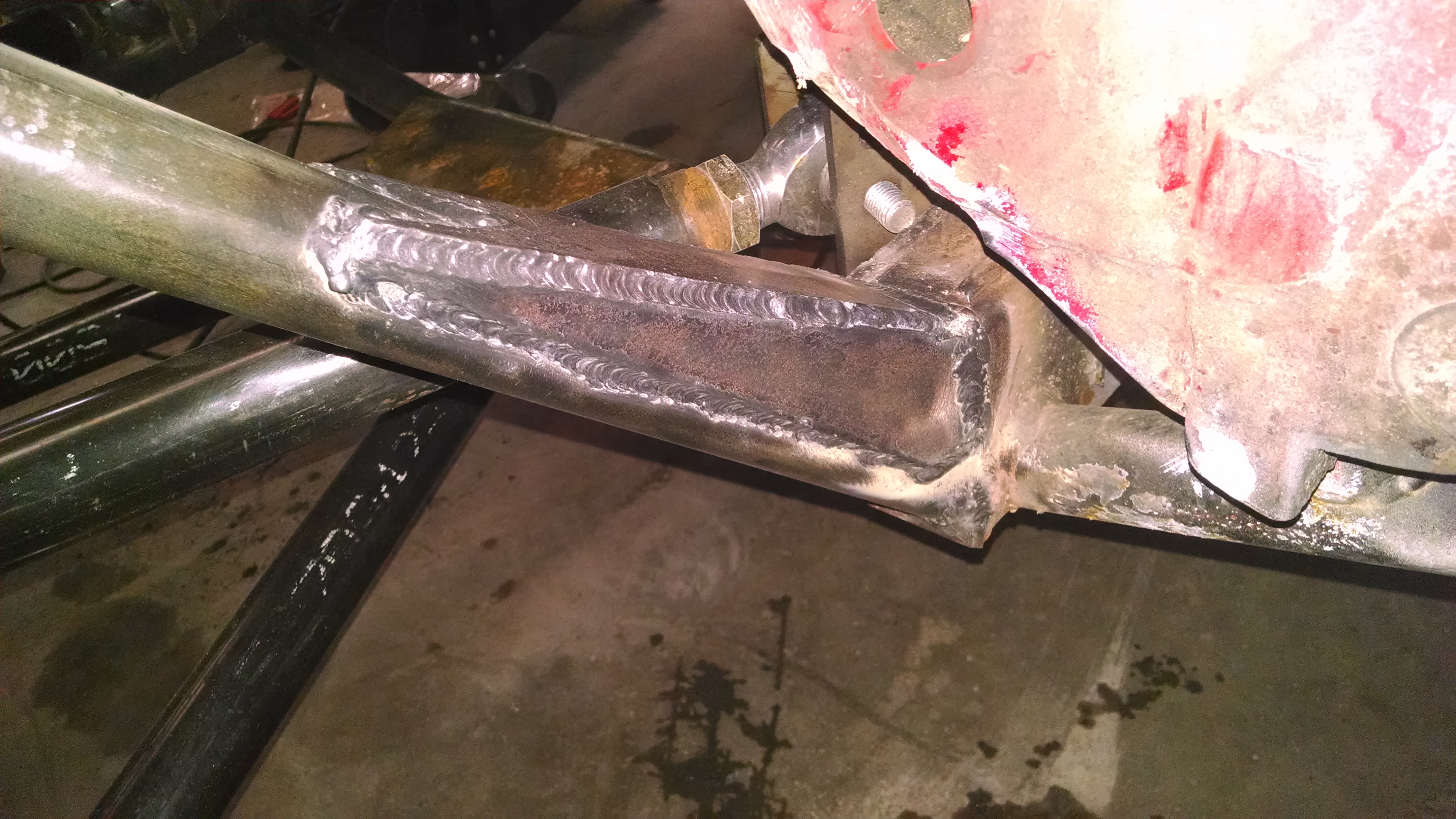

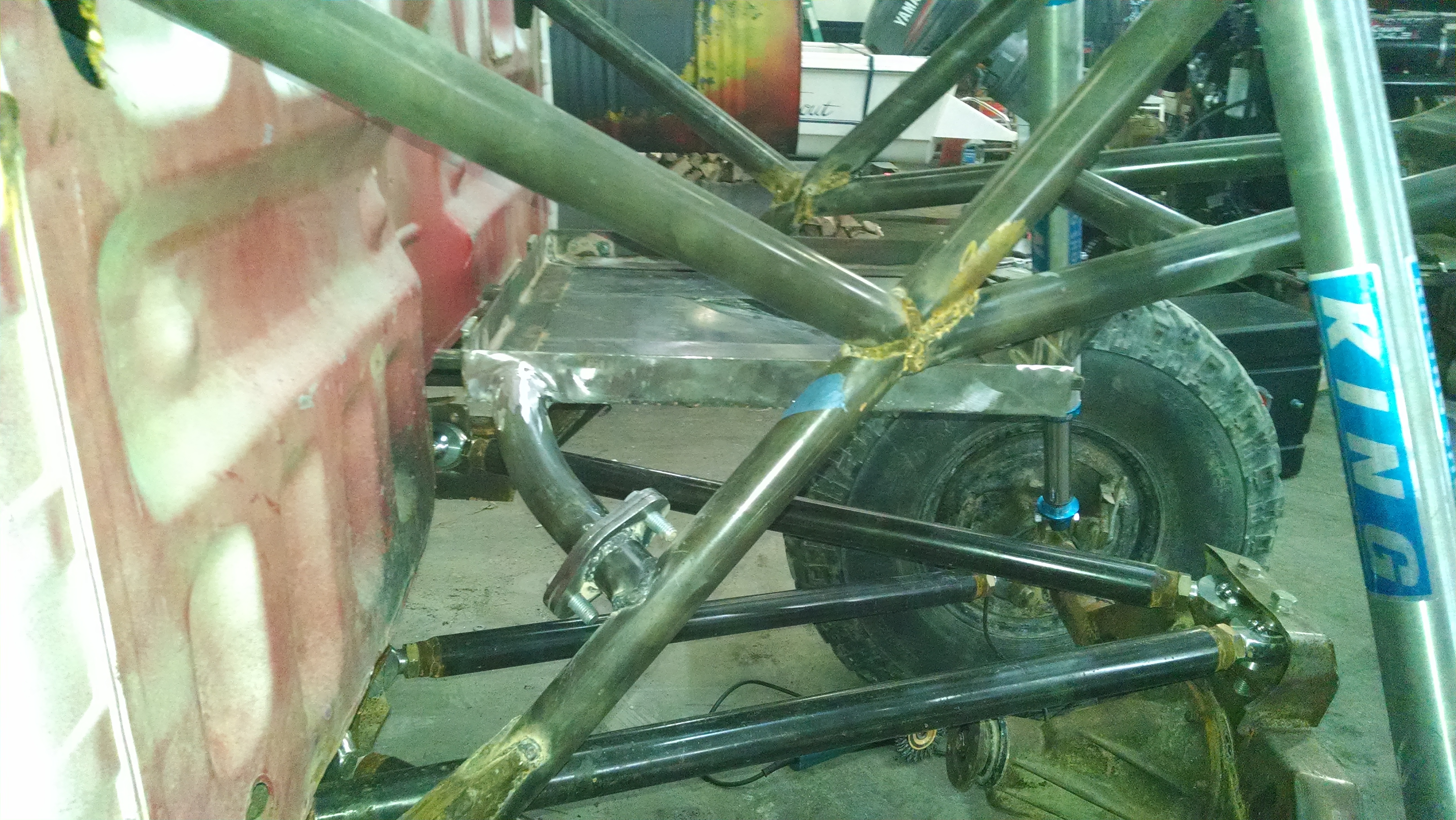

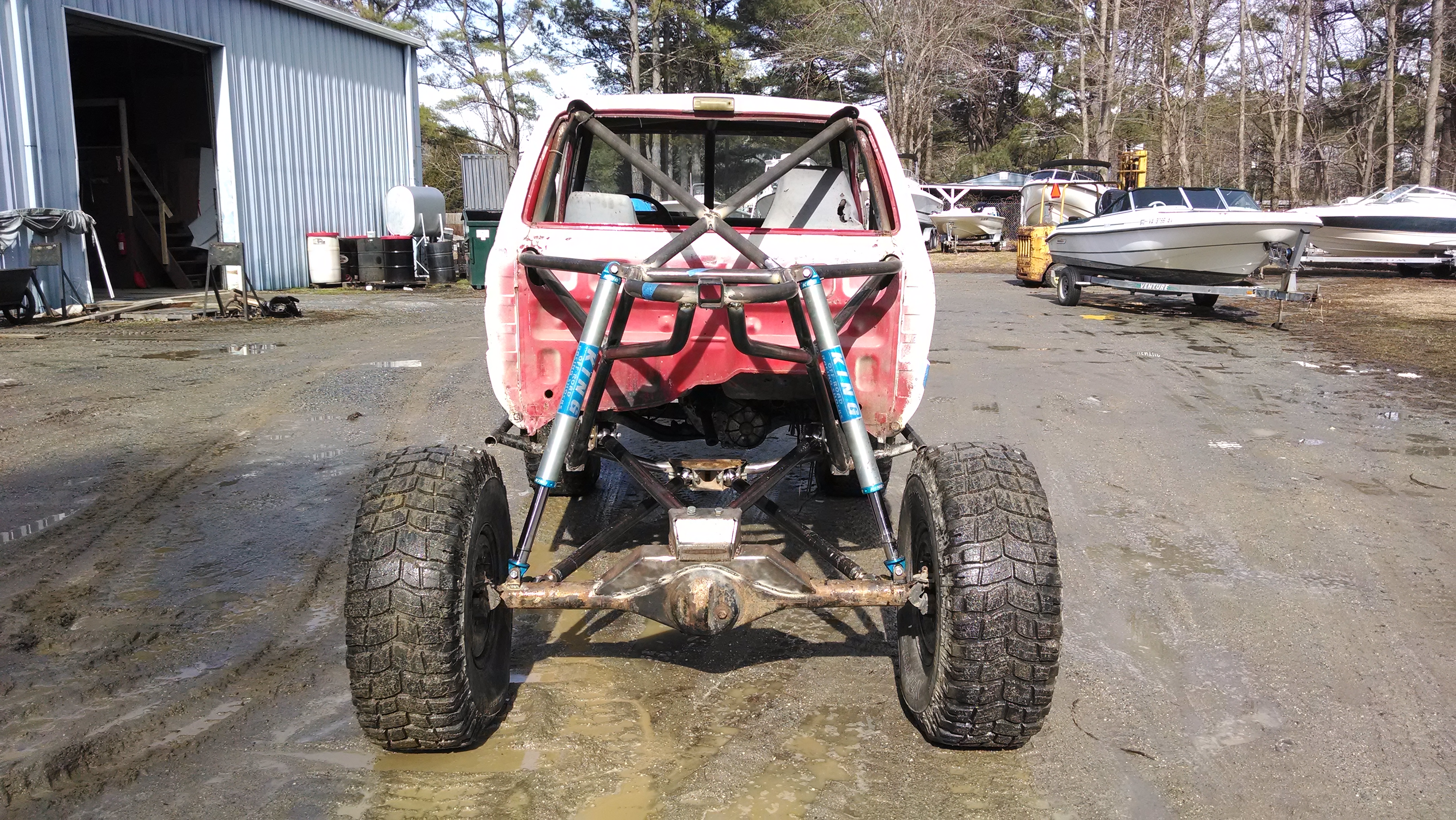

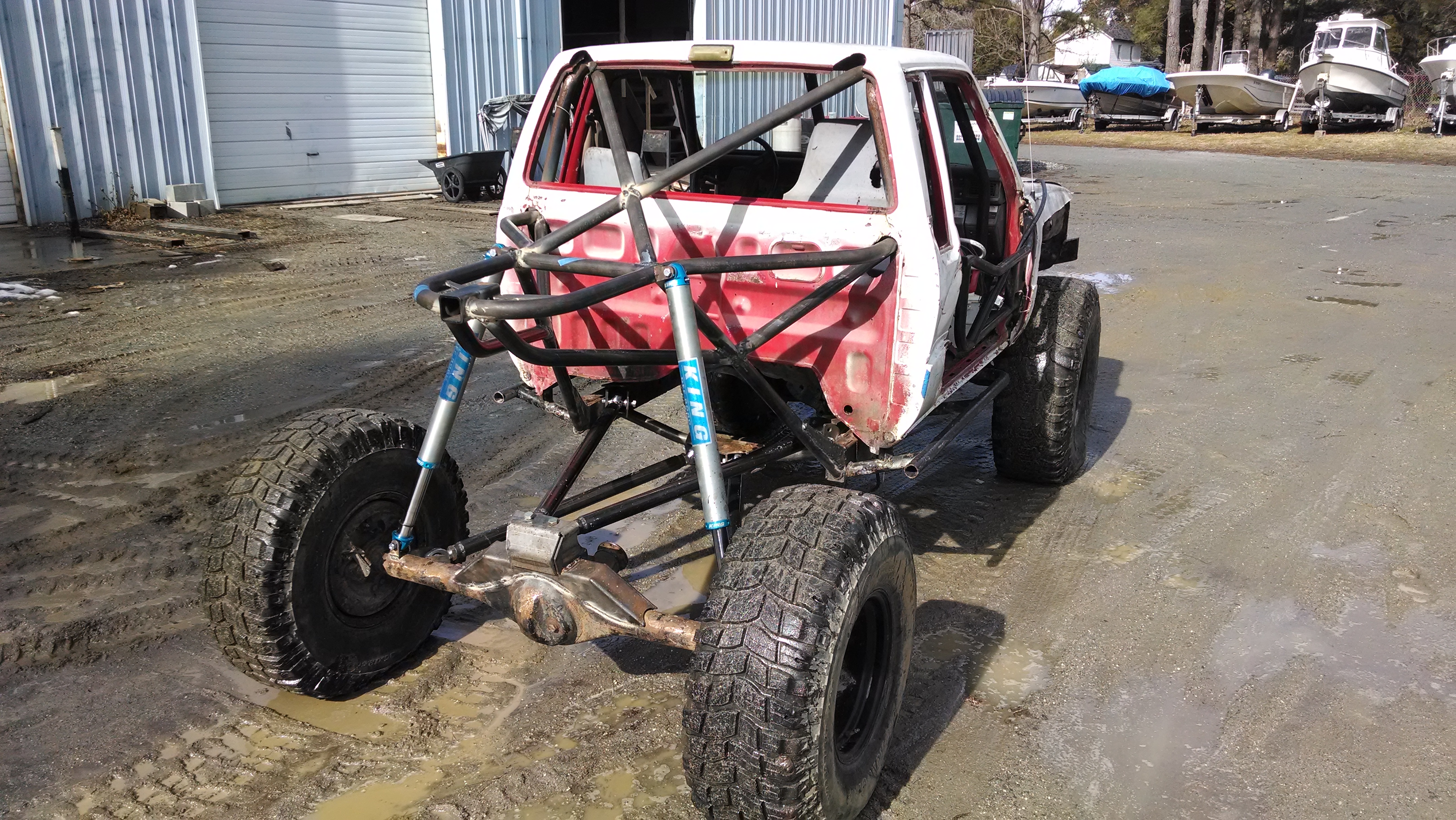

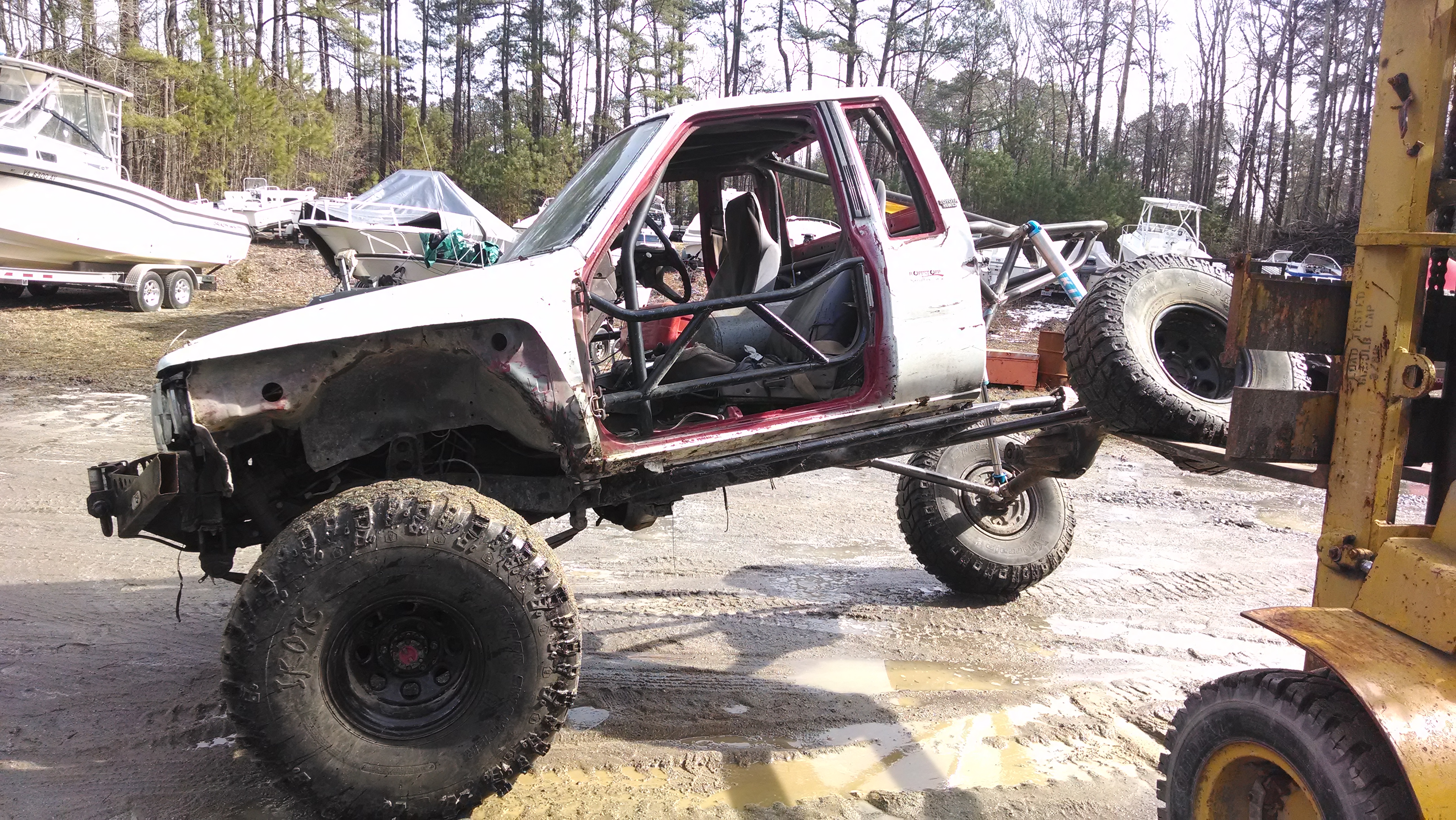

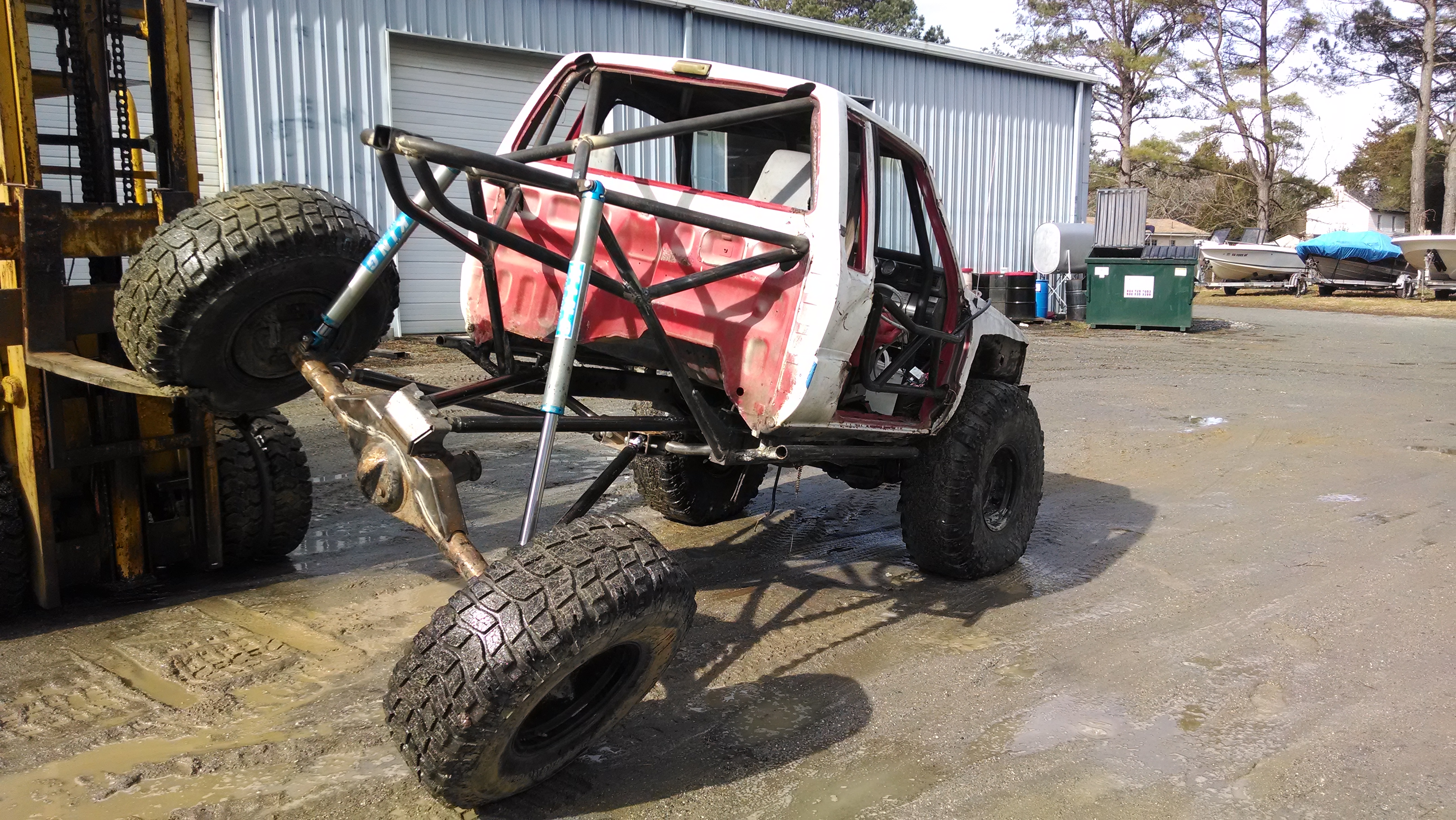

Also did all the finish welding and finished the rear tube. I like the side profile but swap back and forth on the rear...

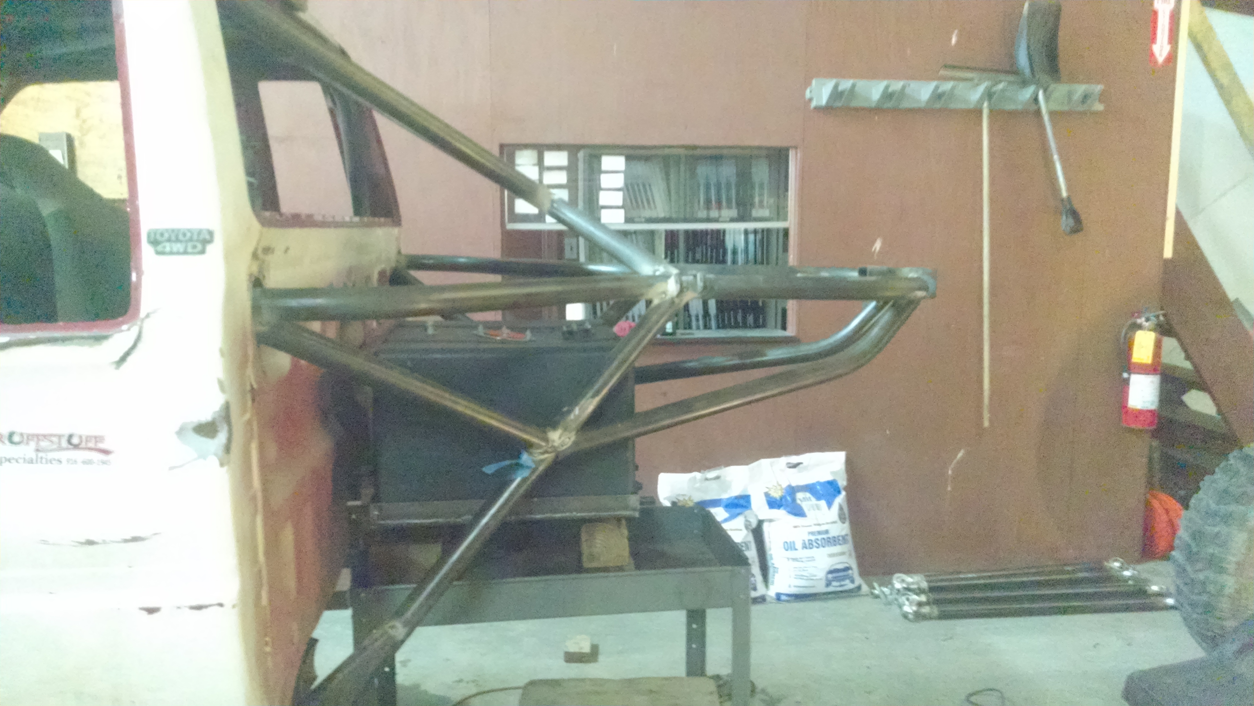

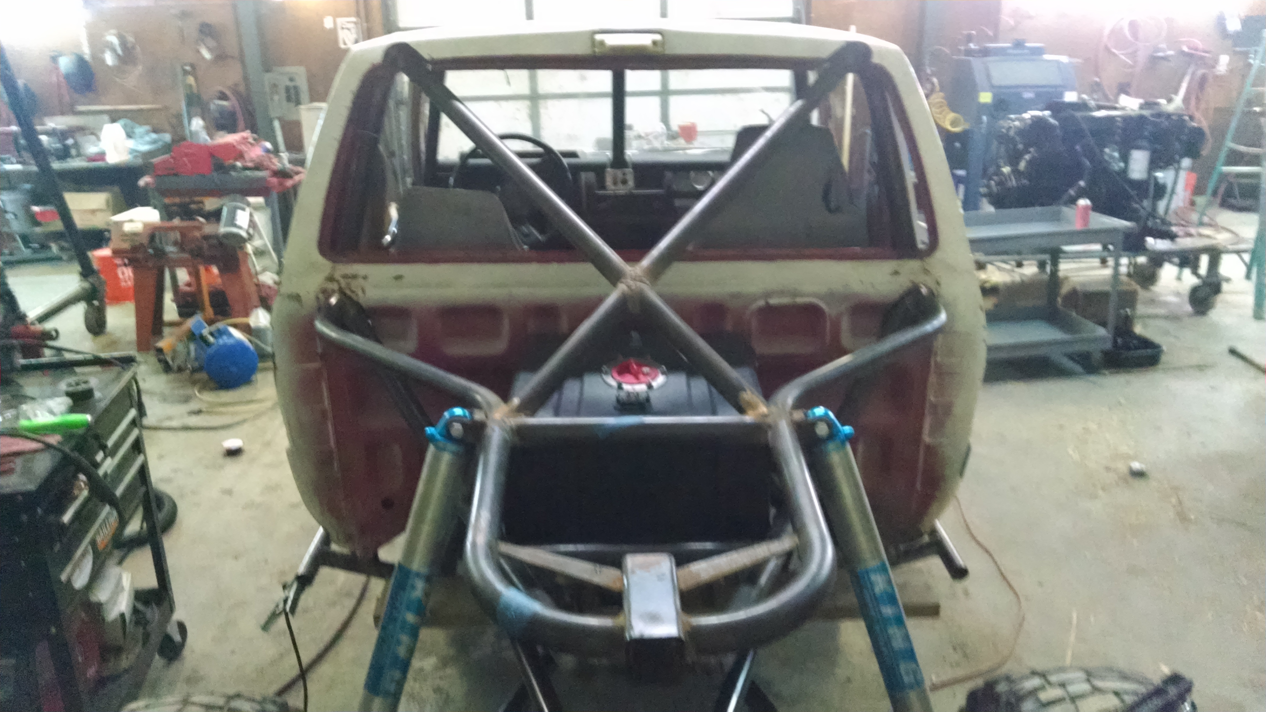

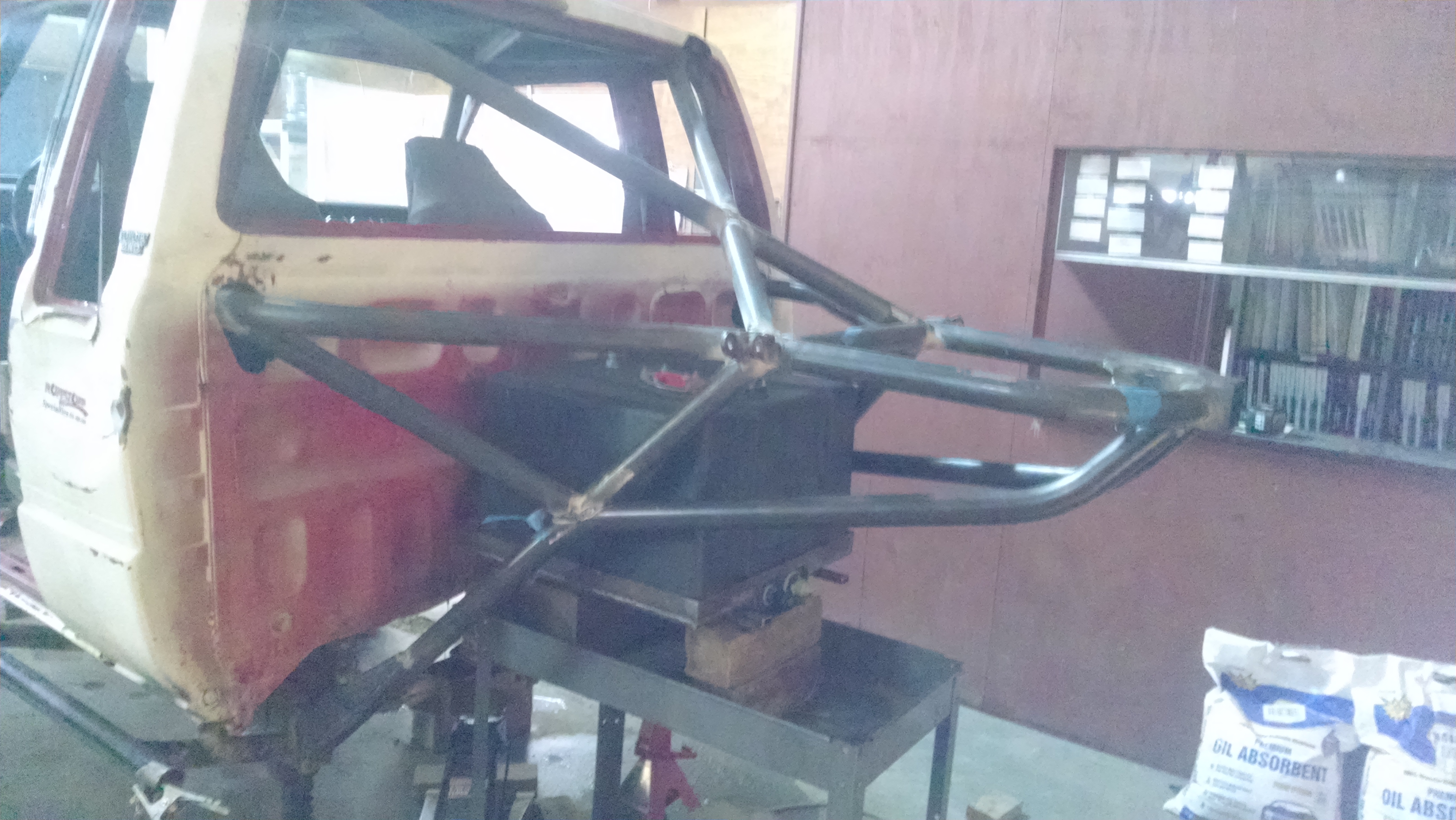

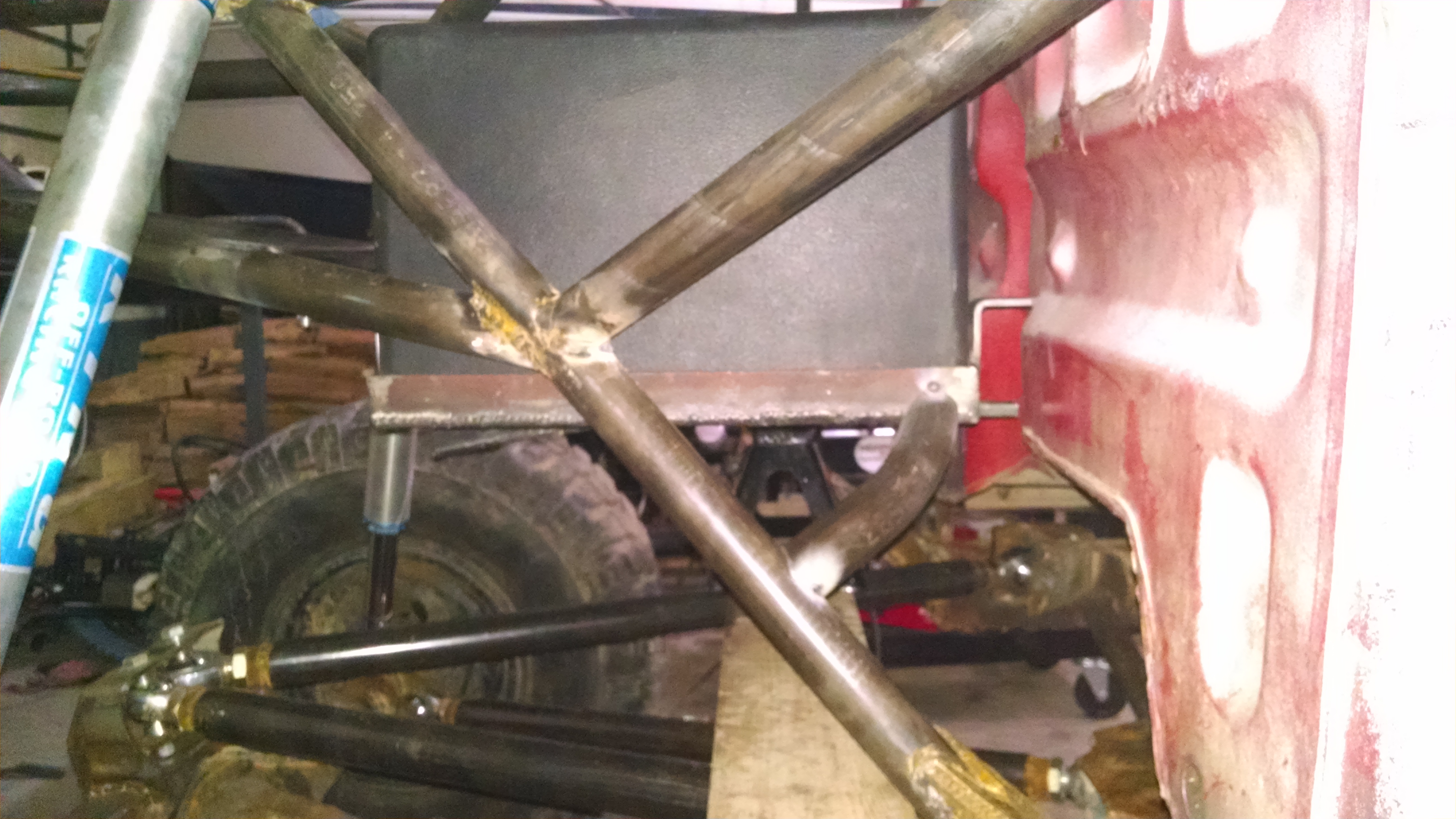

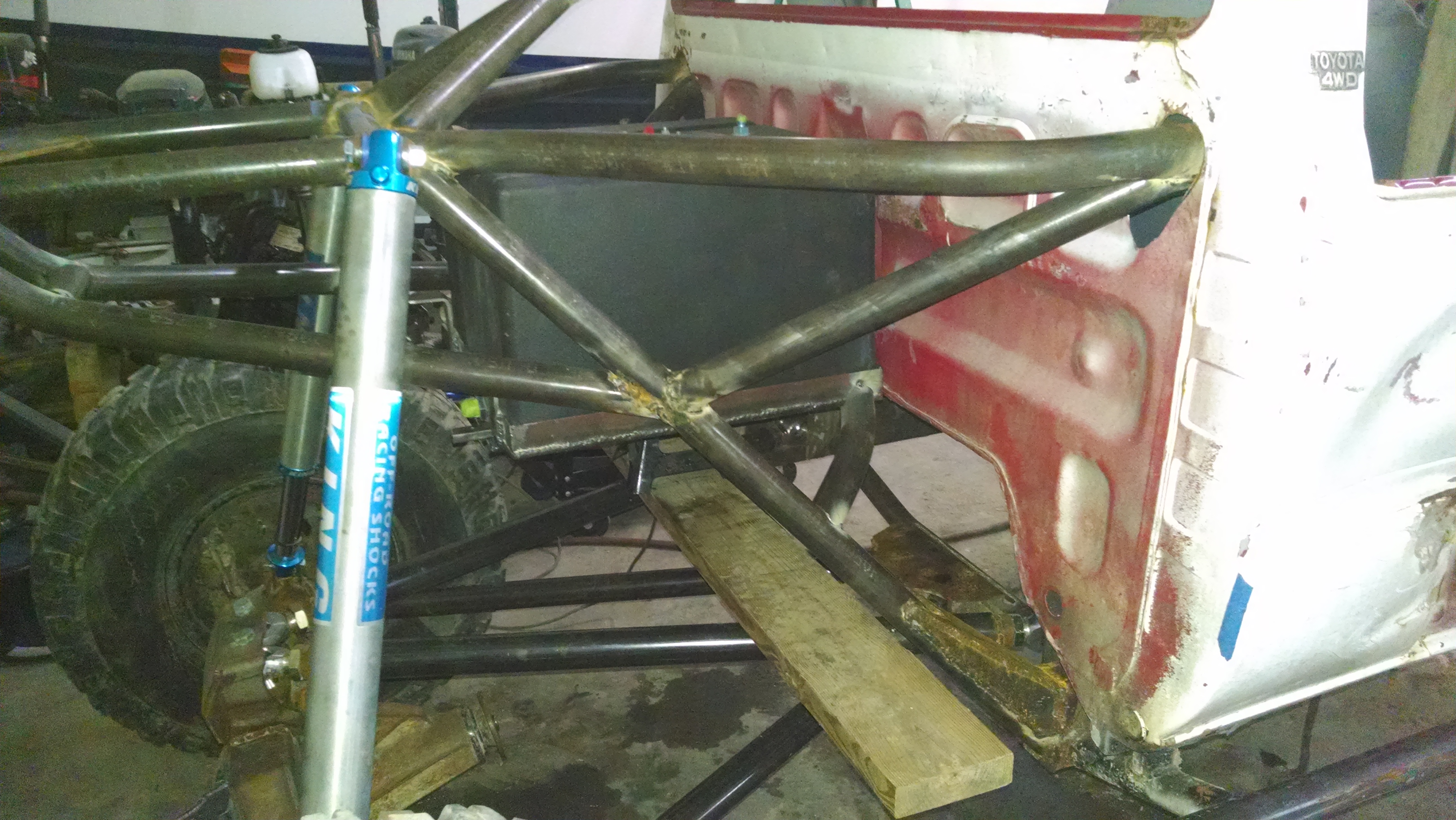

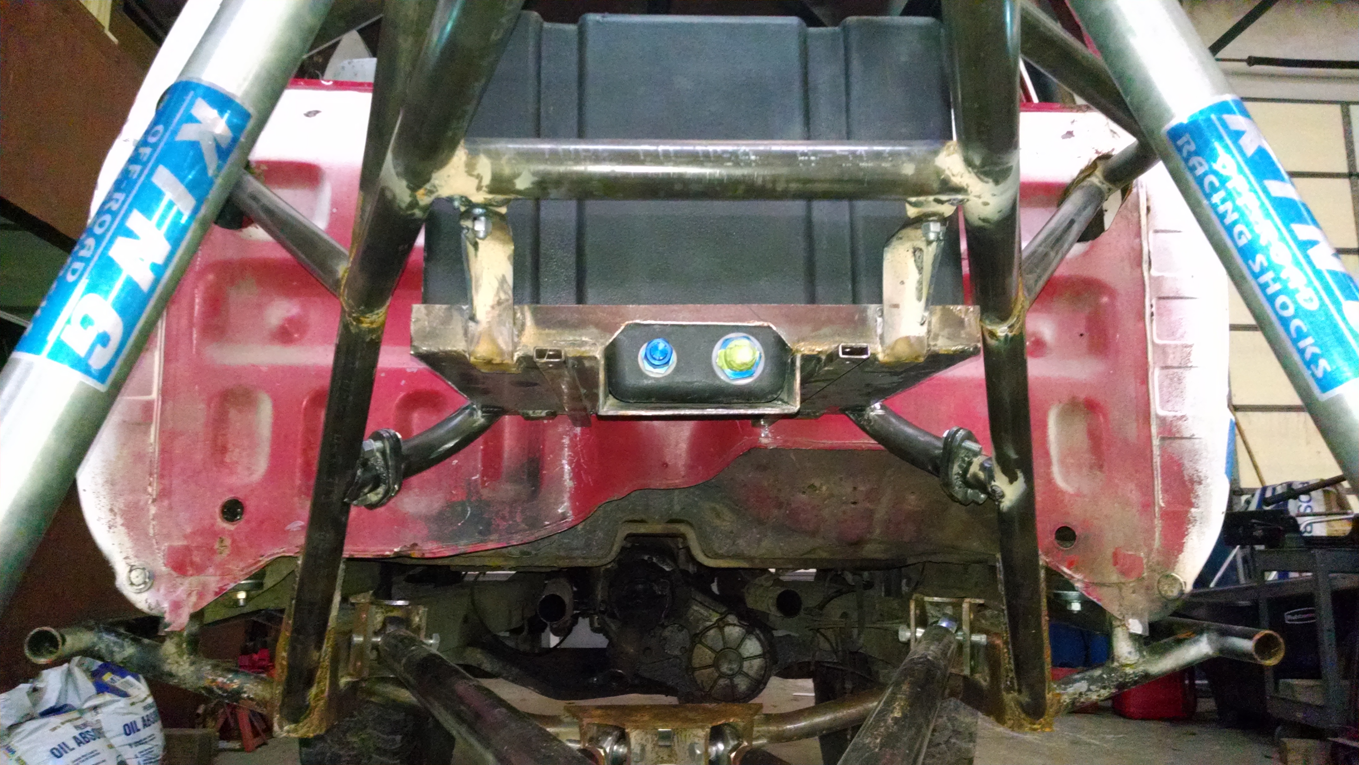

So onto what got done today. I'm learning what they mean my "the last 10% of the build takes 90% of the time. Got my Fuel cell mocked up. Need to add gussets but I think it will work.

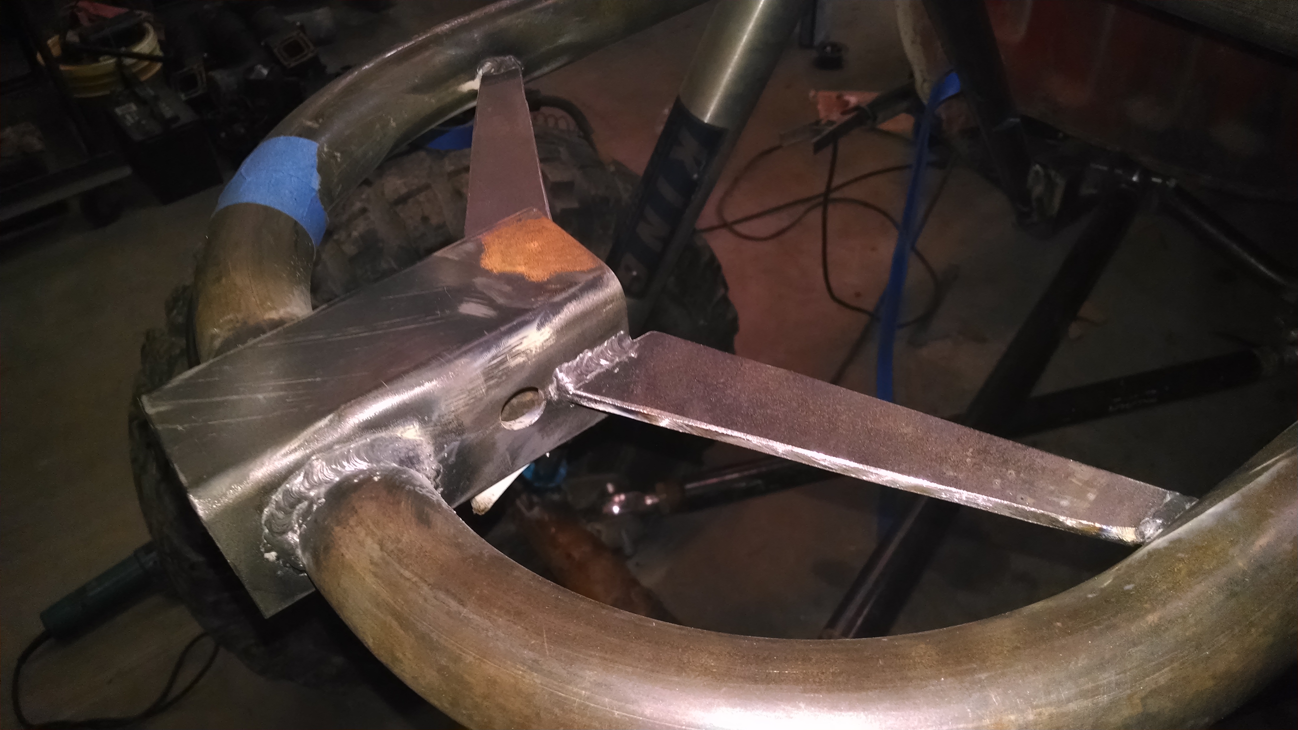

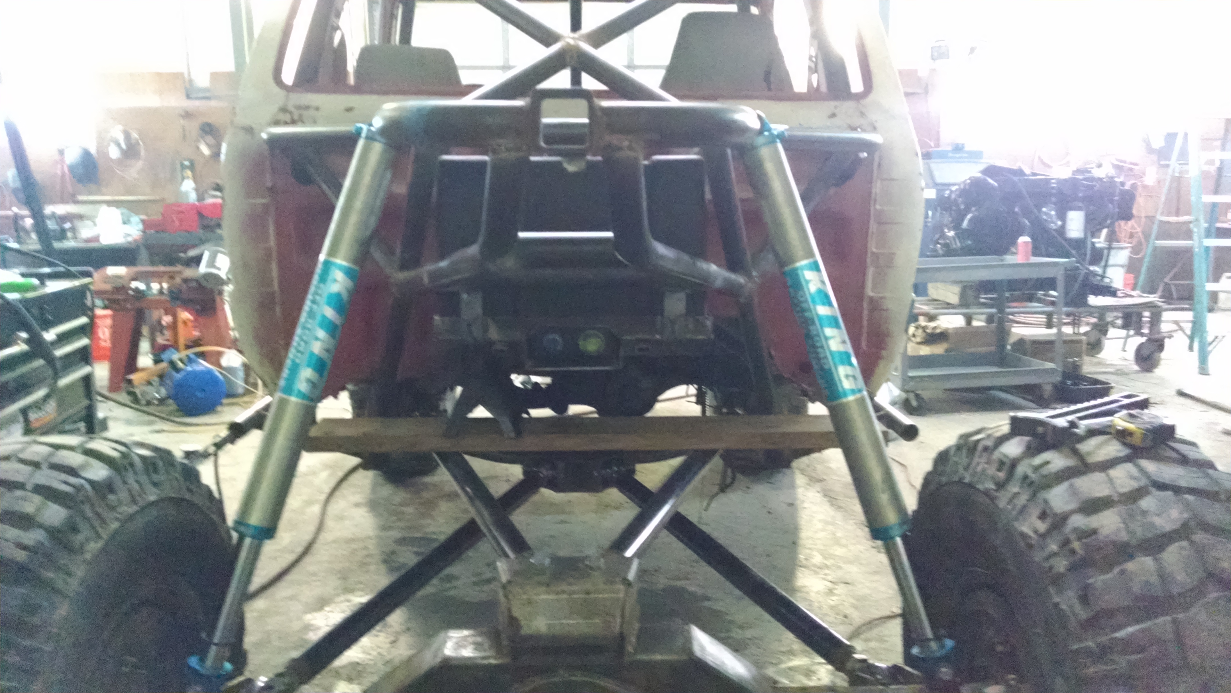

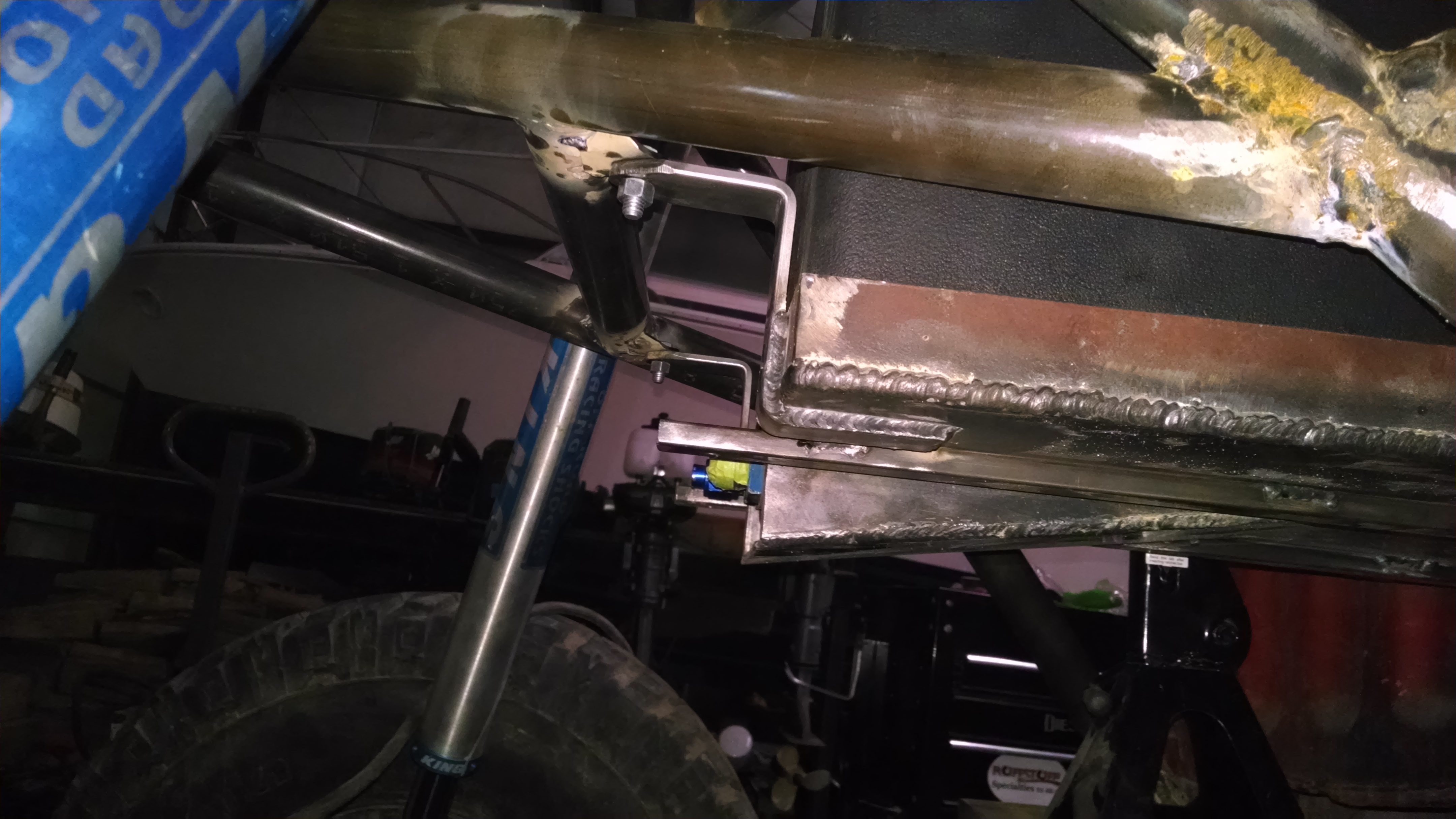

Got the fuel cell mounted. Used Ruffstuffs 1.75" Oval Mounting Plate and some trick tabs Small Trick Tabs to make it removable, pain in the ass to get in and out but still removable....

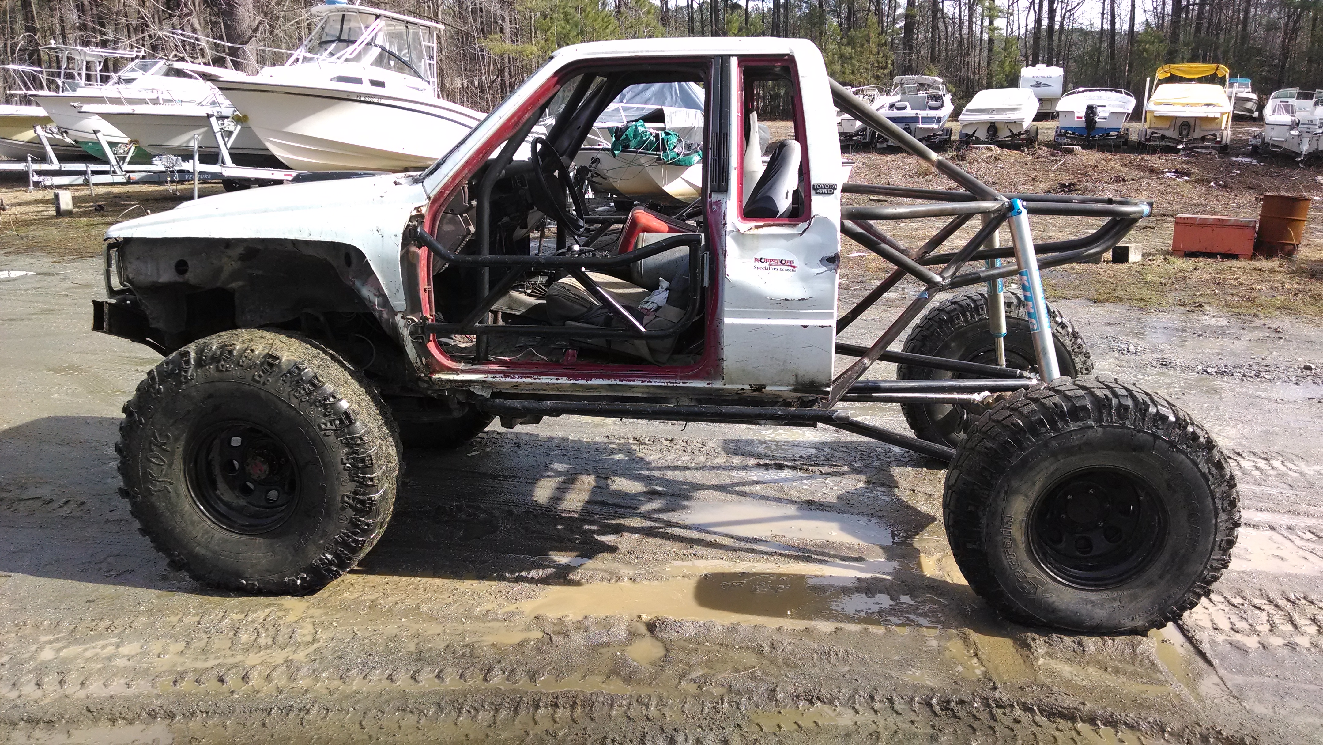

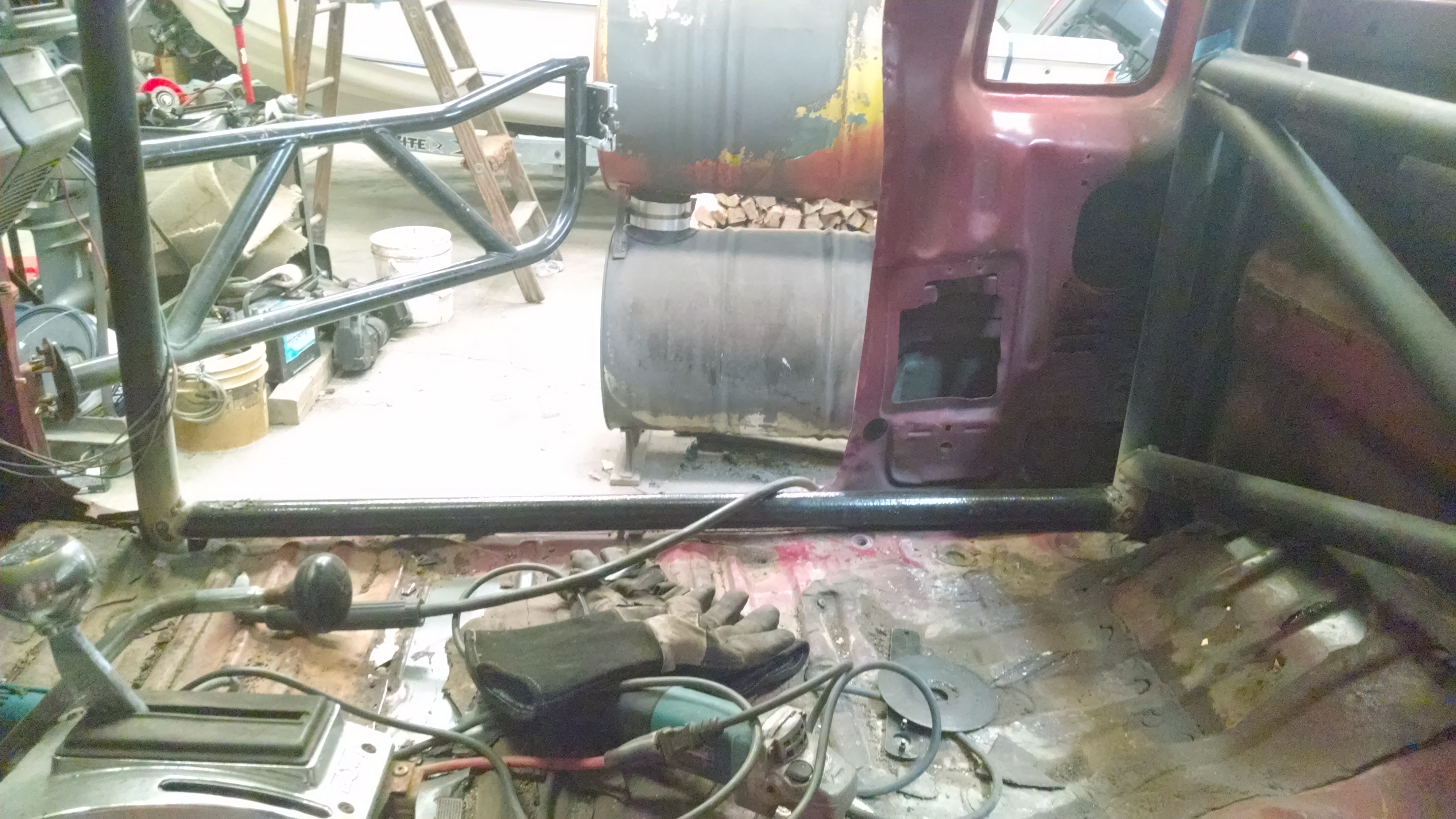

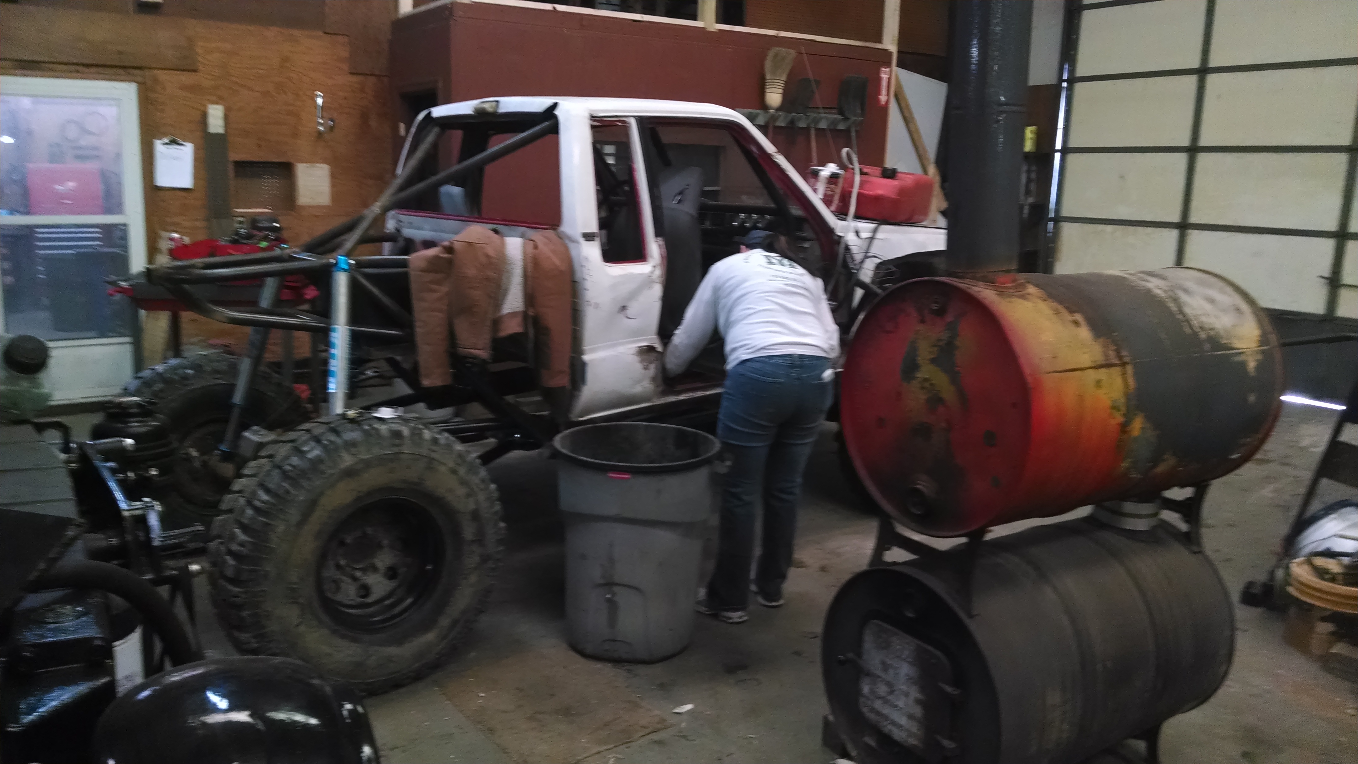

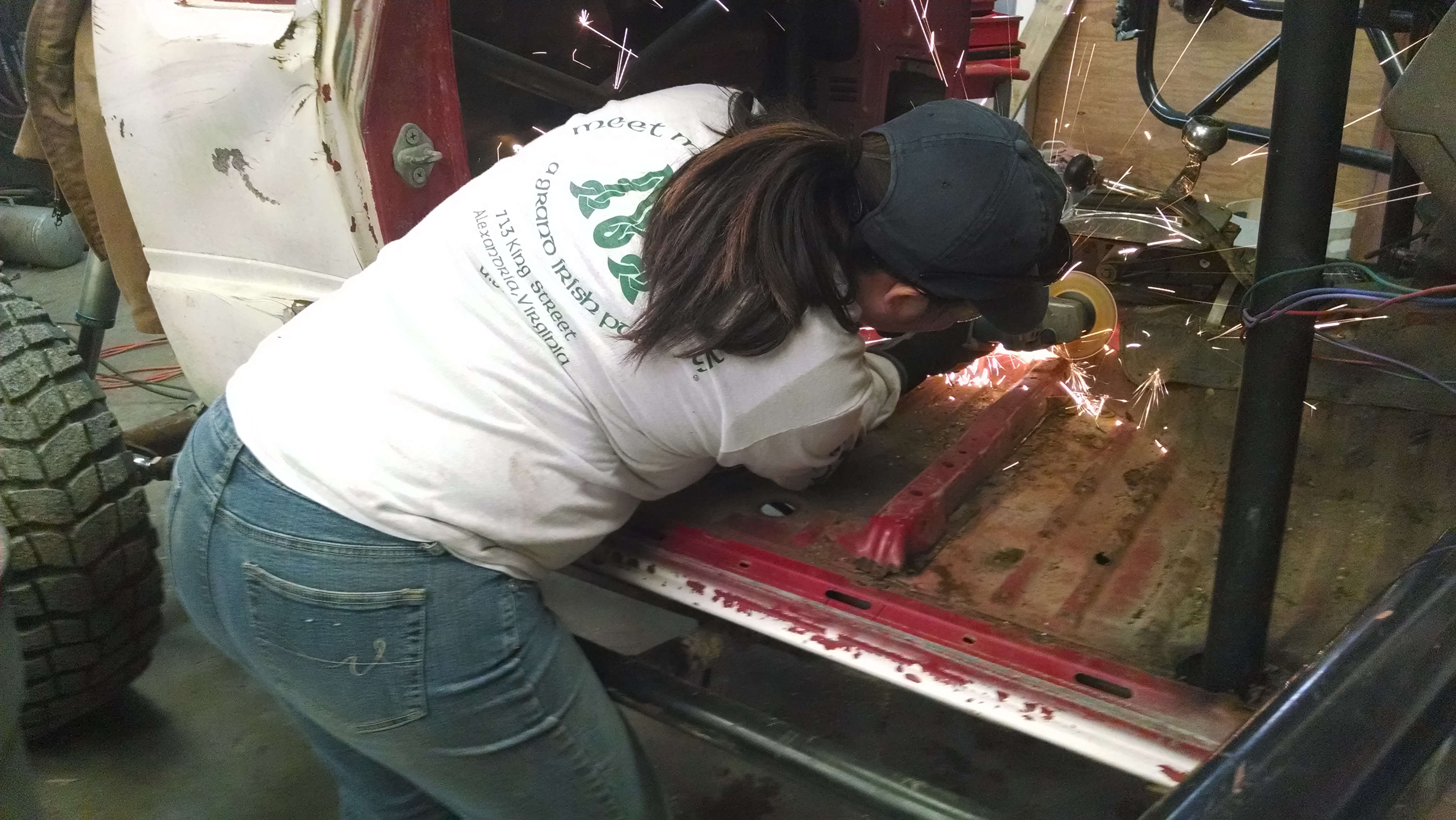

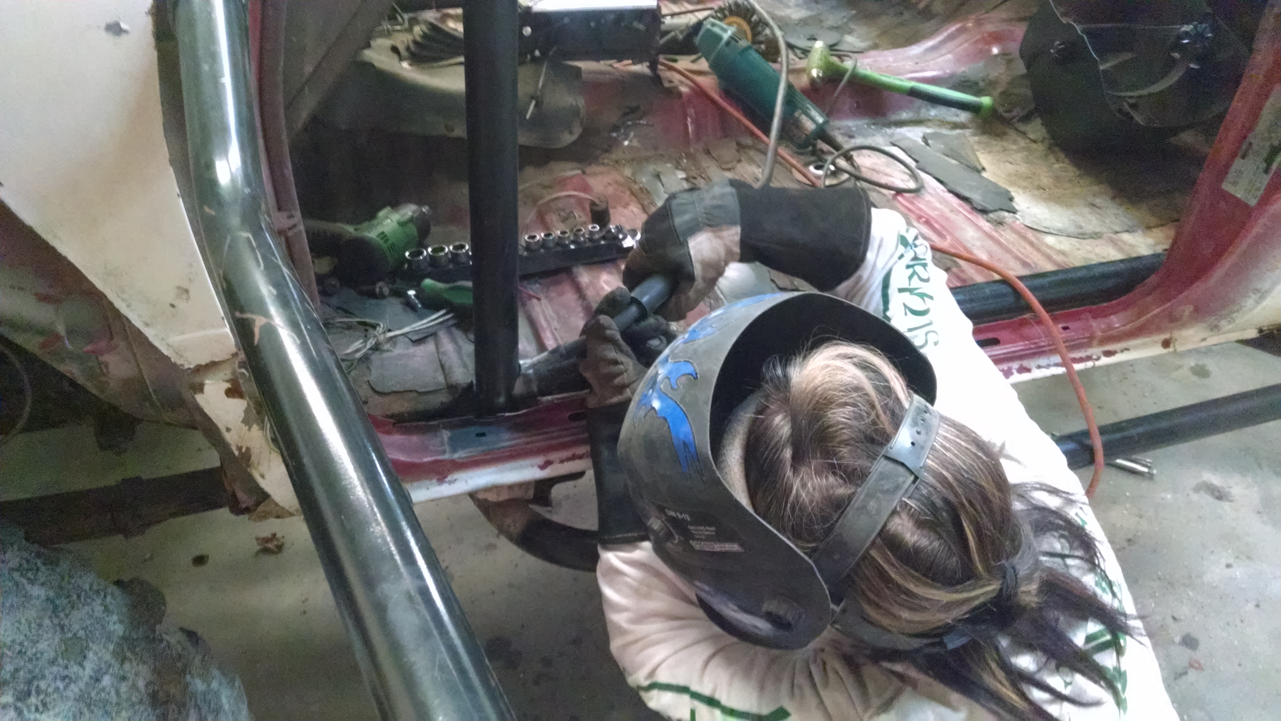

Didn't do too much today. Did some more finish welding, the GF came out to help, she stripped the interior out of the truck again and then helped cut the factory seat mounts out.
Then we started laying in the frame work for the seat mounts. She got a quick lesson in welding tacking the bars in before I full welded them.
A quick video of her heavy ass tack. :laughing:
VID_20140216_133444775.mp4 Video by RESWORDS | Photobucket
Anyhow, Got both bars in before time to go home. Heading out of town for the week to attend CDI school in Alabama so had to get home to pack.

Very nice that you won the Competition!! Build is really coming along. That thing has crazy flex

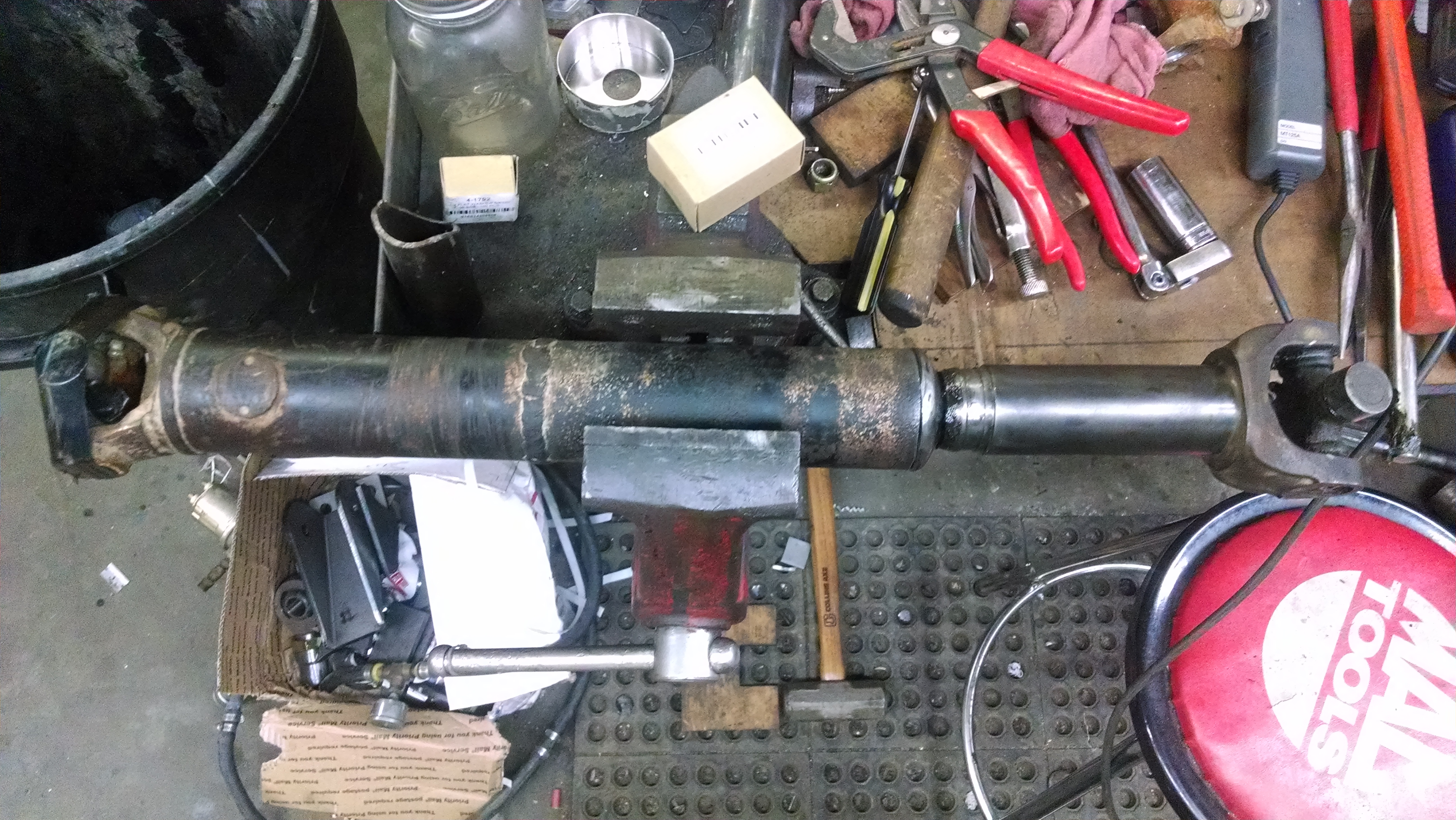

Started on my driveshafts today. Cut the original down to make my front section. Need to find another for the back piece. Going to run a carrier bearing on the crossmember.

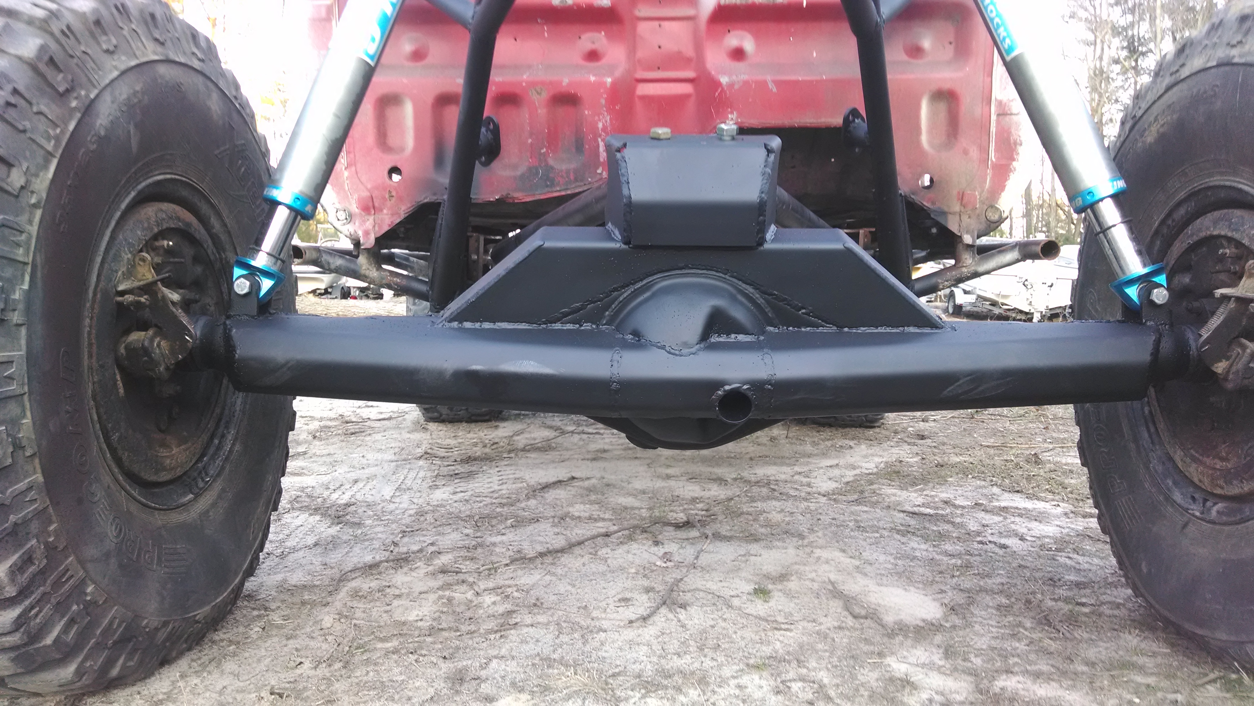

Also got some painting done.

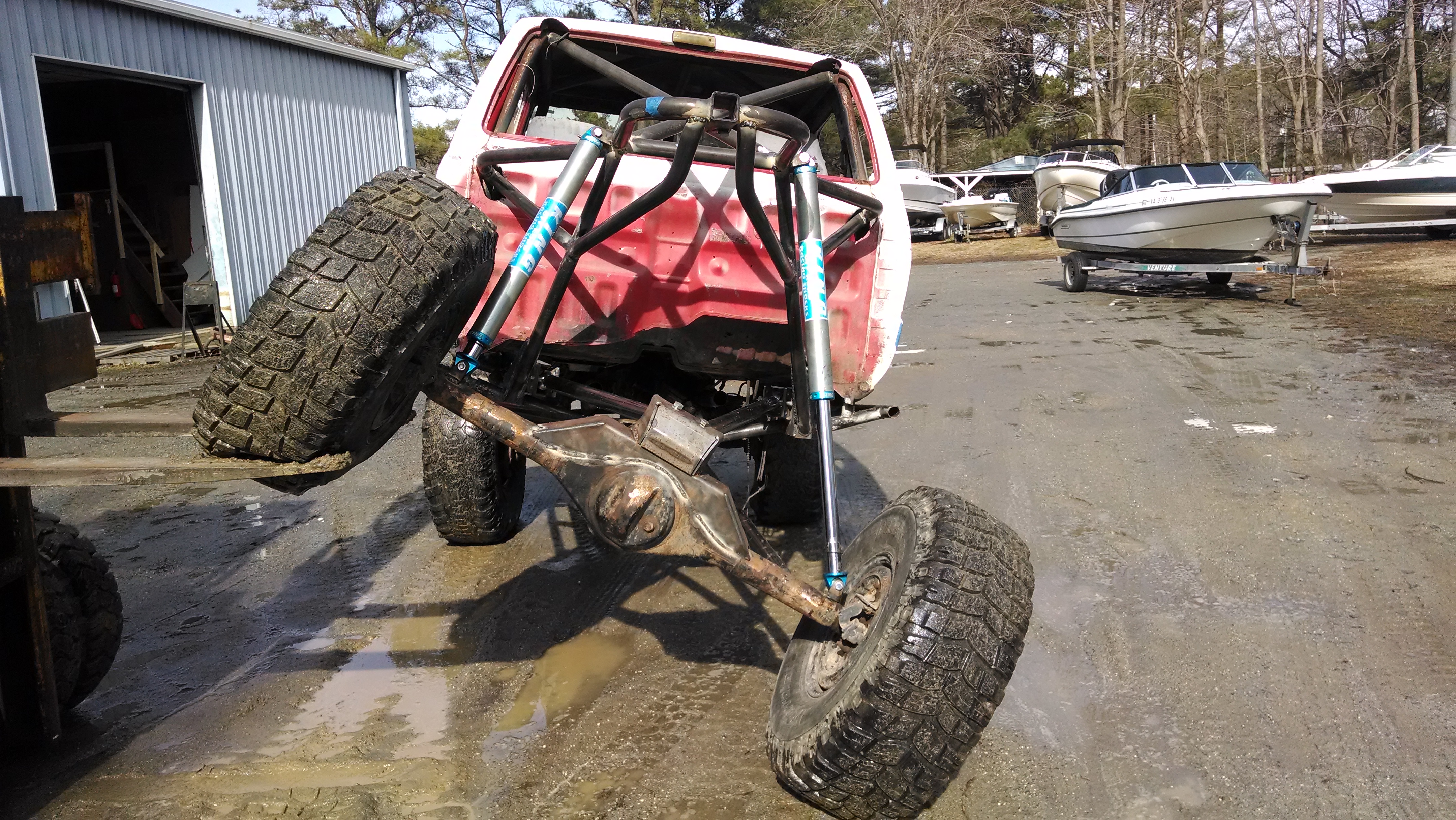

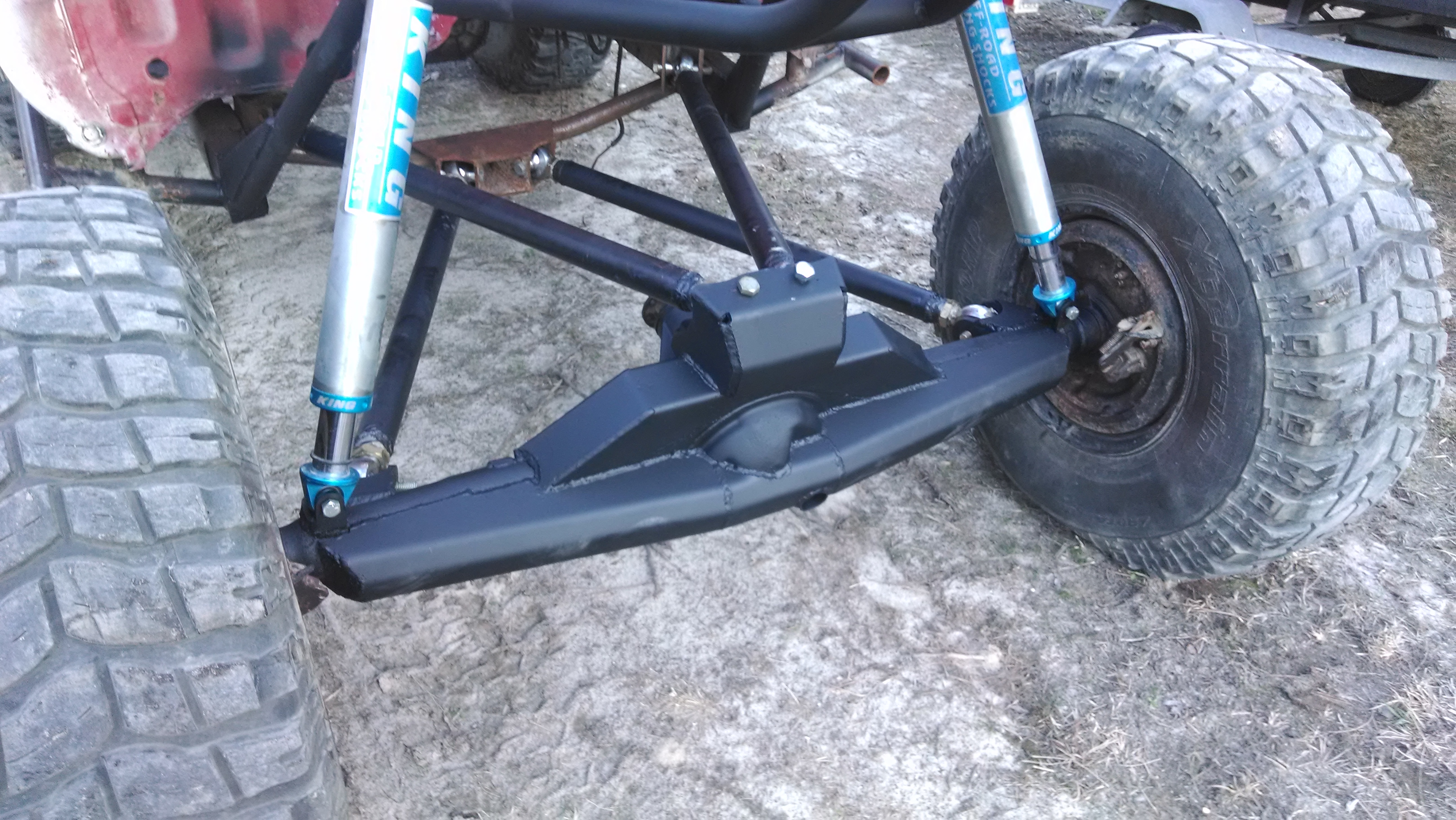

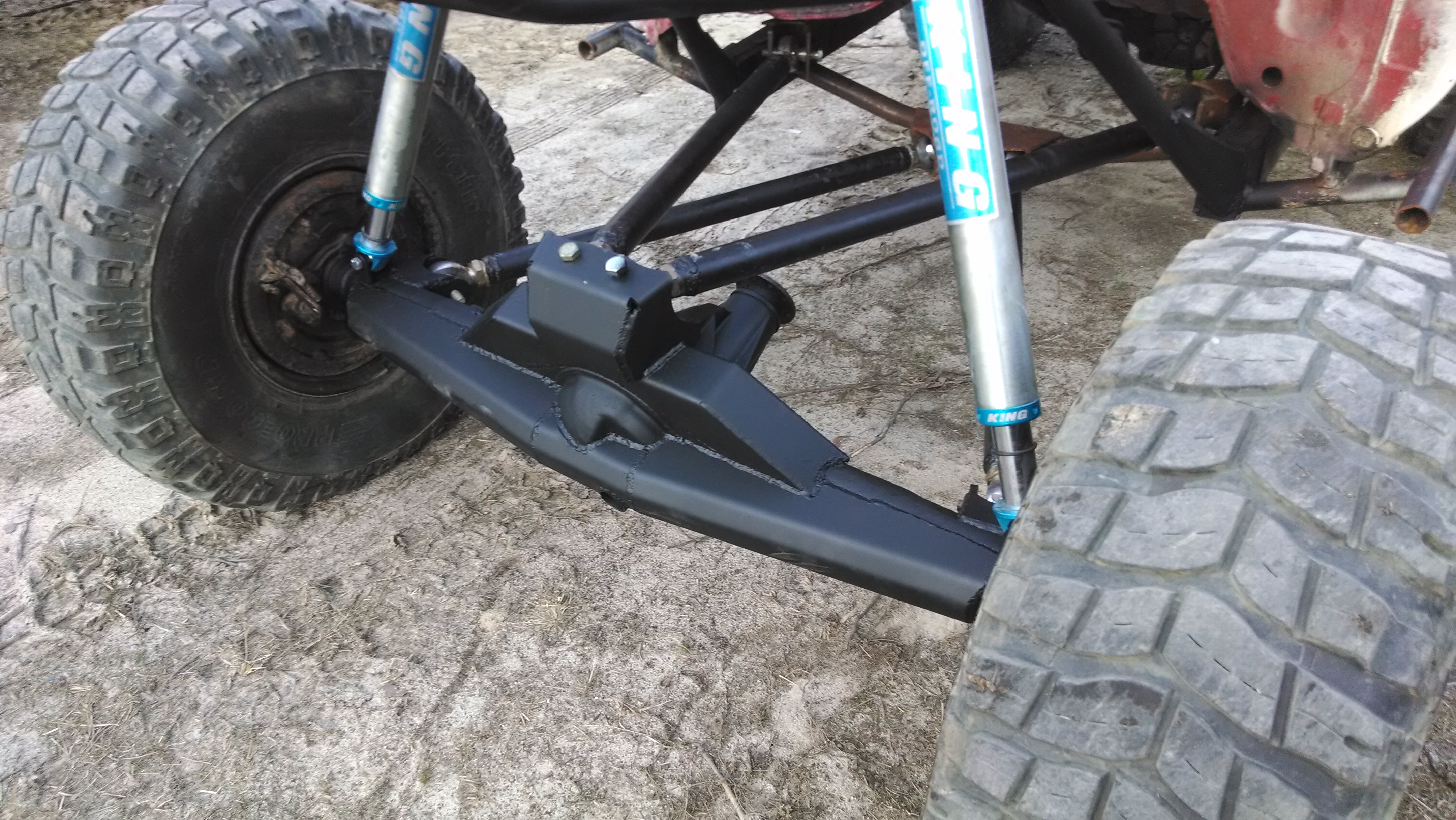

Got my Ruff Stuff rear truss on. Great fit and easy to install! No I can take it off some sweet jumps!!!

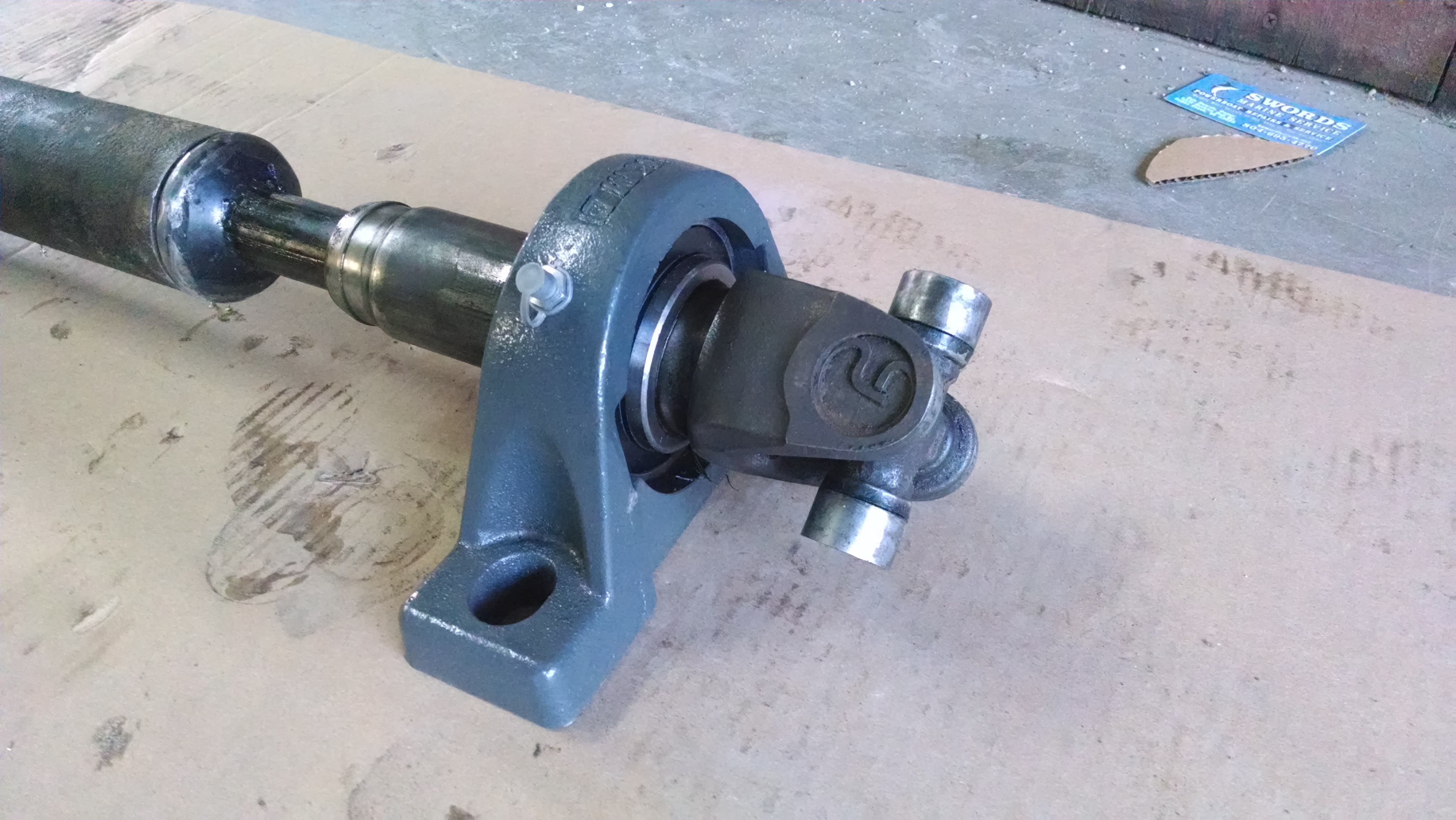

Also the carrier bearing for the driveshaft showed up.
