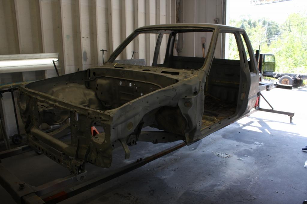

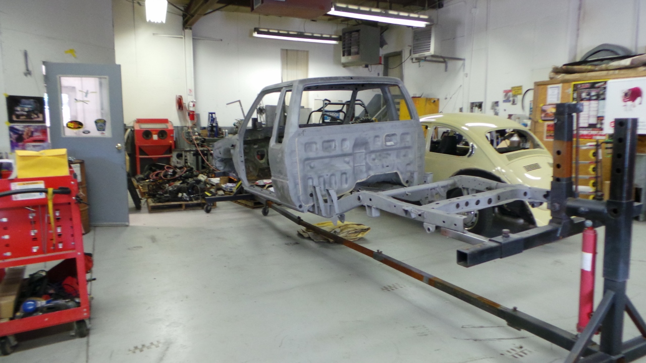

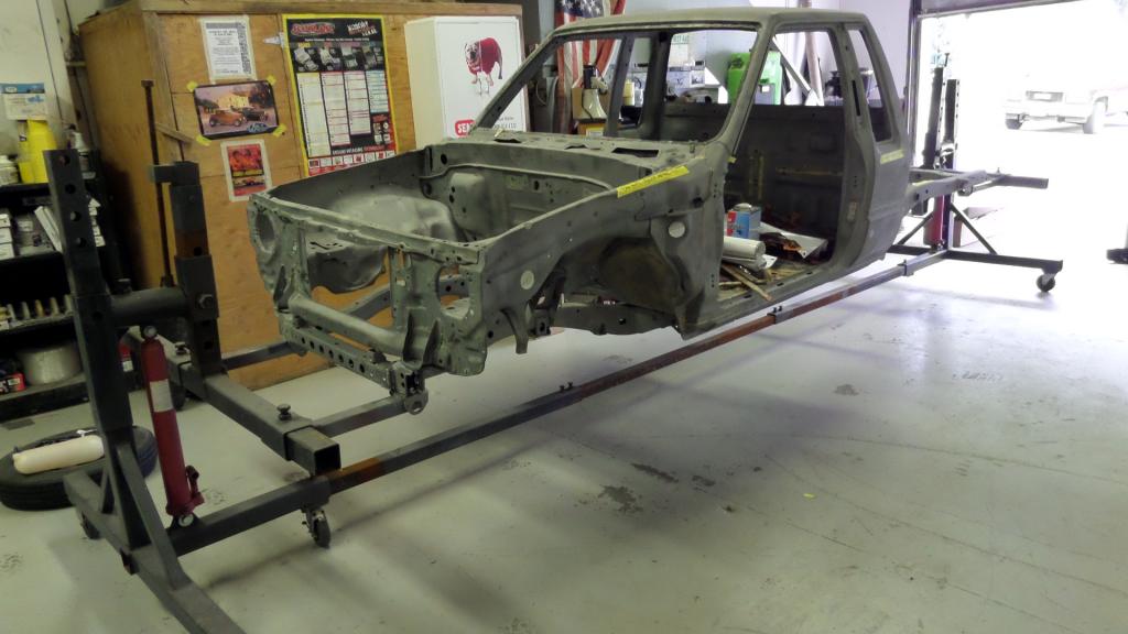

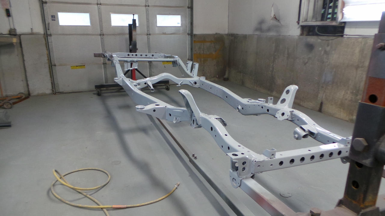

Here are a few pics of the truck and frame after soda blasting and priming. Lots of body work to do still but it is really shaping up at this point!

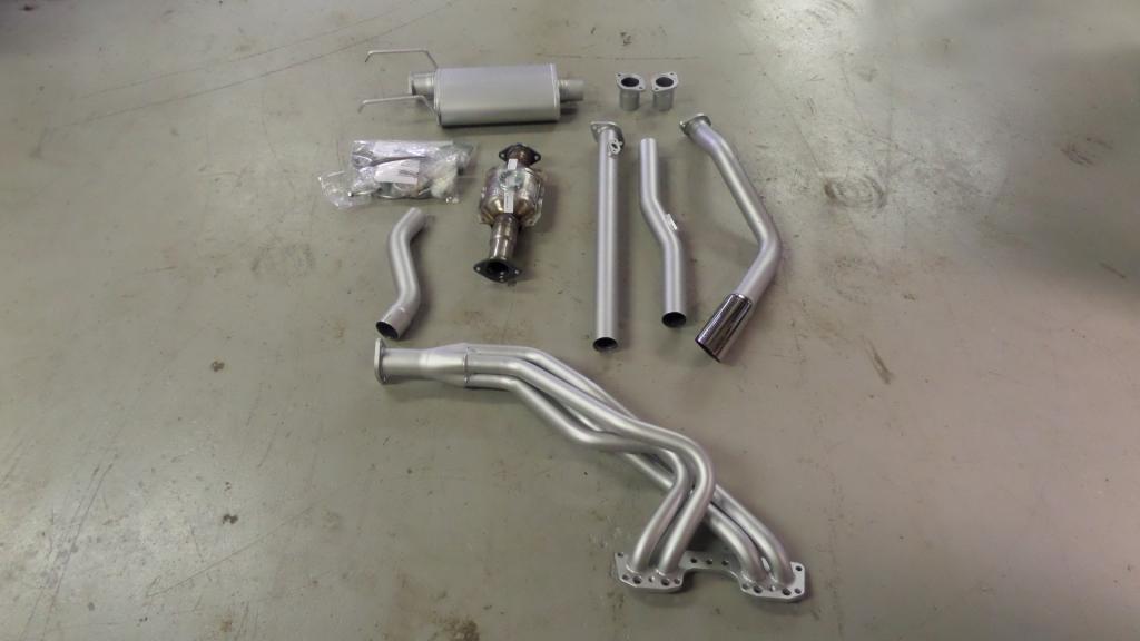

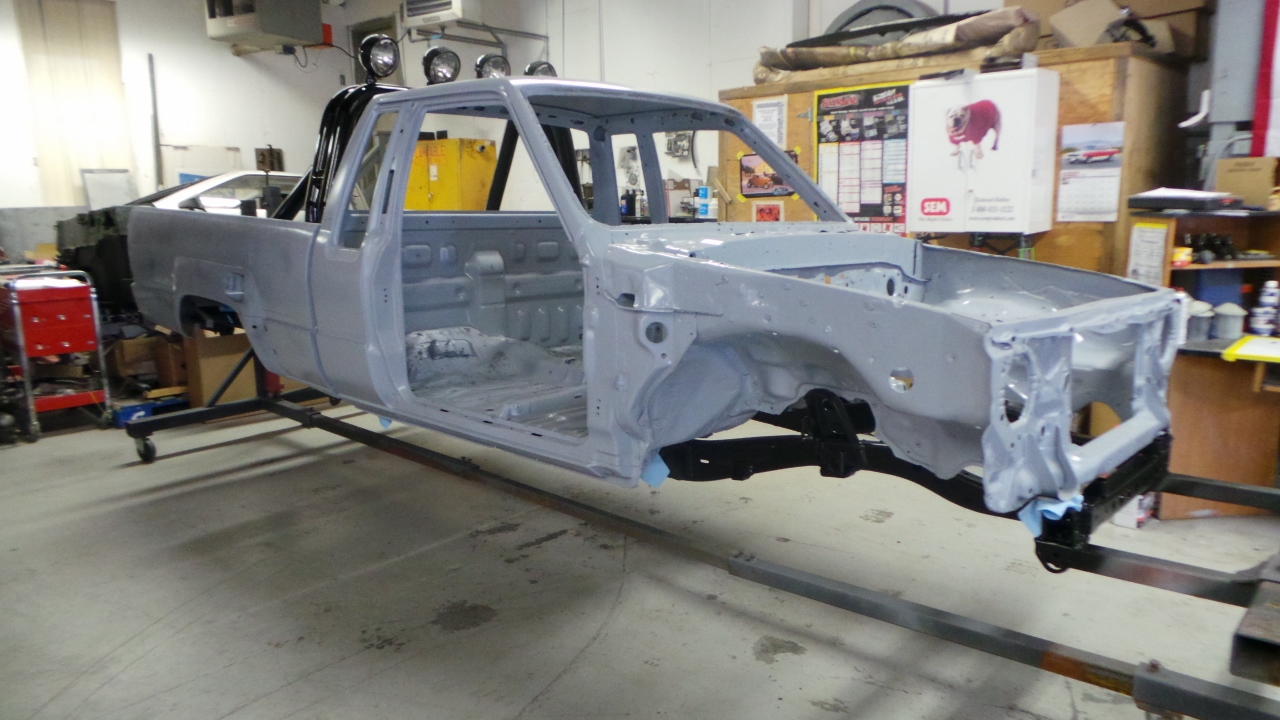

A few pics including the cab and frame after soda/sand blasting and the full stainless LC Engineering exhaust system.

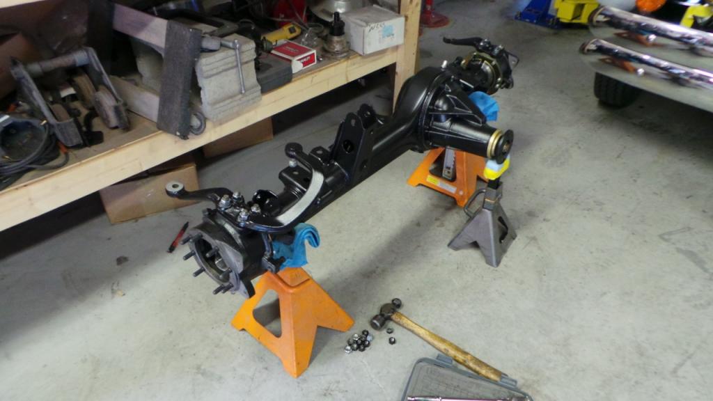

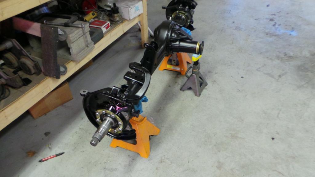

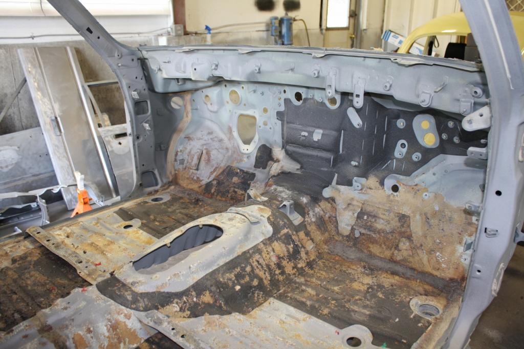

A shot of the cab stripped down and of the front and rear axles near completion. I knew you folks would appreciate seeing some hardware!

Dang, I thought that my axles looked good... I'm so ashamed of myself now...
What did you use to paint them? That paint laid down really nice!
Old Jan 7, 2014 | 12:11 PM
  #33
MTR's Avatar
MTR
Joined: Dec 2013
Posts: 52
From: Royalston, MA
Yours look great too man, don't be ashamed lol!!! Ours were gutted, sand blasted and then sanded down with 80 grit. We laid down an Eastwood etching primer followed by two coats of Sherwin Williams P30a surfacer. The final coat is an Eastwood Ceramic Satin black. Purdy......
