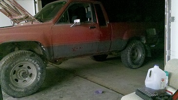

Well here is where it all starts, i was looking for something to build up and take out around all the old school trails along the river that no body has been on in years and just enjoy the day, find new fishing and camping spots and just get away from the city. So the search began and i found this, it an 85 with a bran new rebuilt motor. The guy said he could not keep it running unless it was hooked to another vehical (jump start). So 500 bucks, a test light, a charged battery and 4 hours later i have a running truck. All it was was a bad ground on the alternator, go that fixed and it started up first turn of the key and i took it out for a cruz, and it hasnt died since.
so here is my build thead, got suspension on the way, a new set of 35" BFG KM1's and a wish list a mile long. tomorrow i plan on going through everything and see what other surprises might be hiding and as the parts come in my new TOY will be getting dressed to impressed.
Hope y'all enjoy.
