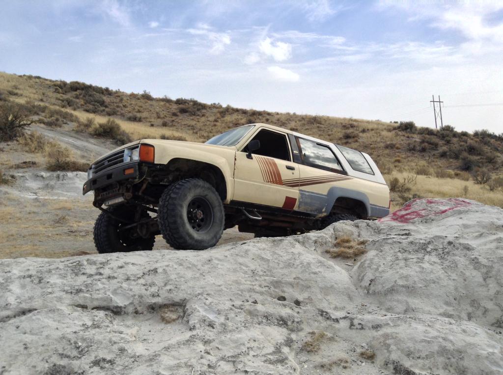

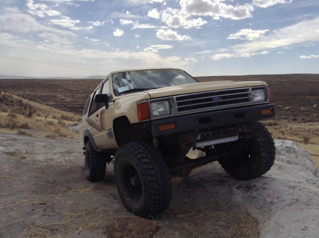

Got to go up into the desert and test the 4wd. I see a locker in my future, anyways here's some poser pics.

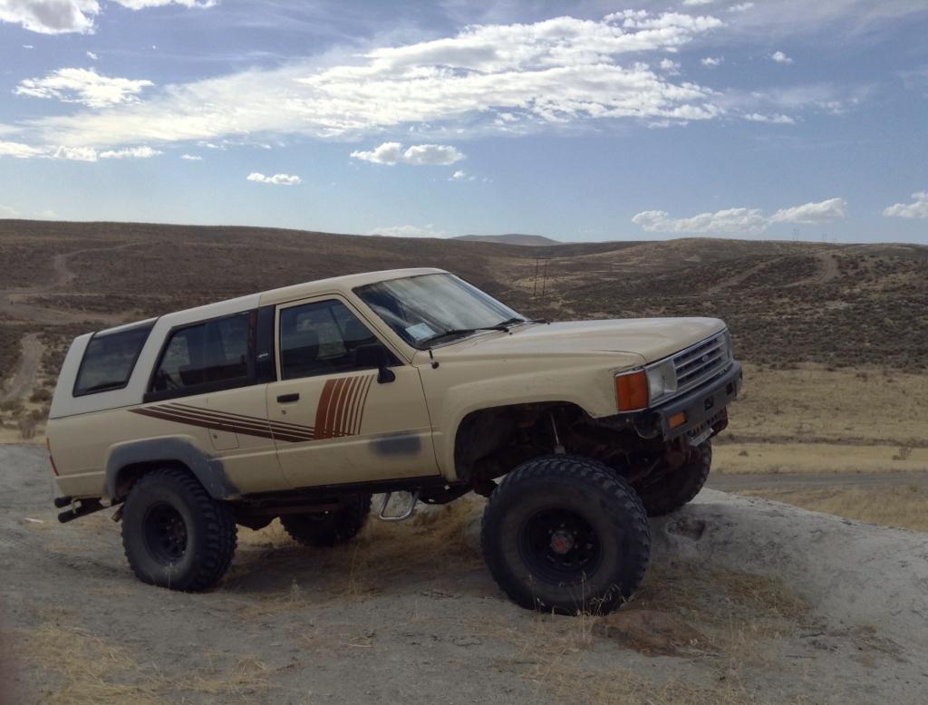

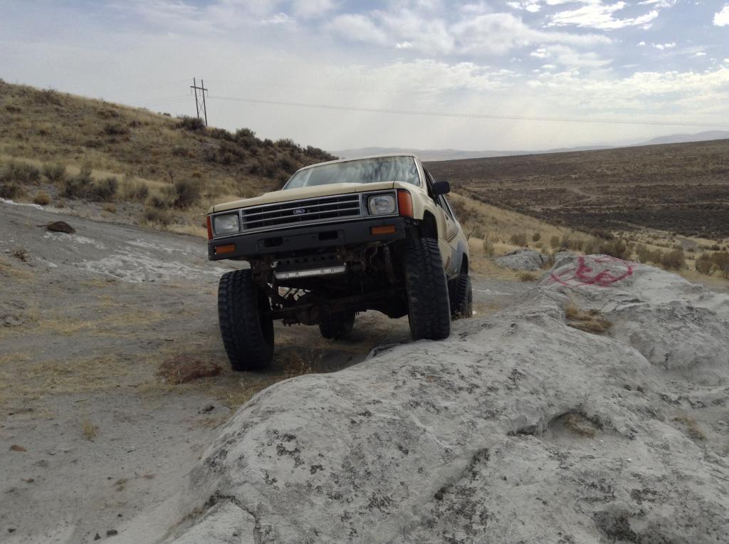

How did everything perform ? Must feel good to get it off road after all this time.
That radiator sits really low . Protection in the future...

It performs like an open/open covered wagon haha the suspension could use some love. Other than that it's great just chugs along. Yeah the radiator is huge but once I do ruf's I'll be dropping the spring hangers down around 2 inches so that should protects it a bit, and I'll probably fab an additional little skid plate for it. I'm back to Reno this Thursday if you ever wanna meet up and go wheel or whatever.
