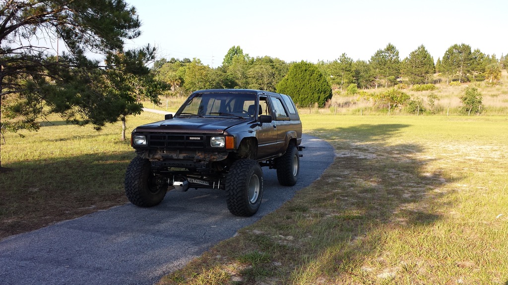

Just picked up this beauty (not really) a few months ago to build up into a wheeler/weekend driver.
Back story: The guy I bought it from was in the process of "restoring it" lol basically just tore a bunch of stuff apart and never did anything else. So I had to bolt the seats back down put the windshield wipers back on yada yada. Got it together threw on longer shackles and 1" block to keep the 33s from rubbing so bad and wheeled it

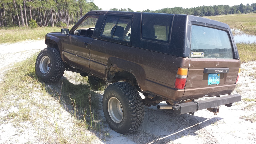

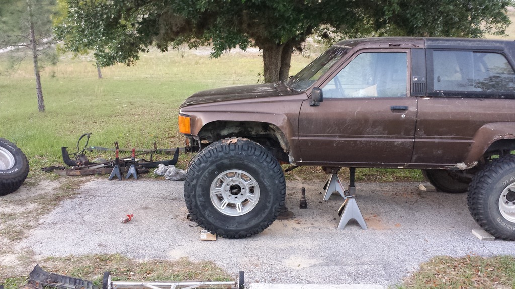

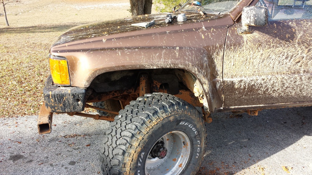

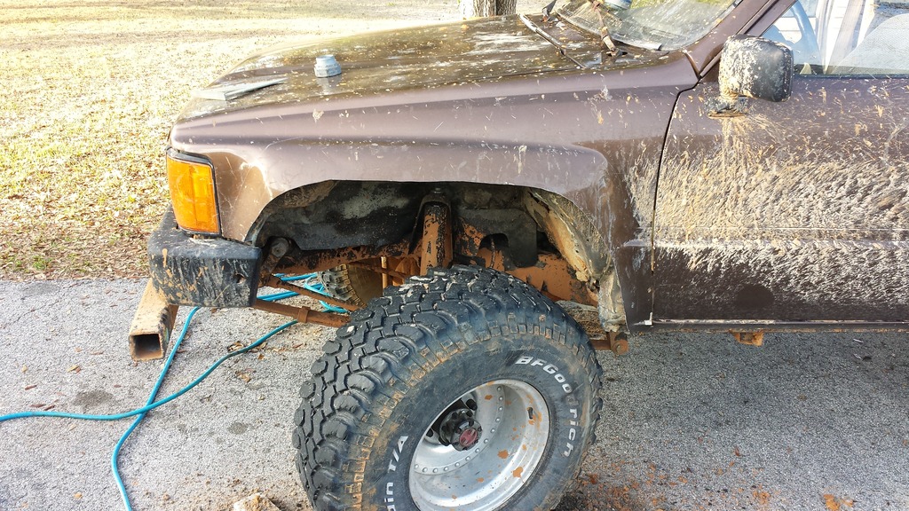

Started cutting my fenders and noticed my tires had broken bands in the sidewalls and we're cracking super bad
Before: Name:  20150225_162619_zpsuyxxzf36.jpg
After: Name:  20150225_170852_zpsnxachanc.jpg

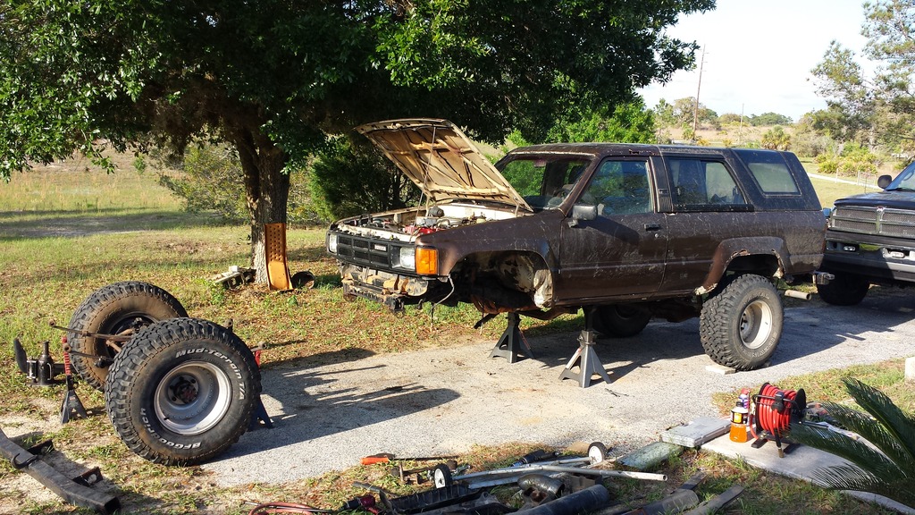

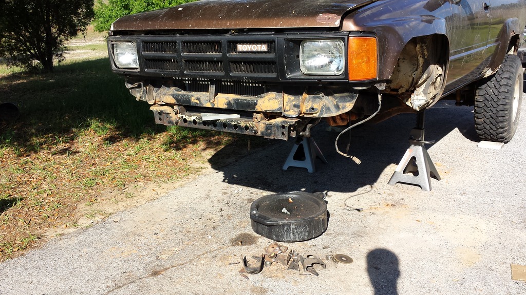

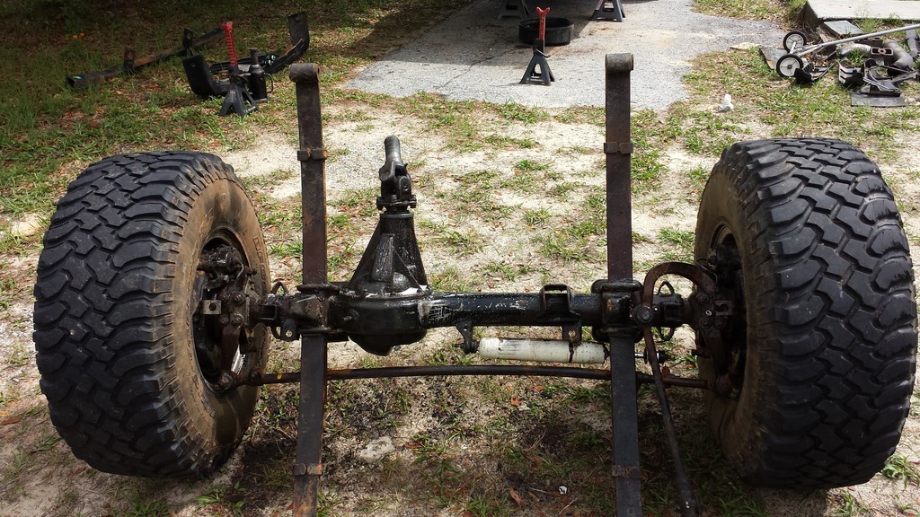

Tear down!: Name:  20150323_175756_zps0rsav5xt.jpg

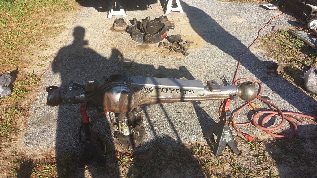

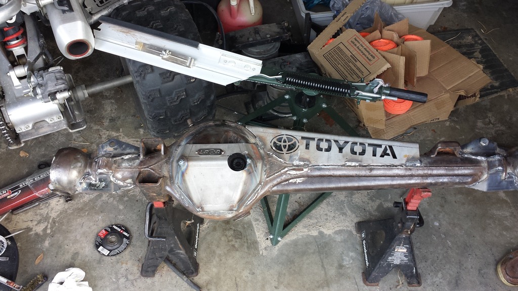

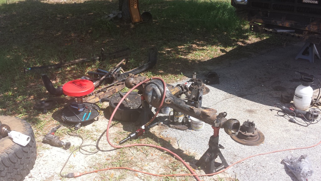

Got the axle all washed: Name:  20150325_122133_zpshg1kxplu.jpg

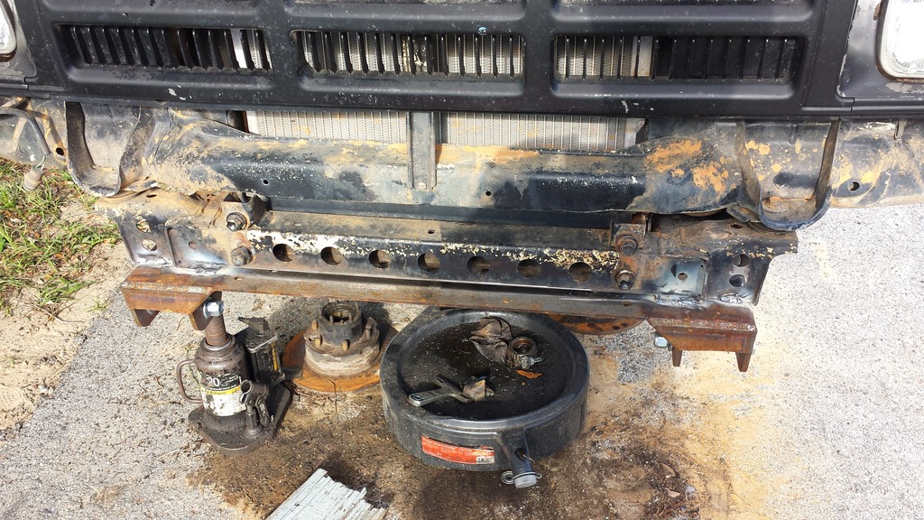

Got all the brackets cut off the frame: Name:  20150325_165950_zpsq9njwcy6.jpg

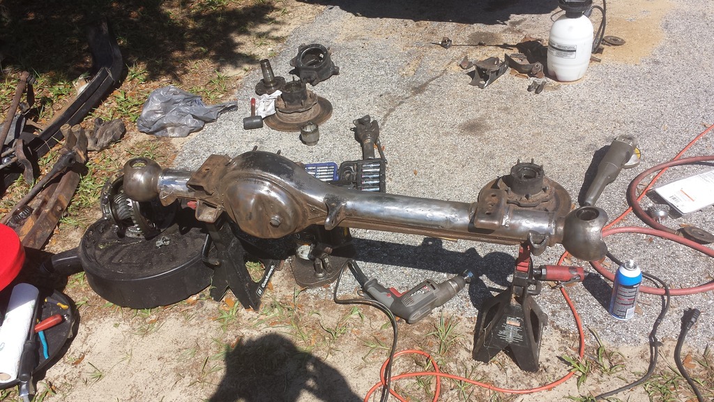

Got the axle tore down and brackets cut off: Name:  20150328_125110_zpszaqjjg9j.jpg

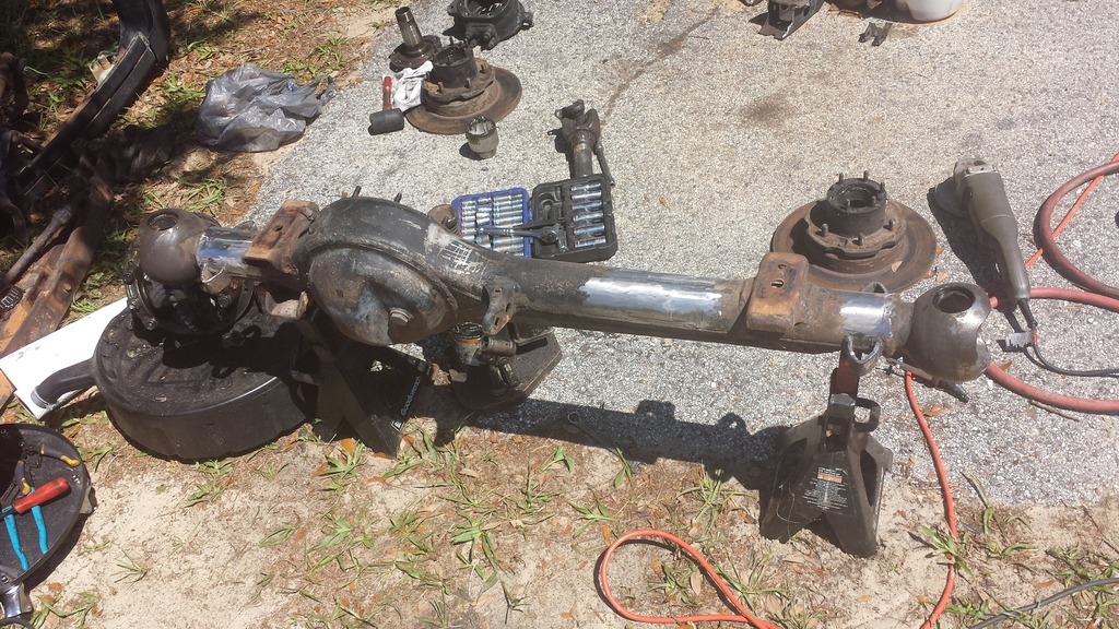

All wire wheeled up and Clean Name:  20150328_153216_zpsutyfzynx.jpg

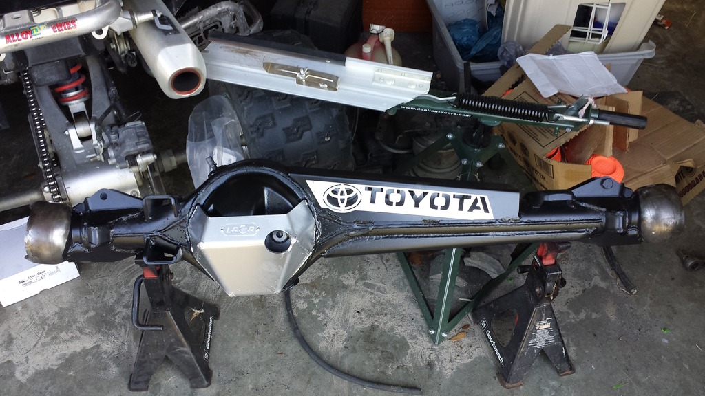

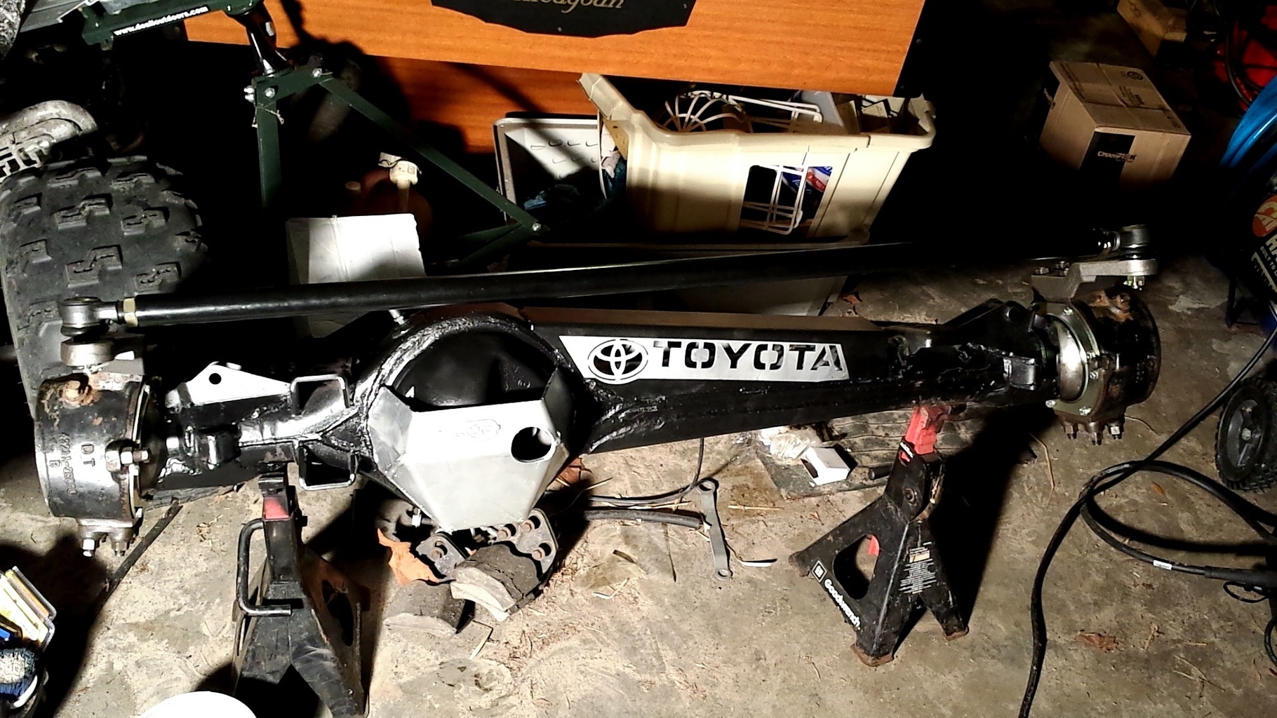

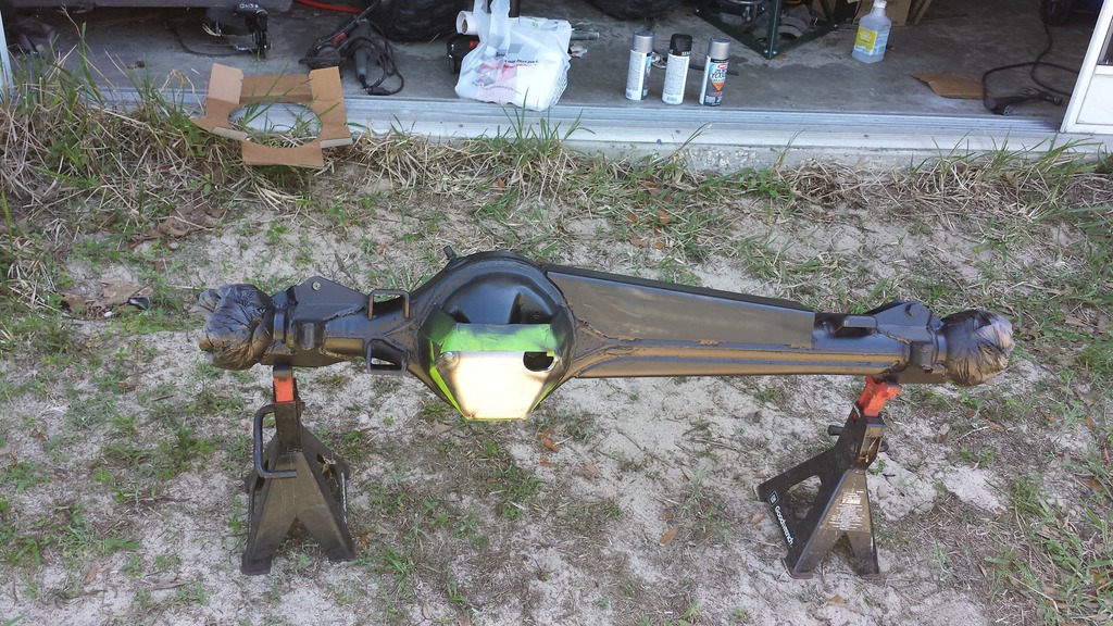

Got a little bit of work done, it slowed down cause I had to go out of town and I also noticed my front pinion bearing was fubar. .
So, new 5.29s and lock rite is on its way
All armored up
Getting painted
all done till gears arrive
don't mind my storage area haha..

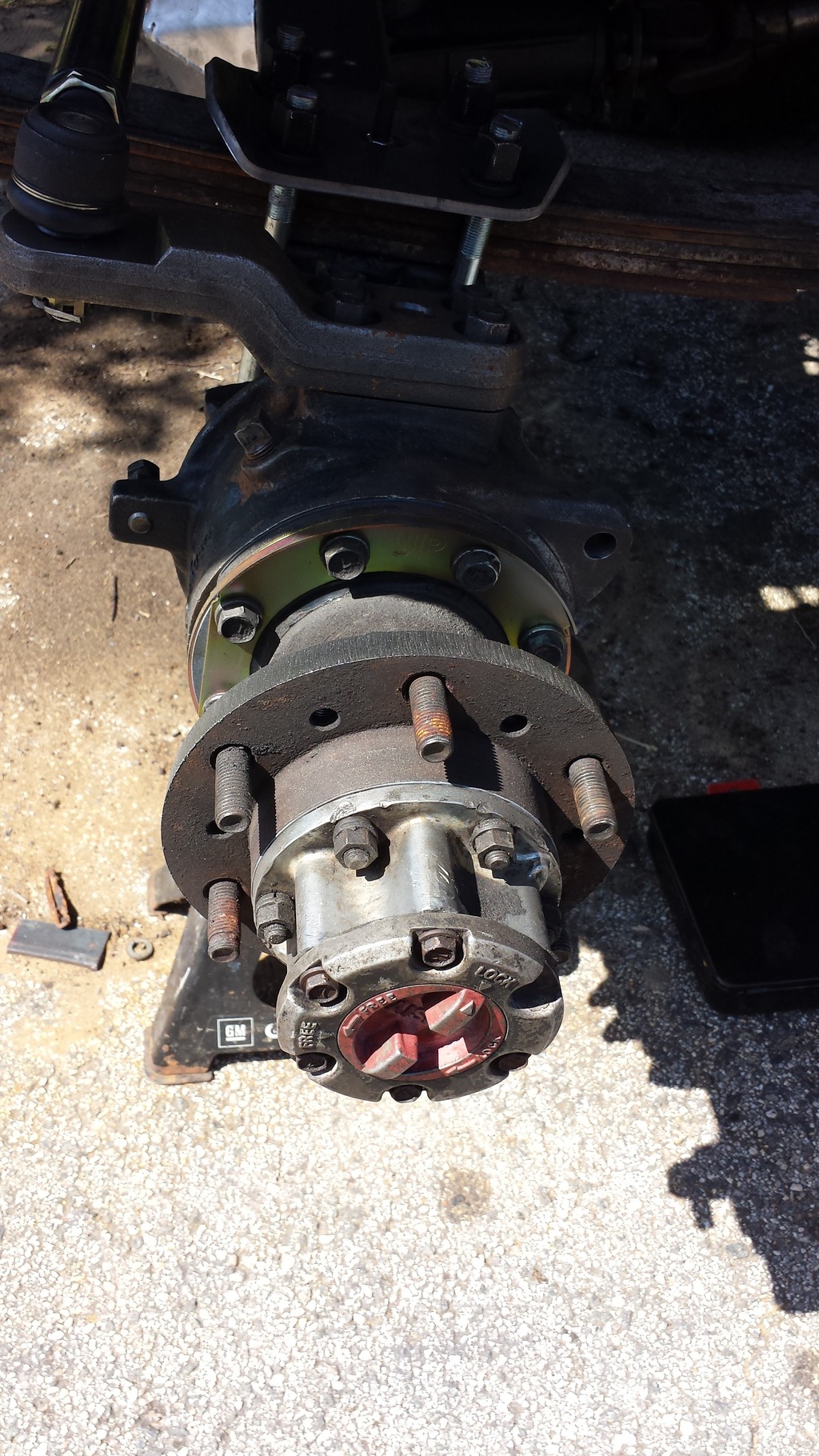

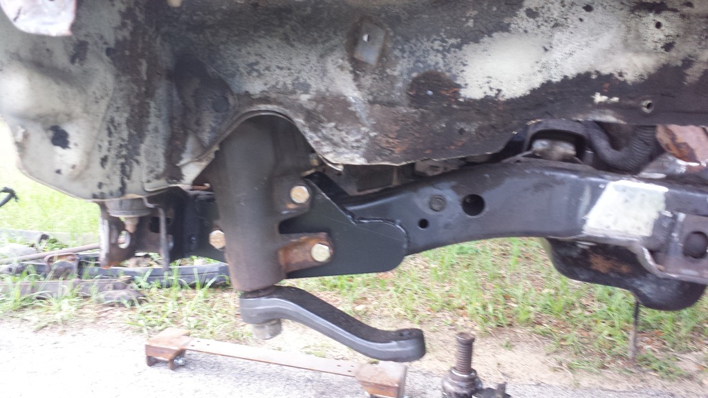

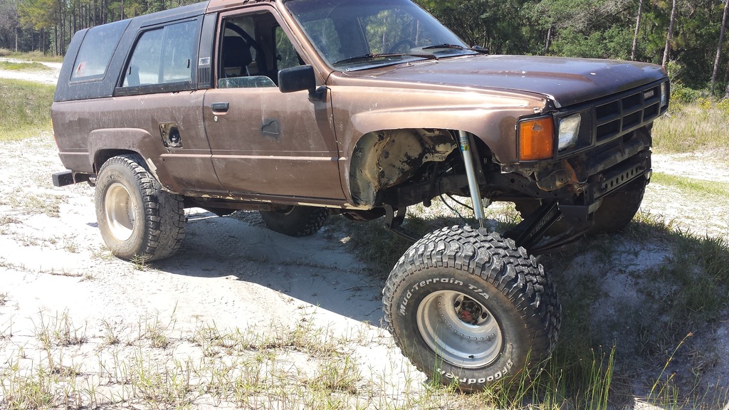

FINALLY!!! I finally got a solid weekend to work on the ole girl and had most of the parts I needed to get her back on all fours..
Got the axle mounted up and steering on

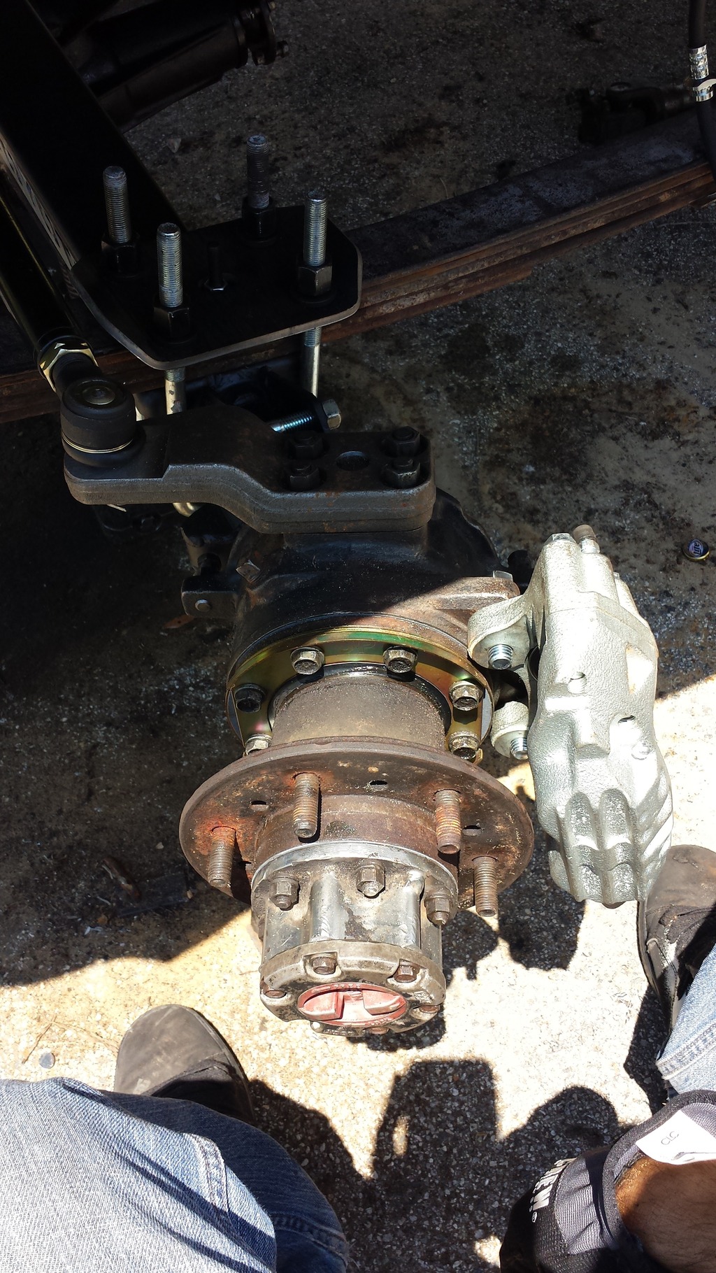

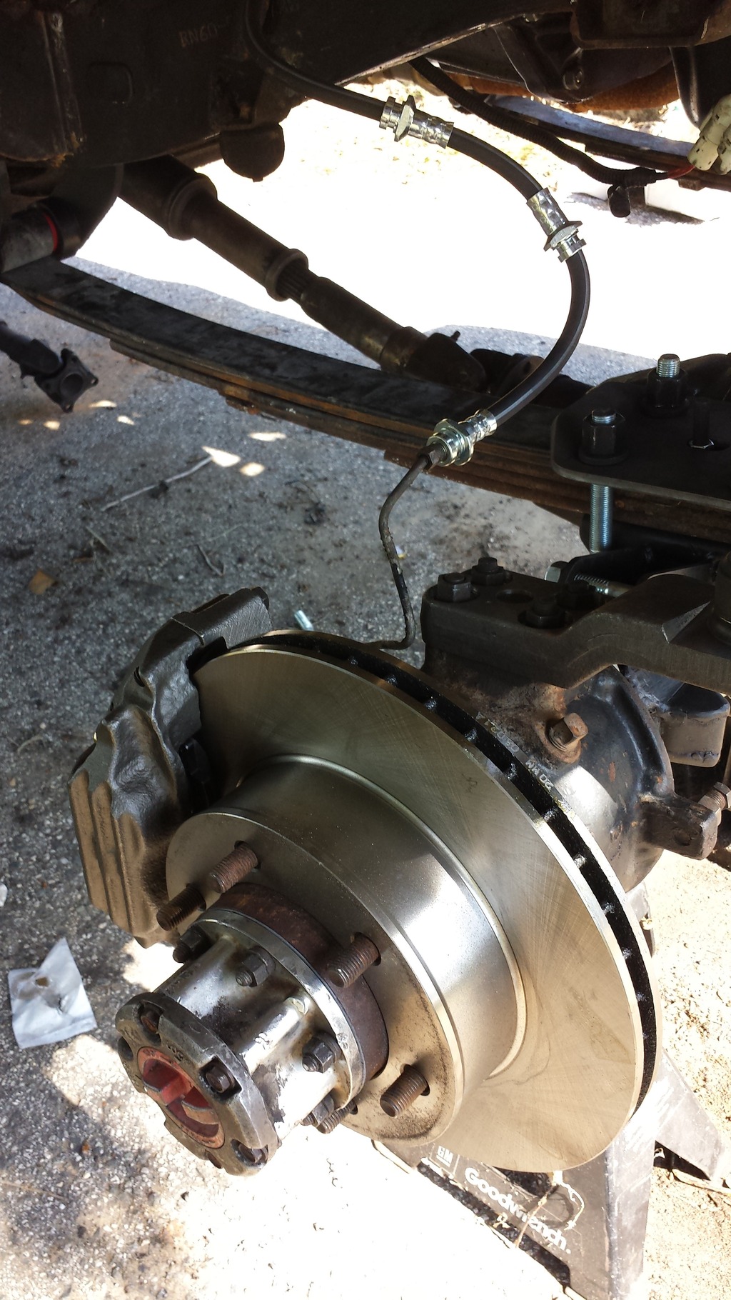

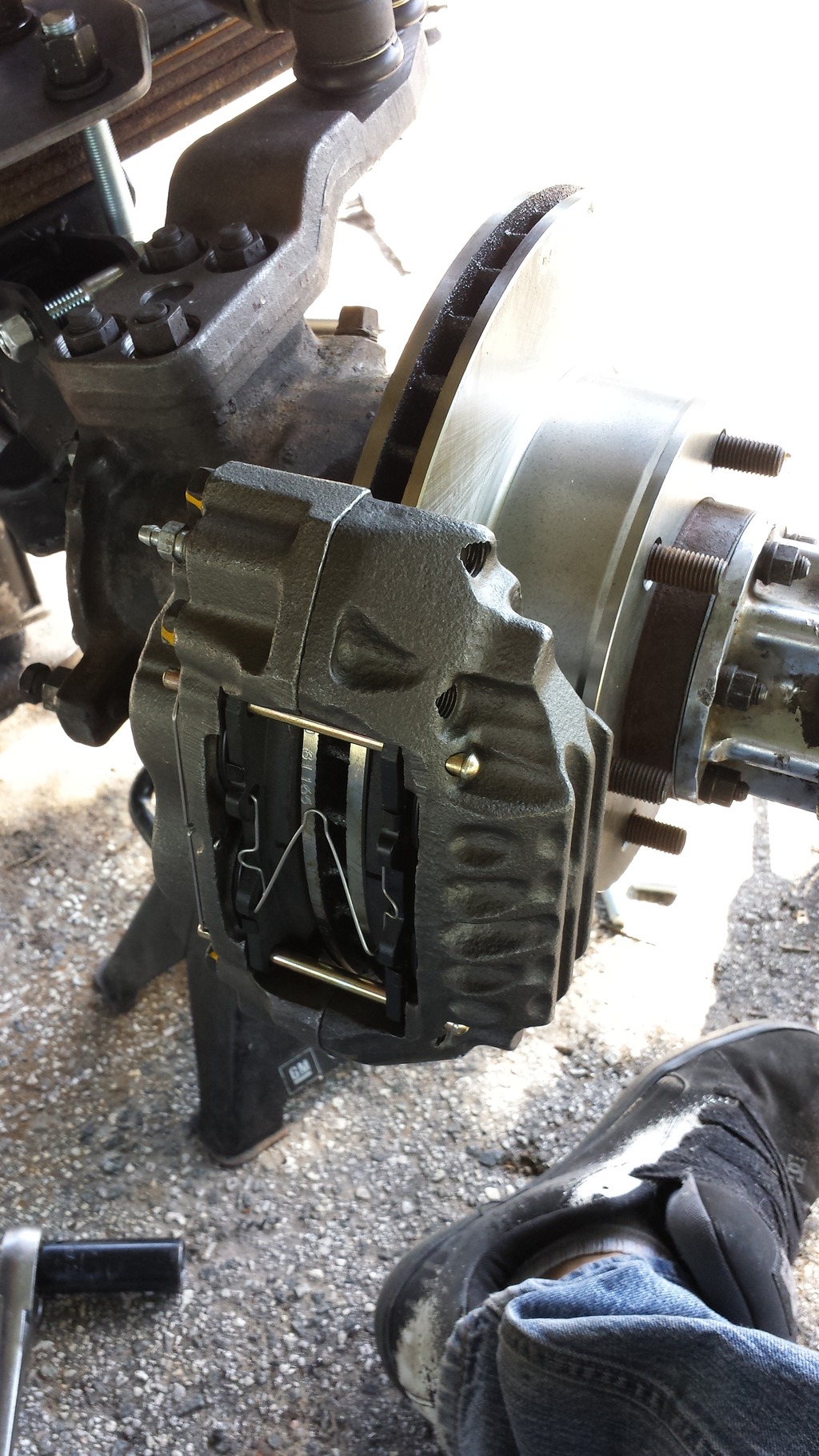

I got my IFS hubs on and my V6 calipers tapped

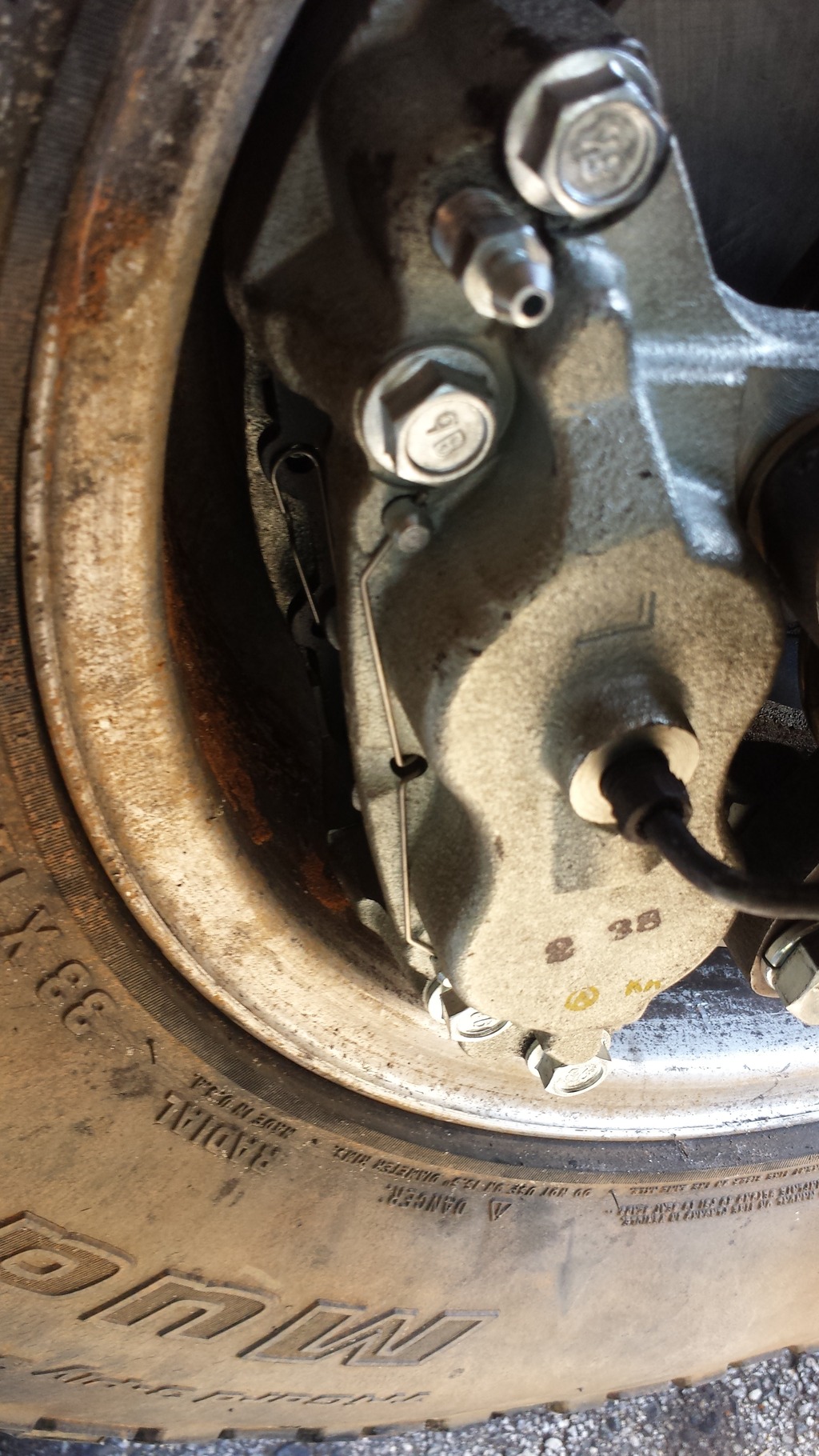

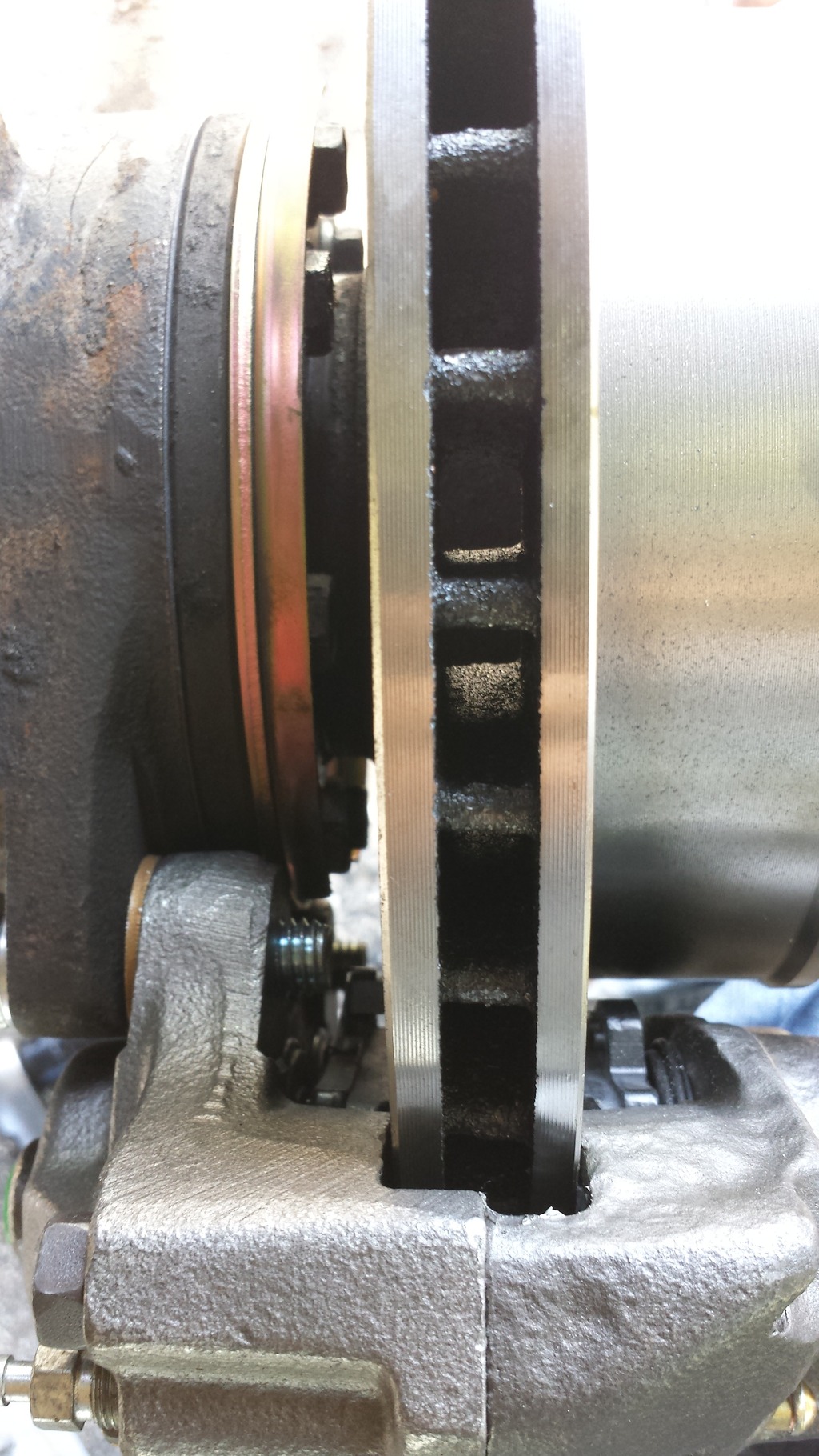

Got my hubs ground down to accept the Tacoma rotors Name:  20150510_155257_zpsrvmvcdmk.jpg
Clearance with the rotor and caliper assembled
All assembled with new 300zx lines Name:  20150510_165111_zpsymulqbbt.jpg

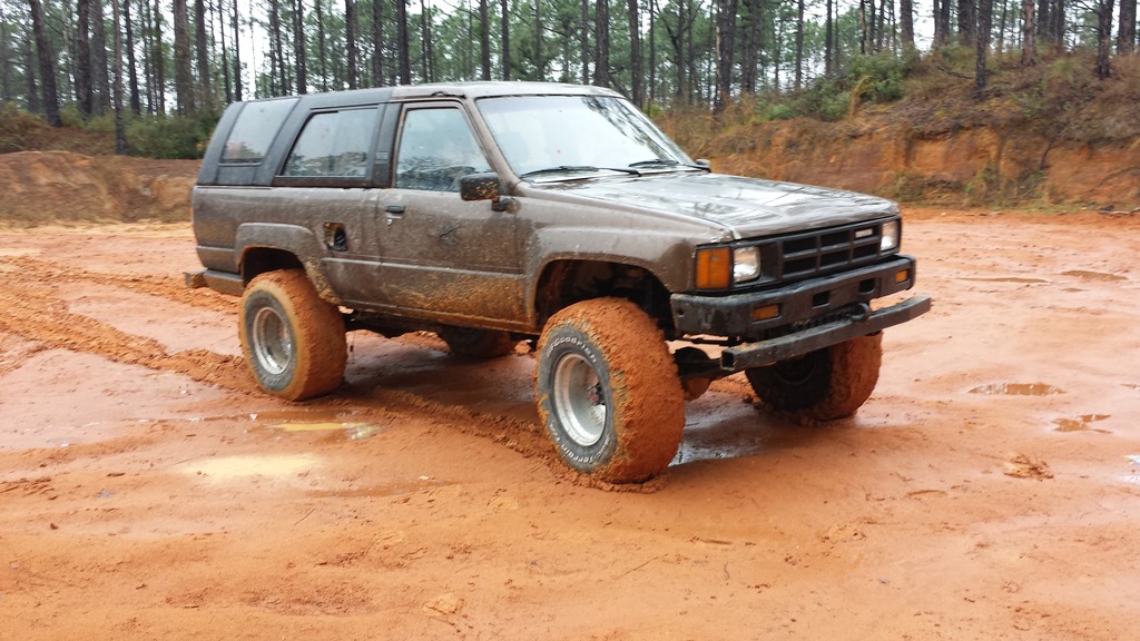

Back on all fours, definitely digging the stance Name:  20150510_132613_zps3ppms556.jpg

Looks good. One question tho. Why is your steering box rotated down that much? Do you have plans to run a flat pitman arm? it seems like you would have clearance issues when you stuff the driver side front.

Bump530, I couldn't move it any further forward without completely cutting out my core support so I angled it slightly to get another 1" or so, seems to be okay on clearance so far but if it starts hitting I'll go to a flat pitman, and thanks guys I can't wait to get the rear wrapped up and take her out for a shakedown

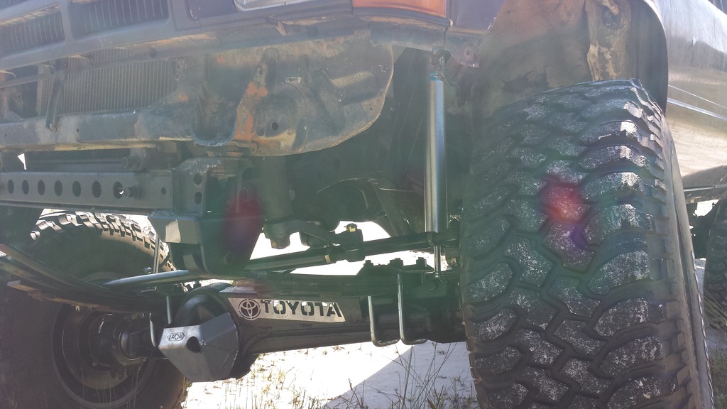

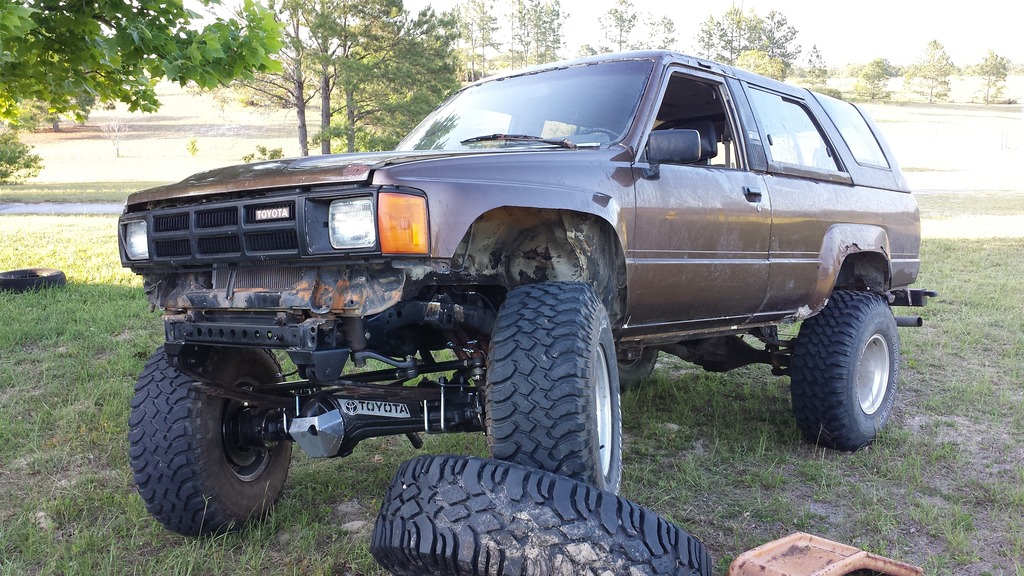

Got a tiny bit more work done, got my shocks mounted (didn't get that many pictures) but got to take it out finally and sweet Jesus I need to get the rear done already
About maxed out, no clearance issues with shocks or brake linesName:  20150522_162534_zpskixnm6vj.jpg
Other side stuffed

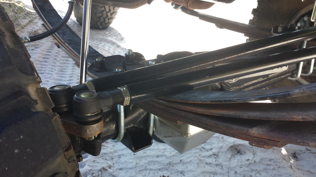

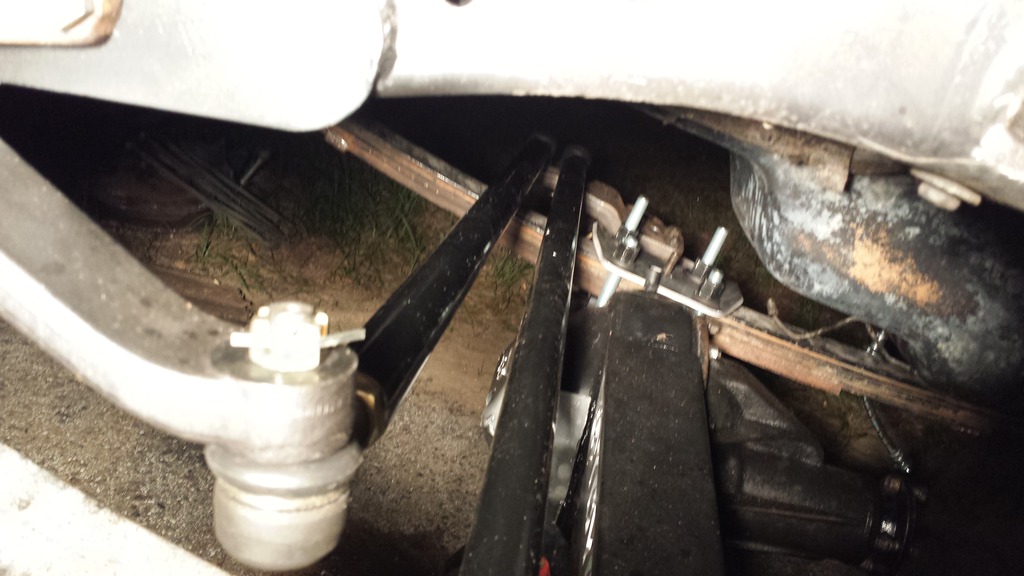

Got a slight contact issue withe the steering drag link, it barely touches so I'll order a flat pitman and swap it later
Overall I'm pretty happy with it, I might end up pulling a leaf and swapping it with an add-a-leaf. It seems to sag to the pass side, but we'll see after a few wheeling trips and the rear is done...and oh my god does it stop, super glad I went ahead and did the brake upgrade while it was apart!
