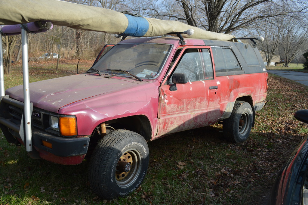

Well I've owned This truck for a couple years. The first owner was a hangglider pilot who I drove thousands of miles on this truck and picked him up so when he was getting rid of it I said " give it to me " and he did.
A couple of months after he bought it brand new in 85 he rolled it down a cliff.
First thing i fixed was the headlight switch. His Toyota mechanic said he couldn't fix it, I went to the junkyard and fixed it in 5 minutes.
Have replaced the head gasket and timing chain so engine is clean but been losing coolent and cant figure out where? even took it to a good garage and they couldn't find the leak. I was living in N.Y. and blew up the radiator. Now I live in Georgia and its nice every day so ill have lots of time to work on it.
The thermostat has a stripped screw hole so have to do something about that, Right now its sealed in place so that doesn't leak.
All the mechanical work I can do but never really did much body work. Small bits of bondo on old cars but that's it. First body thing im doing is a new drivers door. Its crunched near the hinge so have to pull up and in to close. Have to find a junkyard with these in Georgia?
Lots of rust from New York winters, The drivers floor is like fred flinstone, pretty soon ill be stopping by putting down my feet LOL!!!
Its arriving next week so Ill be asking some questions and ill post pics when I can.
I also need a really good loud stereo LOL!!!!!

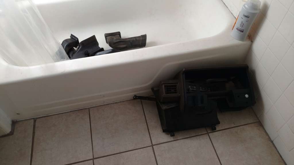

Well im slow as molasses but got a little done today. Tore out the dash and found a very dead mouse. But put all the parts in the bathtub and scrubbed them good. They actually came out pretty good. tomorrow will work on the rest of dash, Behind the roll bar stuff.

easiest way to get 30 years of dust off plastic parts from dash. that ive found anyway.

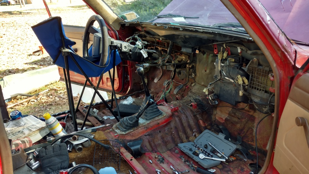

The hardest part about the dash is getting the heater controls back to where they should be. I use two colors of spray paint and mark them top and bottom of where they go to. https://www.yotatech.com/forums/f116...trucks-286766/ While in there might want to get your evaporator.

Thank you very much, I got down to the roll bar and wasn't sure what I wanted to do next but after getting 3 mice out of dash this will be one of my next steps. Very nice to know what im doing

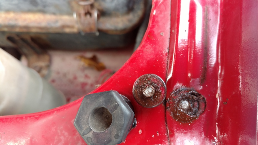

Well tried to put new drivers door on truck but hits fender and won't open so don't know how to fix that. Maybe shims? I hate body work LOL!!! My neighbor used to do bodywork so gonna have to pick his brain. Just cut up a deer for him last night so he owes me know LOL !!!!

Take the fender loose and remove one of the two bolts right at the bottom, it might slide forward enough to clear the door.

It looks to me as someone was backing up and caught the door on something. My guess is it pushed the door pillar out of alignment. Shims might work to correct it or may need to have a shop to pull it back into place. They are not as expensive to have work done as you might think. May need to shop around. You might luck out and be able to move the fender forward as mentioned.

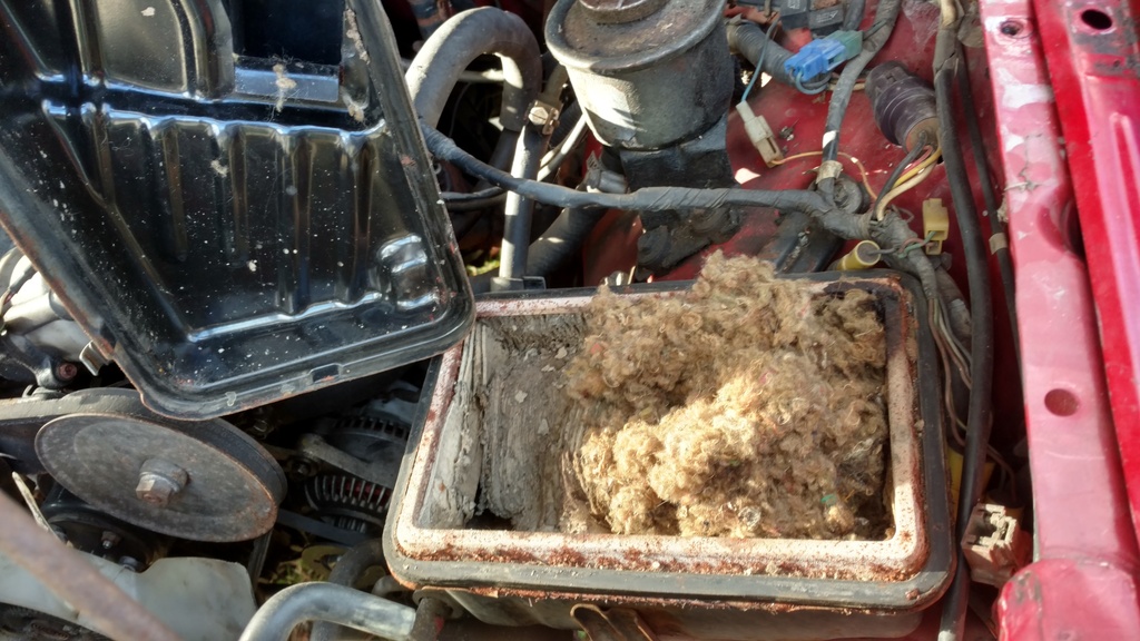

Removed fender today, broke a couple screws and found out it won't work so gonna put old door back on. Also opened air intake in engine and full of mouse nest. Have to take it out and clean it really good.

Well ordered a window regulated for my door and a new air filter. The old filter was a giant mouse nest.

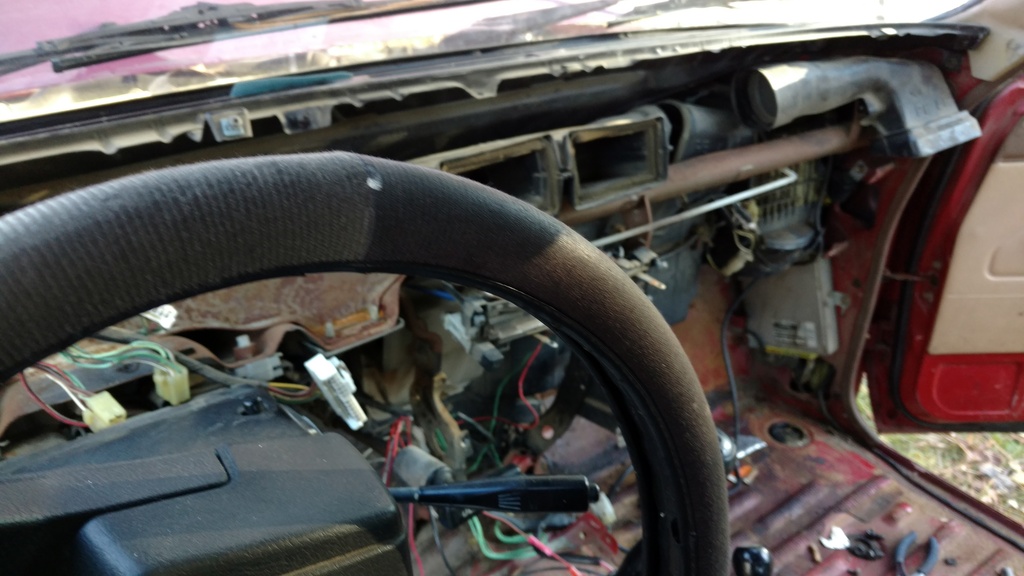

Ut oh how does it go back Name:  IMG_20151205_112134709_HDR.jpg
