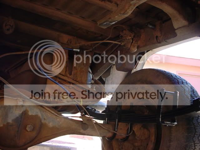

This is the passenger side leaf pack. I snapped this pic to illustrate the steel braided extended brake line. The tires in this, and the previous pic, are spares. While I was building the rear suspension, I loaned my keeper tires/rims to a buddy so he could tow his new project fj40 from Gila Bend, AZ. to Mesa, AZ. I helped him with it last weekend which is why there was no update on Sunday as promised I have some pics of his rig elsewhere that I'll post up later.

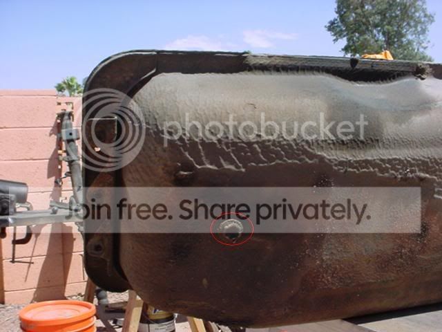

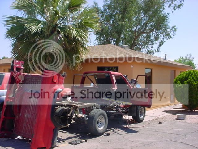

The pic below does not do justice to the work involved to achieve this feat. This is the finished product of much grunting and noodling. The process for final fitment was so intense that I could not document it while in the act. The shots I have taken are after the fact.
As we placed the bed near it's mounting position, I could see that the fuel tank would again be an obstruction. Regardless of the colossal contortions and pains I took to avoid removing the tank for the other facets of this build, I had no choice but to surrender to reality...I could not place the bed in it's 'cradle' while the tank was in place. Since I absent mindedly filled my tank before parking it to do this project, the weight/unwieldiness of the full vessel required that I empty it before removal. Ugh....siphoning gasoline orally
below is an image of the removed tank. The plastic tubing was the siphoning device. Circled is a bottle of Listerine. Can anyone guess why that was necessary?
After the tank was emptied, and the extreme unpleasantness of sucking on gasoline fumes was finished, I dropped the protective shield from under the tank. Circled in red is what I found.....D'oh!!!!!!!!
I guess the time for discovery is before the act....

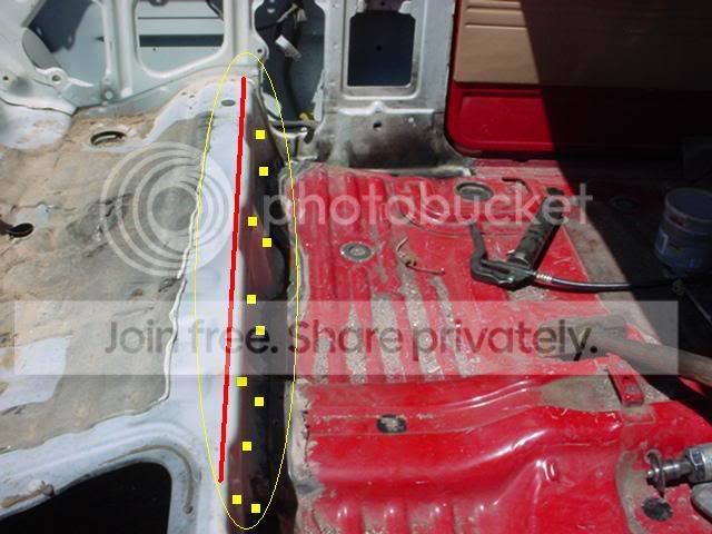

The above conditions are why we were able to remove the bed without dropping the fuel tank and why we couldn't install with it in place. Circled in yellow is the bench where the rear passenger sit. The fuel tank sits directly under the right side and above the plane of the floor pan. With the cab pillars in place and cut 1/4 inch long, we could not lift the bed over the tank while sliding it under the pillars.....let alone aligning it at the critical junction located at the door jamb/cab pillar/floor pan/rocker panel. We either had to cut the cab pillars out an weld them back after fitment, or we had to remove the tank. Since cutting the pillars is as rookie as welding the bed straight across the floor pan, out came the gas tank.
The red line indicates where we cut the old bed for removal. The yellow dotted portion is what we trimmed later and is why we could remove the old bed while the tank was in place. That same portion on the donor bed was why we had to remove the tank.

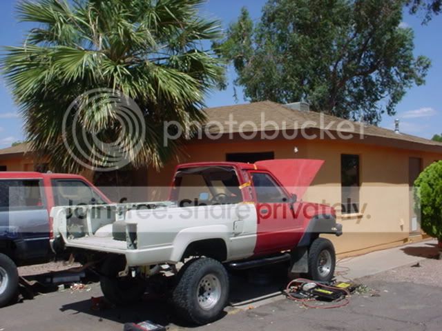

Back to my runner...I put my topper on to help with the alignment. I think I'll trim and weld Monday morning. Here's a pic with the 84 truck parked elsewhere so I could get a good shot of my runner.

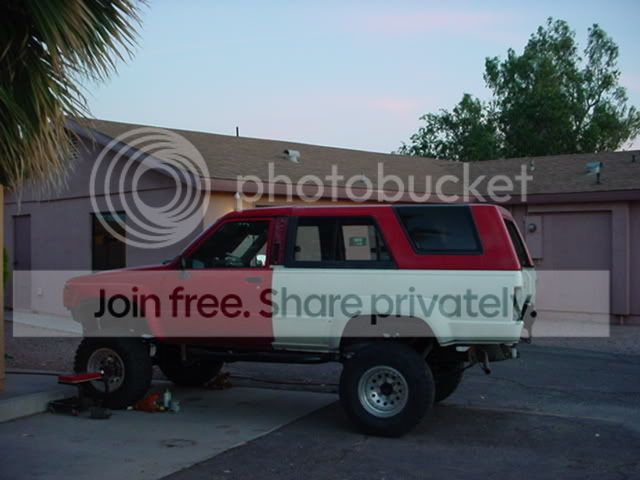

This pic is disappointing. It was getting too dark for a good shot, so I'll need to re-take this exposure tomorrow when the sun is behind me. Here's the crummy one for now...
