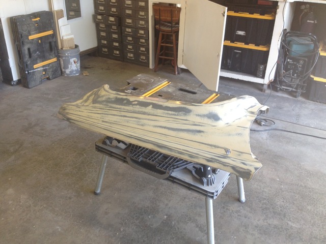

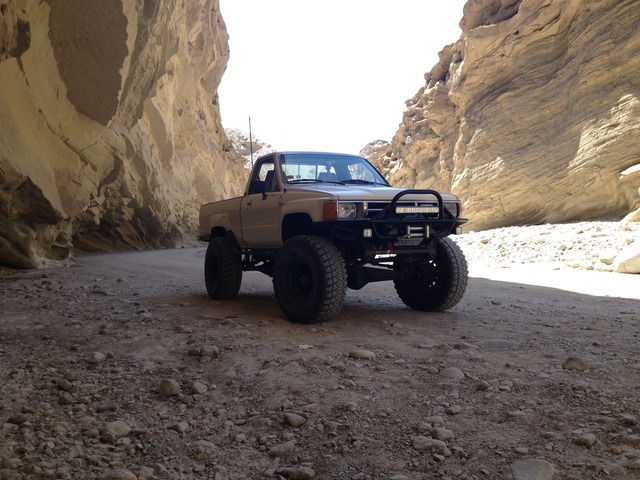

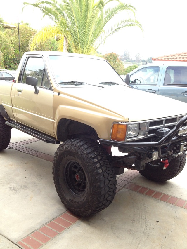

made quick work of the front fender. liking the new color more and more.
Really liking the color! Are you spraying this with an hvlp gun? Looks great!
yes, an HVLP, just general one. i'm still trying to figure out the right amount to thin the paint. i'm getting better but there is some "orange peel" going on. I don't really care to much, I'm mostly doing this to get rid of rust spots. the truck is still for hitting the trail.
