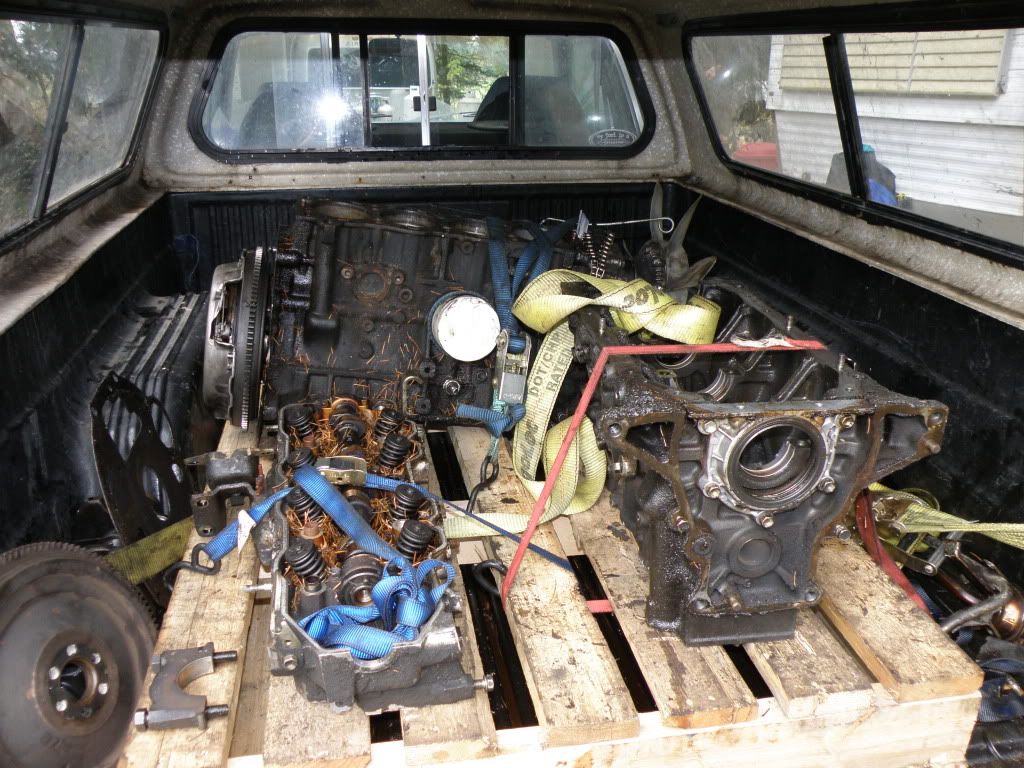

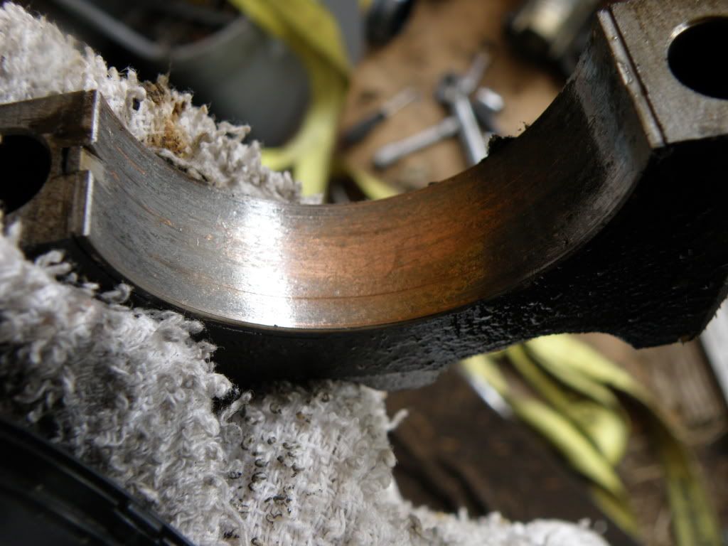

Heres how ya make a redneck cherry picker using:
an old fence
an extra truck
some ratchet straps (industrial grade)
1-throw the fence/gate on the trucks
2- attach some ratchet straps and hoist the engine
3- you will want to add some 2x4s so you can reload the reach on the straps
4-hoist the engine jus high enough to get in the truck and drop it on in there.. be sure to get it down nice and secure before transportation
anyways enough of that heres the update on the truck

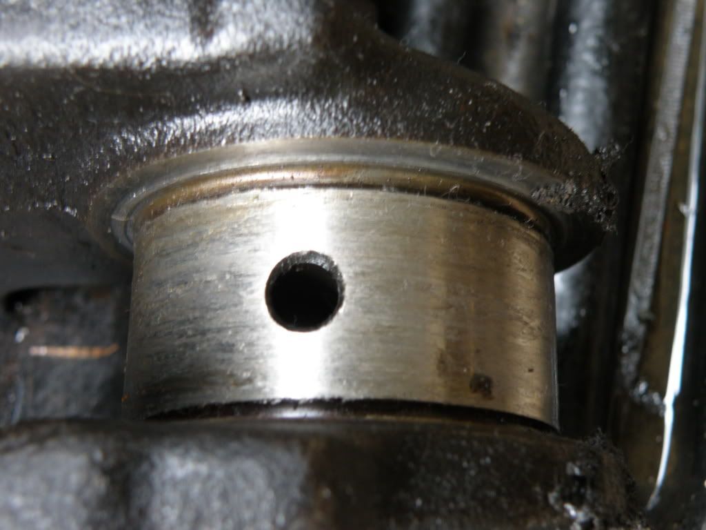

got the motor out here is a main crank bearing worn down to copper
the crank.. definitely needs replacing its scratched all to hell (for those of you that dont know, it should be a polished mirror finish)
got the motors all disassembled and reaady to go to the machine shop
once the motor is back and in i will start moddin it up soon to come is a lift and lockers

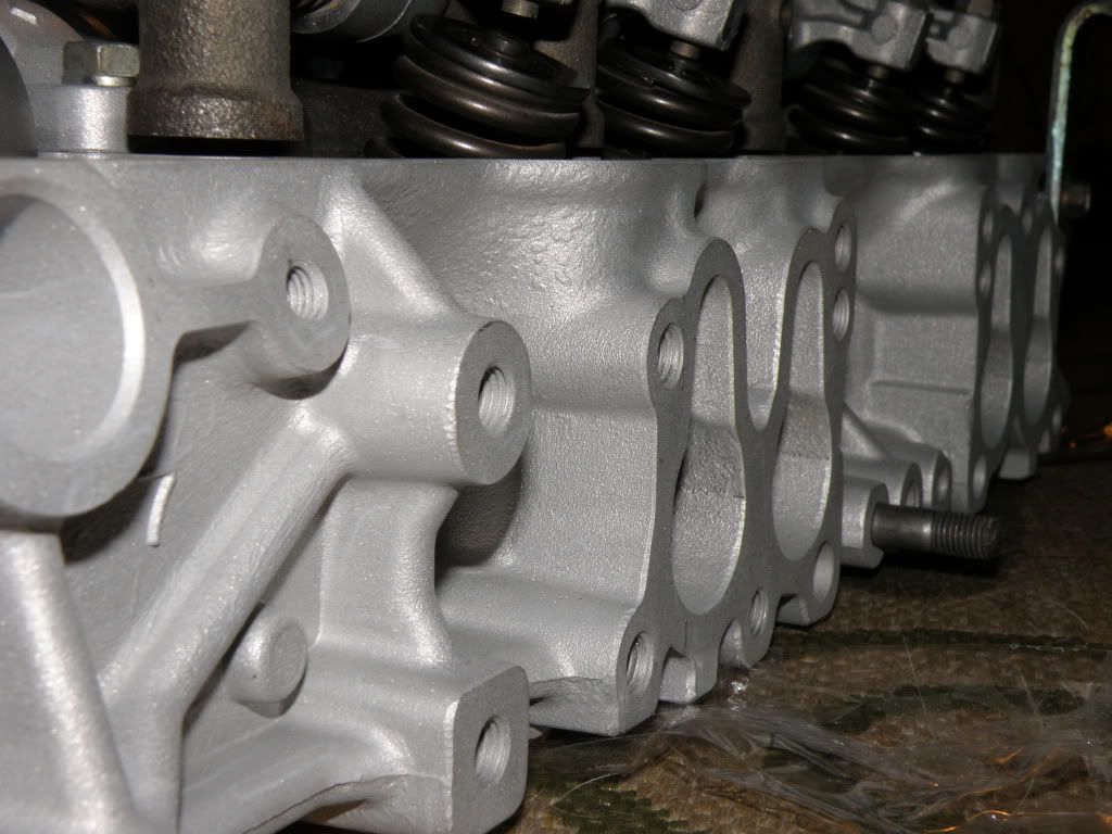

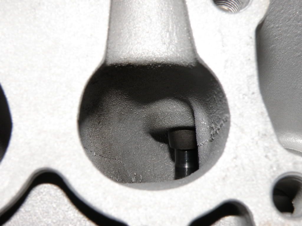

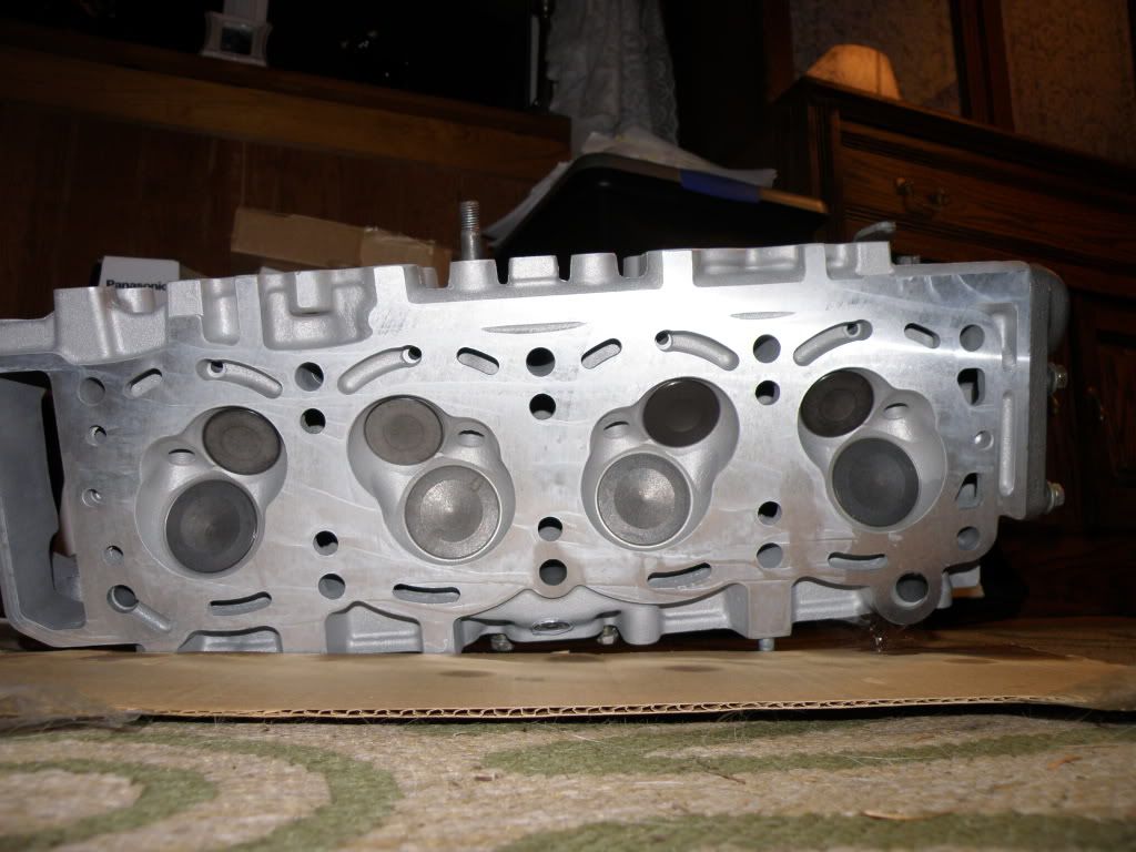

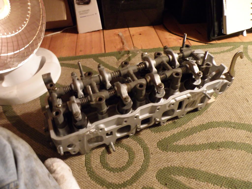

alright ive been doin a little work its almost ready to drive, i had a little setback tonight dropped the timing chain in the lower end while i was installing the head then tore the brand new gaskets pulling the timing cover back off
anyways heres the head before and after
the head on the way to the shop
tonight when i brought it back
all new valves
nice and clean
got the bottom end in
welded the diff
i also scored on a set of chev. rear leafs for $40 so the lift will be on soon updates whenever...
