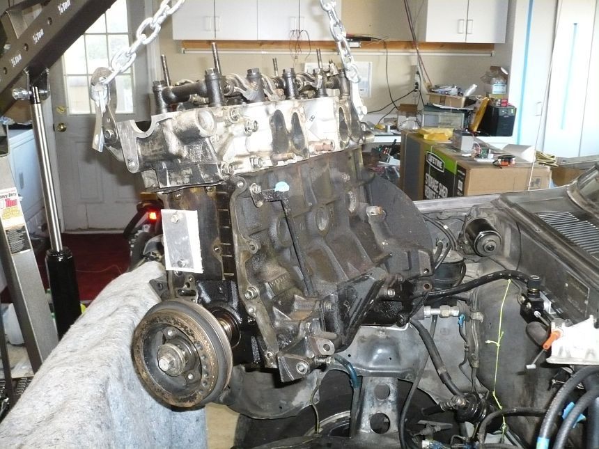

Thanks bruner, I have kind of been lagging on the motor rebuild as I had a friend who was bidding on a 94 single cab, 22re, 5speed, 4x4 pickup that he was going to do an V8 LS swap on and he was offering me the entire drivetrain for dirt cheap. The motor had just been rebuilt by Toyota with paperwork and only had 25,000 miles on the rebuild. This would have been the perfect drivetrain swap for my runner. Well, needless to say my buddy wasn’t able to get that truck so now I’m back to my plan of rebuilding the original motor. As far as the build goes I finally managed to clean the upper intake plenum. Damn, that was a heck of a time consuming process! I ended up using kerosene and carb/choke cleaner and a lot of elbow grease. I am reasonably happy with how it turned out.

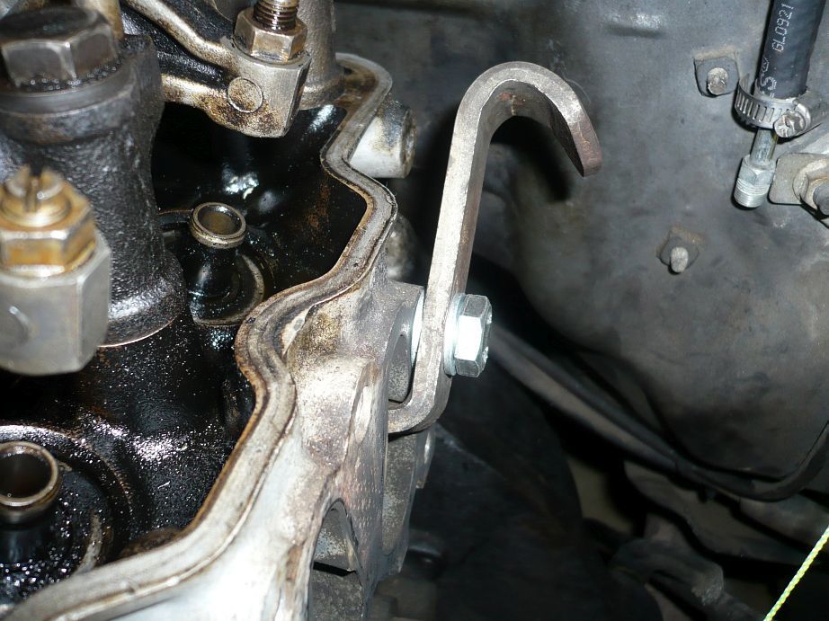

I also was thinking more about my plan to make lift points for the block because the rear lift point on the cylinder head sheared off and have since reconsidered my strategy. I would end up having to purchase a bunch of grade 8 bolts and some plate steel. After seeing the price of steel and grade eight hardware at the local stores I quickly realized that this wouldn’t be cost effective. So instead I went back to brainstorming and came up with a different idea. I decided to just buy one grade eight bolt to attach my lift point to the exhaust port of the cylinder head. Now all I had to do was slap my old gasket back on the block, drop the cylinder head back on, bolt it down and BAM, my motor is ready to be pulled, all for a grand total of $3.50.

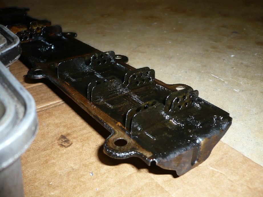

I also decided to remove the oil baffle from inside the valve cover to thoroughly clean out all the gunk that has collected there over the years. This required drilling the heads off the pressed in pins, removing the baffle, and then drilling out the remaining part of the pins. I am currently in the process of trying to tap the holes for bolts to remount the baffle with new gasket to the valve cover.
I am hoping to get the motor pulled out by this weekend, assuming everything goes according to plan.

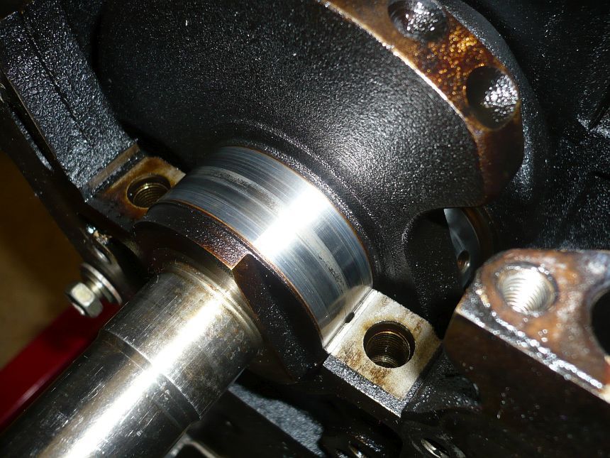

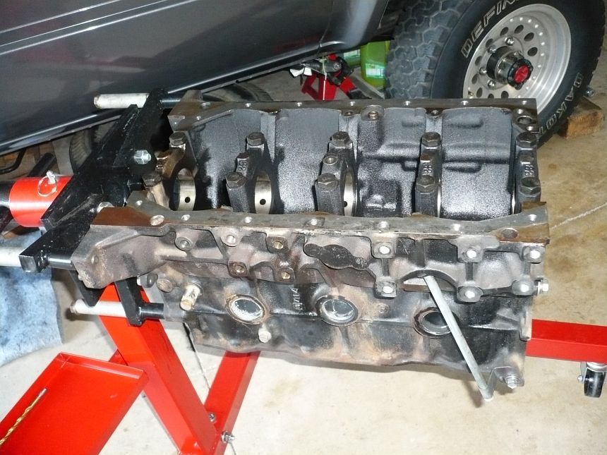

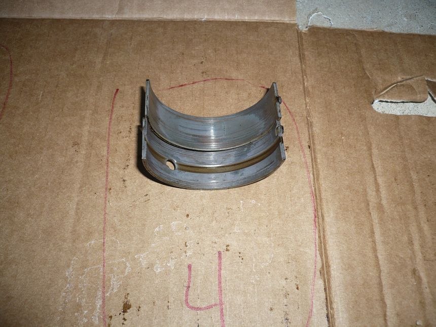

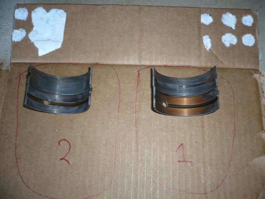

Well, I was finally able to get a hold of an engine crane and pulled my motor about a week ago. I’ve started the process of stripping it down to the bare block and cleaning it up to get it ready for the machine shop. I quickly found out that the main bearings were just as bad as the rod bearings. Each bearing had deep grooves worn into them and most of the bearing surface was worn away down to the copper backing. Serious neglect and dirty oil killed this motor. I also think I figured out where my large oil leak was coming from; A combination of a failing rear main seal and the rear plug on the valve cover.So now the hunt for reputable machine shops in my area has begun! I’m trying to research shops that have experience rebuilding imports and preferably, Toyota's. If anybody has a shop that they’ve had decent work done at in the Southern California area, I would like to hear your suggestions.
