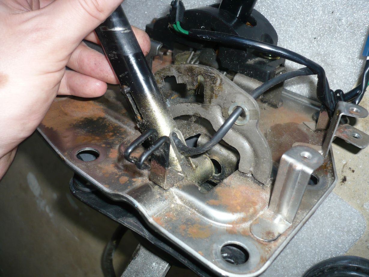

I also took this opportunity to fix my shifter for the automatic transmission as it was REALLY loose and left like it was going to change gear on me if I hit a speed bump too fast. The rubber bushings were completely destroyed and the only evidence that they were ever there was this yellow powder that coated the bottom of the shifter. I bought some new bushings from Toyota for a small fortune and had my shifter fixed that afternoon

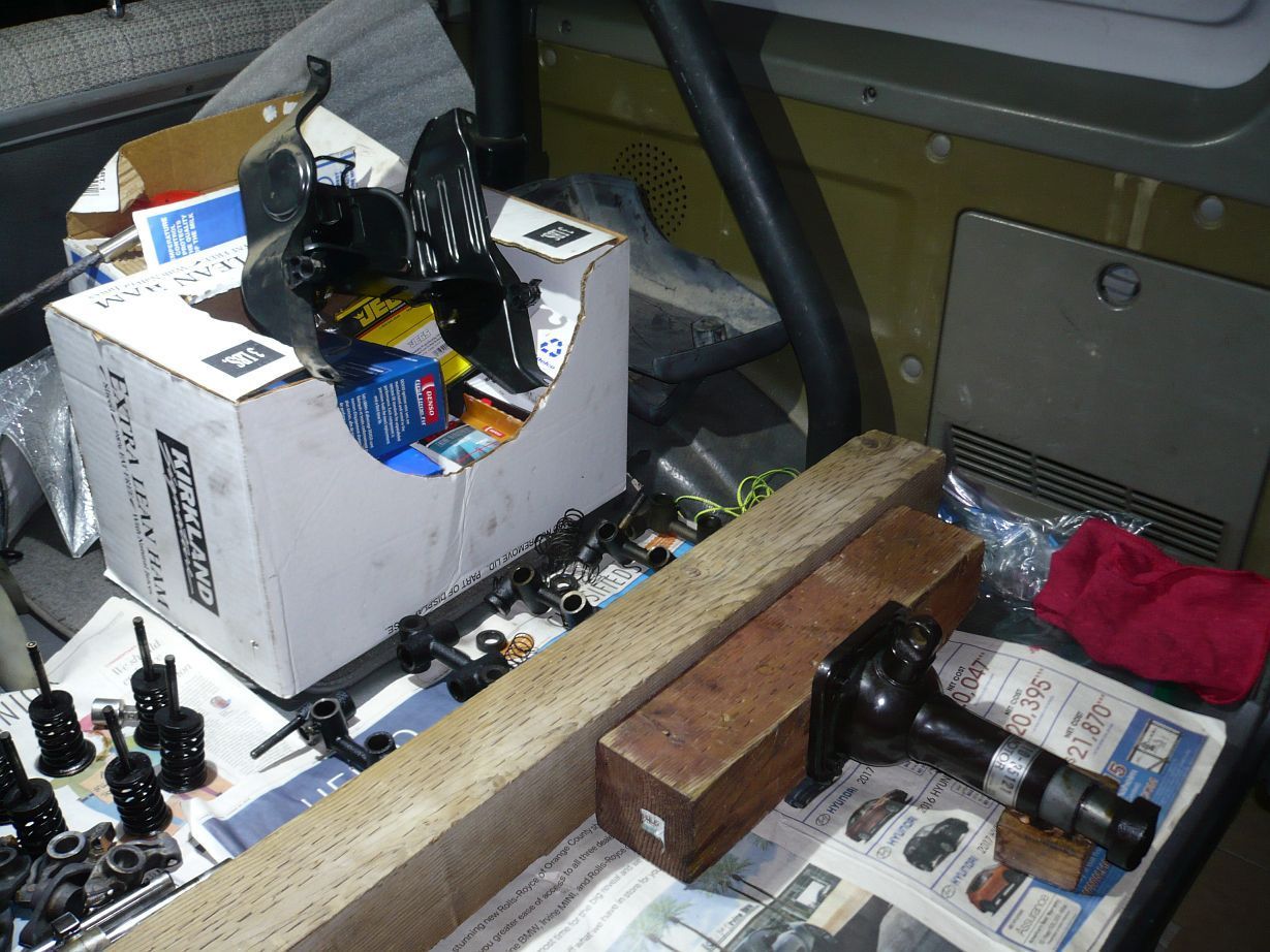

Well, I pulled the cylinder head to see how bad the internals looked and to figure out the source of the knocking noise which was getting louder and louder each time I ran the engine. Disassembly went smoothly as I was lucky and didn’t snap the head bolts when I was removing them. I was kind of shocked at how much oil the motor was burning judging off the combustion chambers, pistons, and the lower intake runners. When I was doing all the prep work to pull the head I discovered that all four of my intake runners had large pools of oil in them. I first though this might be bad valve stem seals, but am now thinking that It was caused by a bad PCV valve. Once I had the head off it became quite clear where the knocking was coming from. When I pulled the head off I tipped it on its side so the oil could drain out and one of the bolts holding the bearing cap on my camshaft FELL OUT. The bolt had completely stripped the threads out of the cylinder head and was just rattling around in the bore. I unbolted the other 2 bearing caps so I could pull the cam and see how badly worn the bearing surfaces were. They were pretty badly scored and kind of burnt looking. It was at this point that I knew I needed a whole new cylinder head because Toyota didn’t design the cam bearings to be replaceable.
As of now I'm keeping a close eye on the inventory of the local scrap yard, waiting for them to get a Pickup or 4runner with the 22re that I could take the head off of.

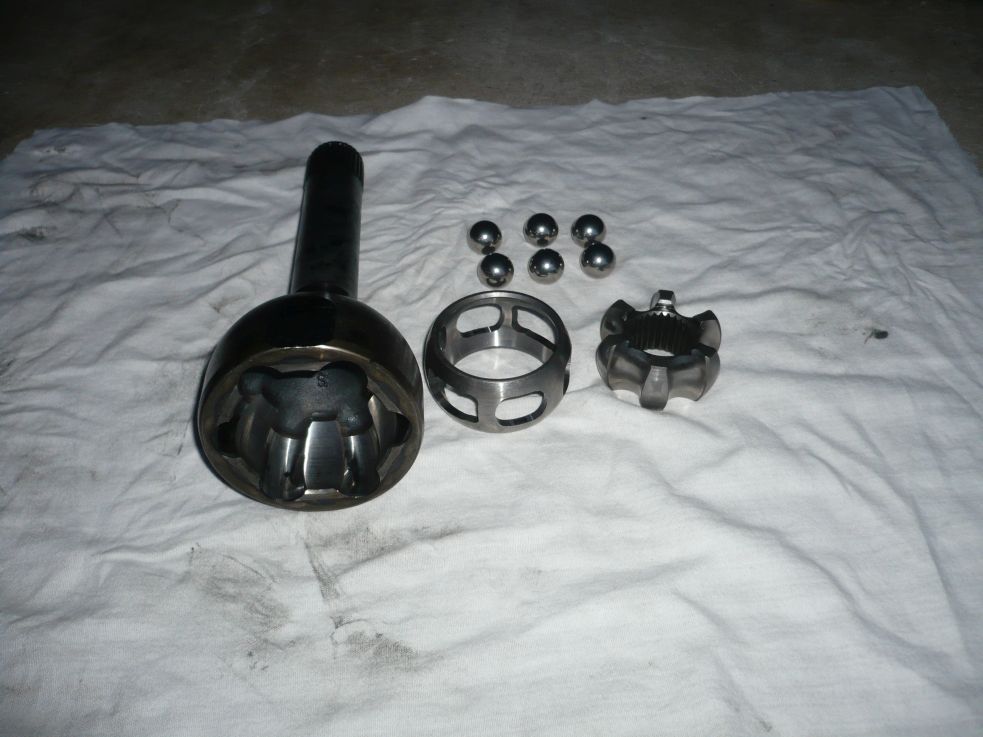

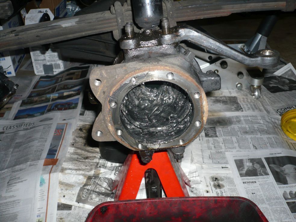

The inner axle seals had given up their useful life a long time ago, and were allowing the diff oil to mix with the axle grease and run all down the inside of the tire. I started by trying to scrape the worst of the dirt and grime off the knuckle studs and hit them with some PB Blaster. After I let the studs soak for a full 24 hours, I rolled the air compressor over and hit them with an impact. I was relieved when all the nuts came off without sticking and backing the whole stud out of the knuckle.
One of the more annoying issues I had to deal with consisted of trying to remove the old brass spindle bushings. I was able to get one side out by bending the lip up and twisting it slowly back and forth, however the other side refused to budge and I ended up having to make a relief cut and then crush the bushing to get it out. The old knuckle bearing races were a little stubborn but eventually came out with the persuasion of a large hammer and some PB Blaster. Once I had all the old bearings and seals removed, it was time to hammer in all the new seals and bearing races. I ordered up a knuckle rebuild kit from Marlin Crawler and a knuckle stud kit, a knuckle pre-load scale and the spindle bushings from lowrangeoffroad.
While I had the axle this far apart I decided to pull the axle shafts and 3rd member to see how they looked. The gears still looked close to brand new with hardly any wear, making me think the previous owner probably never used the 4WD. Good news for me, as I was half expecting that I was going to need a new gear set. I also separated the birfields from the inner axles to properly clean them.

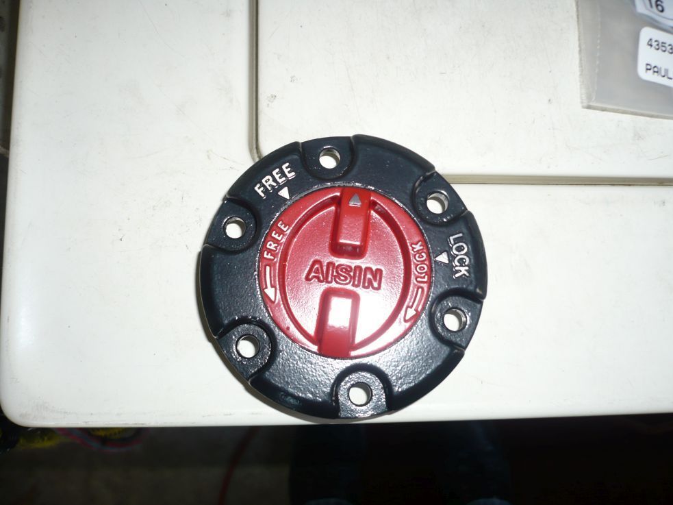

After everything was cleaned up and I got my hubs back from the machine shop with brand new rotors pressed on, it was time for re-assembly.
All that was left to do was refurbish the brake calipers and system, but I'll get to that in the next post.

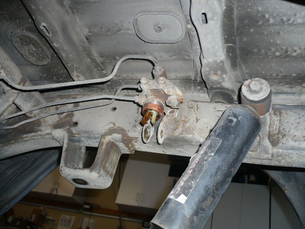

I bolted the calipers back on, hooked the lines up and proceeded to bleed the system. This is where I ran into a bunch of issues that ended up taking me almost 2 weeks trying to solve them. I could not bleed the brake system. No matter how many times I tried, my pedal still felt like a sponge and couldn’t even develop enough pressure to take up the slack in the rear drum springs. After some research I figured it was the load sensing brake proportioning valve that was giving me issues. I was pretty sure the valve was sticking and I had air trapped in the 3rd brake line coming off the valve back to the front of the truck. I crawled under to take a look and discovered that when the truck was rear ended in its past life the impact damaged the valve. The spare tire punched a “U”shape into the rod that connects the valve to the axle and broke the plastic tab coming out of the valve itself.
I decided to delete the LSPV and just install a manual adjustable proportioning Valve. I ordered a valve from amazon and went to the local scrap yard to source some brake fittings. After I plumbed everything in I went to bleed the brakes and now I was getting pressure to the front brakes but no pressure to the rear brakes. I was so confused as to what was going on with the system as I knew the master cylinder was good, the wheel cylinders were good, and the proportioning valve was open all the way. After several days of trying to troubleshoot the issue, I decided to buy another proportioning valve from a well know company to see if maybe I just got some crappy Chinese made part. Success! It was a bad valve after all. With the new valve installed I finally was able to get the rear brakes to work and restore brake pedal feel to the truck.

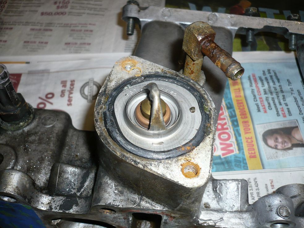

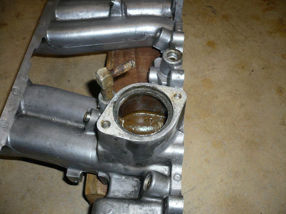

As far as the build goes I’ve started the process of cleaning out the intake manifold of 240,000+ miles of oil and carbon buildup (joy!). It took me several days of scrubbing the runners with a brass brush and 3 cans of aerosol carb cleaner to get the lower intake halfway clean. I really wish I had a parts washer right about now. I also went and tested all the electrical sensors as I removed them from the intake to verify they all still worked properly. I almost snapped the 2 bolts holding the thermostat housing on trying to remove them as they had rusted into place. Thankfully I was able to get the bolts out with the help of a 2 foot breaker bar. I decided that I am going to have to use a different approach to clean the upper intake plenum due to its shape and limited access. I think I’m going to try letting it soak in some foaming oven cleaner and then pressure wash it out. I have seen people use this method and it seems to work reasonably well.

Be careful using the foaming oven cleaner- many of them are not safe to use on aluminum!
I had luck using foaming degreaser, carb & choke cleaner and a power washer down at the car wash. Brake cleaner worked well, too. And lots of elbow grease, of course.

Thank you for the warning about the oven cleaner, I did a little more research on it and found that almost all oven cleaners have one chemical or another that eats aluminum. Its kinda of a pain to find a good cleaner that will dissolve carbon deposits and old oil, but won't destroy aluminum. I'm thinking about letting the upper intake soak in mineral spirits or kerosene, then scrub the heck out of it. Once the heavy deposits are gone I'll probably use some carb clean and a pressure washer to get the rest of the goo out.

A mechanic buddy of mine gave me a can of stuff called Mighty VS7 engine degreaser. It's a foaming engine cleaner/degreaser and it worked really well. Not sure that you can get it at the retail shops, but check it out here: https://www.mightyautoparts.com/web/...system-cleaner
