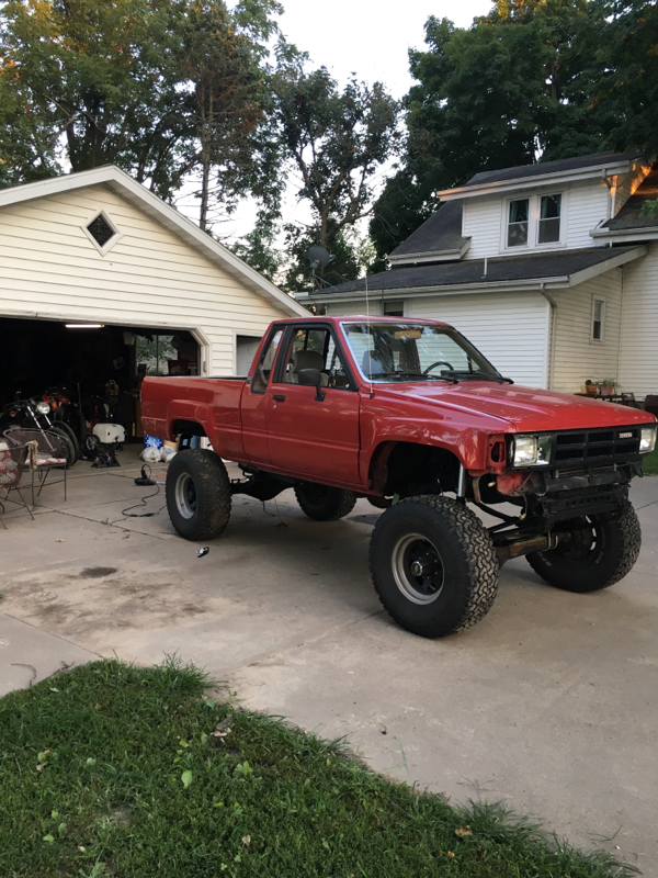

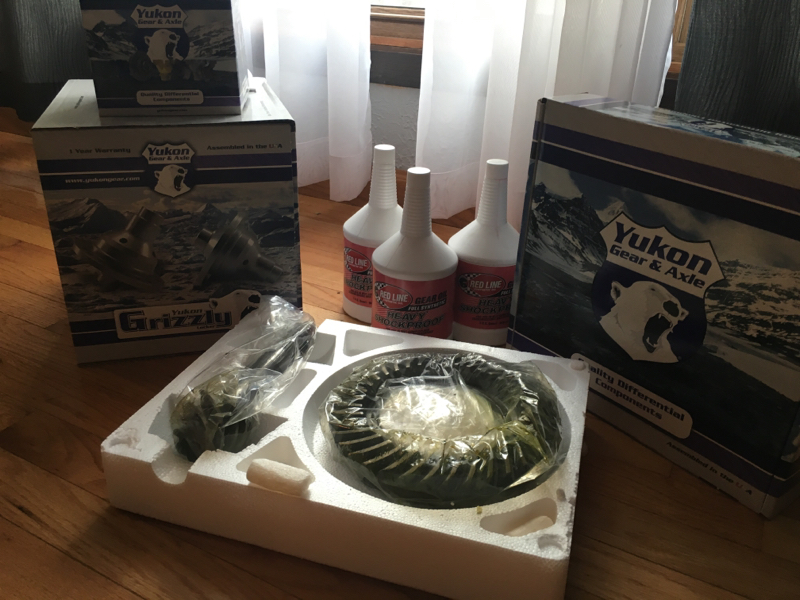

It's been a while since my last post. But I have been knocking it out one day at a time Finally it's streetable again. I was worried about the rear shackle angle before I put the bed on. But once it went on and I was able to drive it around the street. It settled nicely. I expect a LITTLE more sag once I start flexing them. But I'm happy with how it sits. Those 33"s look tiny under there. The next phase comes soon. Parts are already stacking up at the house.
For gears I went with a Yukon 5.29
For lockers. I went with the Yukon grizzly in front and rear. And I went with a Yukon rebuild kit from Marlin crawler
