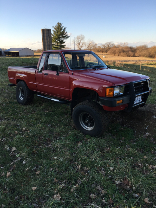

Found this truck sitting at a small local dealership and had to stop... 1985 pickup.. EFI... and straight axle. Seems like a good base for a new build.
5 speed
129K miles.
good frame.
SMALL body rust on driverside rocker.
got it for right at $2500

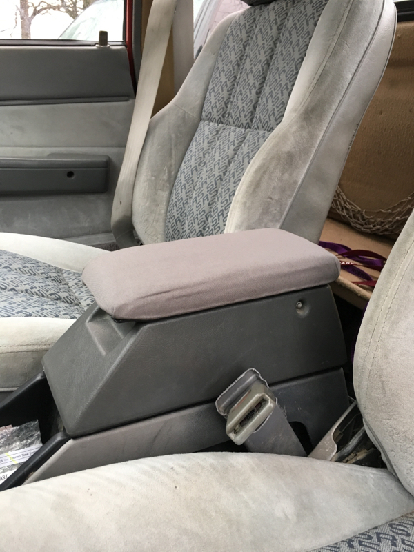

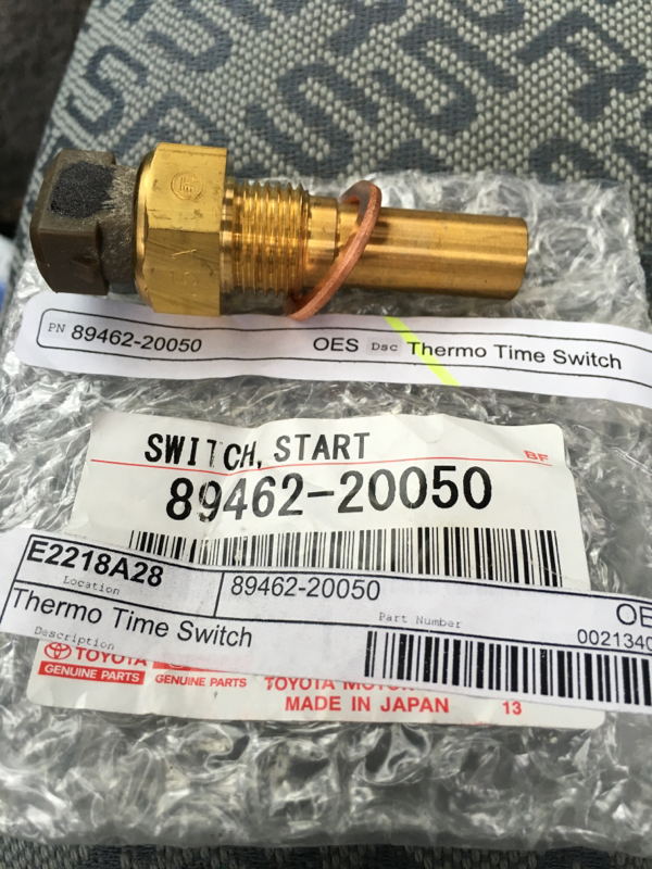

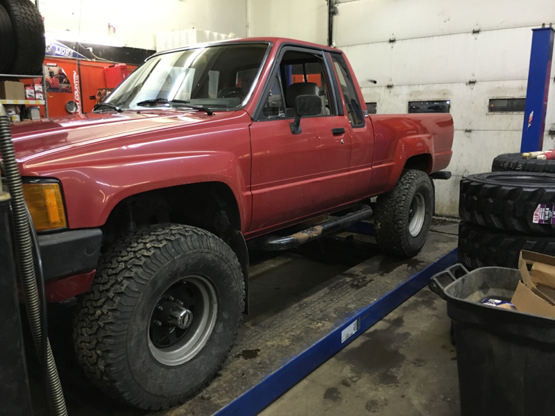

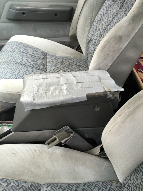

Well unfortunately I was laid off from my job because the mining industry sucks. So most of my time has been spent looking for new jobs. I'm a recent college grad with the engineering degree so hopefully something comes along soon. As for the pick up, due to my situation , I have only done a few minor things to fix/diagnose the truck. The center consul that's a nice classy duct tape on it so I managed to save the stock foam and cover it with some new fabric. 85 xtra cab Pickup-image-938065324.jpg 85 xtra cab Pickup-image-605729204.jpg The truck is also picky when it is cold , sometimes it does not want to start until it warms up slightly, so I picked up a new thermal time switch to hopefully fix my issue. 85 xtra cab Pickup-image-908875077.jpg I also have a pair of 33/12.5/15 BFGoodrich all-terrain tires to put on the pick up, they came off of my previous daily driver and are basically brand-new. I will post pics of them on the truck when I get them on 85 xtra cab Pickup-image-3373844946.jpg

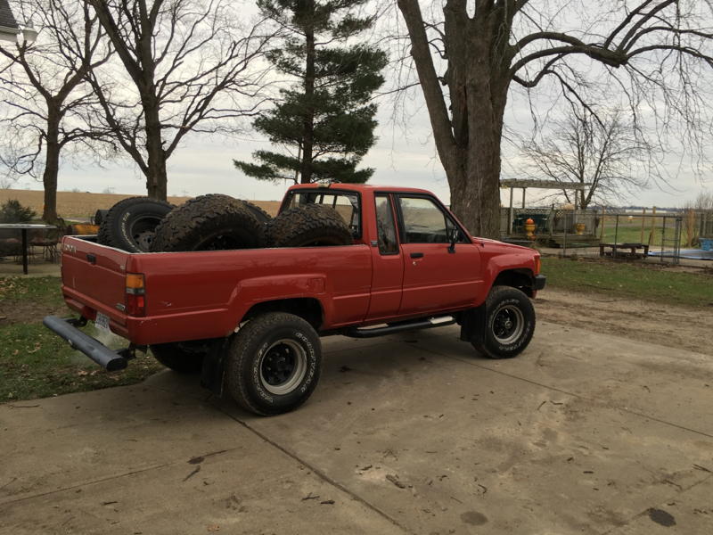

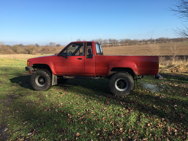

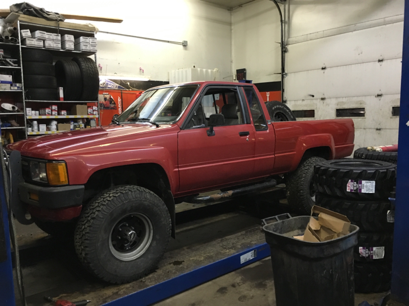

Got the 33"s on. Zero rubbing on the fenders. The mud flaps catch a little when I turn right. But they are going to be removed soon.

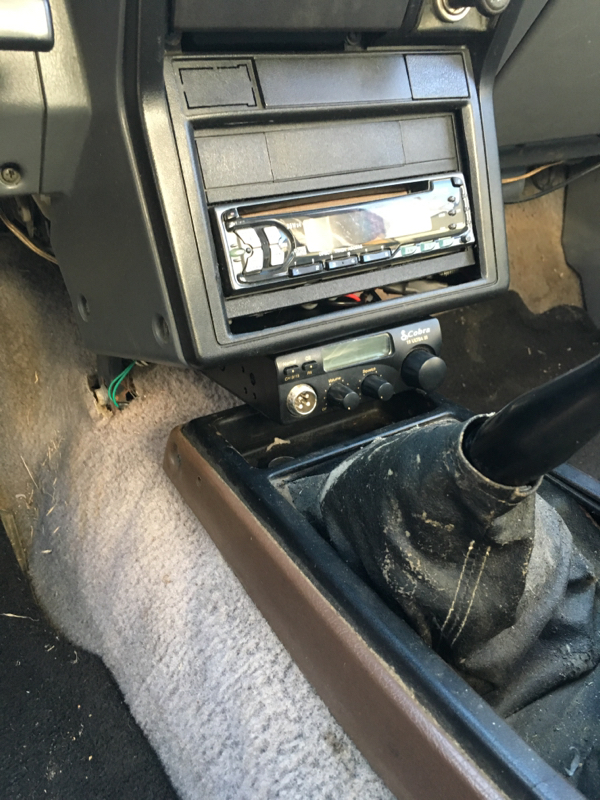

I also got my CB radio wired up.

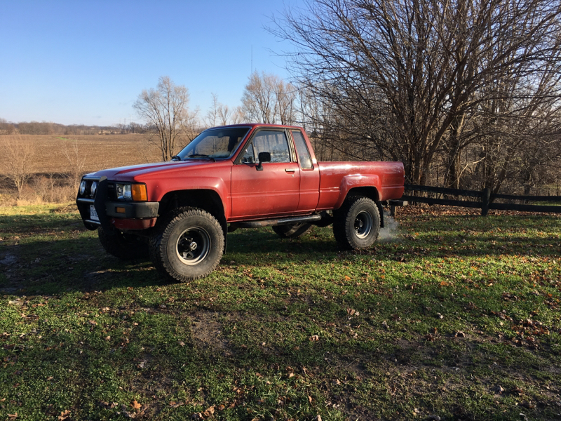

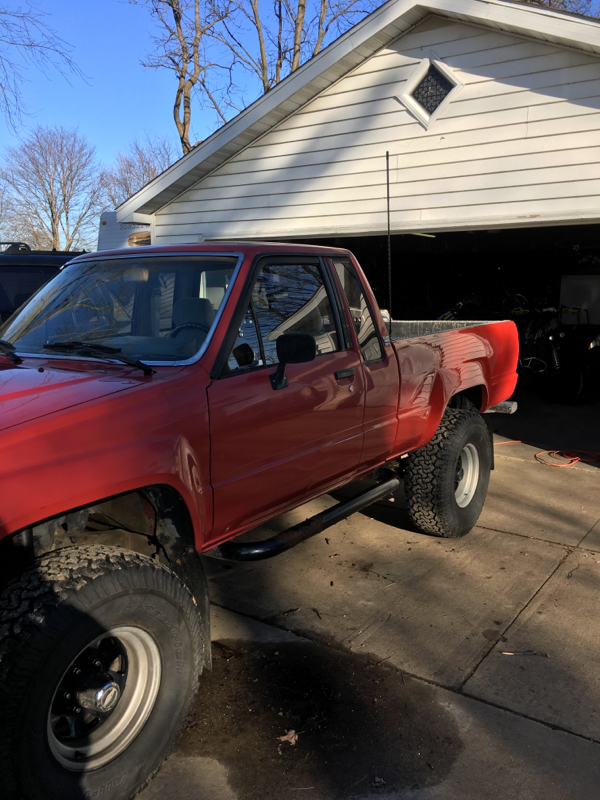

Here is a few more pics with the new tires
I had to take it in the backyard for a stock flex shot

I had purchased the thermal time switch which was around $150 after taxes but have yet to install it.
I went out yesterday morning to start it. Knowing that it probably wouldn't since it was below 30 degrees.
Like I expected. It did not start. So I got to thinking and opened the hood. And switched the wires on the thermal time switch. And it fired right up.....
My thought is the old man that had the truck prior to me. Or the shop that did this before. May have plugged them in wrong.
I went out this morning and it fired up first try in similar temps .
I'm going to keep the sensor I bought until it proves to be fixed.
I want my $150 bucks back haha

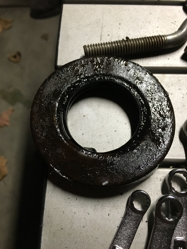

Since I got the truck it had a slight leak in the rear end from the pinion seal. So I replaced that tonight. Pretty simple. Take out old and put in new!
Here is the oldie!!

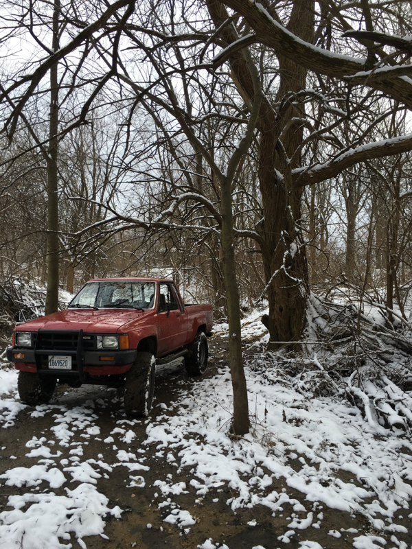

We had a little bit of snow so I decided to take advantage of it and do a little adventuring.
