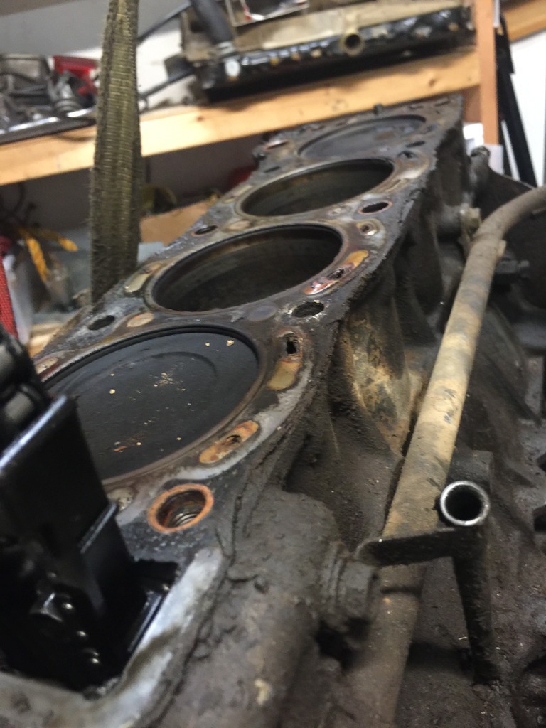

Old Aug 15, 2016 | 07:06 PM
jlcullum's Avatar
Joined: Jul 2016
Posts: 9
From: Wadshington
http://<a href="http://s1295.photobu...1;/ATTACH]</a>pulled the head an the block looks pretty ugly,
anybody want to share some insight for me?

Old Aug 15, 2016 | 07:13 PM
millball's Avatar
Joined: Aug 2013
Posts: 4,262
Likes: 683
From: Southern Arizona
The block deck with old gasket stuck to it looks pretty normal to me.
Gotta be made tweekishly clean before reassembly.
Old Aug 16, 2016 | 04:44 AM
gsp4life's Avatar
Joined: Feb 2015
Posts: 858
Likes: 13
From: Mogadore, Ohio
Mine looked about as bad only one of my pistons was destroyed and there were fresh puddles of coolant everywhere. How were the head bolt holes? Any filled with oil or coolant? Scrape the head surface down really carefully, clean it with a little solvent on a scotchbrite then you'll see what you're dealing with.
