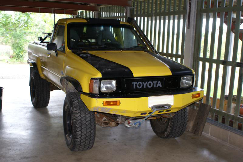

OK so heres my build, been going on for a while and not at a great a speed.
So 4 years in a nut shell....

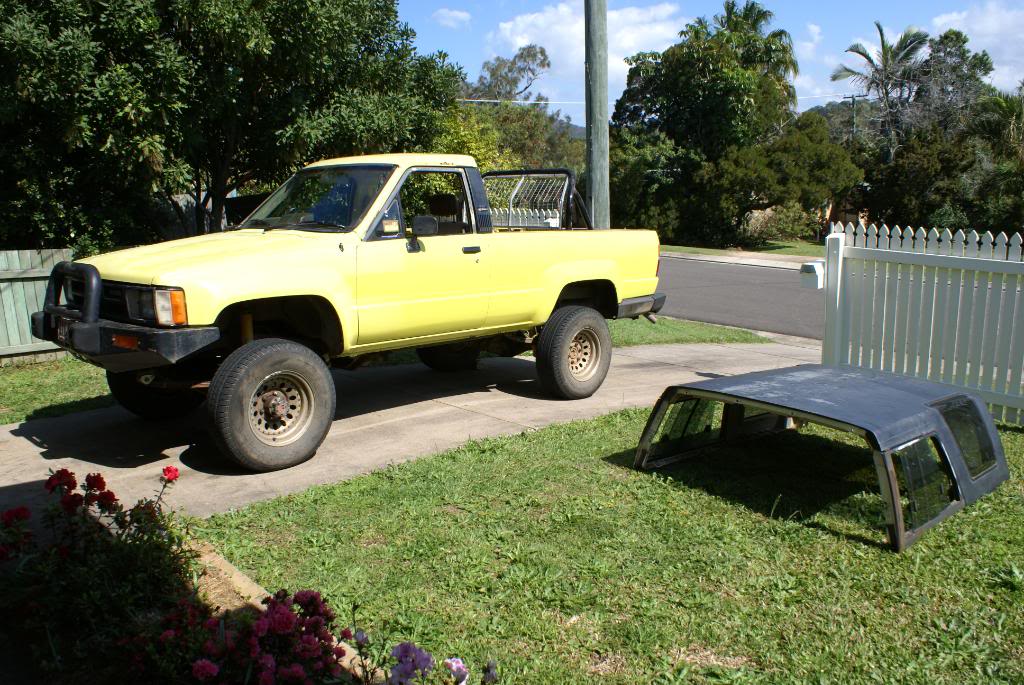

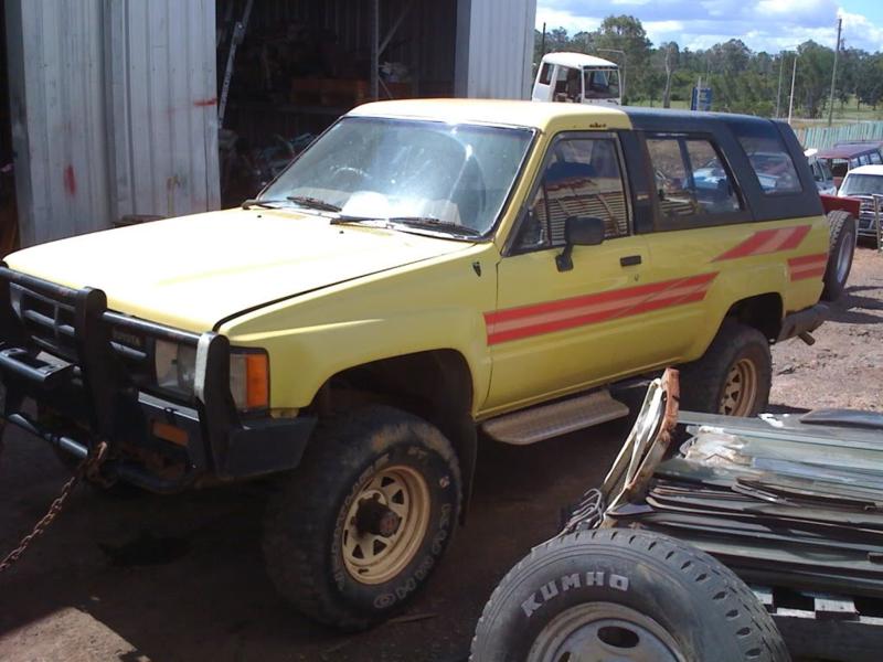

Bought in 2010 when we were in Uk about to move to Aus, and Bro in law sent pic..did we want it?
Yeah we did...

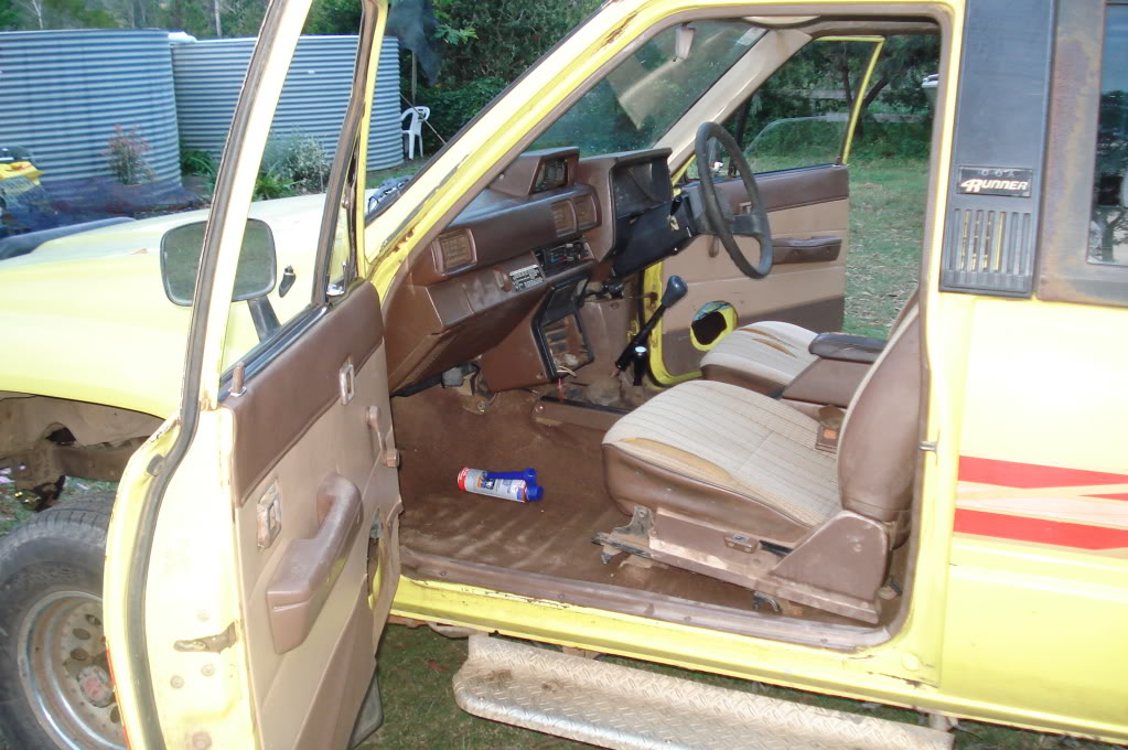

Pretty rotten inside as had been a farm truck for years so need to be stripped

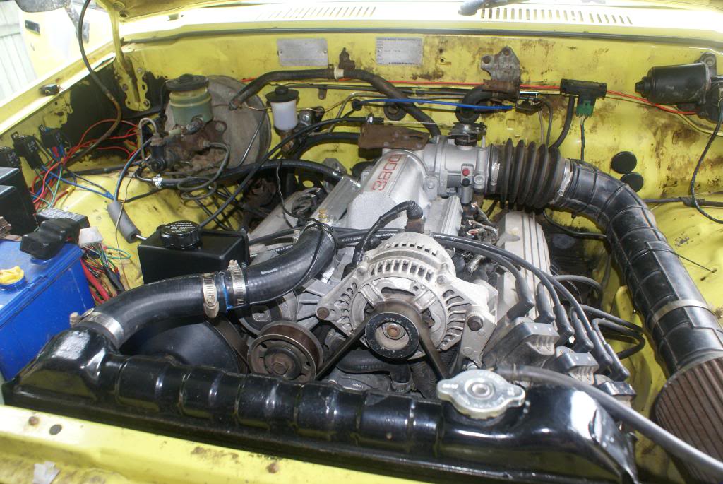

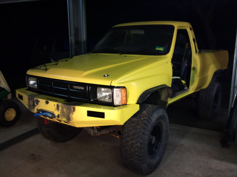

Dropped in a V6 380 (Think they are US Buick's)

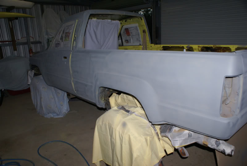

re paint..

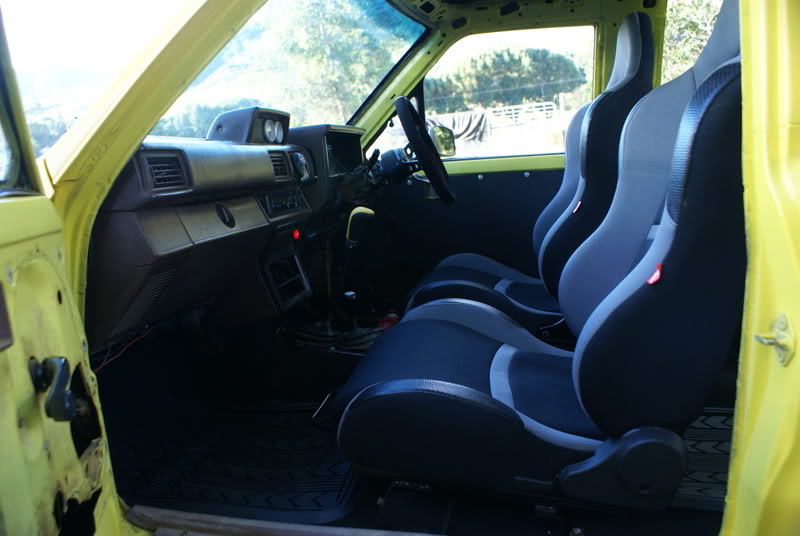

New seats

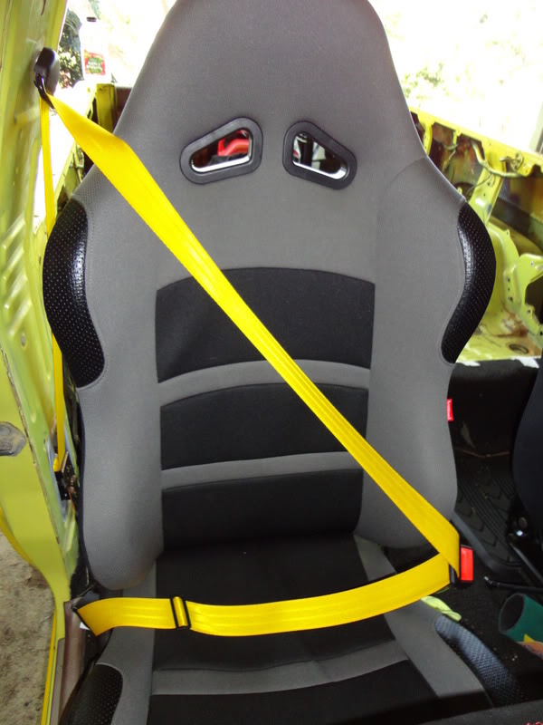

Seat belts...Yellow of course!

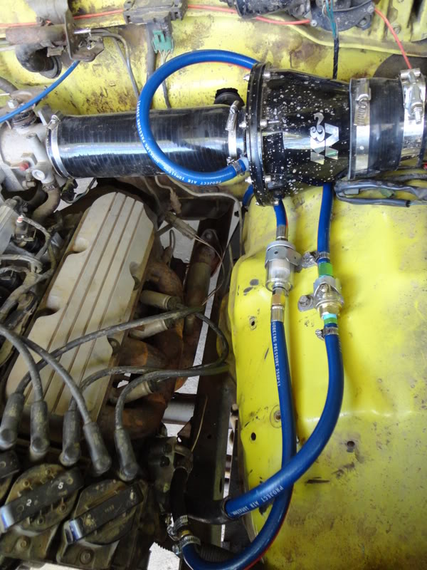

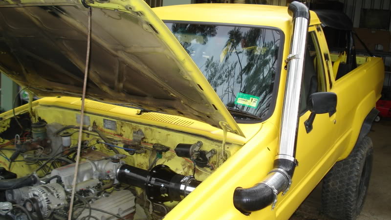

Snorkle to K&N

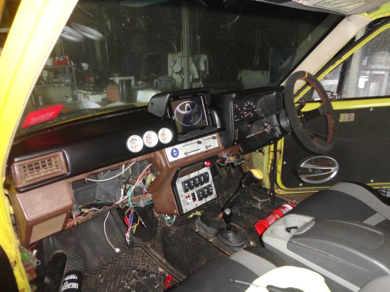

Sort out dash with gauges etc V1

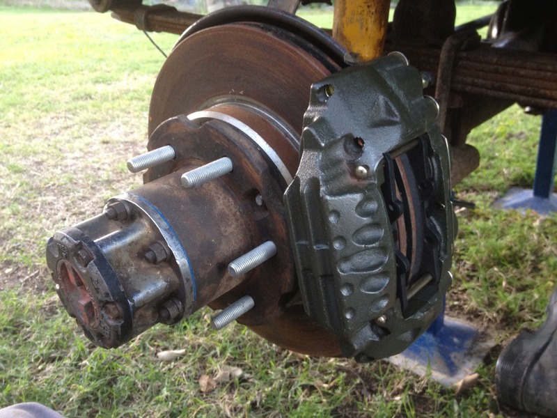

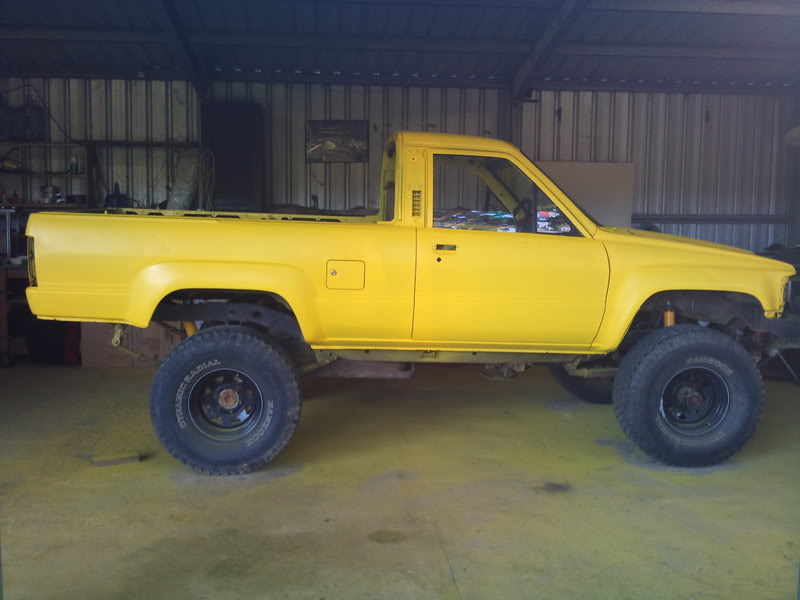

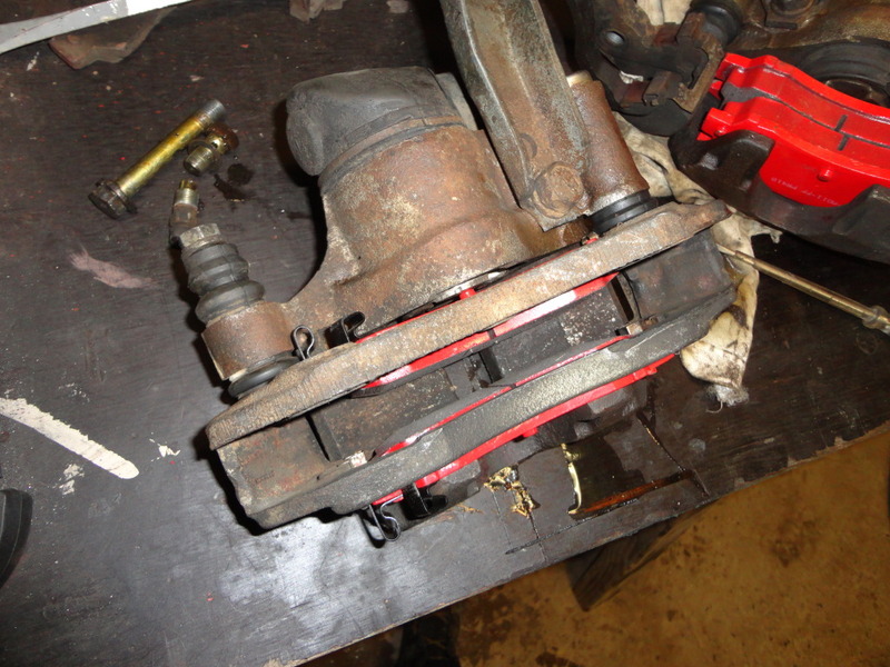

Uprate fronts...

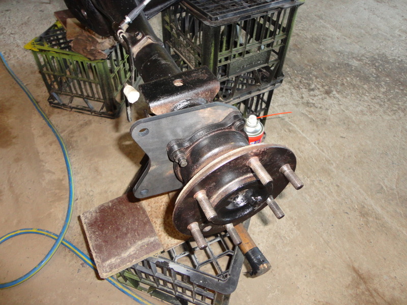

Subaru disk Rears with hand brake...

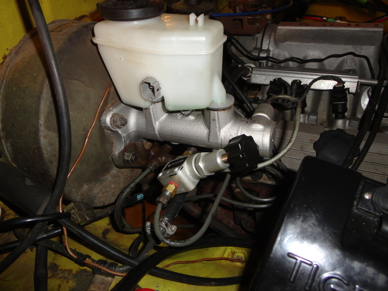

Brake valve for rears

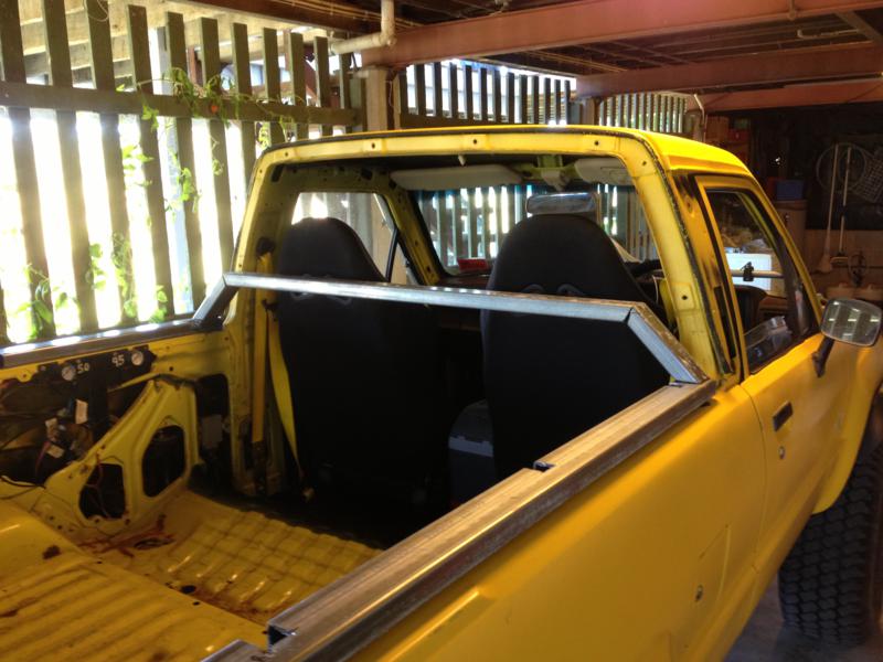

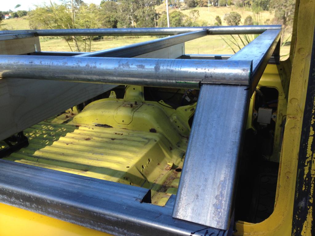

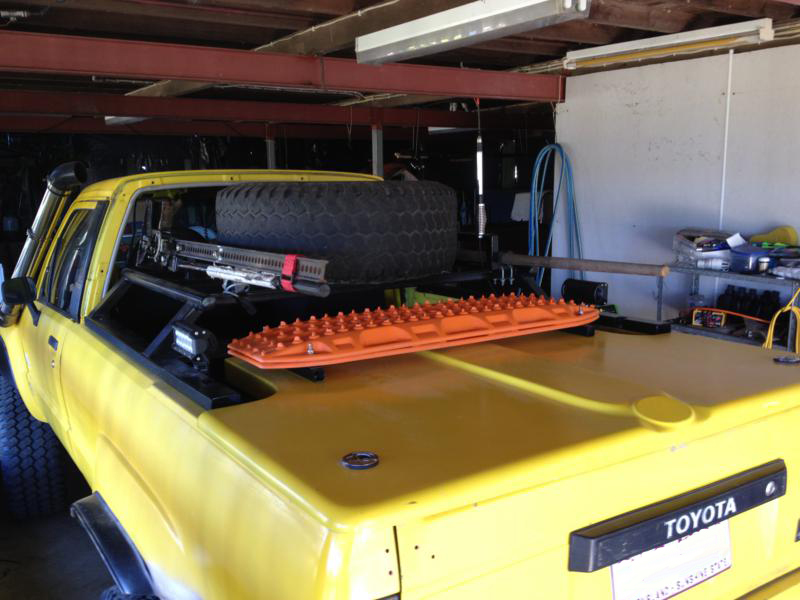

Built up rear rack

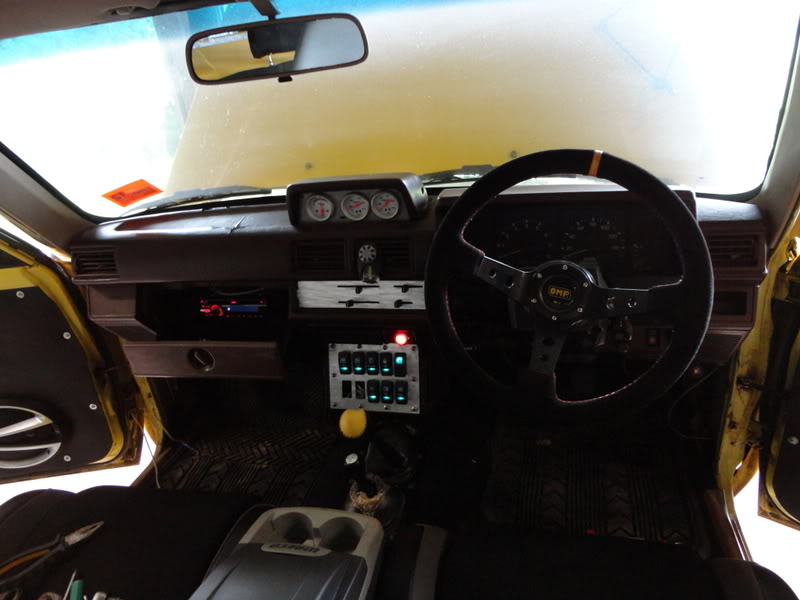

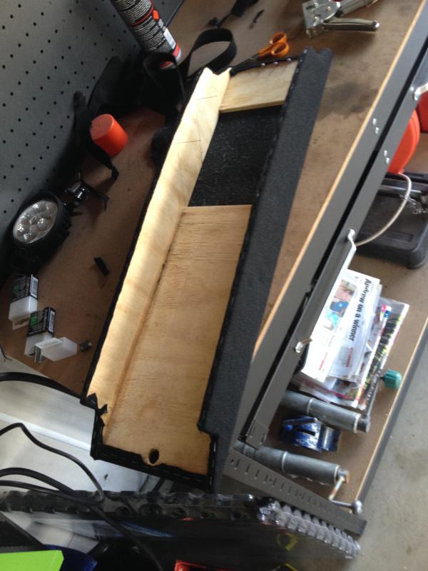

Built centre console

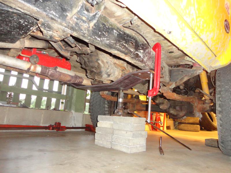

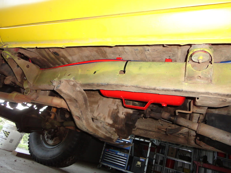

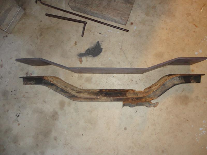

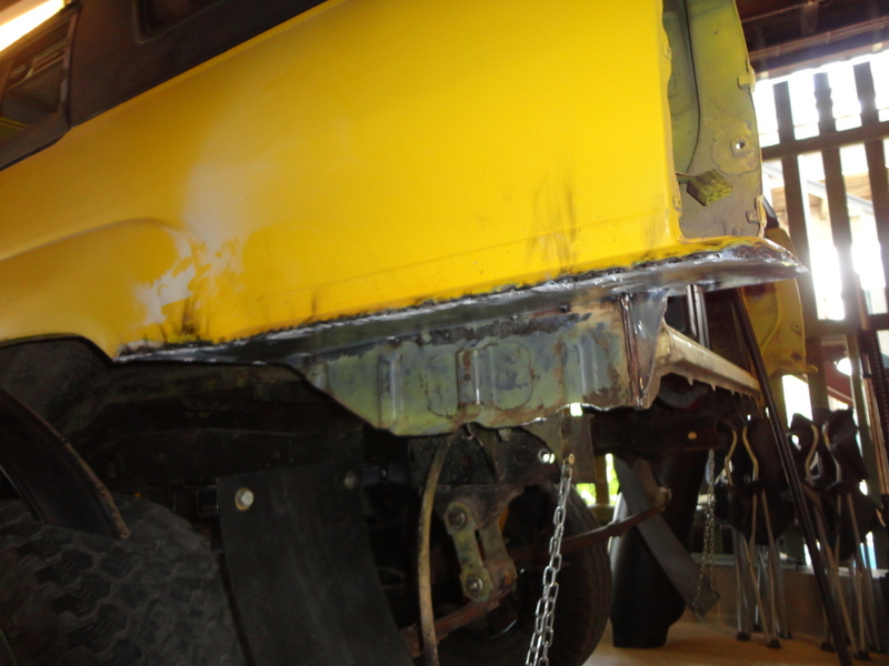

Bent up cross member

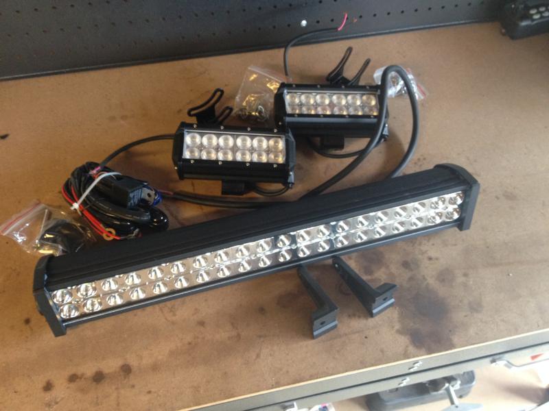

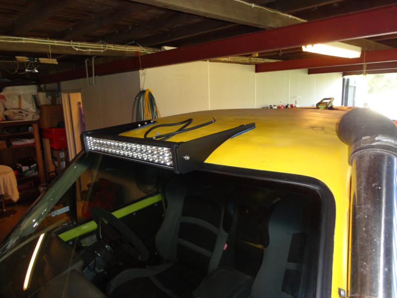

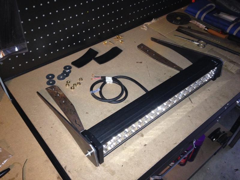

Lights...

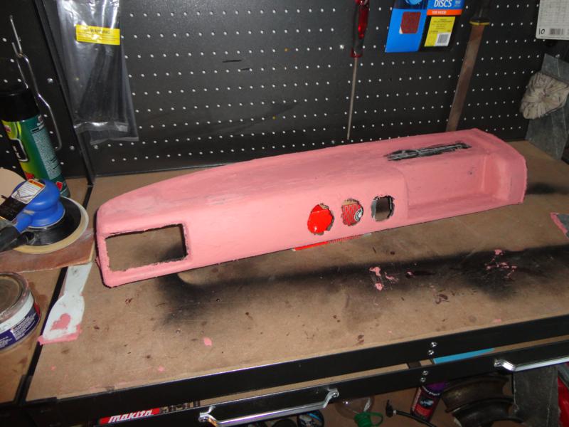

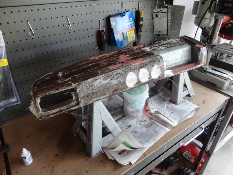

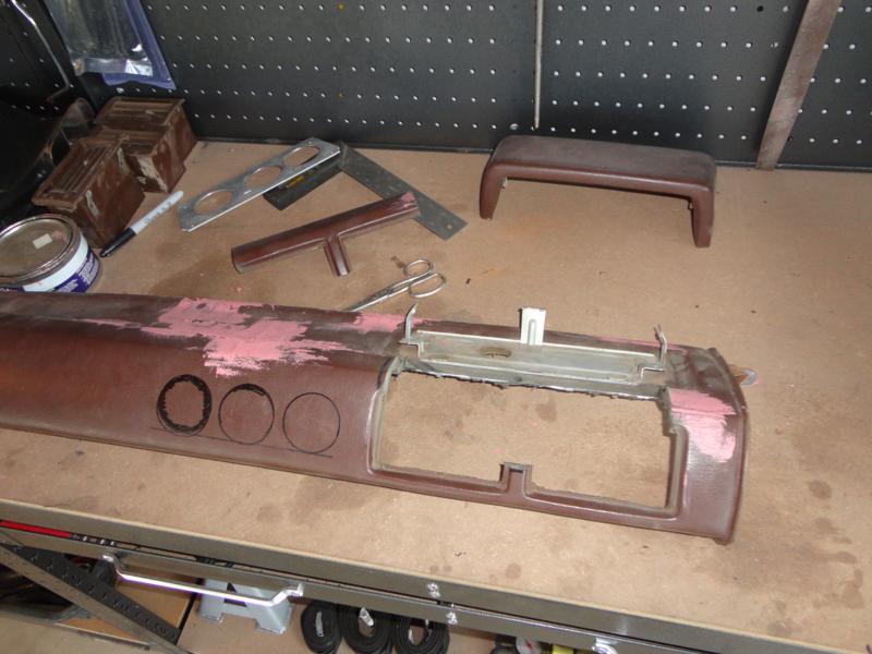

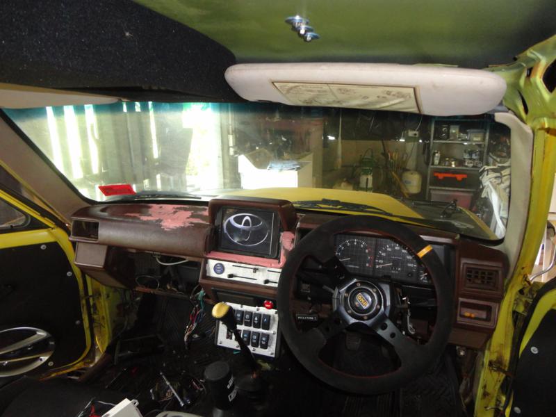

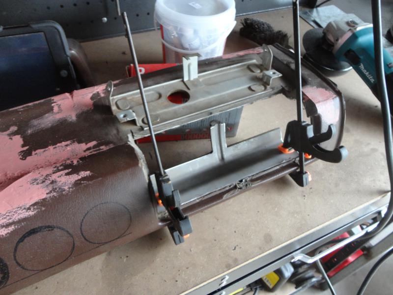

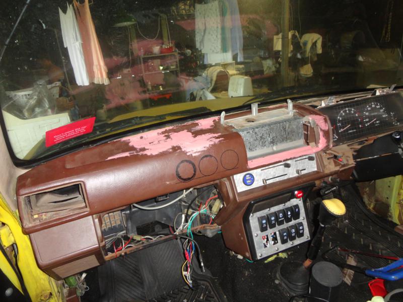

Cut dash up

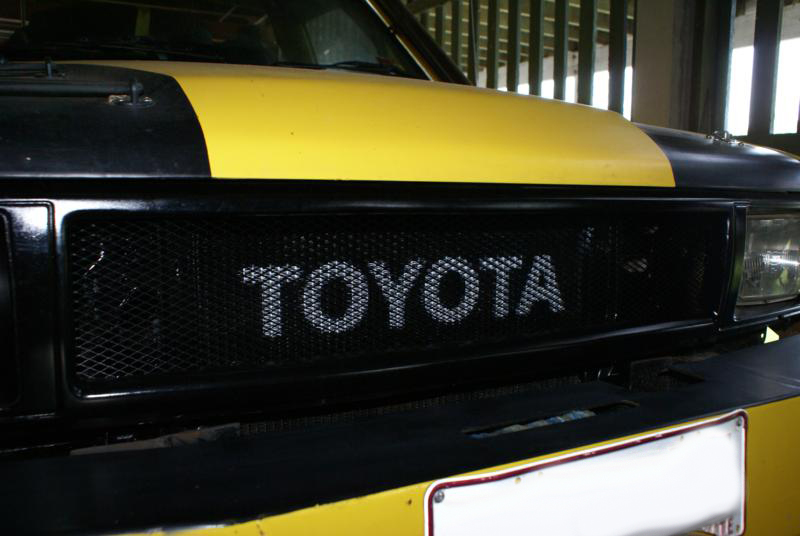

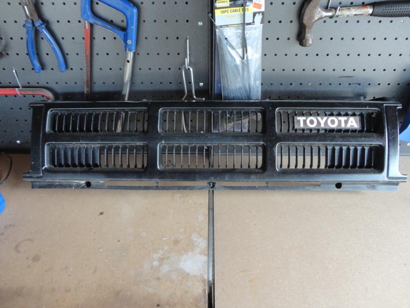

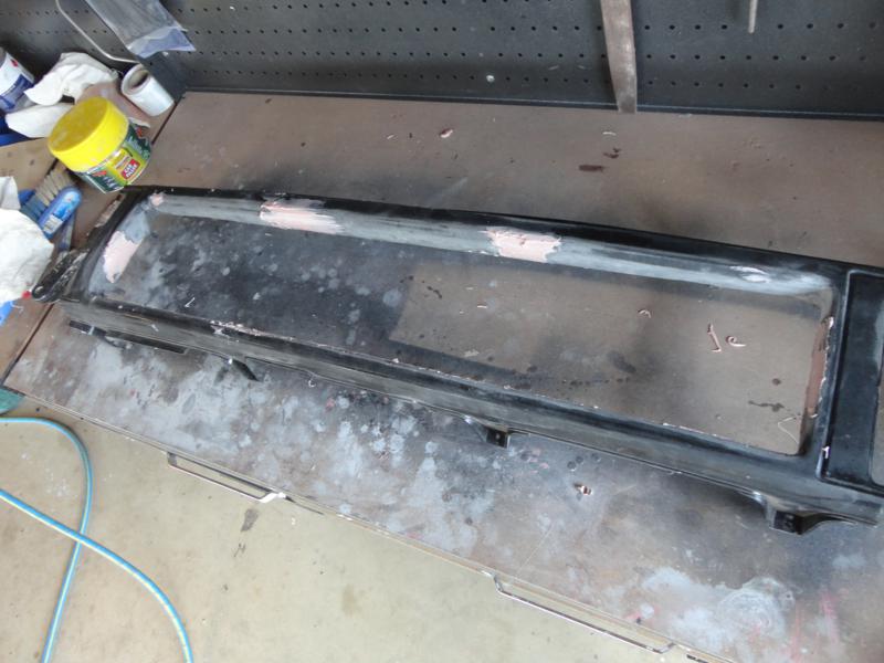

Cut grillie

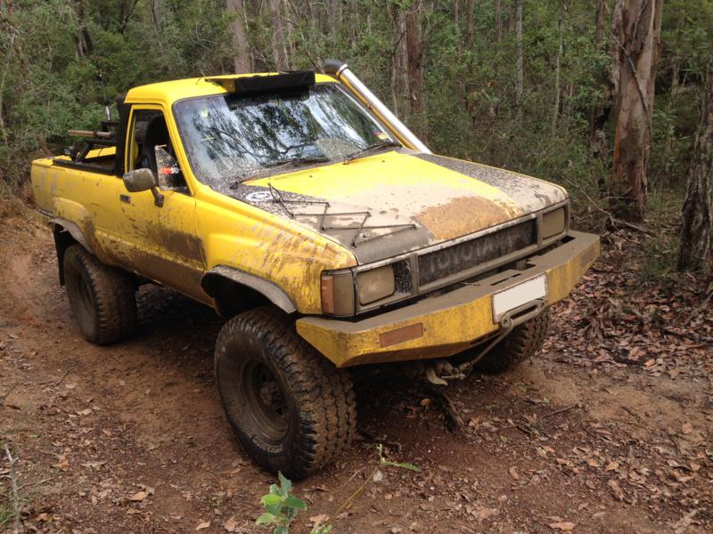

Add mud..

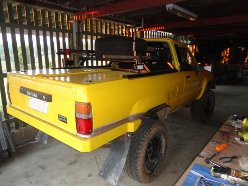

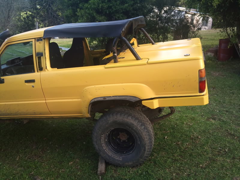

Cut down rear rack

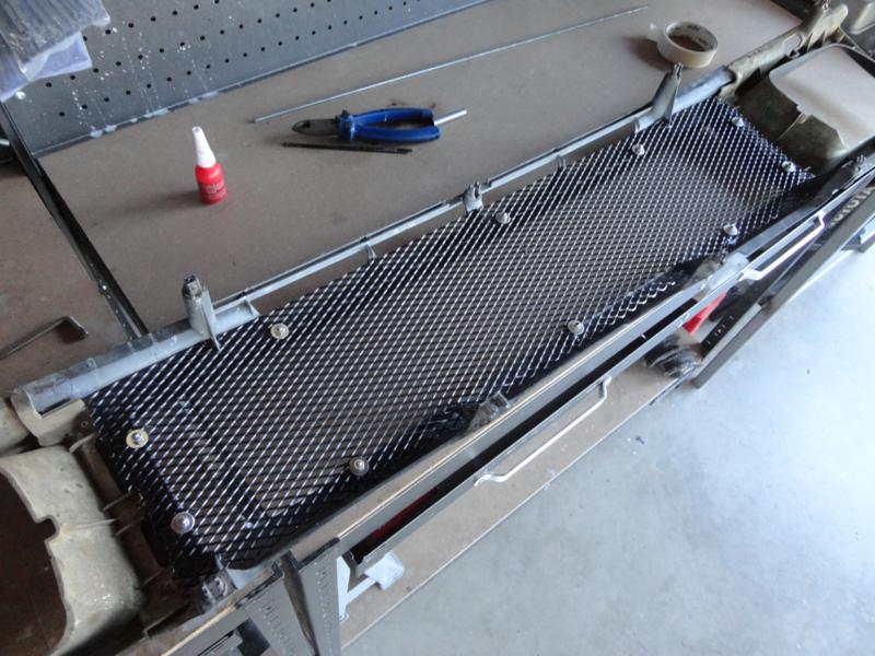

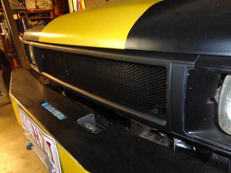

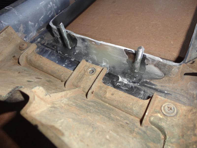

i Got one question buddy on the grill how did you manage to glue or mount the metal grill to the plastic front ??

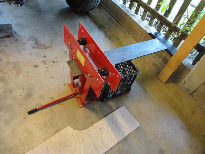

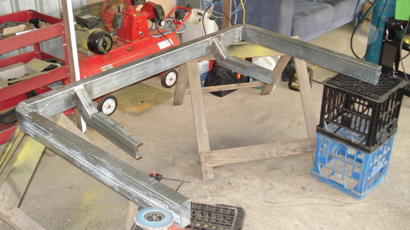

I love the way you made the cross member. I would have never thought to use the bender that way. I have the same one in the shop. Any pics from the underside showing from a different angle.
Old Oct 3, 2014 | 01:06 PM
Faolan's Avatar
Joined: Aug 2010
Posts: 14
From: Sunshine Coast, Australia
Thanks for the comments fellas! I am just hacking away, no artist, and the pics don't show the amount I have messed up along the way! Sorry for delay in replies as well, most of my employment is overseas so I tend to drop out for a month or so occasionally.
The cross member did come out good! It was a fair amount of messing around and in materials way cheaper than from a shop....add the time I spent on it then probably not but I like to try and do stuff myself if I can.
I scored it across first with the grinder then notched out a bit of scrap bar to fit on the top of the bender jack.
If your going to do this, make sure you use a decent thickness of bar, the one I used bent during the bending, didn't affect anything but next time I will use a stronger bit..
When it was all the right shape I ran a few beads of weld back through the score troughs to finish, then paint.

The grille is held on with epoxied cut down threaded bar, then washers and nuts to suit...
