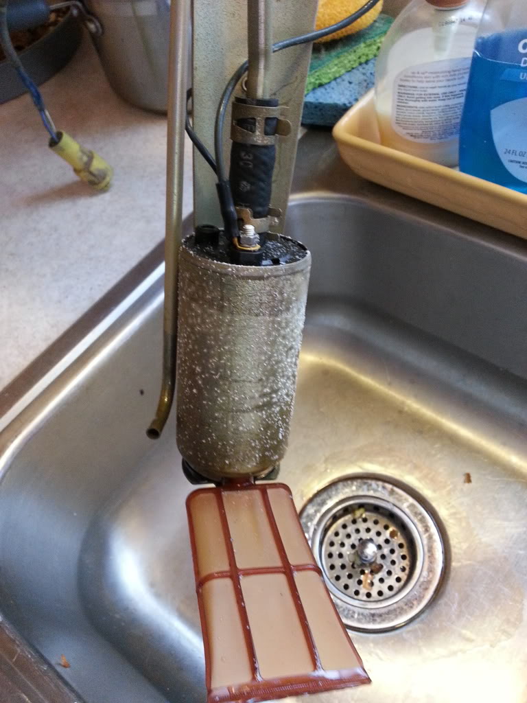

heres pump

Well im gonna use fuel hose where I broke that piece and just lamp it tight. I bought new pump and strainer today so hopefully tmrw shell be running. Too bad I leave for work next day and cant enjoy her.

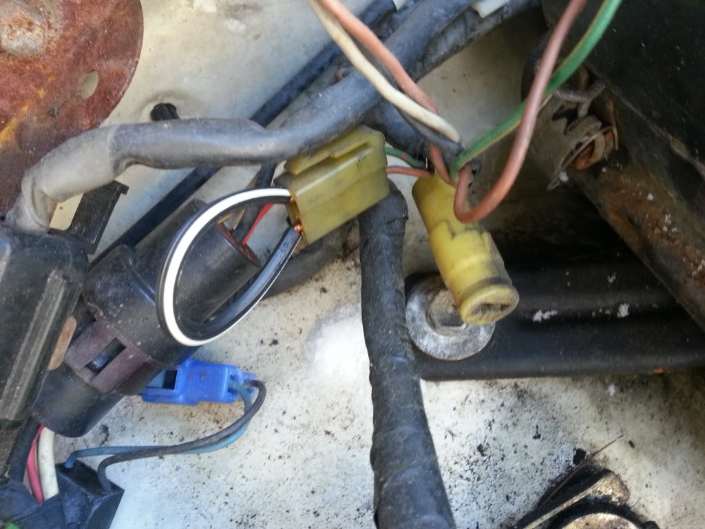

Am I doing this correctly??
By jumping this I am bypassing the cor?? So if she fires up with it bypassed it implies that my pump is good and my wiring to the pump is good, correct???
The I can check the cor and the afm???
If it does not fire up it means my pump or my wiring to pump is bad???
Ive also read something about reading ohms or volts somewhere.
My battery was fairly dead so I have it charging off my wifes car right now. But I tried turning her over and nothing I cant hear the pump going. Its brand new pump.
So if I have it bypassed and its still not cranking I should pull out pump, put power directly to it make sure its running and then check over wiring to it make sure its good.
I think im understanding what I am needing to do. I think. Can I take my meter and just run down the line until power stops and that will show me the issue with wire if there is one or should I just look for cuts and stuff???

Was I doing that jumper correctly???
I am going to test pump tmrw and if that's fine I am going to to start tracing wire for it to see where its bad.
