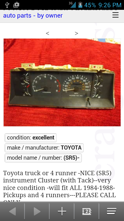

Very excited to find some LEDs for it and finally have a tach.

You got the good guage. It has the Horizontal lines and not the crossed hatched ones. I like the one you have a lot better then the other style. Dont for get to get the correct Oil Sending Unit. It is the larger one and runs about $30 for it.

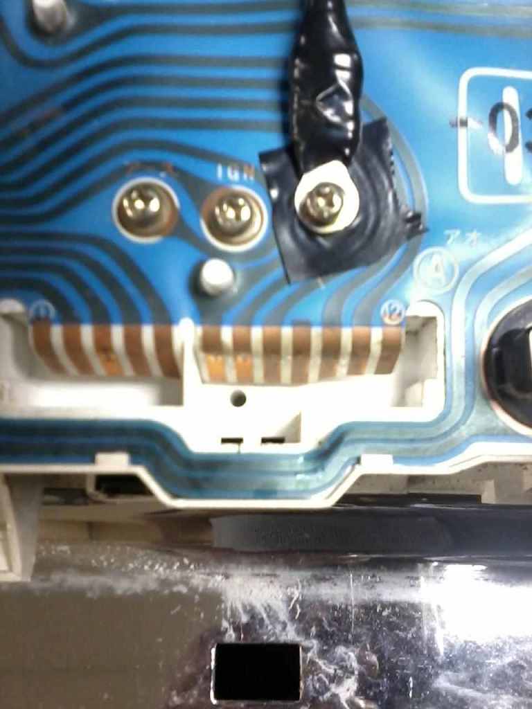

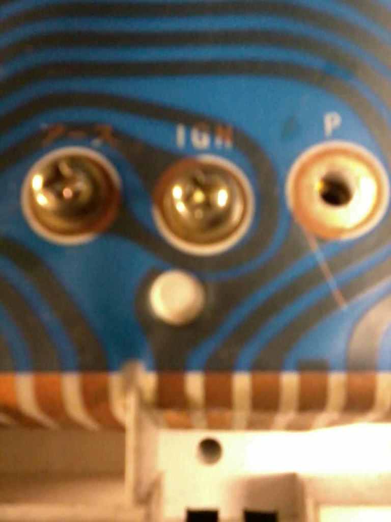

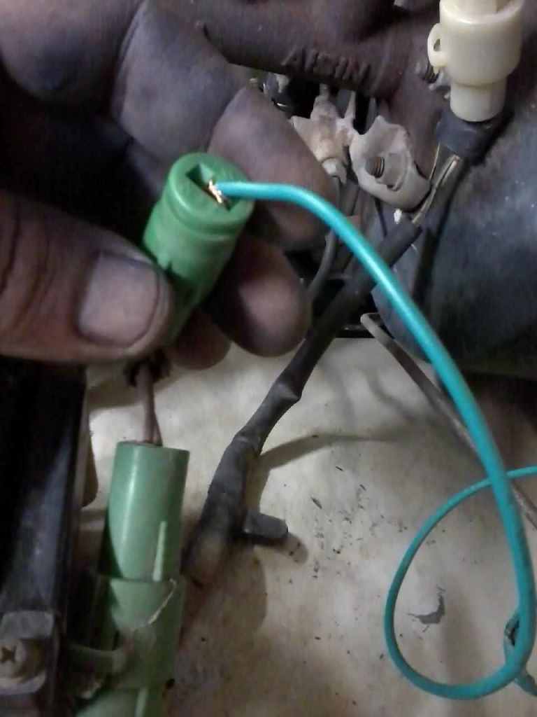

Here you go. It may or may not work. If it doesnt work just run a wire from the "p" to the Negative side of the coil.
If your tach does not work, you will need to run a wire from the negative side of the coil to the "p" on the back of the cluster.
Copied.
I then ran a wire to the negative side of the coil, on a carburator coil it is a little different then a standard coil you are most used to seeing. This truck didnt come with the SR5 guage so I added it. If your truck is not Plug and Play like some are, you need to run a wire from the negative side of the coil to the little "p" to make the tach work.
Then what I did so as not to short out the electrical run beside it. I placed a piece of electrical tape over the little "p" and crimped a wire to the smallest connector that I could find.
I used tape for insulation and to make my connection to the "p".
This is a temporary connection and is on a 22r Motor.

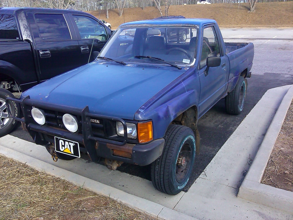

better picture of brushguard and new tires.
they dont look like much but they ride amazing, great for a DD

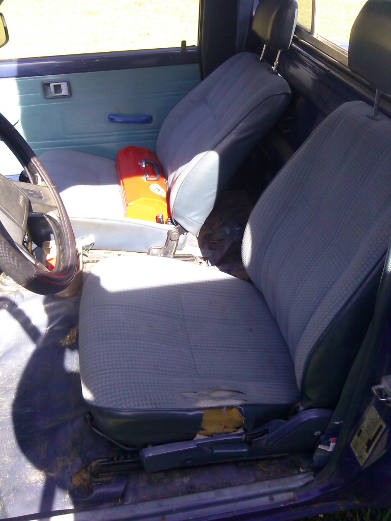

Picked up some bucket seats for $60! I missed lumbar support so much i dont even care about the hole. Anyone ever swapped the passenger and driver seat onto the others' rails? just a thought
The kid had an 87 4Runner SAS'd with dual cases and a roll cage inside.
It was pretty sick. Good to make a somewhat local comtact for parts. he had a ton of stuff.
