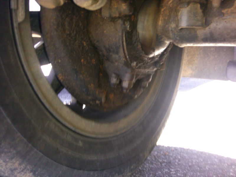

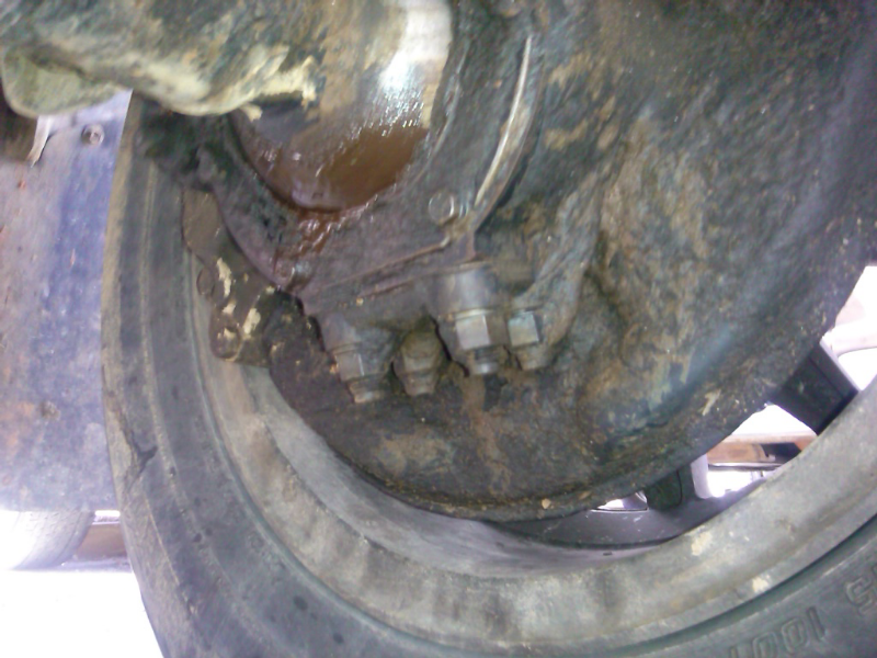

I'm pretty sure my front end needs to be rebuilt on account of this fluid on the knuckles. Maybe I can get away with just not using my 4WD for a little while. If it's not engaged there shouldn't be anything partying inside my axle.
Plus I could rebuild it right before I get new rims and tires so that everything gets balanced and aligned at the same (:
Luckily these falken street tires will not die. I'm riding these bad boys to the wire.

I eventually need to rebuild my axle. From what I have seen, Marlin Crawler has the best rebuild kit out there and is even better then Toyotas kit. Luckily I will have a friend helping me on mine. With the cost of tires I dont blame you for trying to get every mile out of them.

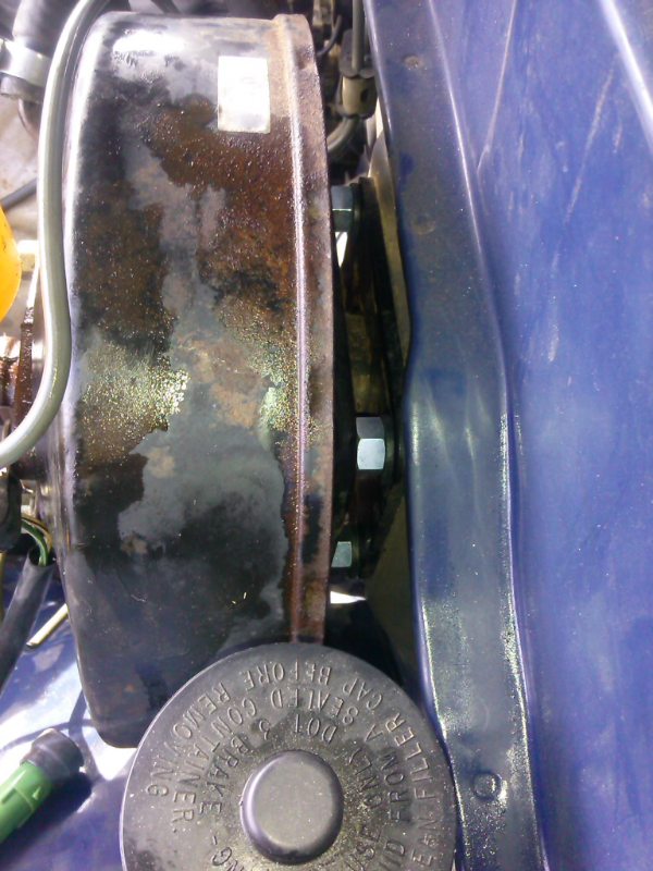

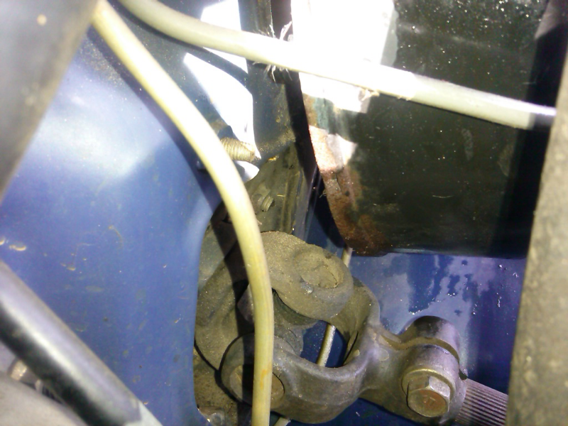

Bought an 88 efi booster and it's too big! You can see where it was hitting the steering joint. So we shimmed it and adjusted the pedal play. On the bright side my brakes work. I plan on fixing this but it does work safely.

I have never seen that problem before. You sure the truck the booster it came off of hadn't been switched before? Something I will look into when I get the chance as I have an 88 and will see what the size differences is.

I would put my money on it being the original booster because the small tag on top of it was only one number off from mine.

I may be wrong on this but i think there is 2 different size boosters.I think the turbo model dual diaphragm booster is of a smaller od than the others,thats why its sought after for the earlier model trucks.Please correct me if i am wrong.
