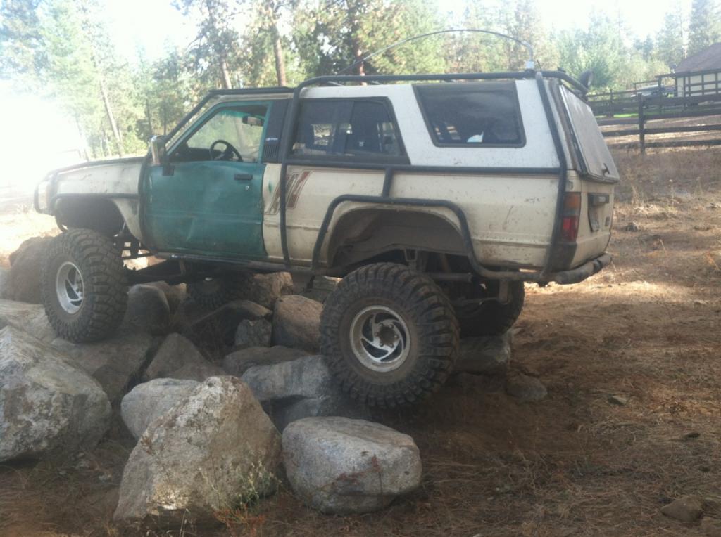

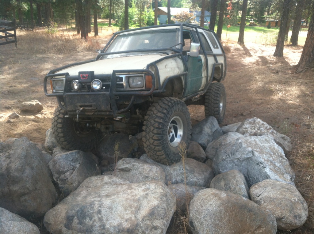

Here are a few shots of the runner in my rock garden.
[IMG]https://www.yotatech.com/<a href=http://s1310.photobucket.com/user/1984RunnerCrawler/media/IMG_0048_zpsddfddff2.jpg.html target=_blank>Name:  IMG_0048_zpsddfddff2.jpg
Size:  286.0 KBName:  IMG_3522_zps3ed63391.jpg

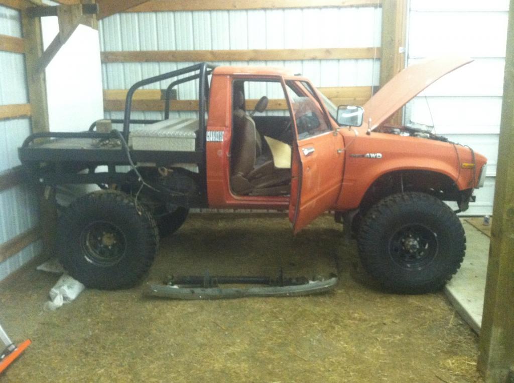

A friend bought a project yota (80% done) a few months back and brought it down to my shop. Pretty neat truck!
70's single cab, dual cases, 4.7 gears in the rear case, twin sticks, supposedly rebuilt 20R, webber carb, 4" rough country lift springs, brand new 35", spartan locker in the rear, open front.
We need to wire it up, lengthen drive lines, lengthen brake lines, and tighten everything up and probably a ton of other little things but should be a fun truck when done.
