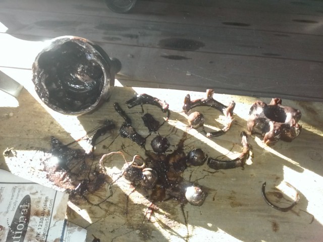

Birfield
At the very end of my last wheeling trip (videos above) my front right tire was no longer spinning under power and would bind up some times. The theory was my birfield exploded, and sure enough.......
So now I need to fix it. Here are the options that ive come up with.
1) trail gear chromo 27 spline birf: $119
2) Bobby Longfield 30 spline axle kit: $650
I really don't want to spend a lot of cash right now since I just put the 22rte in so I am leaning towards the TG 27 spline birf and when/if I break another component in my axle ill do the longfields.
