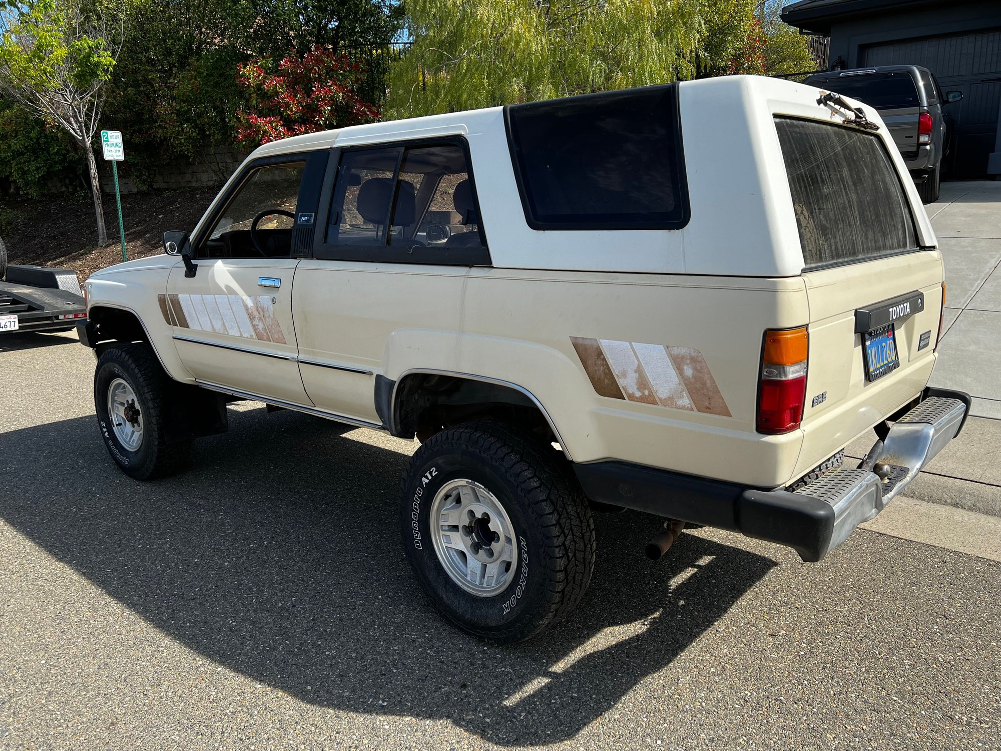

Finally got my later model SR5 wheels mounted with new 31.10.5.15 tires.
Smog pump was seized up so I took it apart today, cleaned it up inside, lubed the bearings, put it back together and it spins freely again. Will install this week and see if it will keep spinning on a running engine.

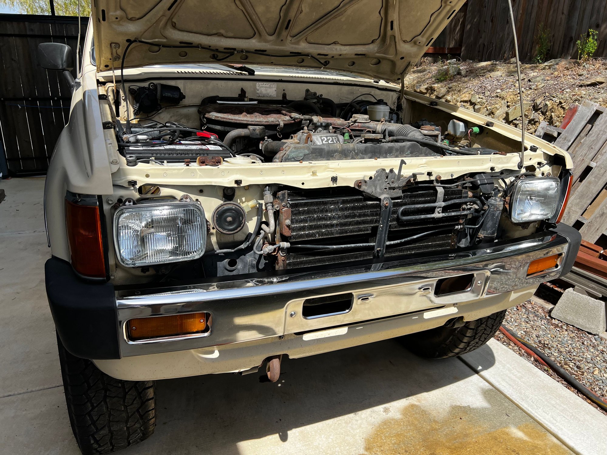

This week I have been working on wire repair due to rodents, mostly in the engine compartment and the passenger side front fender well. Looks like I got repaired what I needed because I did a check of all the exterior lights and signals and was pleased everything works as it should. All electric windows go up and down and the heater blower works.

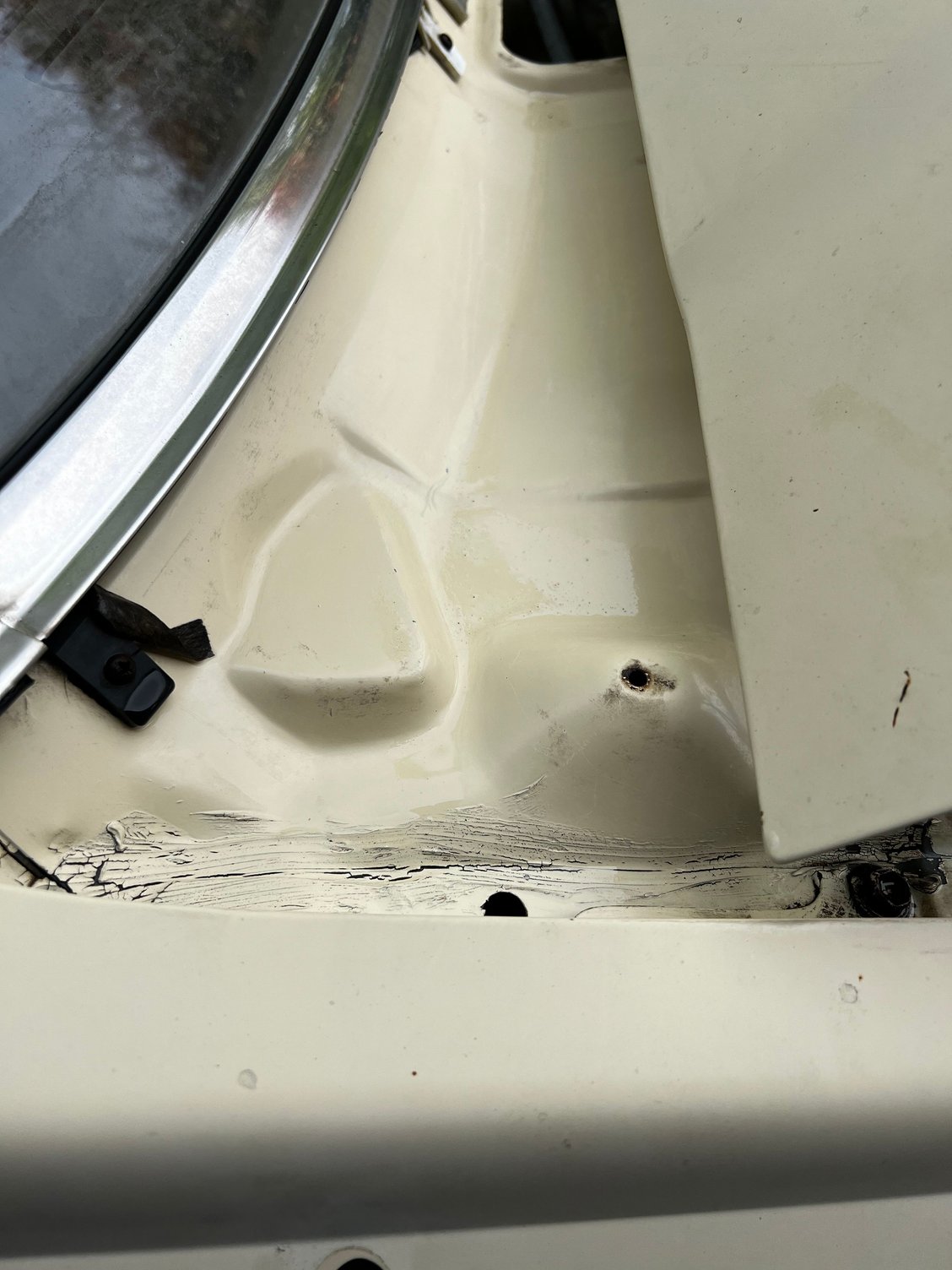

Today I removed the wiper cowl and did vacuum of that area and removal of leaves and walnut shells......I was really happy that there are no signs of rust and it just needs a good power wash left. I removed the front grill and broke some of the old grill clips which I ordered on Amazon. Replaced the front headlights so now both of those work, both high beam and low beam. After cleaning up the front radiator support and front grill I re-installed the grill and was really happy with the results.
Next few days I will re-install some wire looms and remove the radio power antenna so that I can get that repaired on the work bench. Clean up of the cowl area and re-install the cowl.

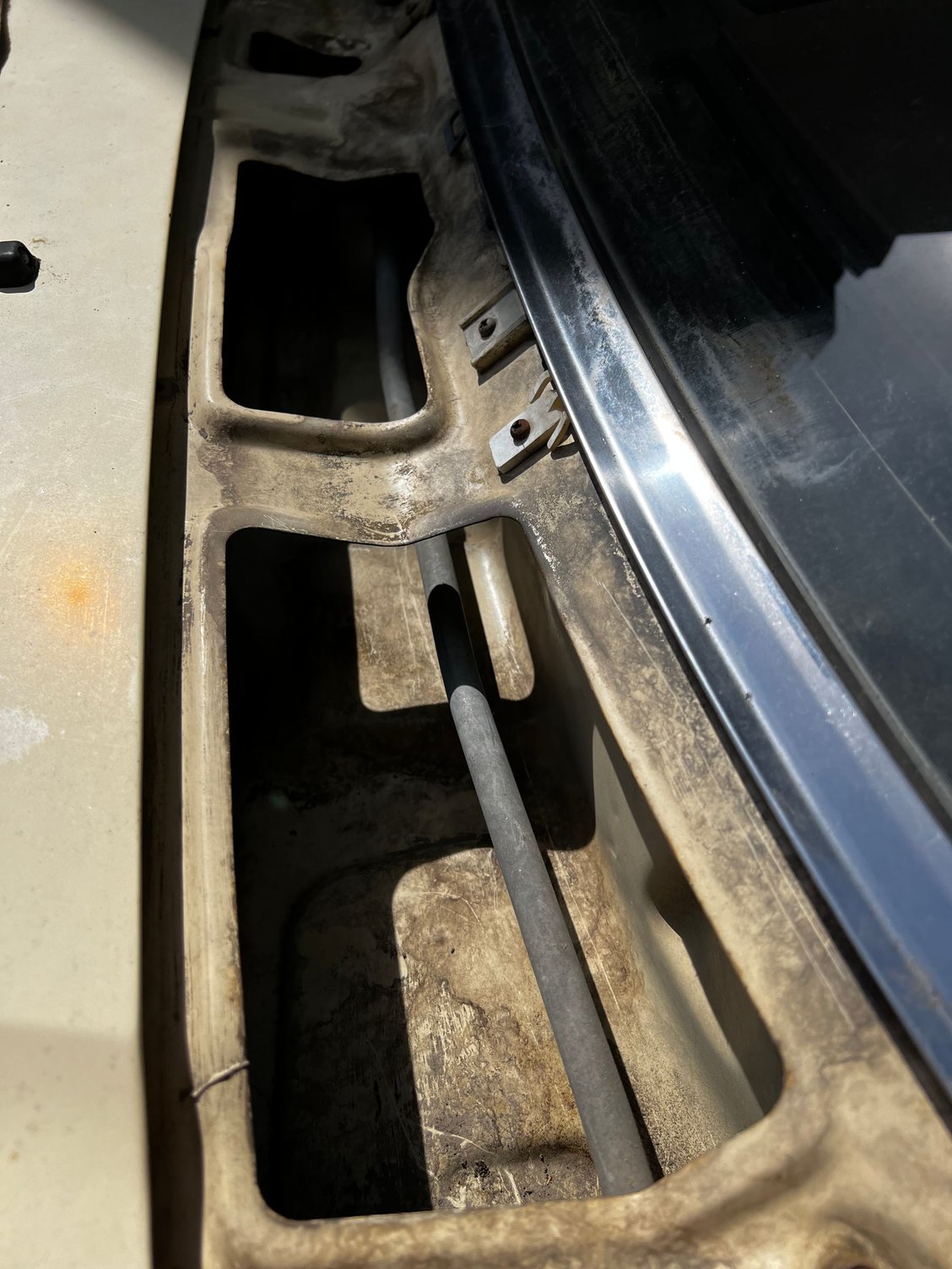

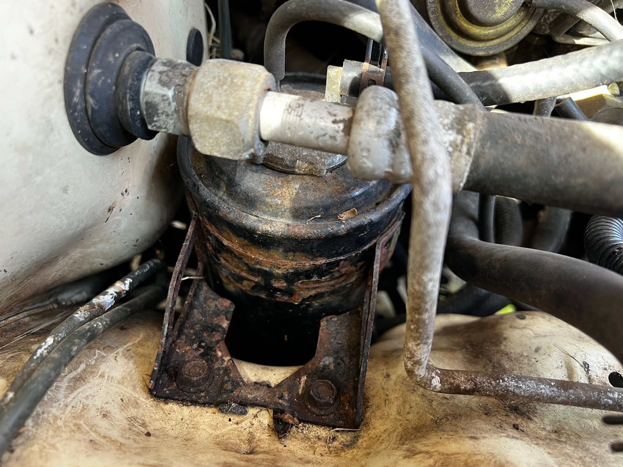

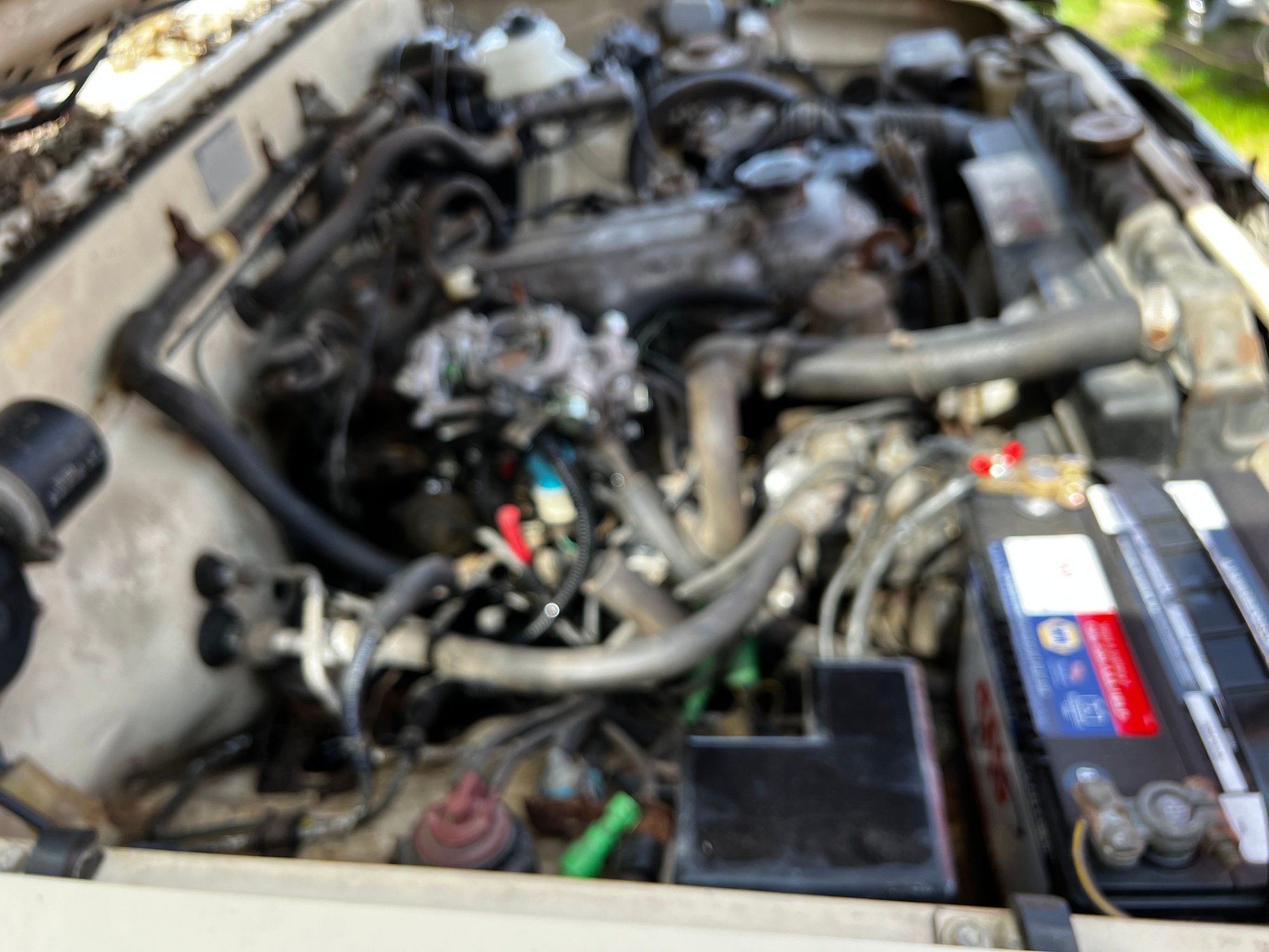

Done with the wire repairs and moved on to the engine bay cleaning which took some time but I am really happy with the way it turned out........
Wiper scuttle area
Engine bay.. little surface rust around the battery tray but it will clean up and I will treat it with some rust inhibitor.
probably bead blast the air cleaner and repaint...
