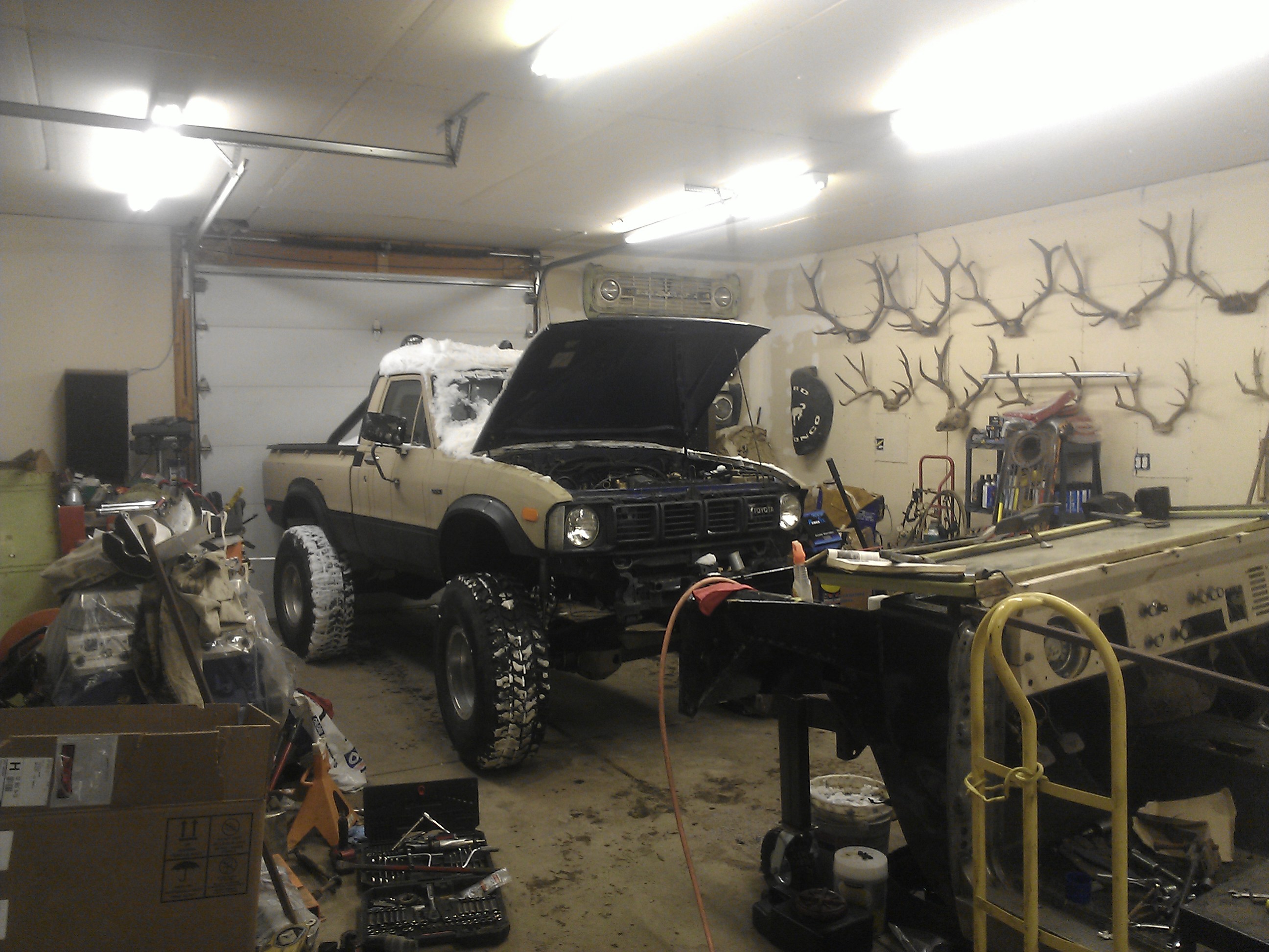

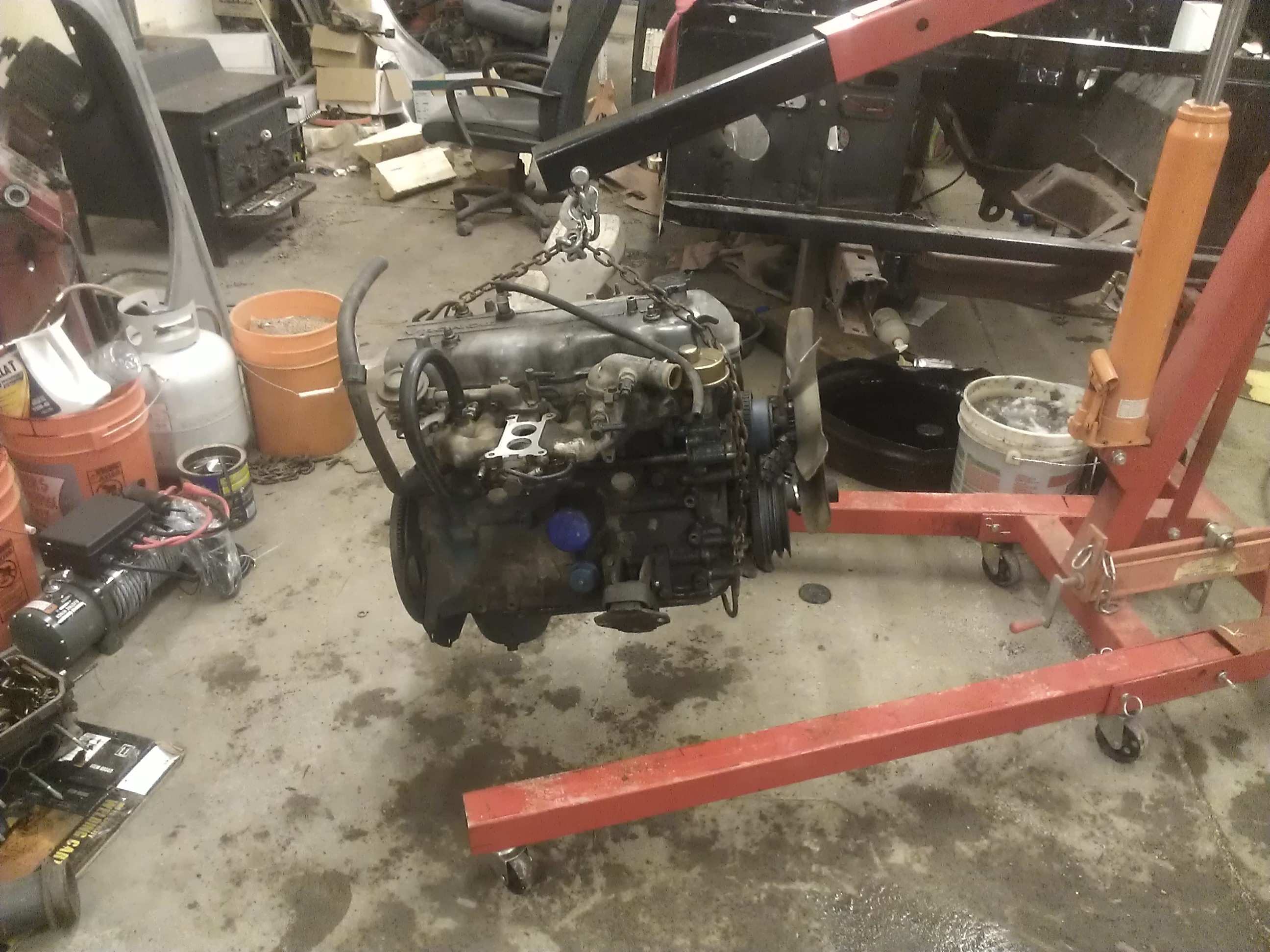

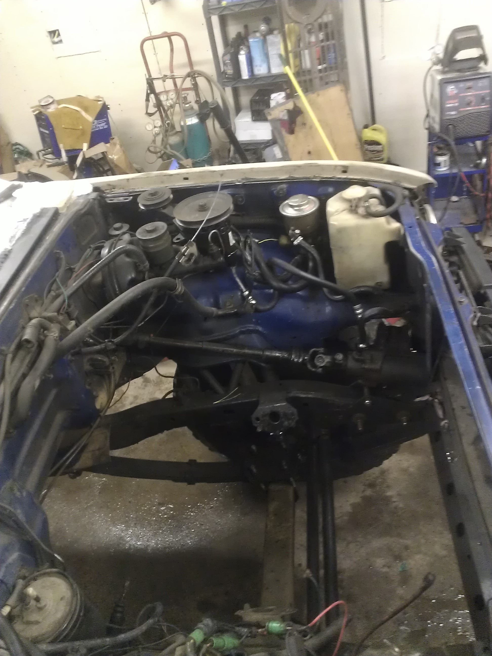

Finally!! A real update although not really much of one. I finally got it moved into the shop to pull the engine. Feels good to have some progress on this beasty again.
And out
Finally out and clear to make room for the 3.4

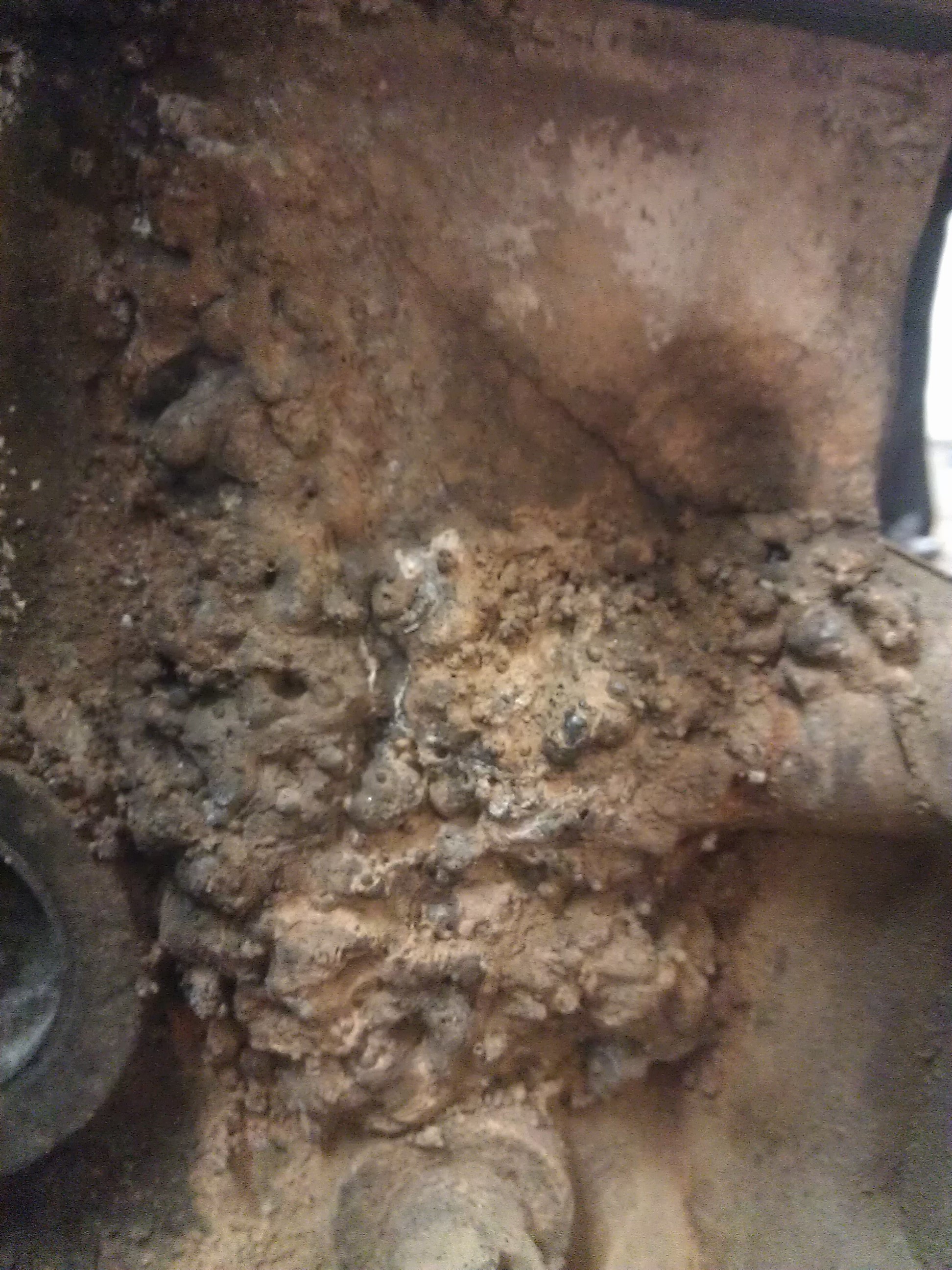

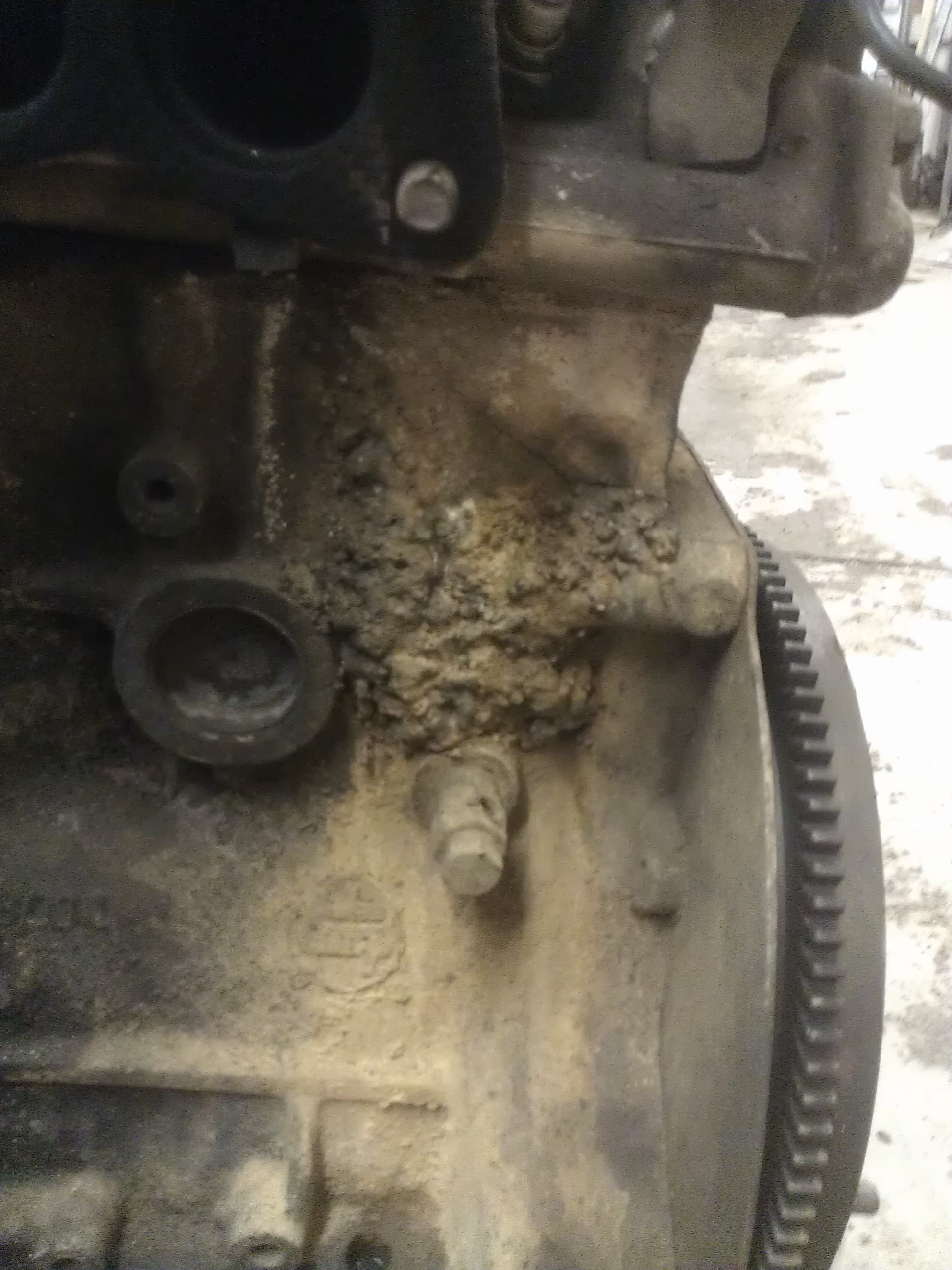

Now to what I wanted to show y'all... This is my guess as to why this terd never ran from the get go.
Someone decided that after they cracked the block that MIG welding it was the best way to fix it. They missed a crack though, clearly visible above the bird poop welds.
Size:  820.1 KBName:  WP_000904_zps73fae983.jpg
I haven't torn it down yet but I am curious to see what is on the inside.

wow .. makes me shake my head
people with welders , who shouldn't have welders !!
Agreed! That is a fix that I wouldn't have even considered.

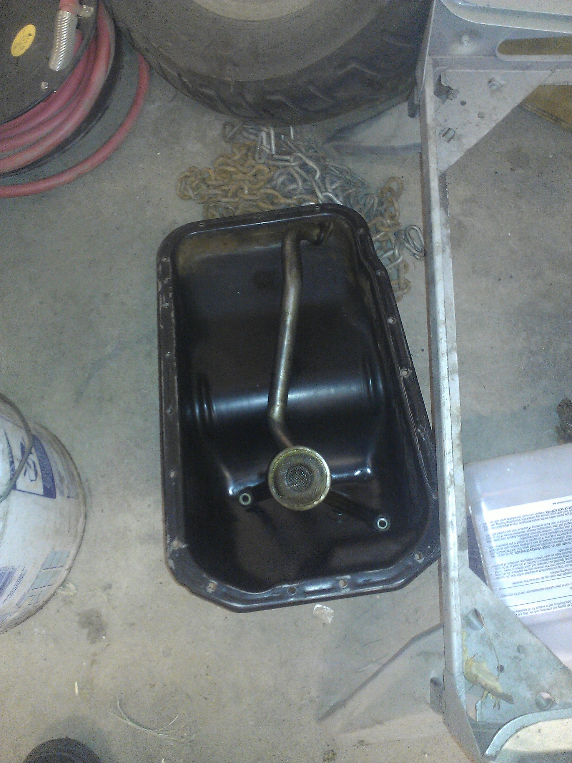

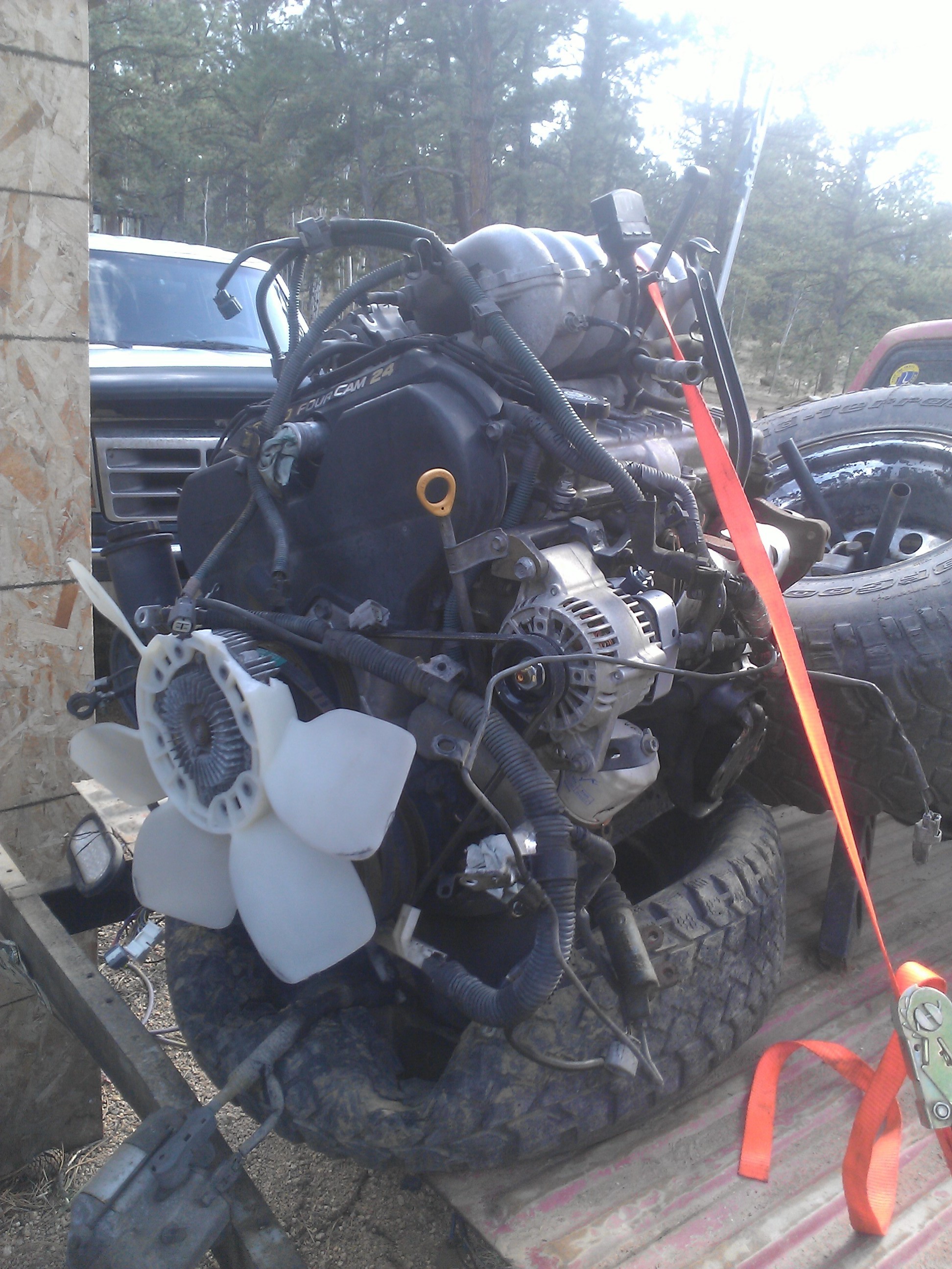

Small update. Nothing much, stuff kinda moves slow around here with so much other things going on. (1 Bronco project, like 8 Toyota projects between 5 of us, and 3 Escorts to maintain...) But I have my small pile of parts. The 2wd rear sump pan and pick up, the updated Marlin V6 adapter, dropzone's old twin stick kit. I decided to not powdercoat the conversion mounts because I can't get the pos HF coater to work properly for me... It's dumb. So a couple of coats of rattle can flat black will have to suffice for now.
I did finally get the engine and trans pulled out of the 4Runner. I need to now put the oil pan on, move the oil dipstick, and pull the crossover exhaust. I think I will end up running both banks right out the back for ease and cheapness.
New pan and pickup

Engine out.

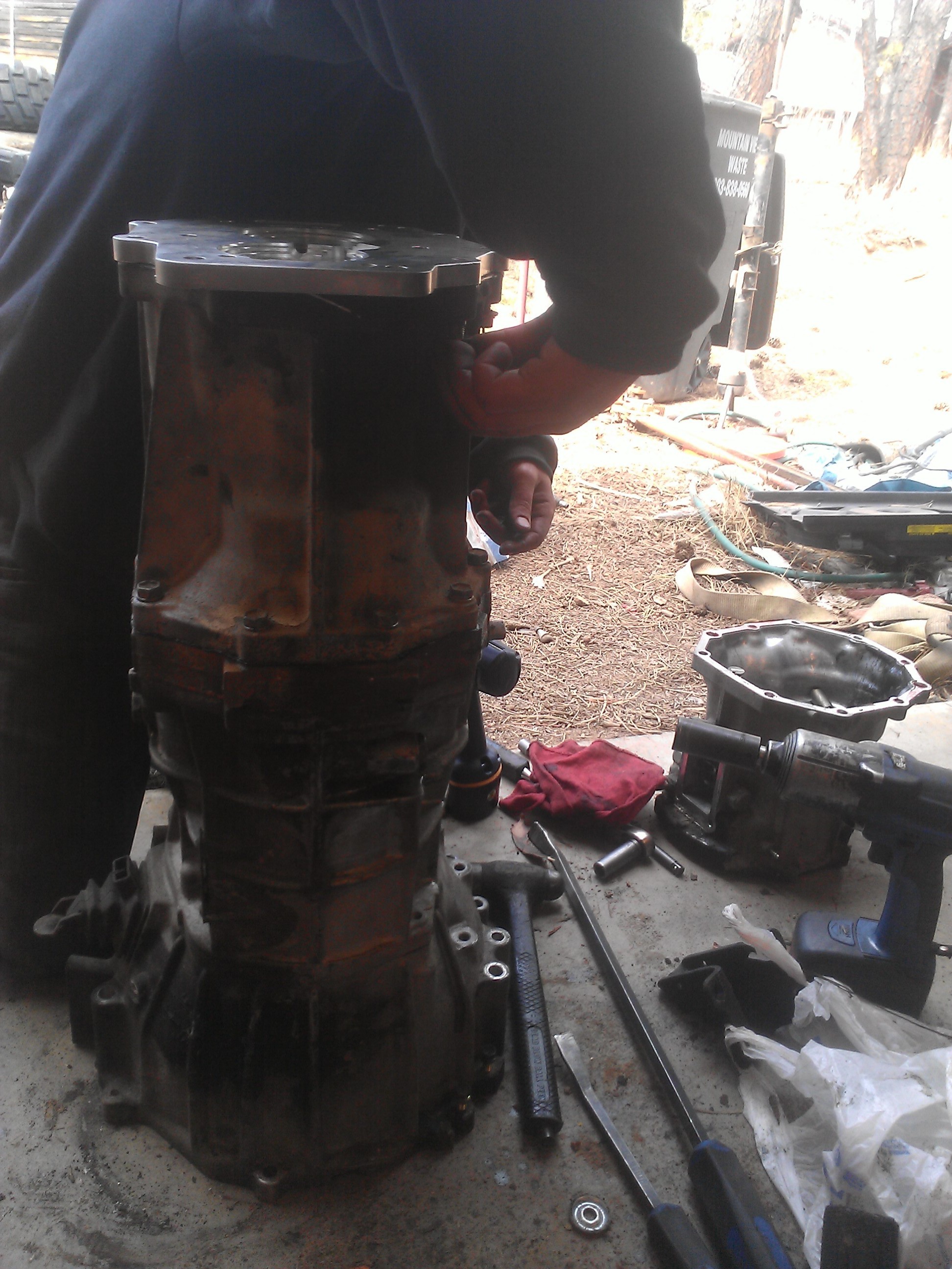

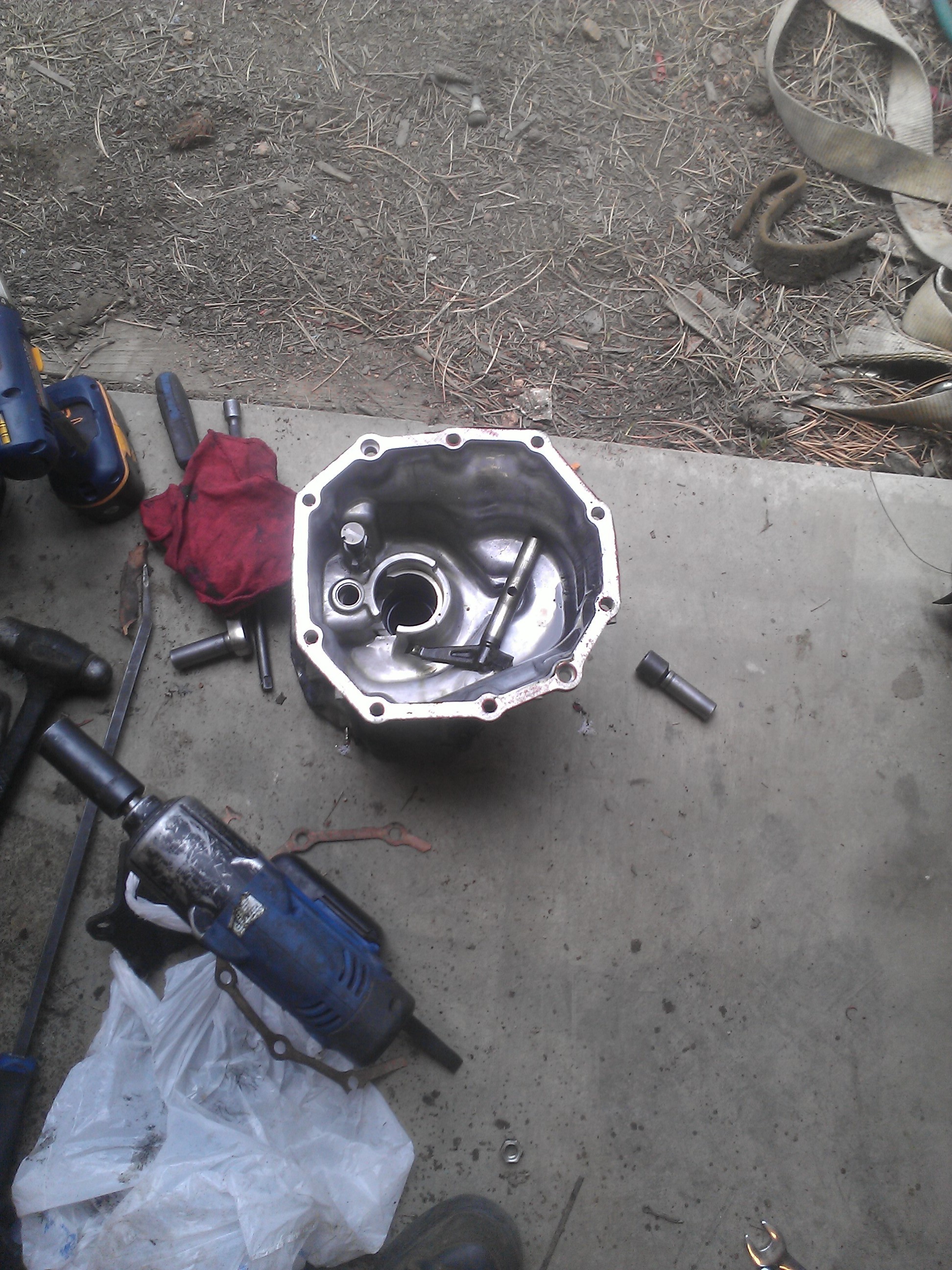

I was finally able to get quite a bit of work done on this thing today

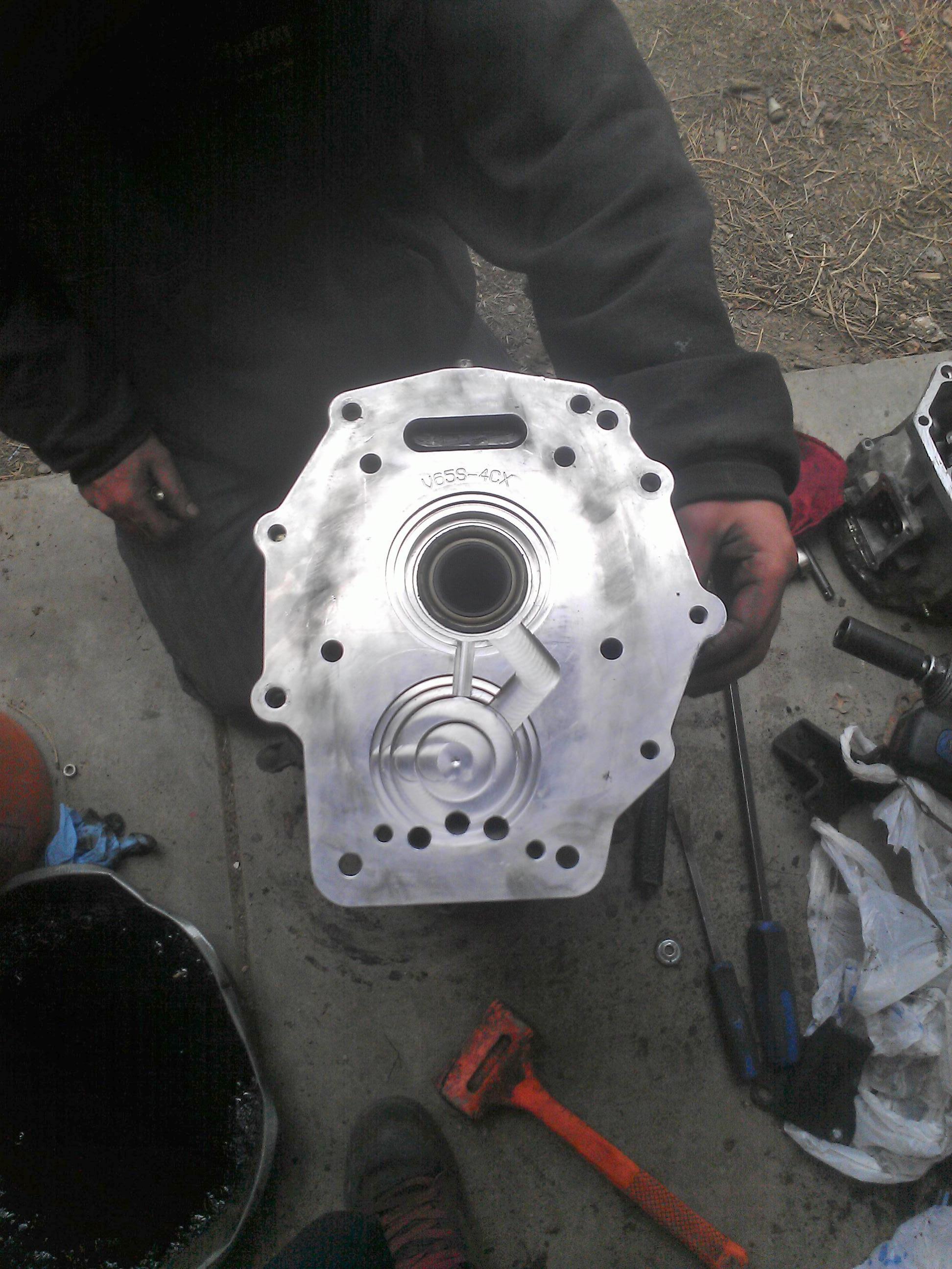

Took the 3.4 R150 tail shaft housing off
Replaced it with a 3.0 R150 tail shaft housing to accommodate my early Marlin V6 adapter
The adapter RTVd on and bolted in

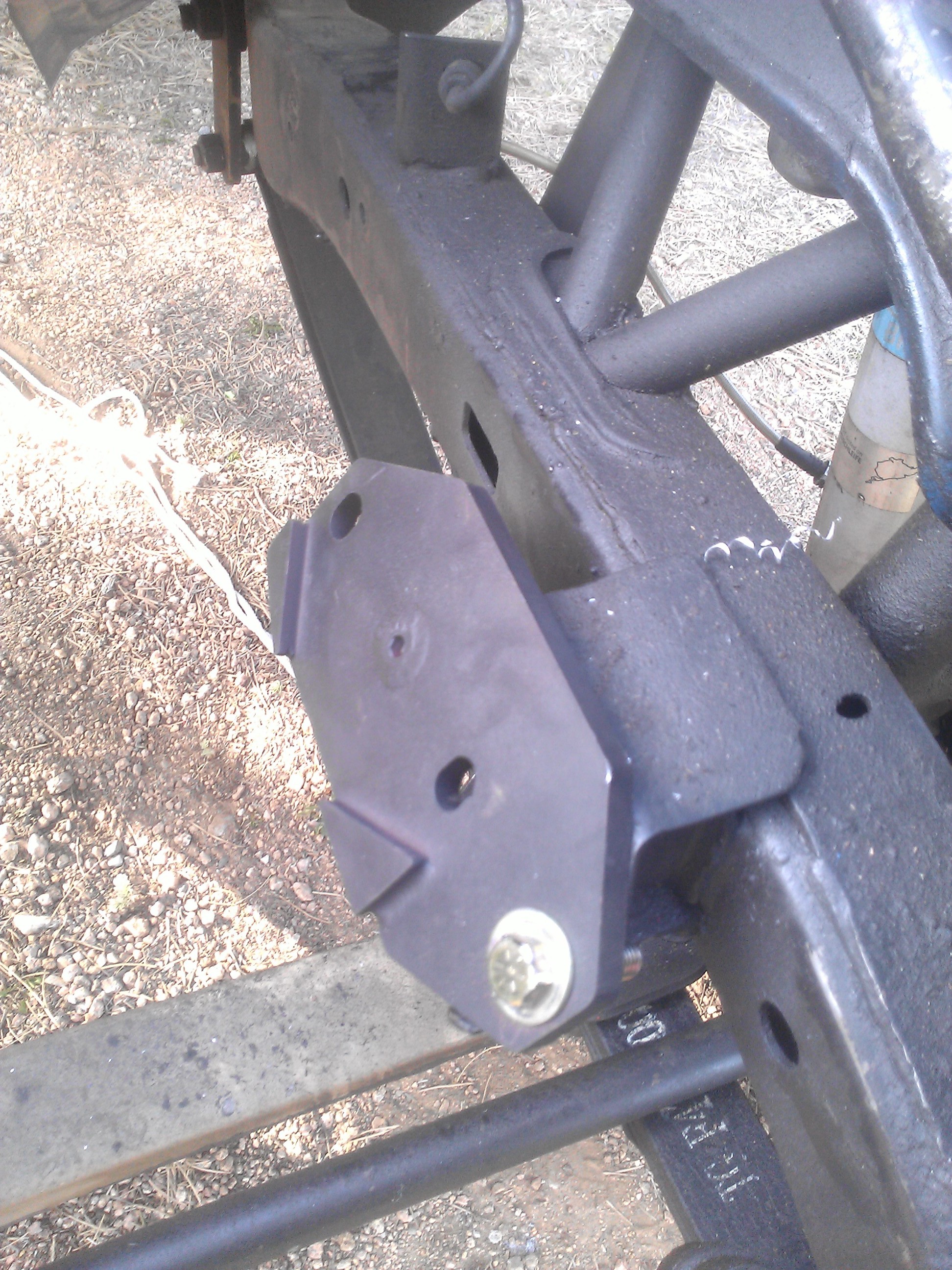

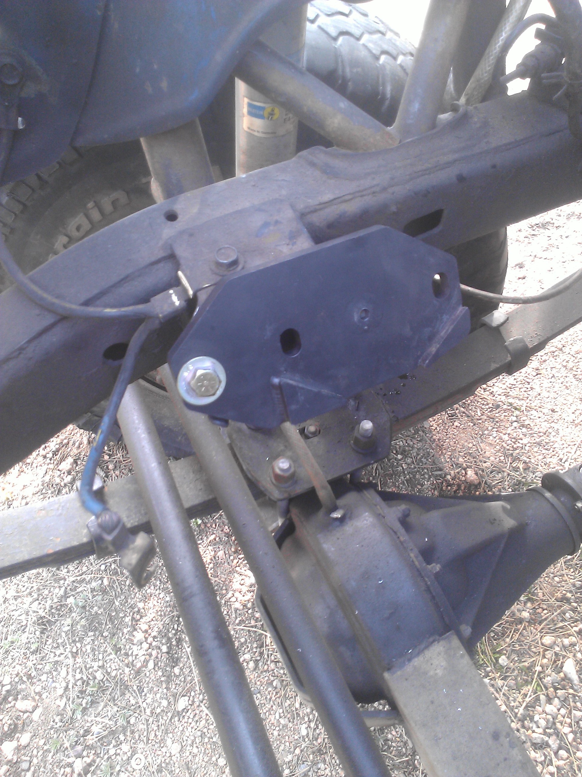

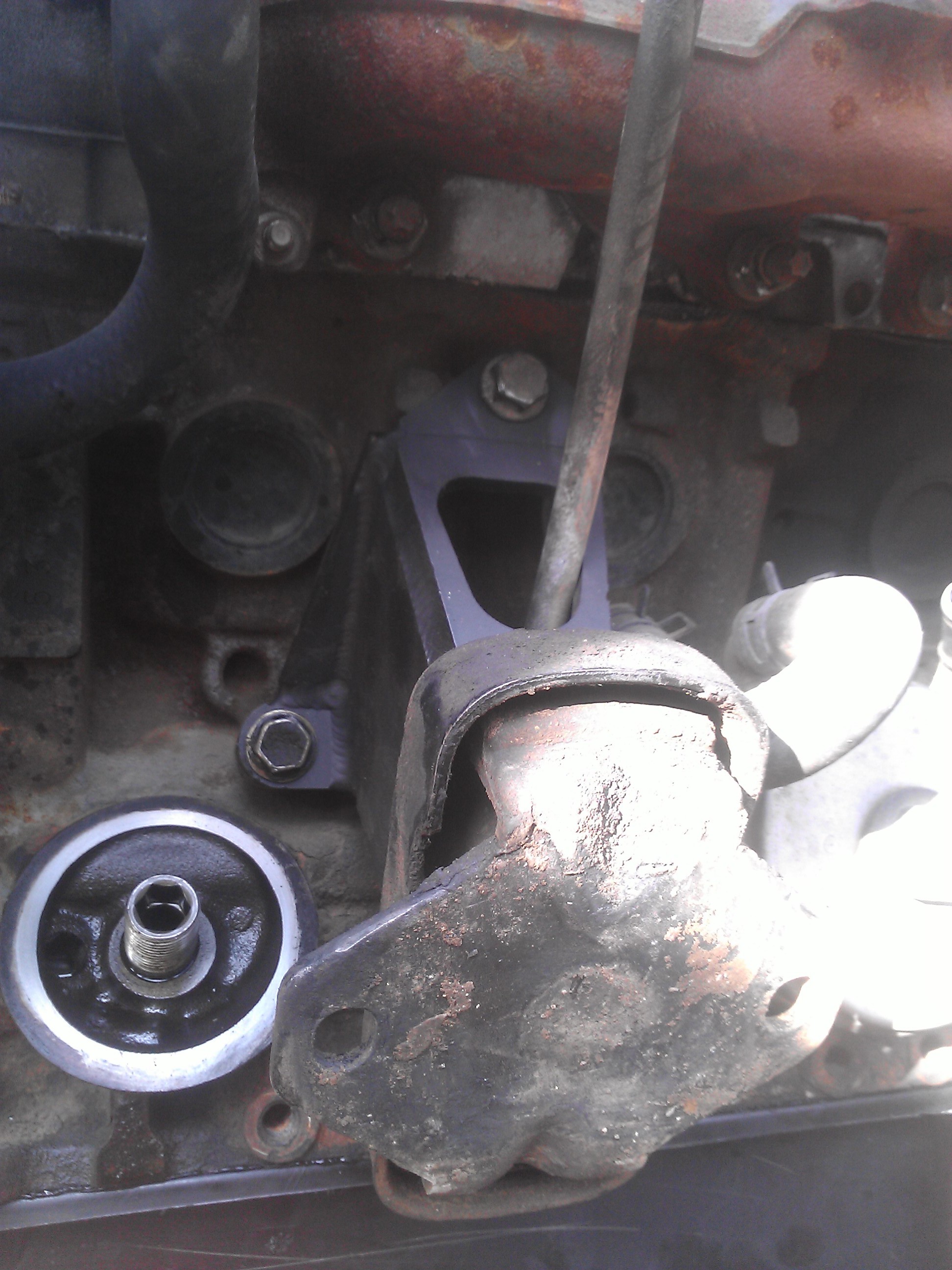

The Chilkat conversion mounts on

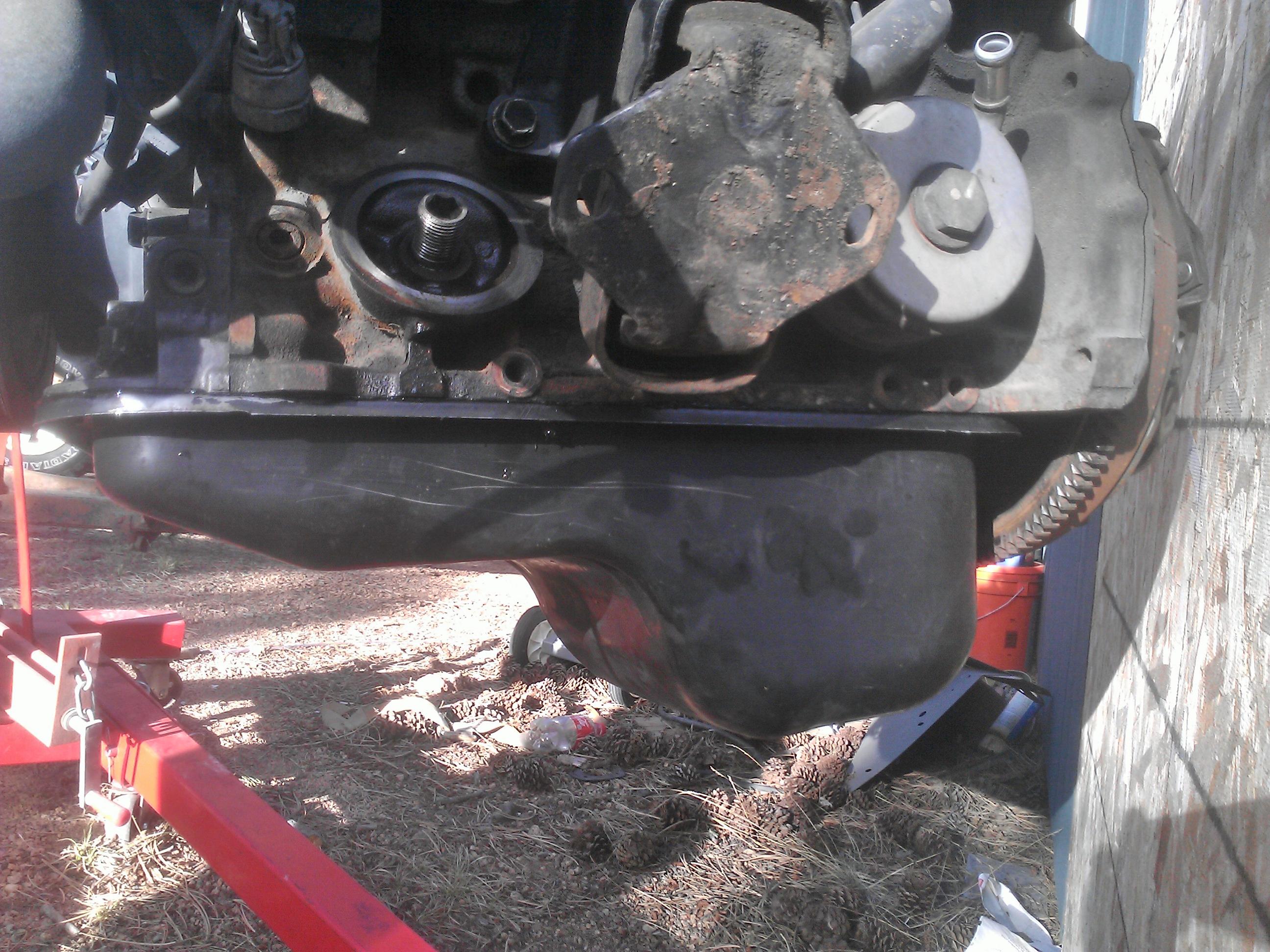

I relocated the oil dipstick tube to the proper spot. I just used the factory tube instead of looking for a T100 tube. Just as easy, only needed to drill out the hole to half inch to make it fit. No pic...
The 2wd rear sump pick up and pan installed.
