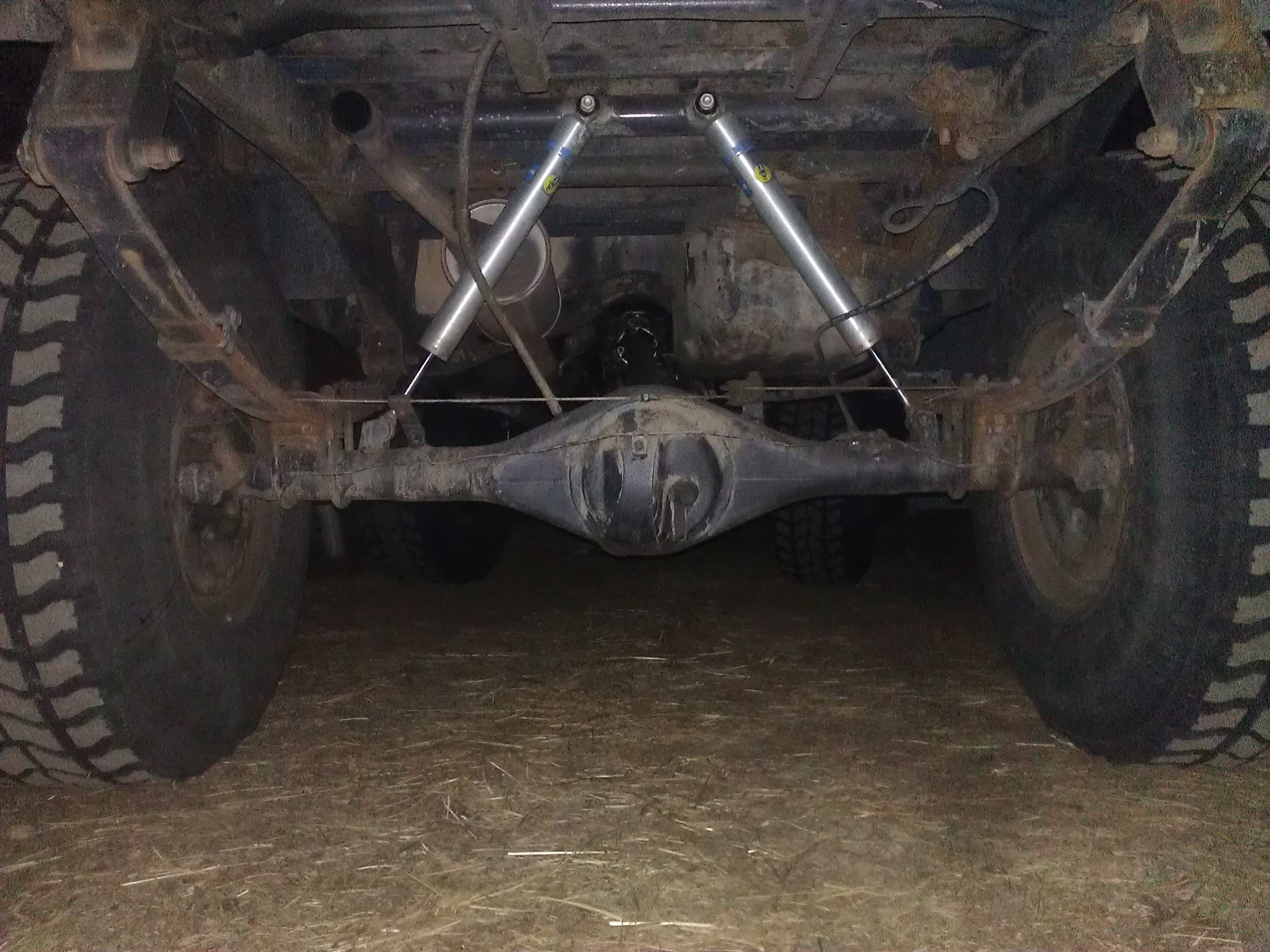

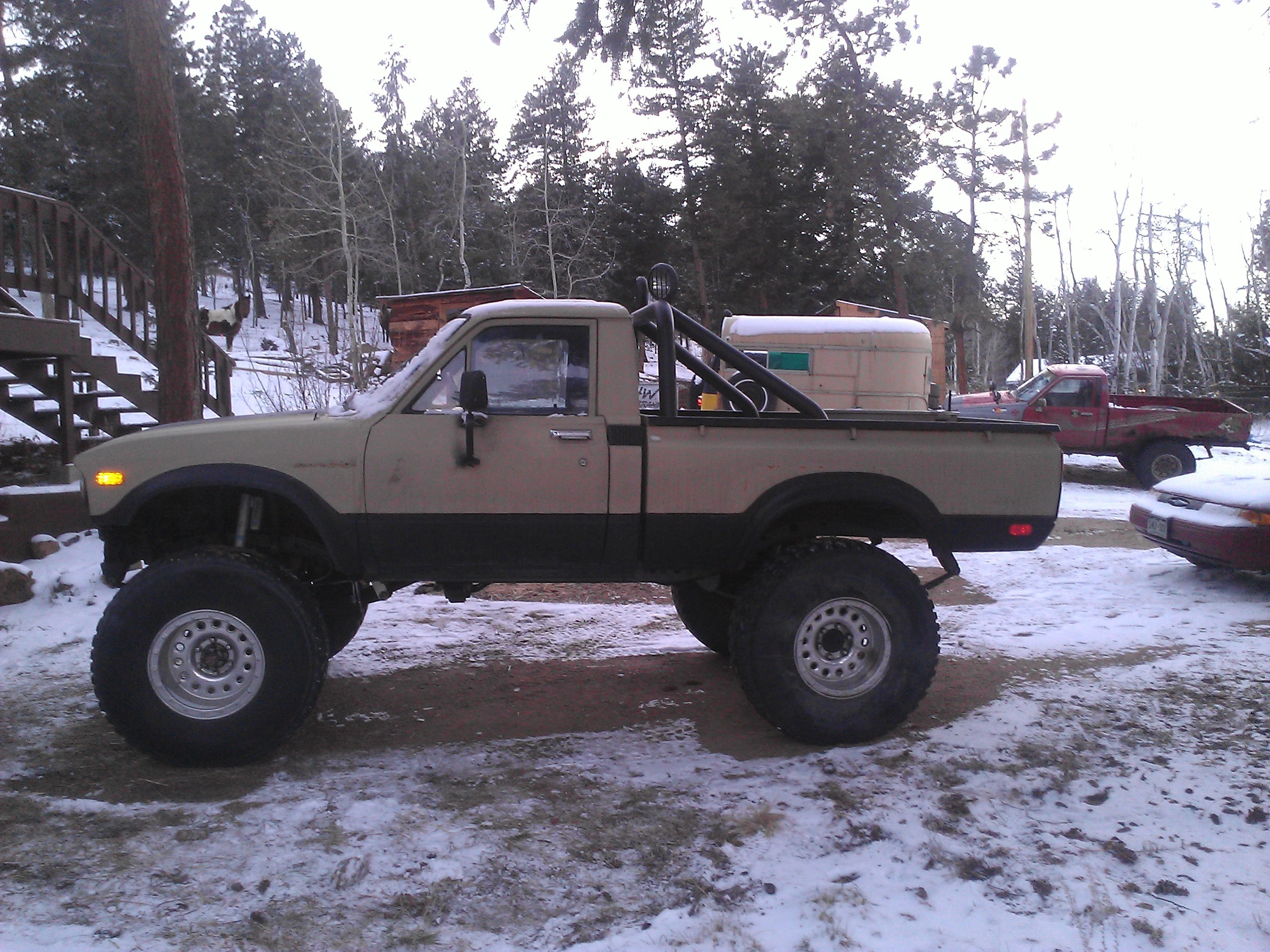

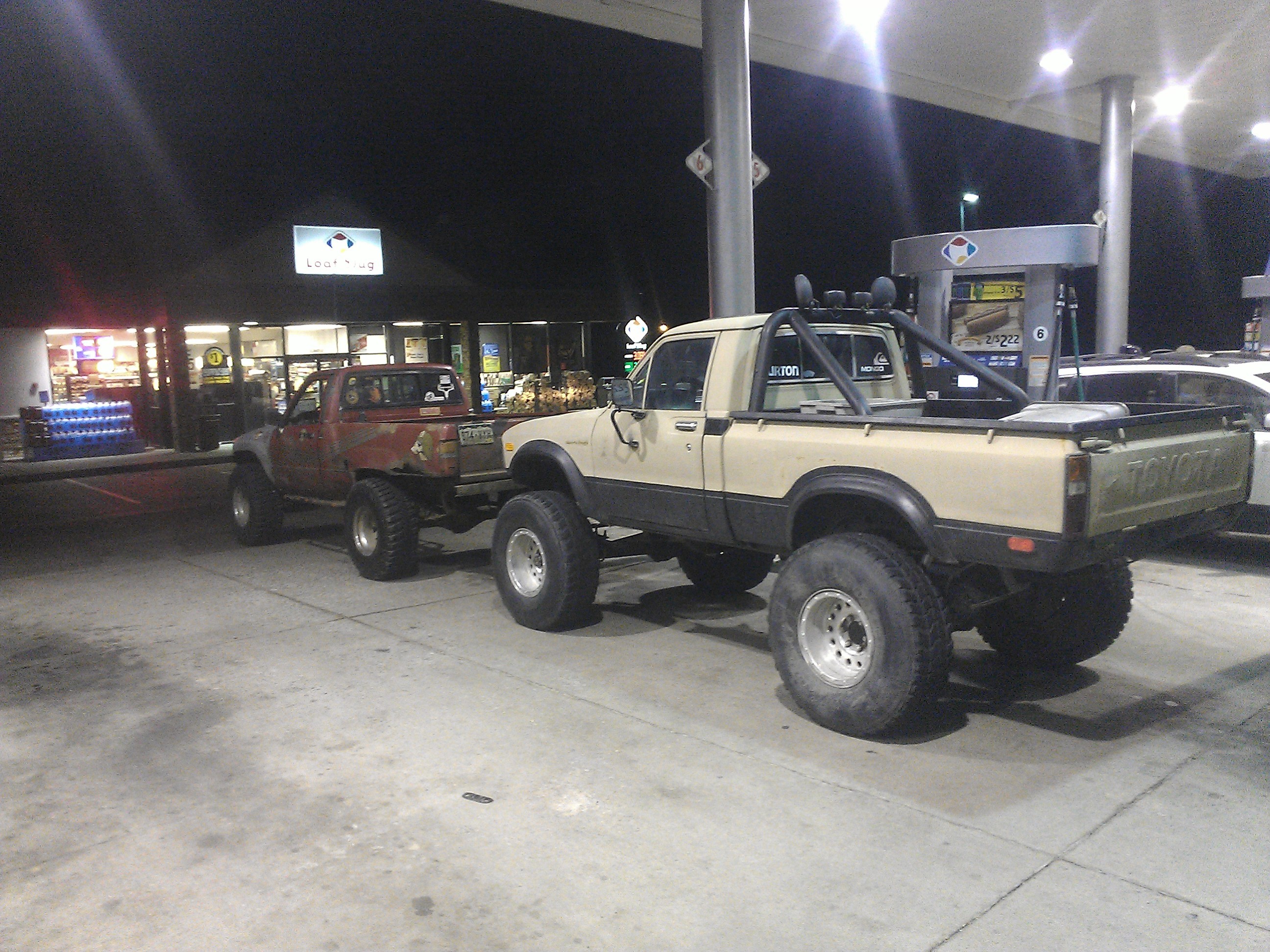

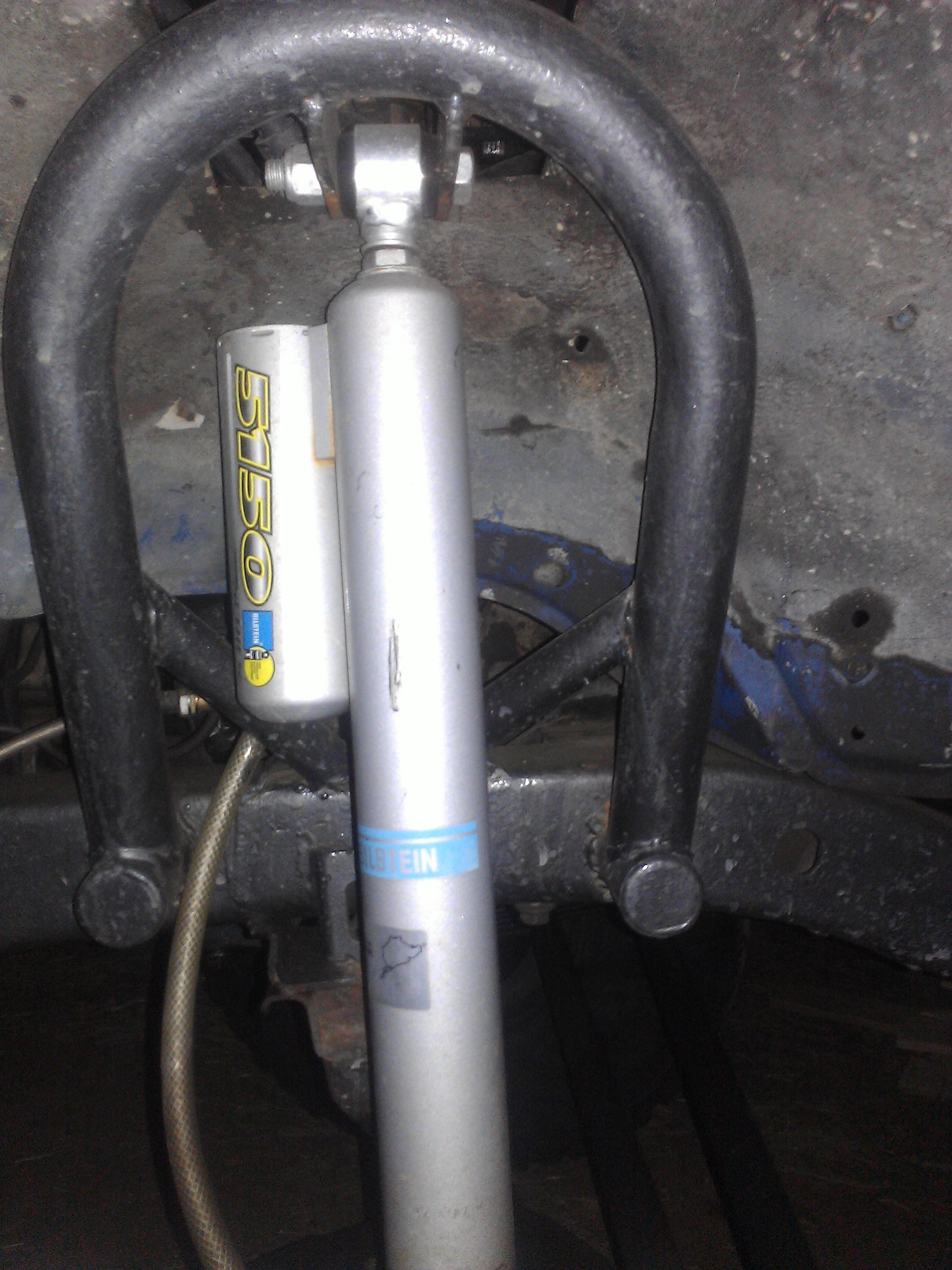

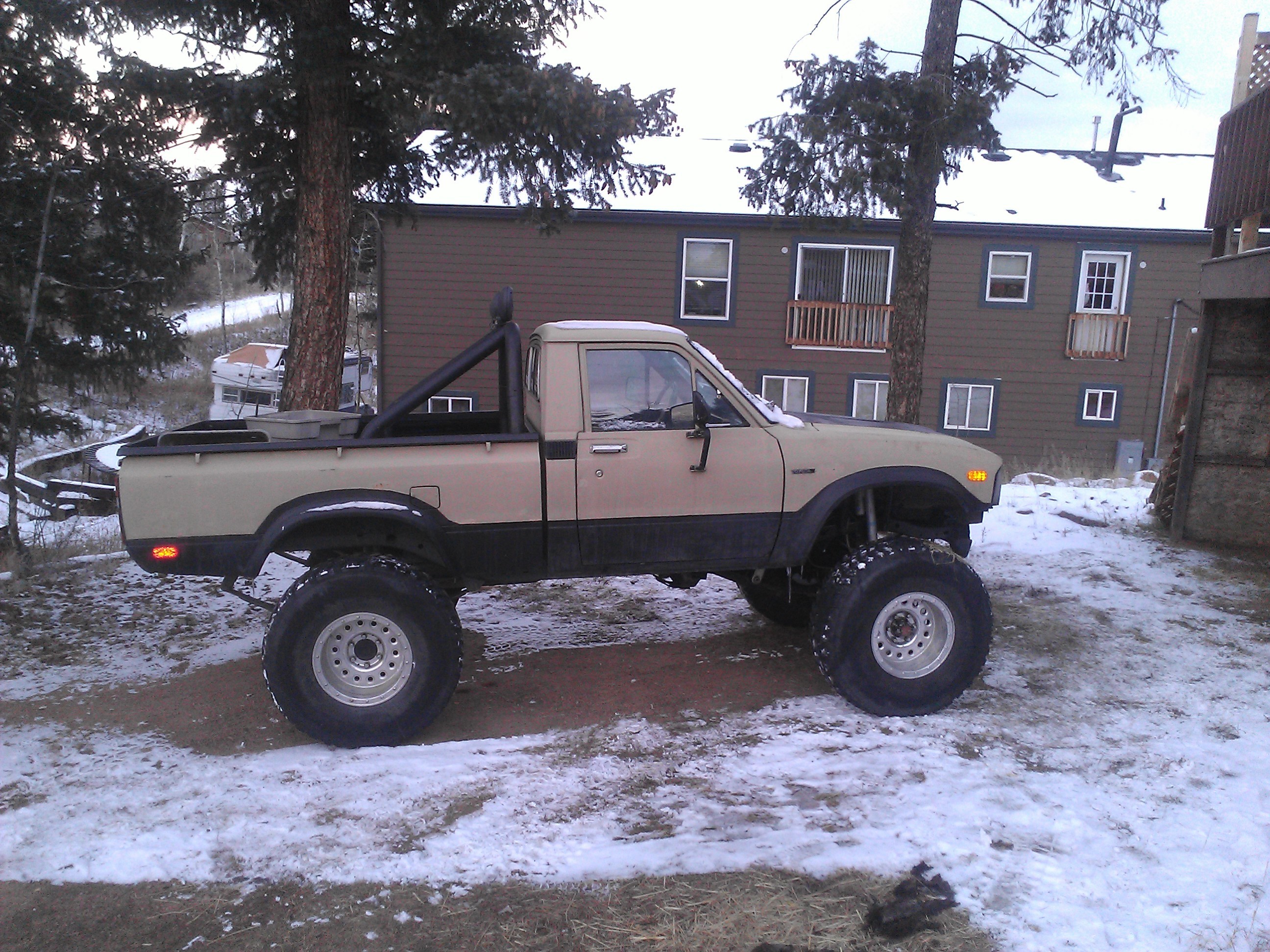

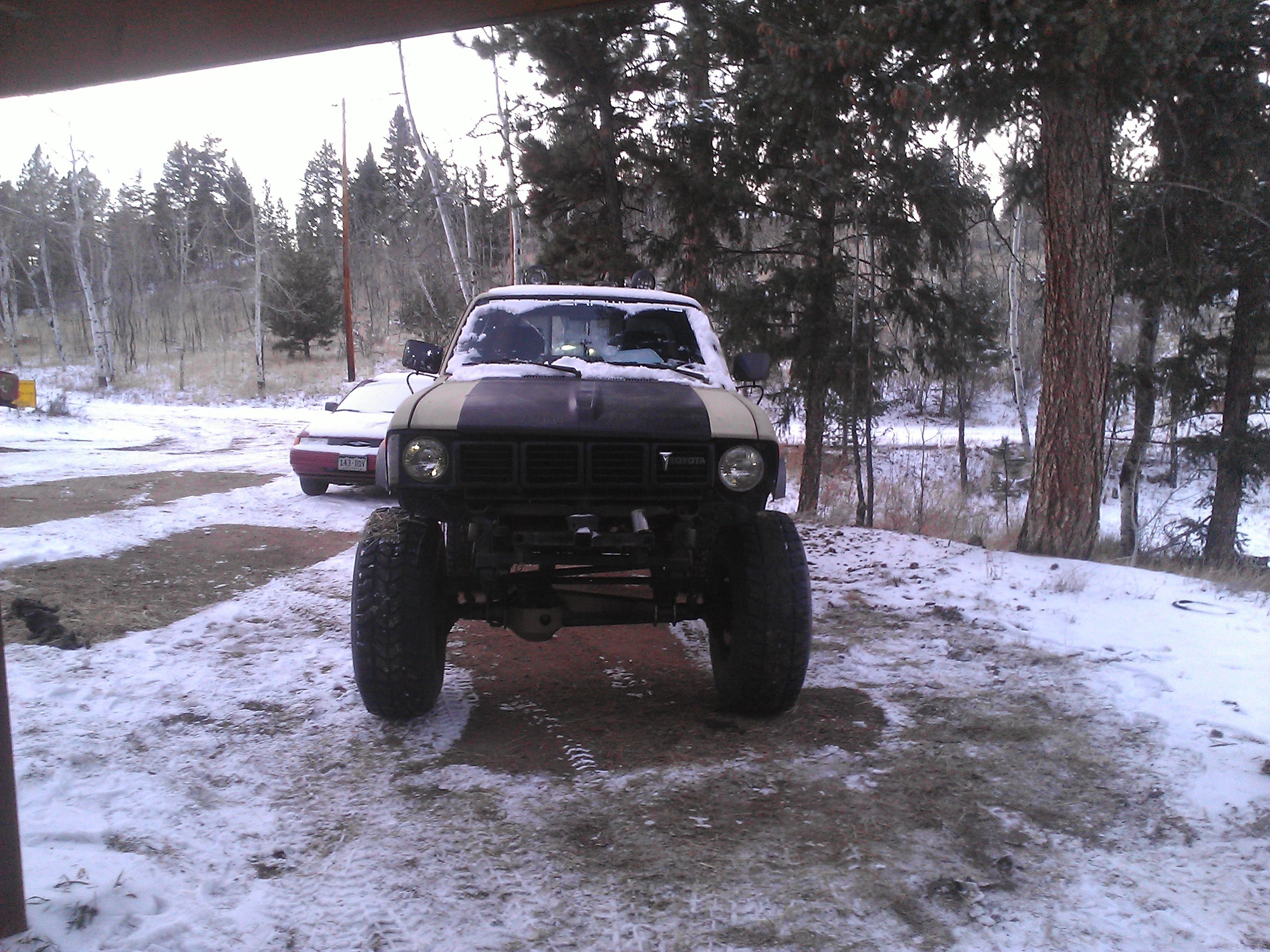

Just got this like Wednesday last week. Traded a rifle for it.

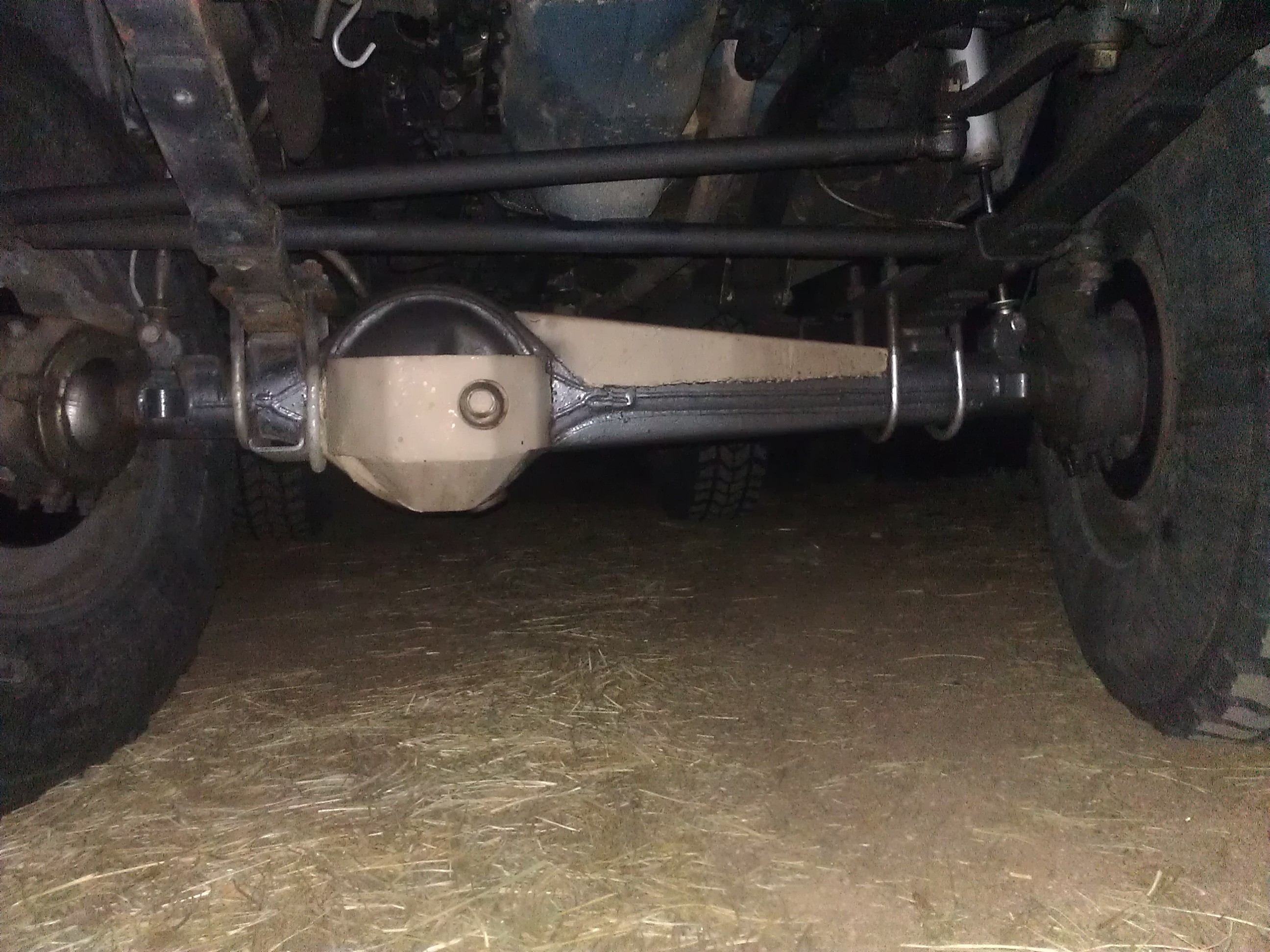

It is an 80 SR5. Blown 20R with a 32/36 Weber. Swapped to W56. IFS rear with an Aussie. Trussed and armored front with an Aussie ,1.5" wheel spacers hi steer and power steering. TG 4.7 single case. TG 4 or 5 springs. Bilstein 5150 up front and 5100 in the rear. And 37'' Military tires. Guy said it had 4.73 gears in it, but that to the best of my knowledge isn't a Toyota gear ratio. 4.37 maybe? Will have to look. Hoping it has dirty 30s or longs in it. But here is what I have for pics right now...
Towing it home
