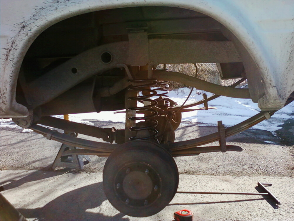

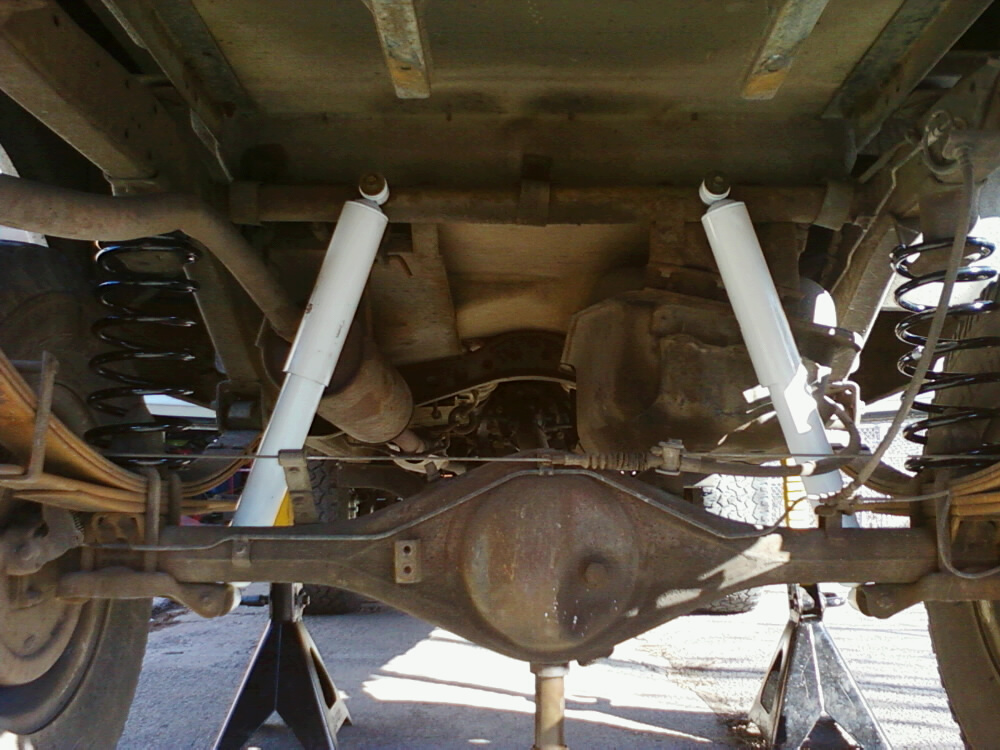

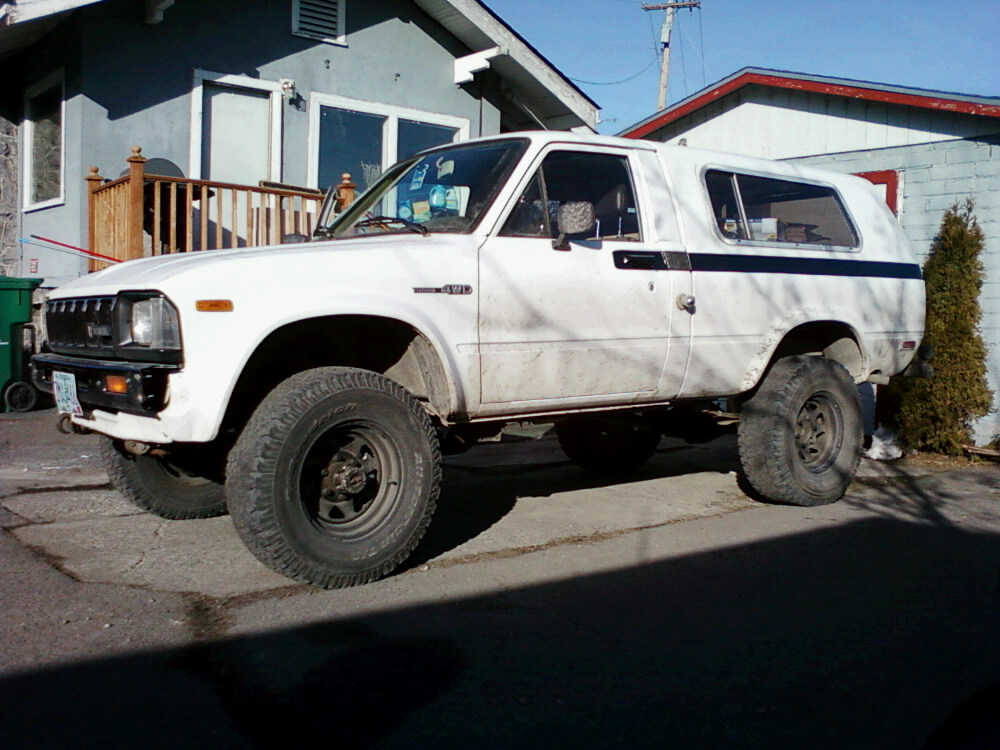

Today the Trekker received a Zuk mod using Black Magic 035-012 5" x 11" 125 lb rate soil springs, which slipped over the bump mounts almost too easily. Should have gone with 12", but this will do until I get new leafs.
Also threw on some Gabriel Ultra rear shocks at the same time.
The bump stops used to be less than 1" apart; now they are almost 4" apart. 3" lift for $60, yes please! I'm sure they will settle over time, but over time I plan to install a whole new suspension anyway.

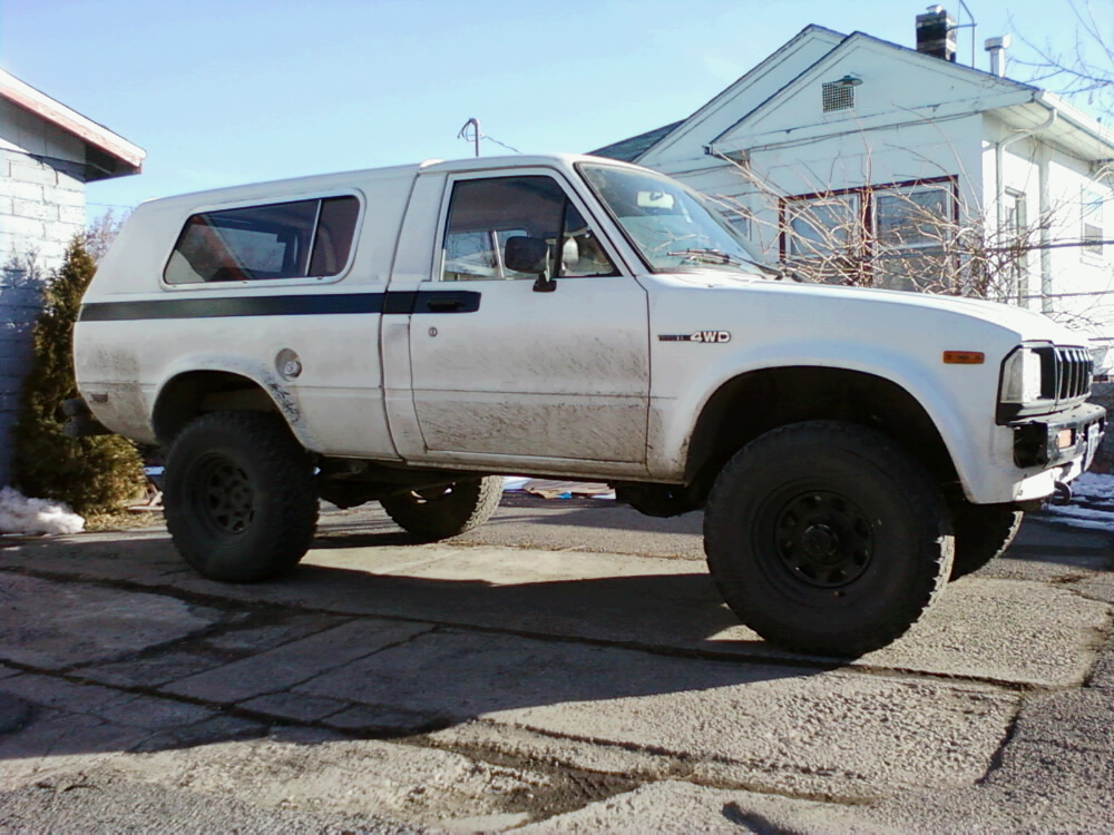

Stripes are on!

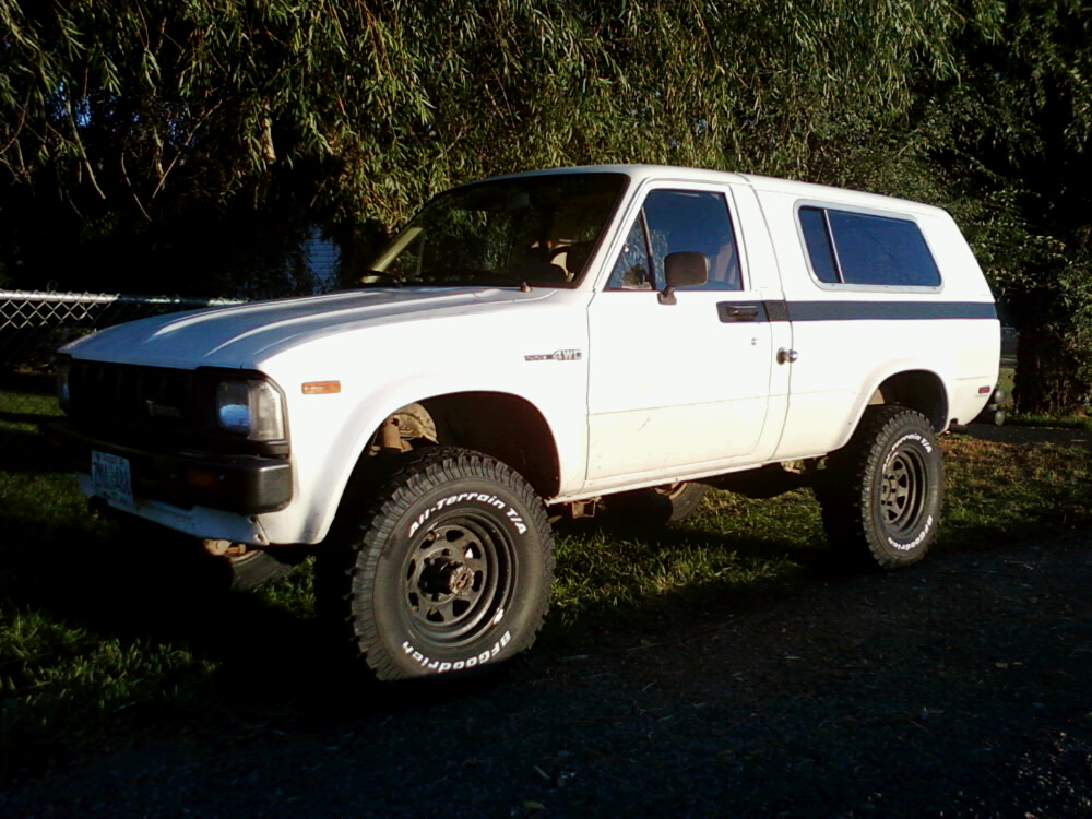

Finally got some new 31" BFG AT's!
In the mail: New brake rotors, ceramic pads, brake hoses, front shocks, seat covers, frost plug block heater, and battery heater. Will post again soon when everything is installed.
