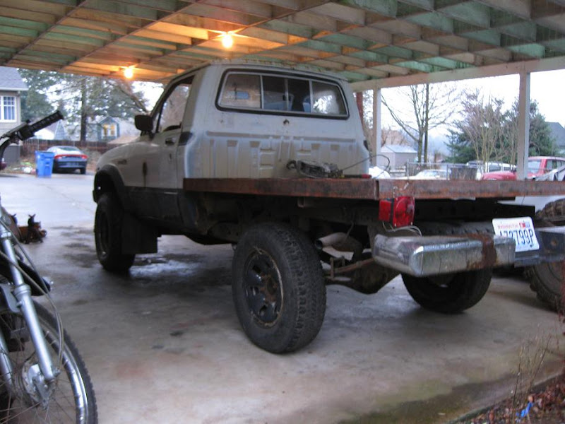

So, got a sweet deal on this truck this weekend. It used to belong to a friend of mine who got it from his dad. He converted it to the flatbed as his senior project and then stuck it into a garage and went into the Army Reserves.
He wanted to just give it to me since he had no use for it.. so I gave him $100. So far all I've done is stuff some 33" Super Swampers under it and rebuild the carb which had rust in the float bowl. Next I'll pull the tank and see if its usable.

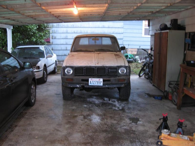

Here's how it came:
The flatbed will probably go away along with the cab.

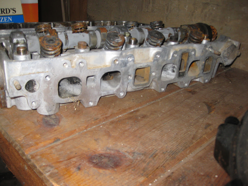

Not sure what the head is... hopefully its a spare 20R.

Somewhat clean.

just a note on the spare head. you can tell if it's a 20r by the shape of the intake ports. Round ports on the 20r, square on the 22r. Good luck on the project.

What if they're roundish square ports?

Thats a 22r head.

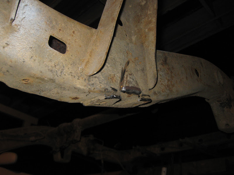

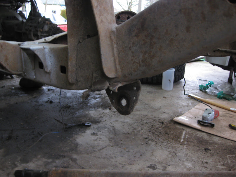

I had to cut both the front spring hangar and the shackles off just to get the stock springs off, they were so gummy.
then to get the shackles out of the hangar I had to cut the end off and pull them from the inside and pound them the rest of the way with a splitting maul and a socket extension

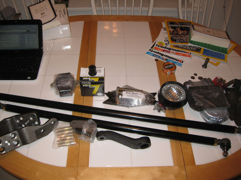

Anyway, got some more goodies today. 4-stud TG crossover kit, IFS steering box mounting kit, rear shock tabs, u-bolt flip, bushings for rear shackle hangar, bump stops, 8 magnum studs, and TG's $15 light for a backup light.
