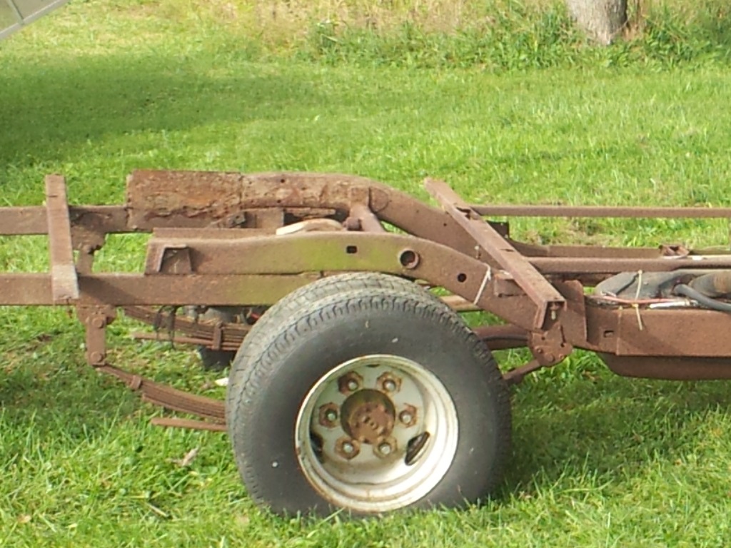

Here's an example of some less-than-stellar modifications; Picture from a stripped cab & chassis of identical year & make (1982 dolphin) that I was considering buying last summer. Note the re-located rear spring shackle and welding within the spring arch. Ask any knowledgeable trucker, engineer, or mechanic - this type of frame mod is an absolute no-go. They did it...

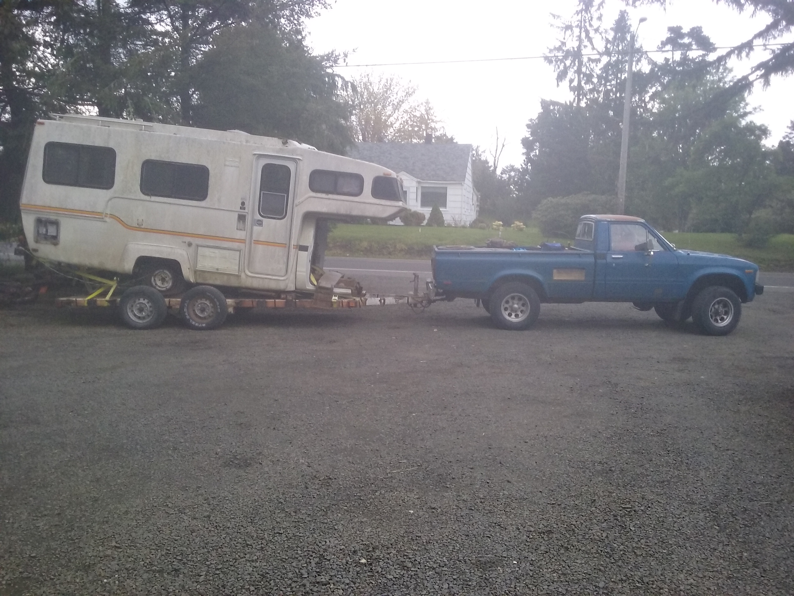

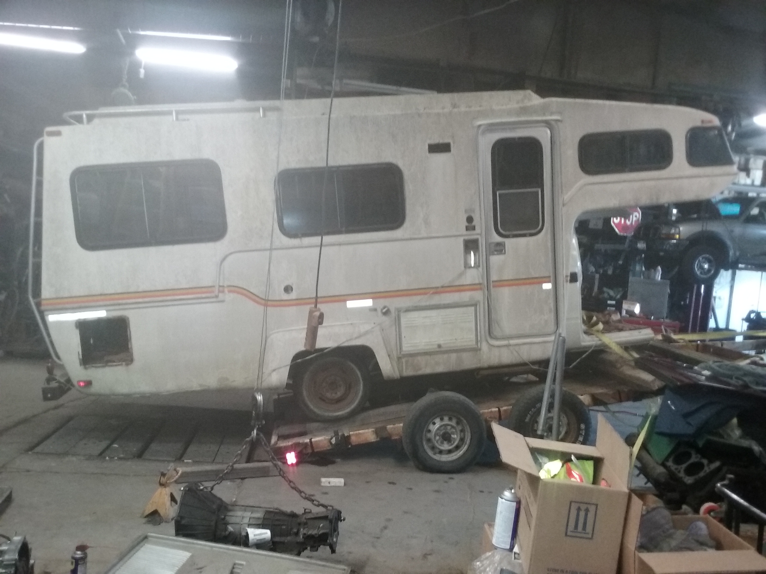

Had a busy week. Got the replacement Coach Body. 1,300 miles over the last week. Donor is a rusted out 21' 1983 Sunrader Motorhome that had been sitting neglected for the last 15 years in the coastal rain and salt air. Good thing fiberglass doesn't rust... One of the very few RV coach builders that used a molded fiberglass shell in the construction. The trip was something else...
It's going to be fun fixing the factory installed holes in the roof, and some of the accumulated damage and sagging that this make is prone to, but I'm hoping to build a real gem.

Some pics of the parts rig getting ready to come home. Looks a bit funny, but the box is mostly air.

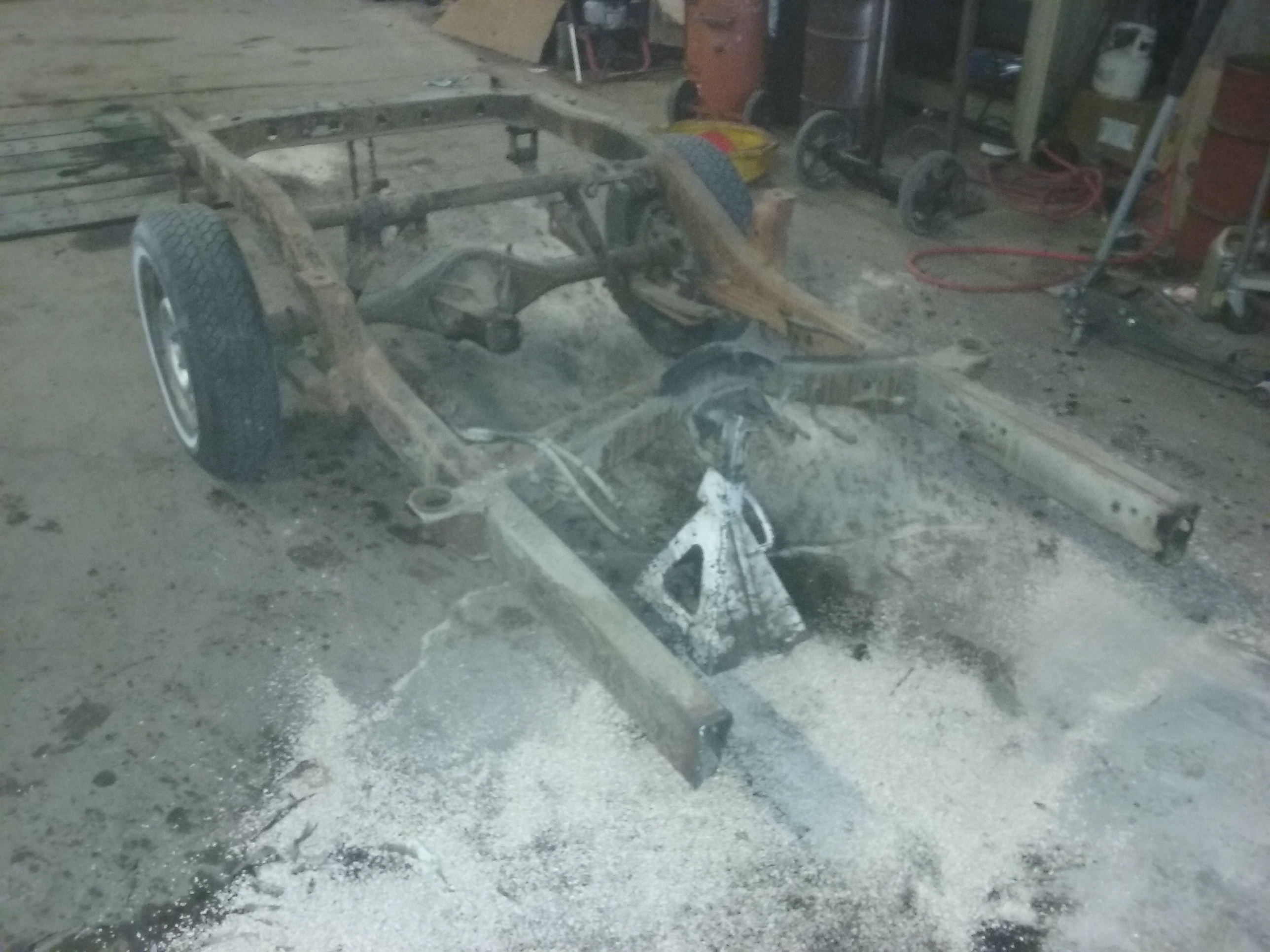

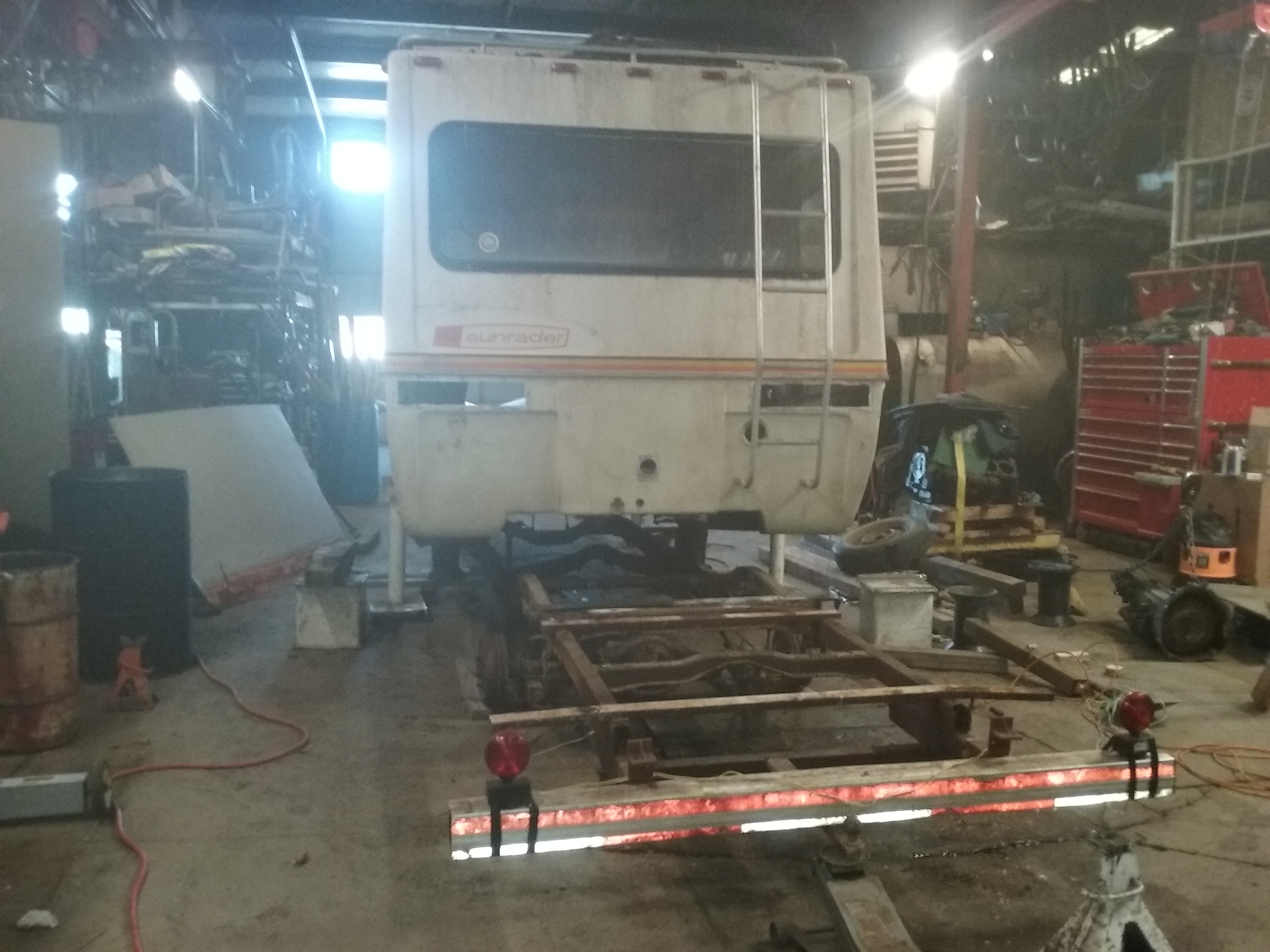

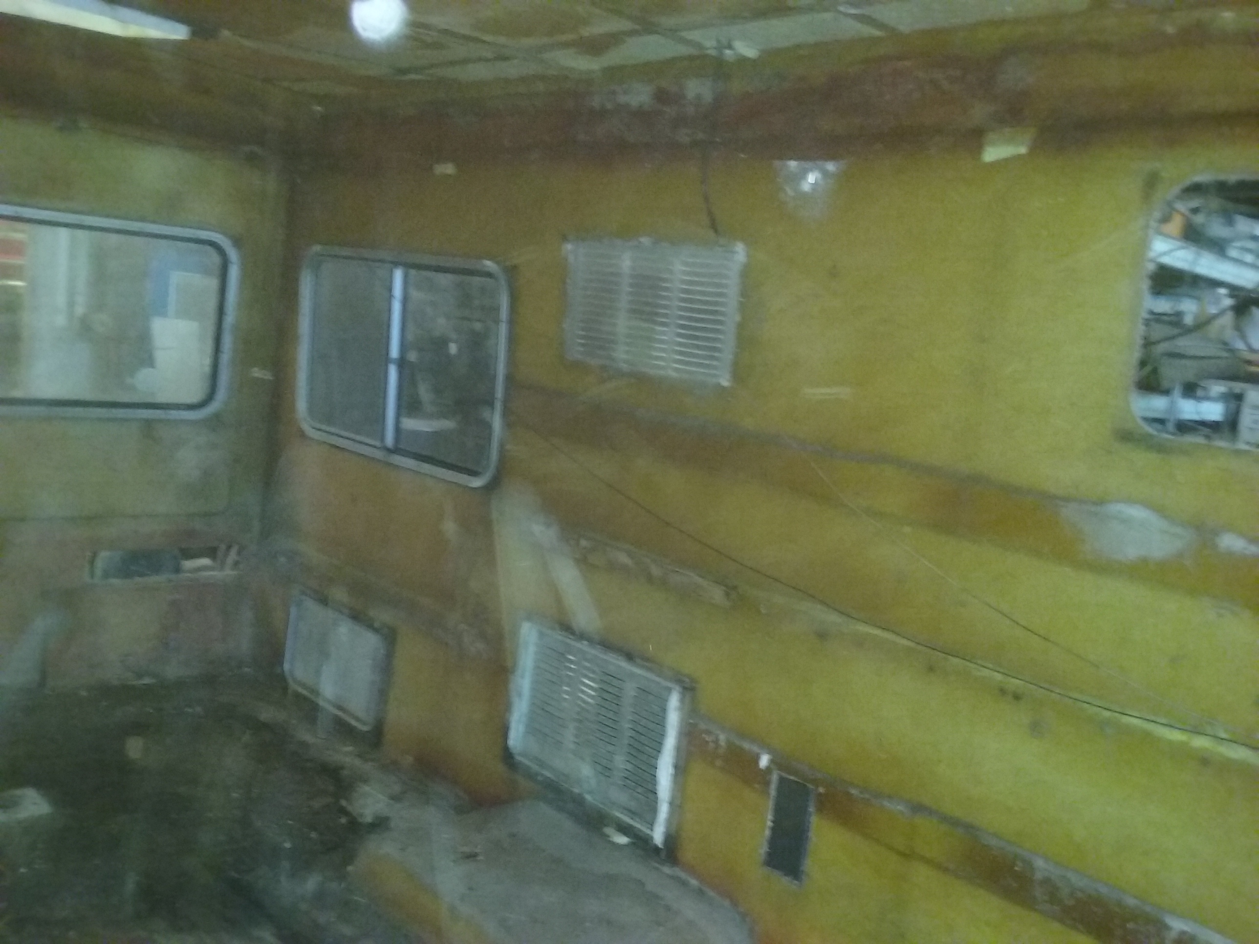

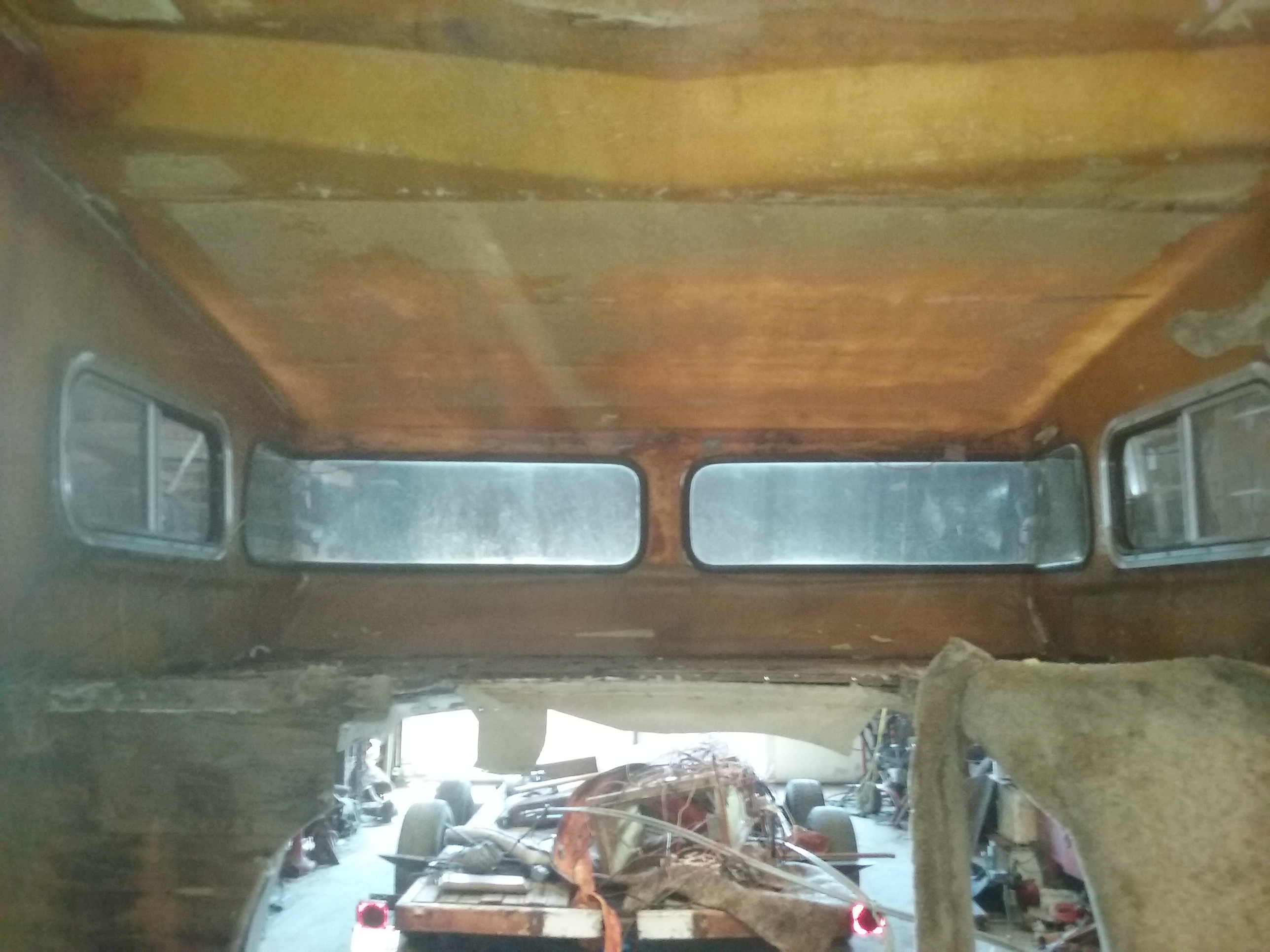

Progress update: Got the inside of the shell to bare fiberglass & Floor, and have the rusty frame metal separated from the shell. I'll be posting some pics of this stage soon, and then the fun begins - making my frame fit the shell, and the beginnings of the 4wd drive-train conversion...
Old 05-30-2017, 05:03 AM
troyjmueller's Avatar
Join Date: Mar 2007
Posts: 67
Received 1 Like on 1 Post
Here's some pics... removing shell, shell sitting on another pending project, some interior...

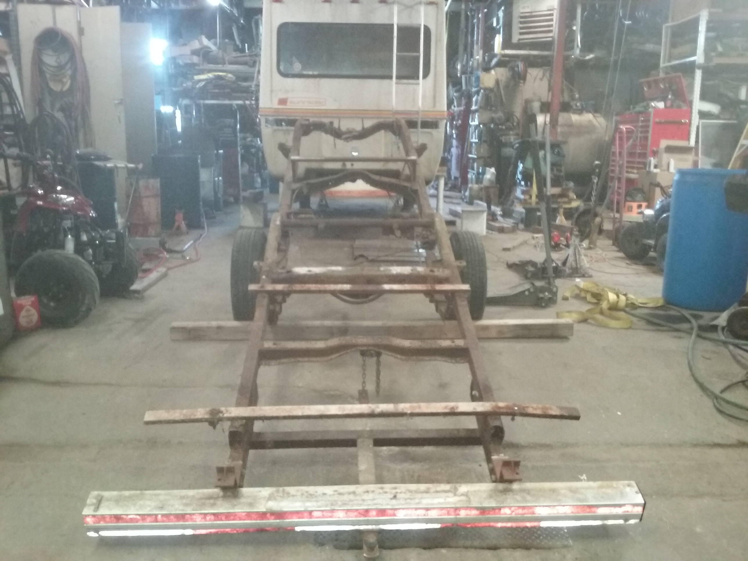

I've been a bit busy, but have managed to get a bit more done. Having the shell separated from the rusty donor frame, that phase of the project is complete. Now, I've been working on frame customization. I've raided my parts pile, rounded up my axle set, and have a rolling mock-up right now. My parts worked out almost perfect for the rear part of the two-piece driveline (stock gen 1 long-bed drive-line), bolted to a 2wd front drive-line carrier bearing stub. I need to add about 1/2" between the carrier cross-member and the rear section (to allow for slip-joint travel), and about 2"-8" between the front section and the center section, to get a wheelbase of ~ 150" - 156". That would allow for a cab extension of 10"-16", before the transition to the RV proper. I have some pics of the mock-up, but is going to be a bit before I can get to the next stage, but I can see the beginnings of a foundation...

Here's a few pics of my parts rig, and the beginnings of the custom Long-Bed Frame... Last pic is current stage, frame assembled loosely, not welded or bolted (clamped), with rear section of two-part driveline hanging between axle and carrier bearing stub from a parts 2wd long-bed front section... and measures about 150" long wheelbase. I've got a bit more room than the stock 109" wheelbase, now...
